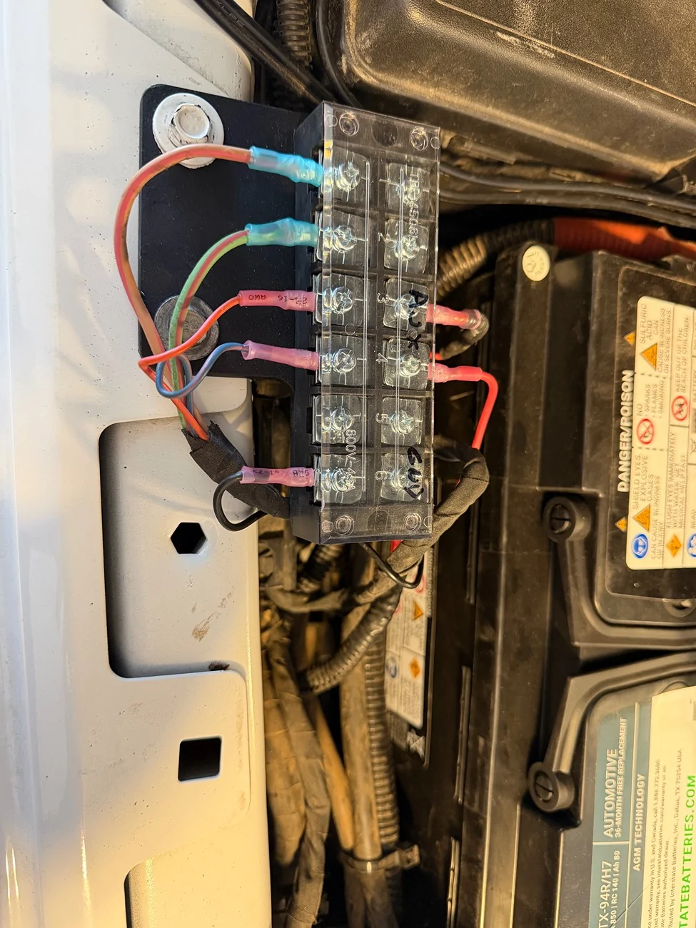

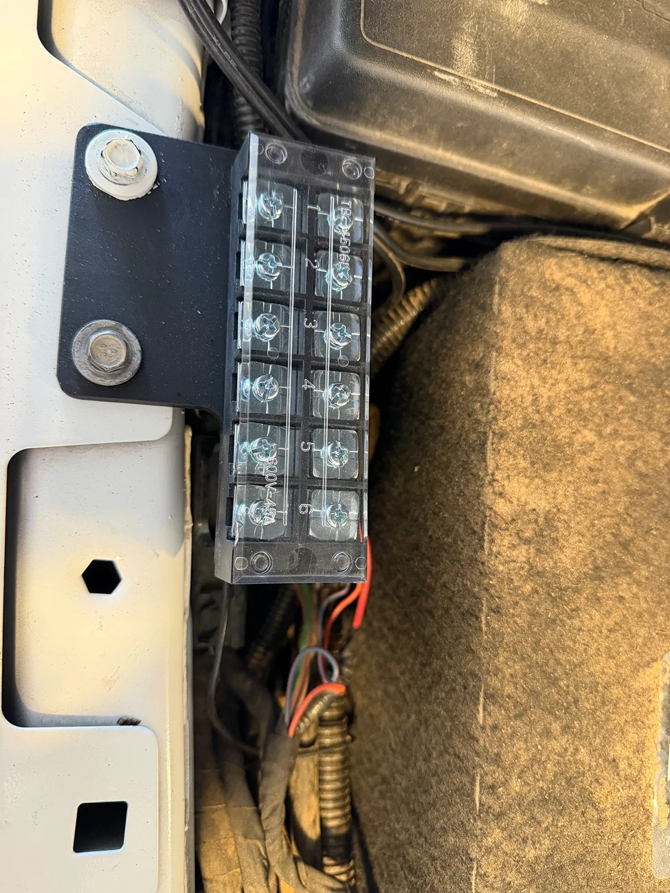

Will be connecting a few accessories to battery and am looking for a clean way to do it. I've been looking at some kind of bus bar setup. Any recommendations on what to get? Something thats weatherproof?

What ever you get, make sure it has the capacity to carry the amperage you are hooking up to it. And maybe add 20% for safety. A
