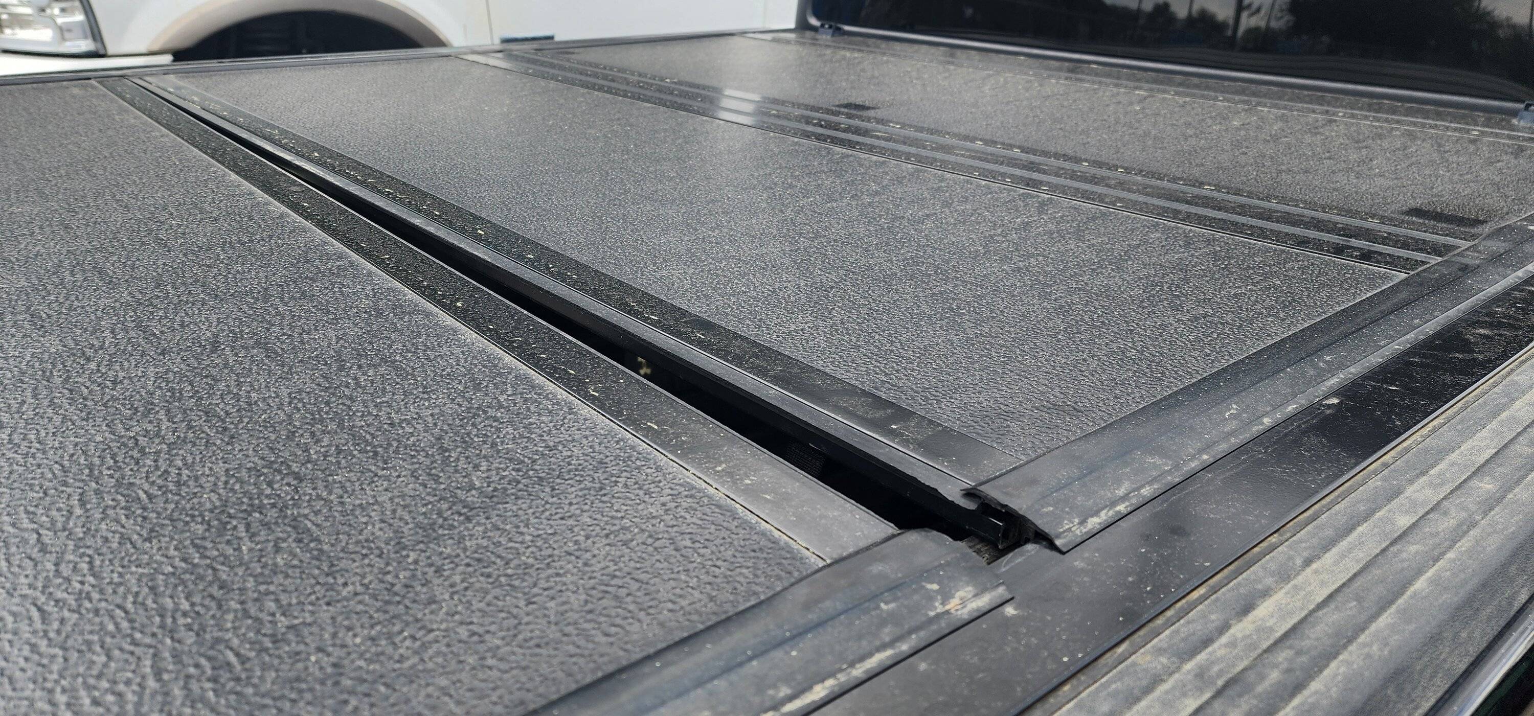

Looking for the rubber seals for the MOPAR tri-fold cover. Any chance there's a kit, or do I need to order each part individually?
Hi Jeff,
I do not believe these are serviceable from Mopar but I am checking with my contact.
Thanks,
- Benny
Hi,
I have confirmed Mopar does not offer these but you should be able to obtain parts directly from the vendor at 833-204-2606
Thank you,
- Benny
