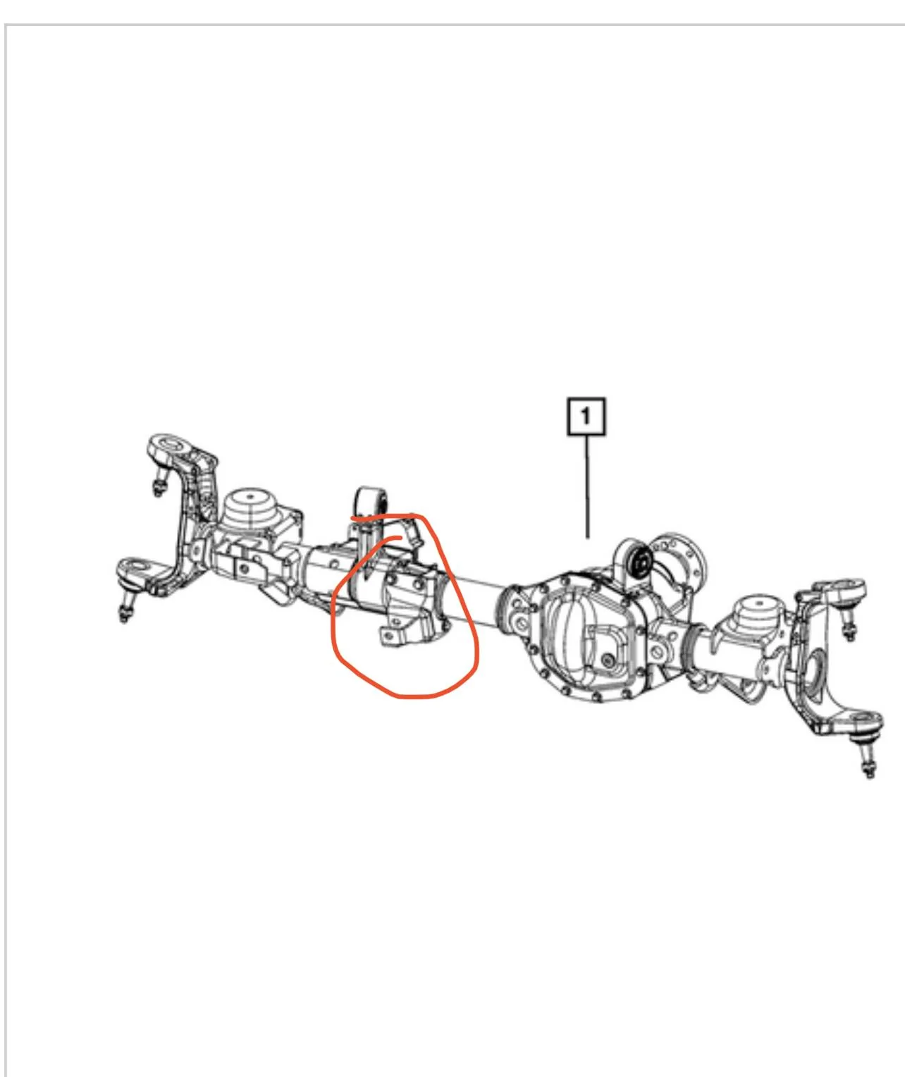

Benny @AllMoparParts.com ,
I am looking for the part number for the front axle side steering stabilizer mount bracket.
VIN: 1C6JJTBG4NL143415
Thanks for any help.
Hi,
Part # is 68394147AB
Please let me know if you have any other questions.
Thanks,
-Benny
