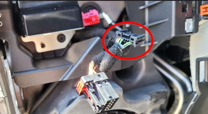

I assumed the inverter switch harness would be sitting there after watching, go to 6:31, I have the inverter but the wiring isn't there

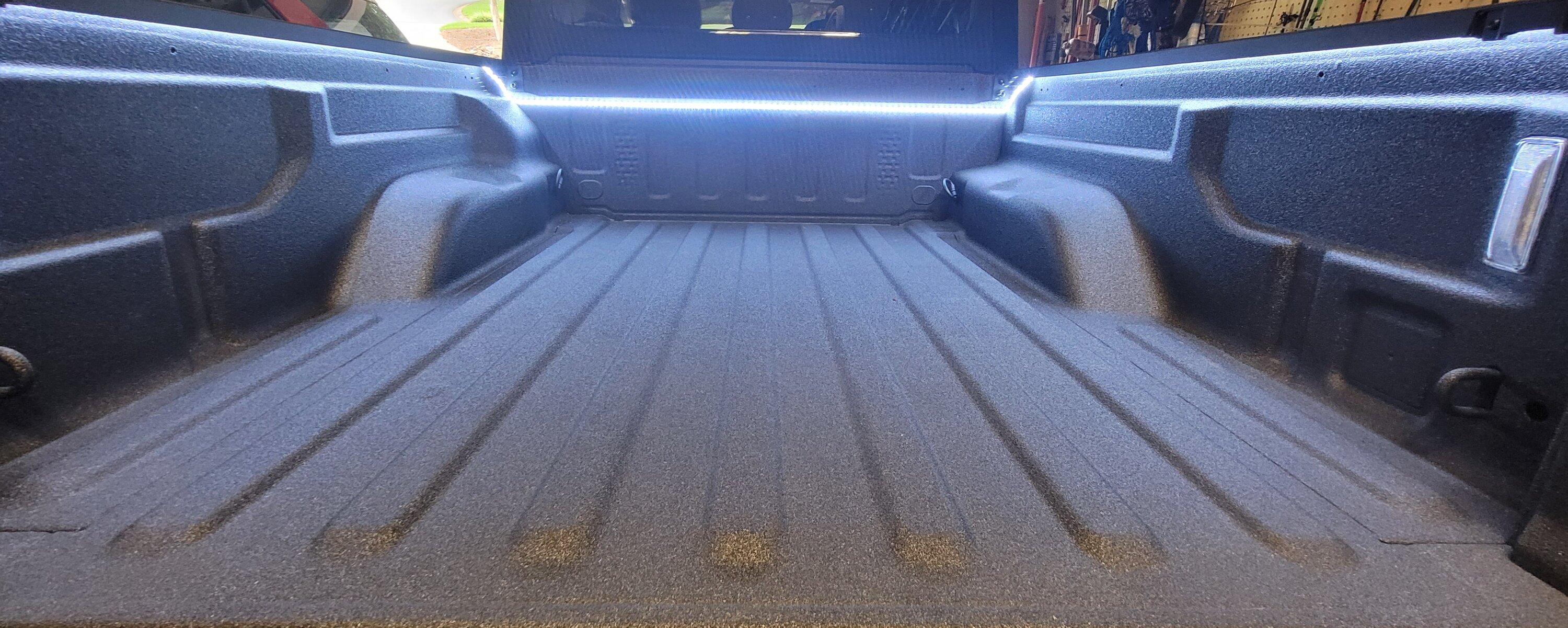

That is interesting. I just added the bed outlet and outlet switch this past weekend. The outlet switch harness was taped to the light switch harness. I wonder if yours is shoved behind something.

So no extra connector behind the HL switch panel ?
I seen where it's only there with the 240 alternator but I have the 220, 650a battery, 400w inverter, I can run it manually but need to know the cable part #

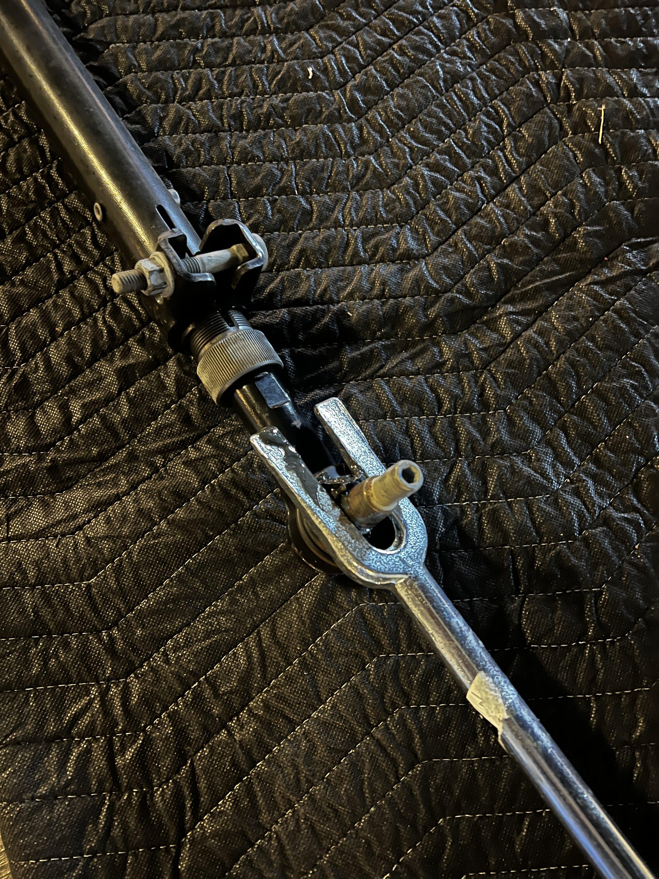

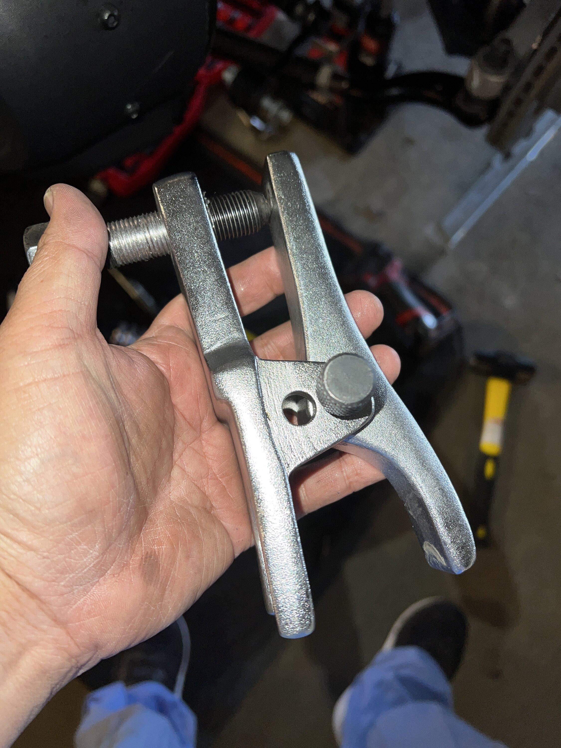

Upgraded to a Teraflex Tie Rod and Drag Link.
Getting the ball joint off the pitman arm was a struggle. Cheap Chinesium ball joint separator failed. I was luck just to get this thing off.
Jeep Gladiator What did you do TO your Gladiator today? [ADMIN WARNING: NO POLITICS, NO GUN TALK] 9272C122-C710-4846-BB78-87B7F73E3FD5
Made a trip to O’Reilly’s and got Pickle Fork instead.
Jeep Gladiator What did you do TO your Gladiator today? [ADMIN WARNING: NO POLITICS, NO GUN TALK] 03C223A1-2576-4842-8E29-A4B8921A04CA

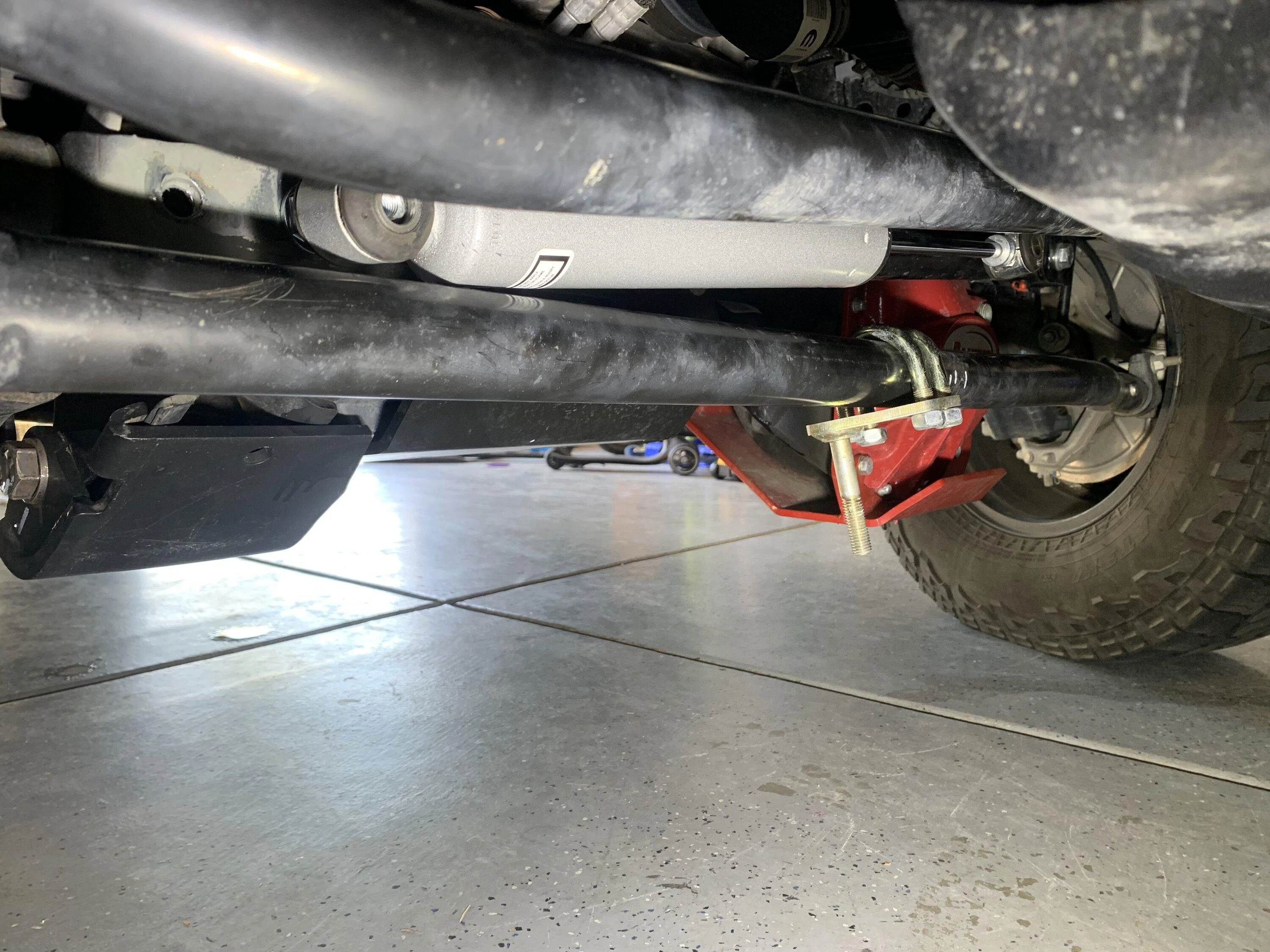

I took off my quadratec aluminum transfer skid that reduced clearance, and put the stock one back on.
then, I spent a bunch of time taking my Clayton SS relocation bracket off and putting the synergy one on, only to find there’s even more interference with my setup!?‍♂
Long story short, with Clayton bracket, AEV SS, and RK track bar, the tie rod clamp by the diff hits the track bar and drag link at full left turn.
The Synergy bolt doesn’t work at all with the AEV stabilizer. It’s fatter than OEM so synergy bolt doesn’t go all the way through the bushing, not sure if trust a few threads of the hex bolt to hold. Worse, the AEV is so fat that it hits the tie rod.
Jeep Gladiator What did you do TO your Gladiator today? [ADMIN WARNING: NO POLITICS, NO GUN TALK] B8FDD0BE-BFF9-4AE6-ADE8-7B27AD17F850
sooo, I put the Clayton back on and tightened everything up.
