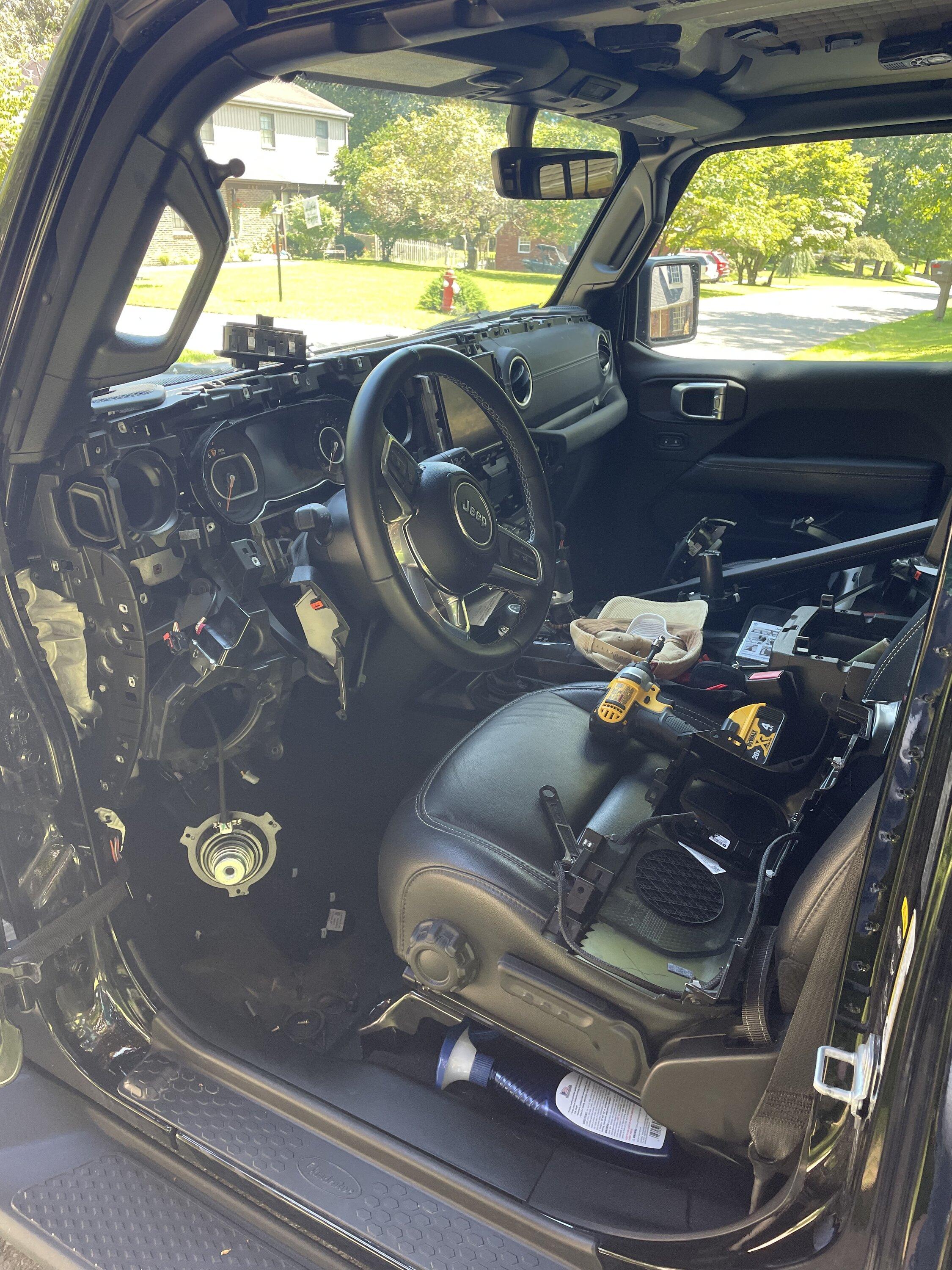

I assumed the inverter switch harness would be sitting there after watching, go to 6:31, I have the inverter but the wiring isn't there
I watched that same video and got the whole dash off to find that I too didn’t have the cable where it was shown to be in that video. Luckily a comment on that video said that newer Gladiator models still have it, but it is further back. I had to take out the front knee speaker and reach really far back, almost to firewall, to get the cable. It’s taped onto the same harness as shown in the video, but just in the worst location possible.
Not the best picture, but just wanted to show future sufferers what it takes to get OEM bed power:

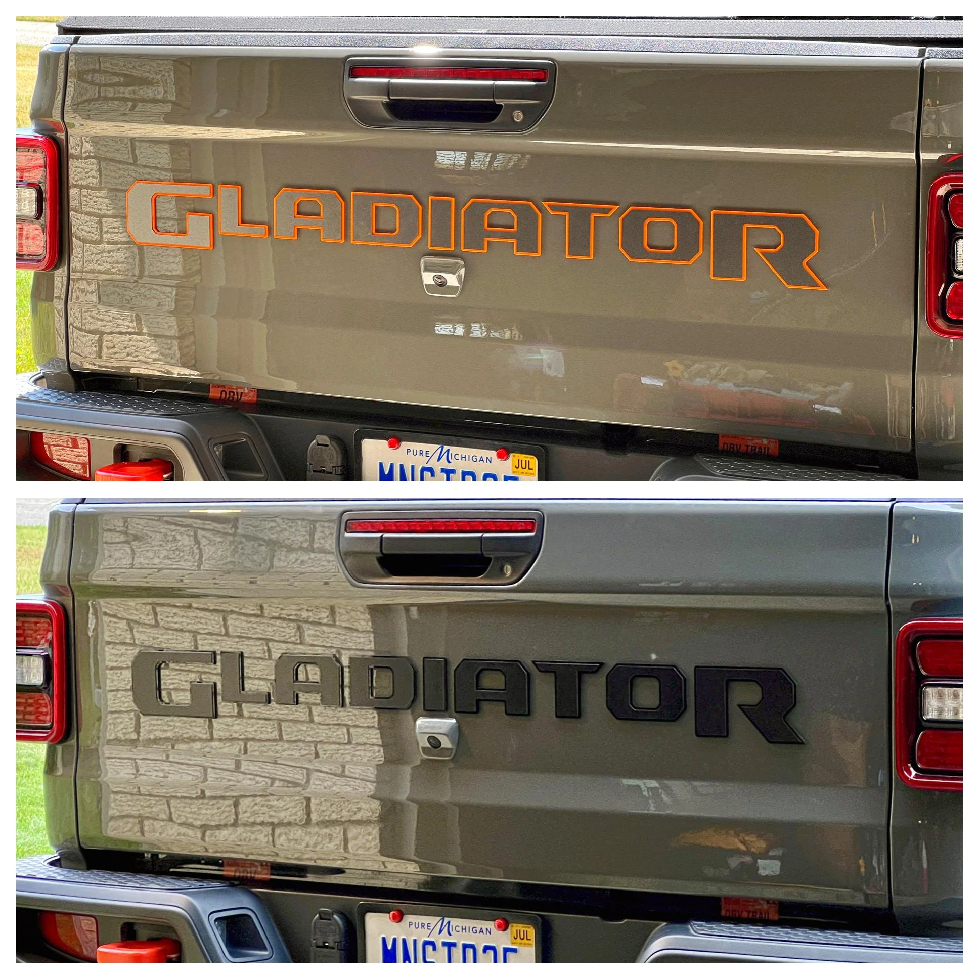

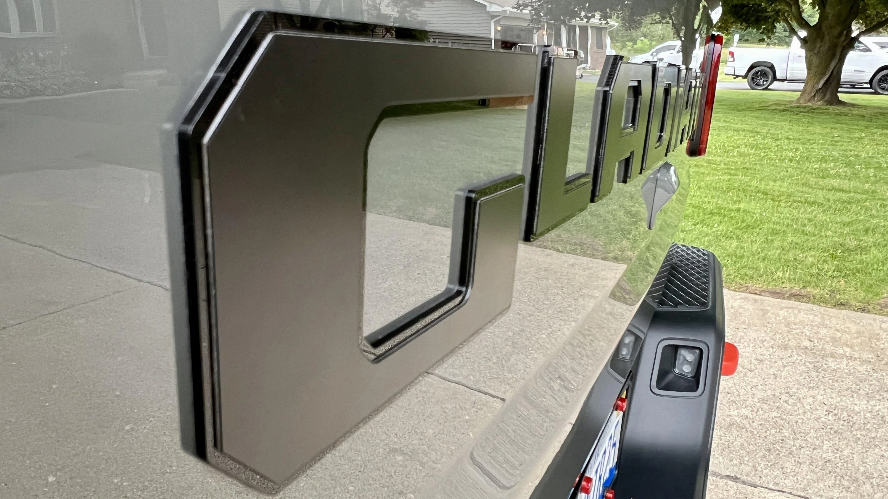

@OffAxis2021 which "GLADIATOR" badge kit is that?
LimitlessParts.com

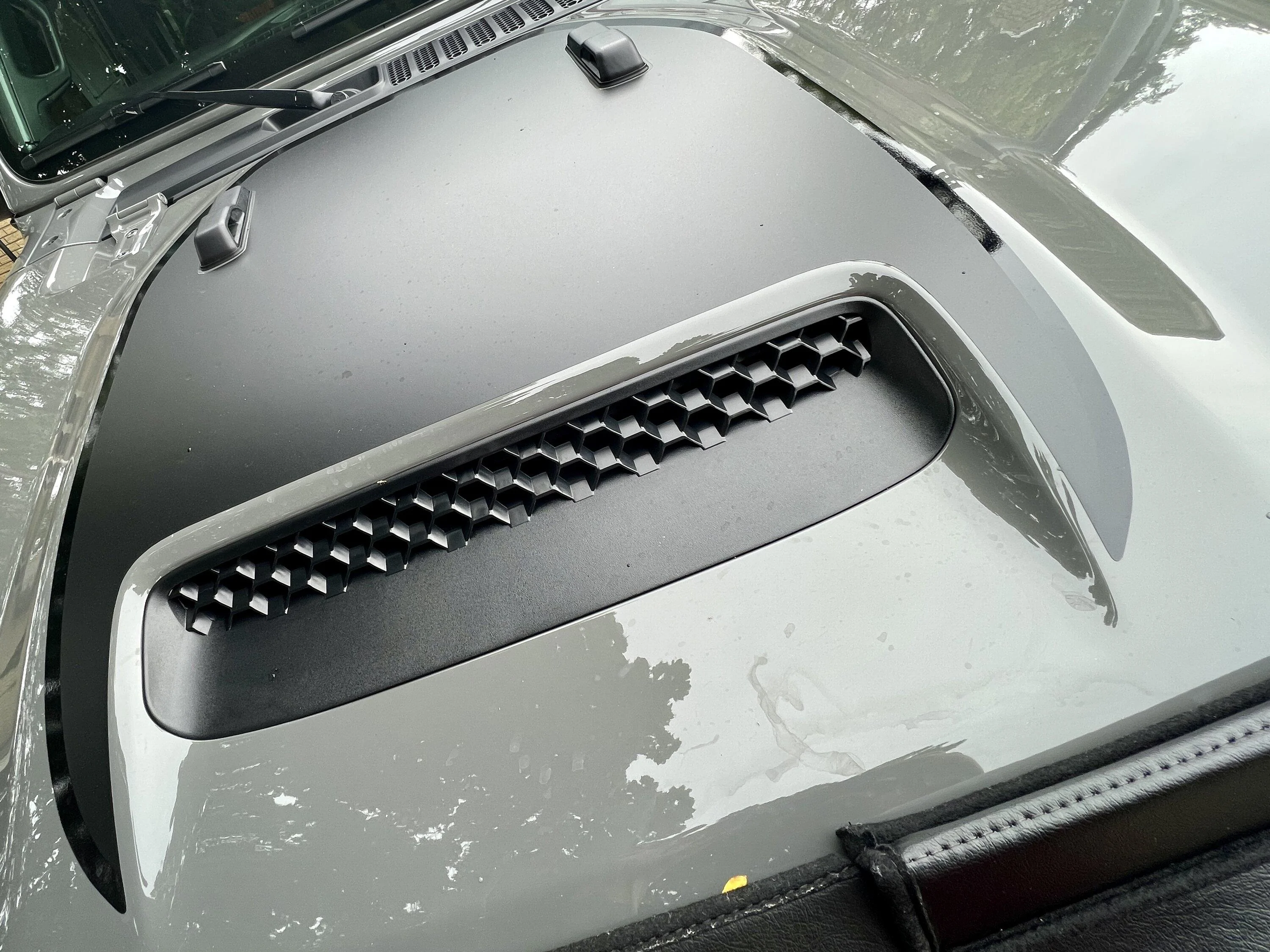

I tried the standard Mojave colors, but disliked the overall look. The orange was not a close enough match. The current is satin black (supposedly - it may be more matte) on gloss black outline, which is what the OEM hood graphic is (also may be more matte).
Satin vs. matte is closer than the Mojave colors badge’s orange was though.
Drove me nuts. Too OCD here.
Personally… I think the satin gray on gloss black would here have looked best on my application.

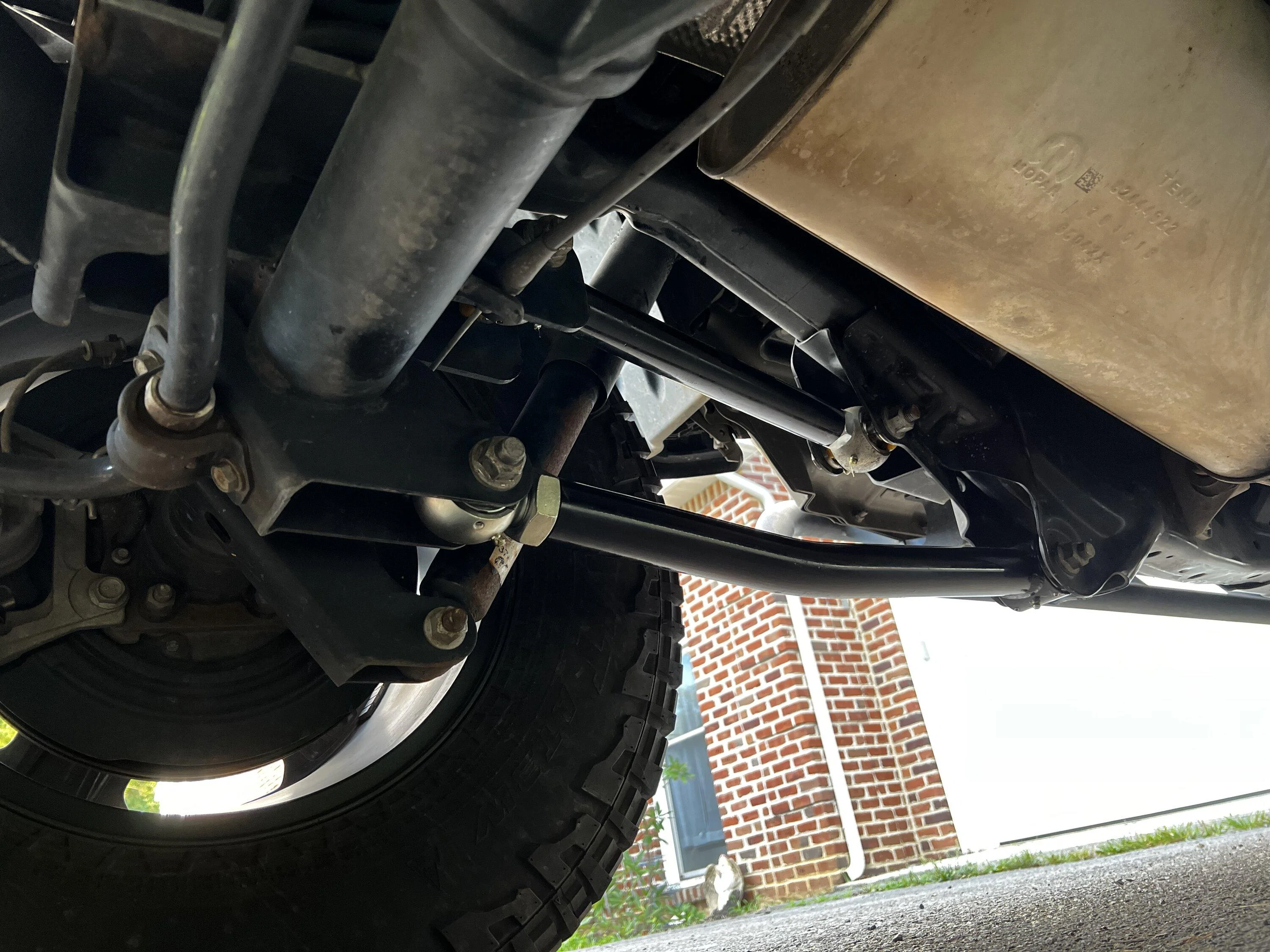

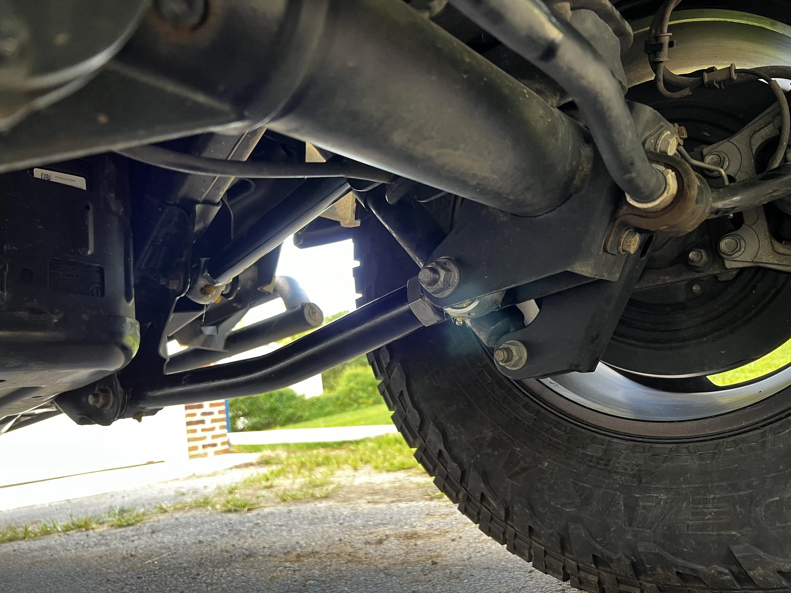

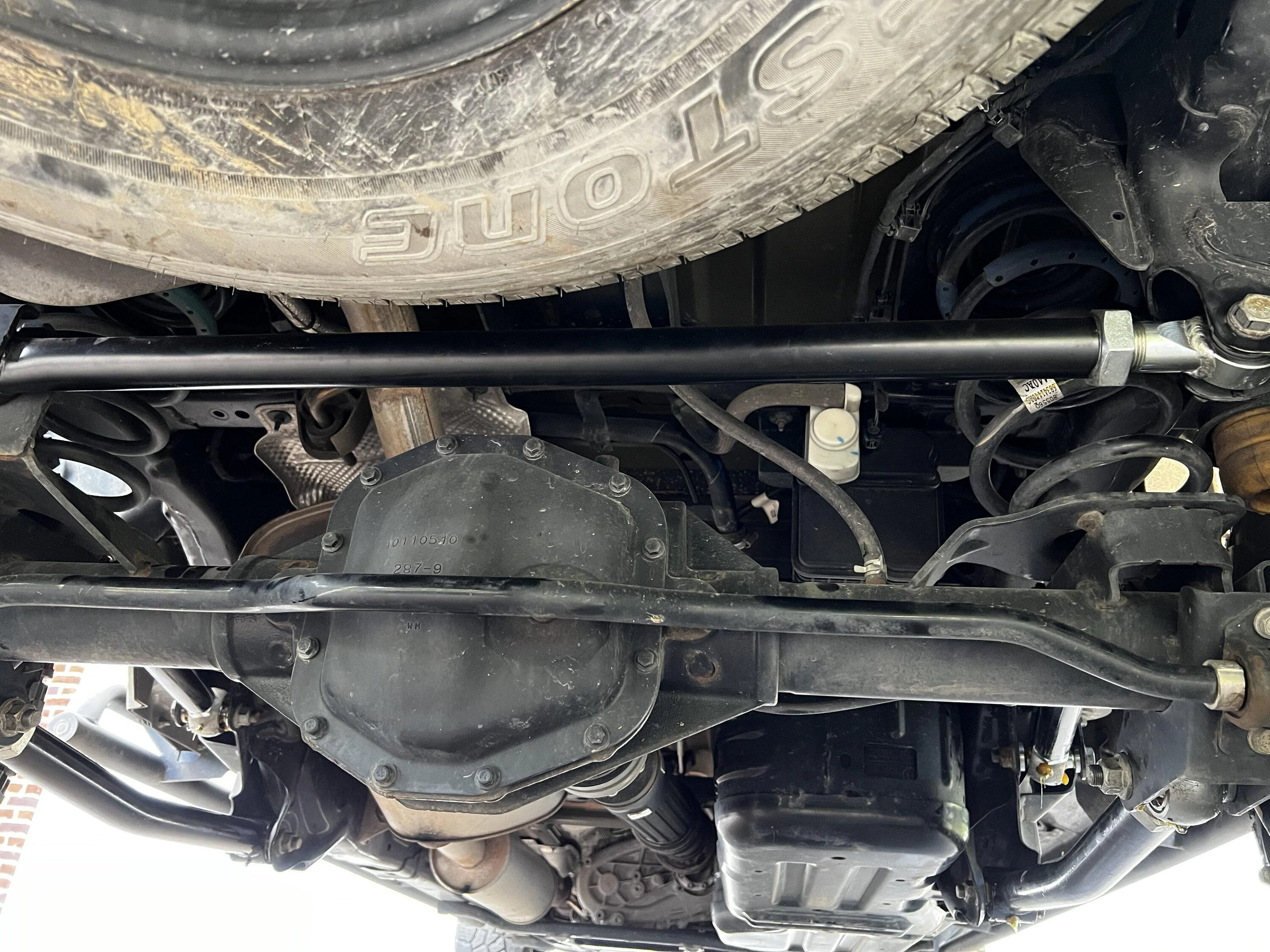

Finally installed the Rock crawler rear control arms and EVO rear track bar. Hope I did them correctly.

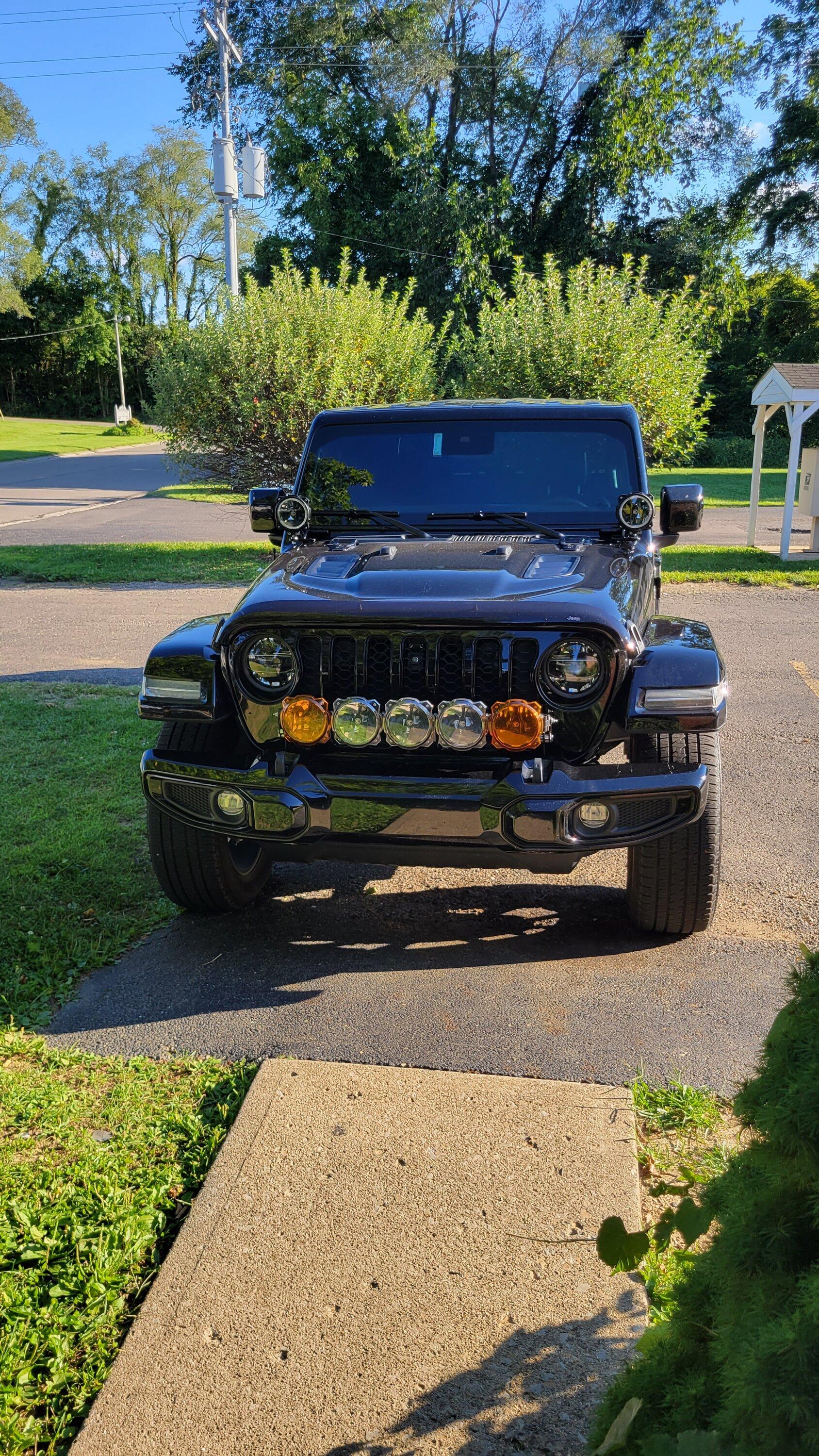

i added some kc gravity pro 6 to my cowl but i prefer the old style on my bumper just not sure if i want to keep them

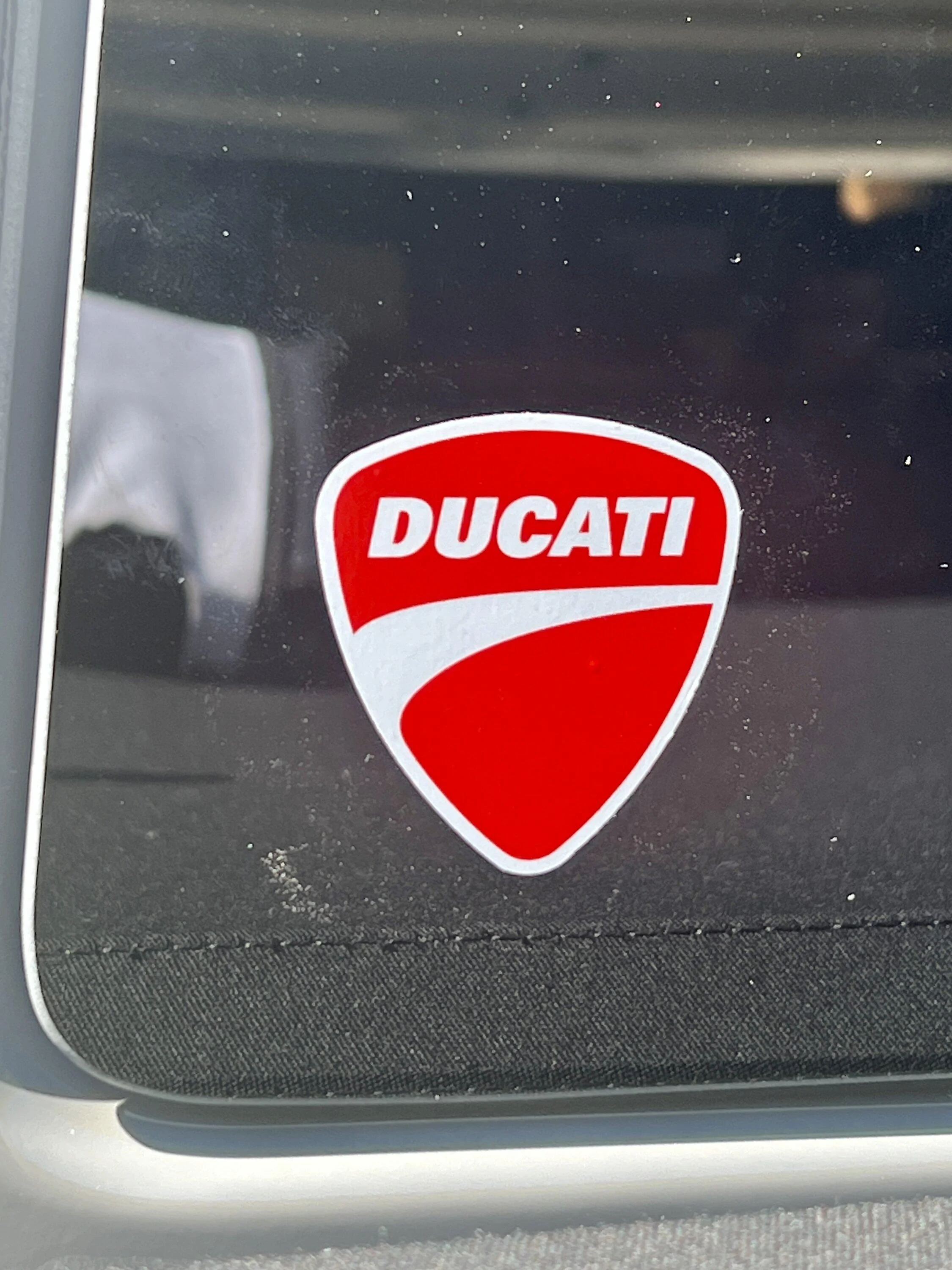

Yes… another cosmetic… Hah and not going to make the “adds X horsepower, right?” comment, but…
My actual “build” of sorts, is minimal and basically done so…
Added a sticker and it was by far the worst I have ever dealt with. So thin and I could not separate it from its paper backing.
Anyway… I said I was not going to put on any stickers, but… because… it goes with my digital license plate. Which is also in this thread.
Again… not a brag. Just another/an alternate choice of debt. Lol.
Weird, I had thought those were supposed to be installed with the bend "up" for clearance. That fashion increases the chance it will touch down on a rock, no?
