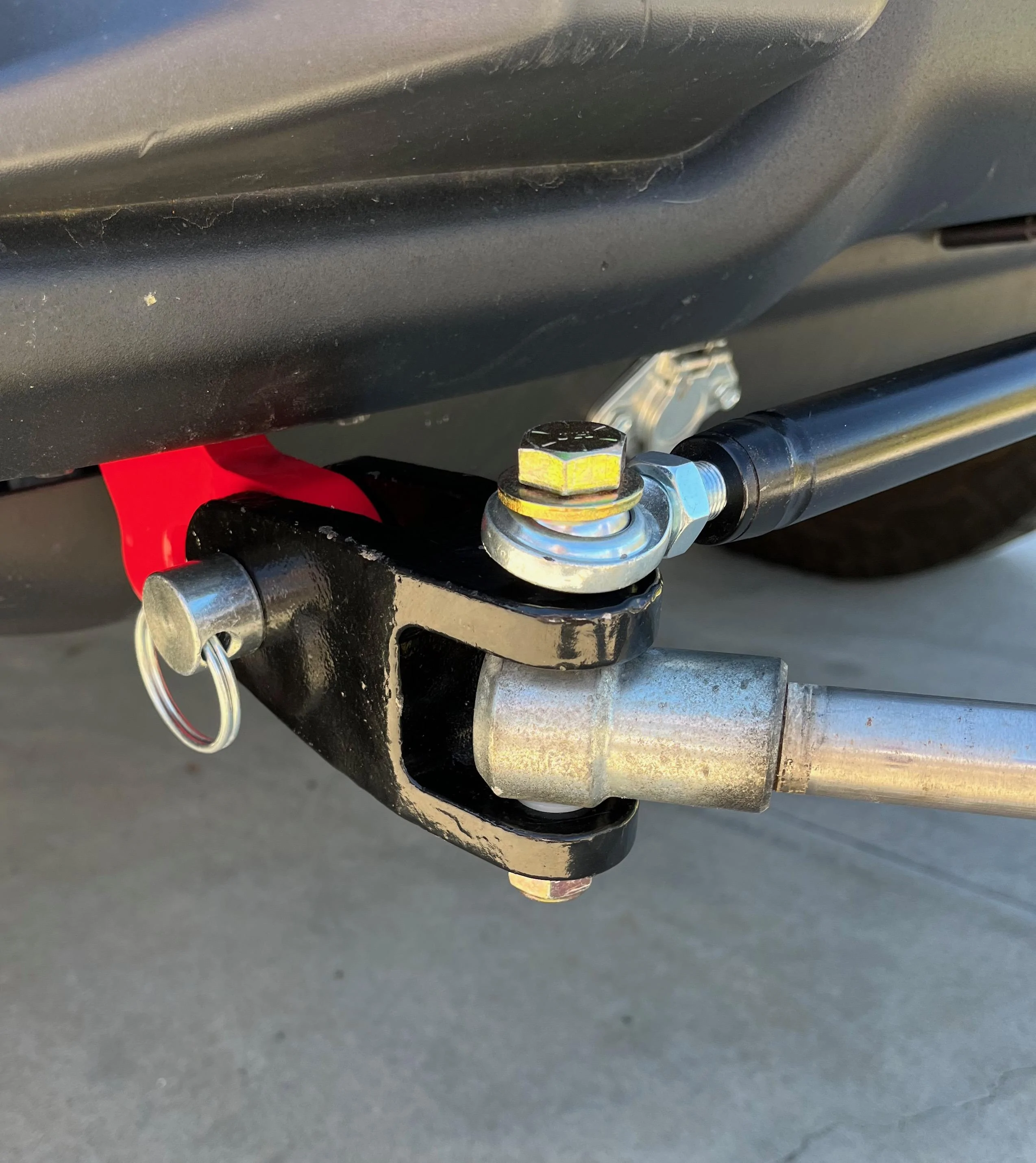

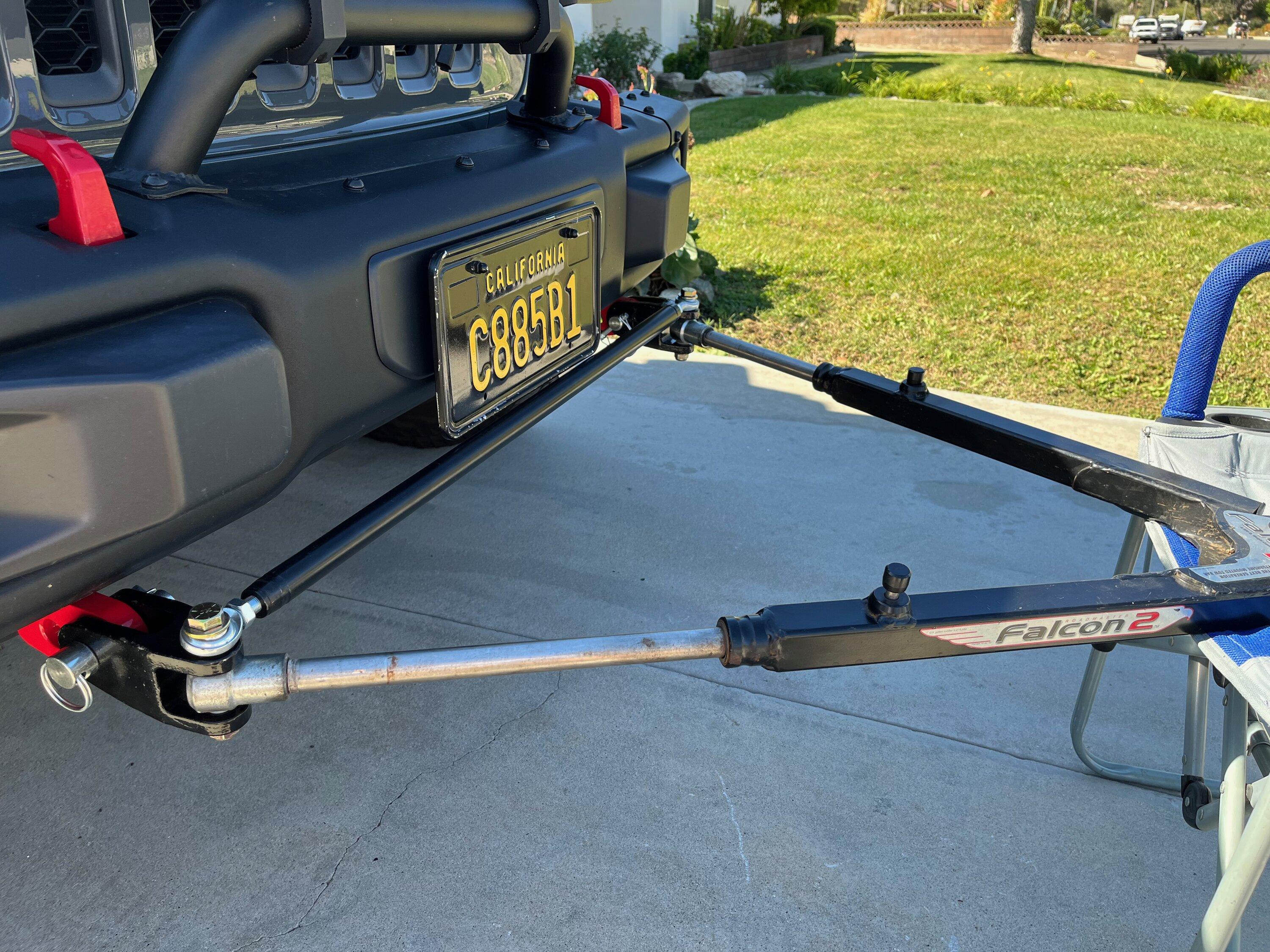

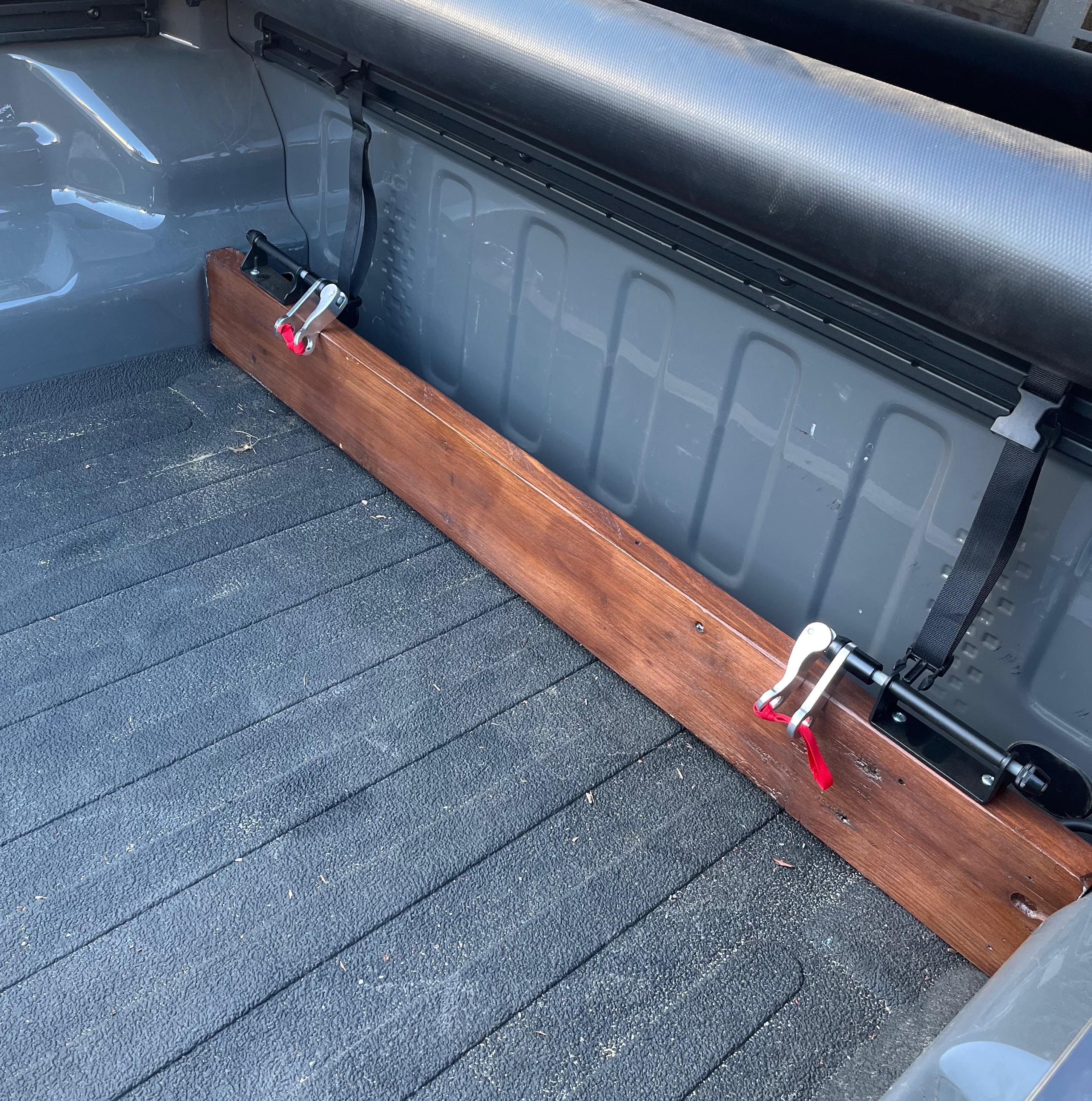

This is a duplicate post (mostly) of one I put on the Towing/Flat Towing sub forum. Administrator - Please remove it if this isn't allowed.
Finished installing lockable bike mounts in the bed for an upcoming camping trip. Mounted on a scrap 2x6 & finished it just so it doesn't look like well - scrap! The bike outboard pedals will be bungee'd or carabiner'd to the trail rails. Bikes won't move. I'll be flat towing the Gladiator behind my 26 ft. Class C RV for the first time.
Previously we towed a Fiat 500 (still have it) but I've wanted to make the Gladiator flat towable for a couple months long trip to Canada and back sometime in the next year. We'll see how the RV does on this test tow. I installed Maximus-3 recovery loops based on info found here rather than a frame-mounted baseplate like I have on the Fiat and also had on my old JK.
Bit of a pain in the neck because the "things" - whatever is their proper name - on the end of the Falcon 2 tow bar had to be changed to interface with the loops. I added the cross tie bar - also based n info from here - but the supplied bolts were not long enough. Had to get longer Grade 8 bolts & washers and all was good.
If anyone sees anything of concern PLEASE post comments.
