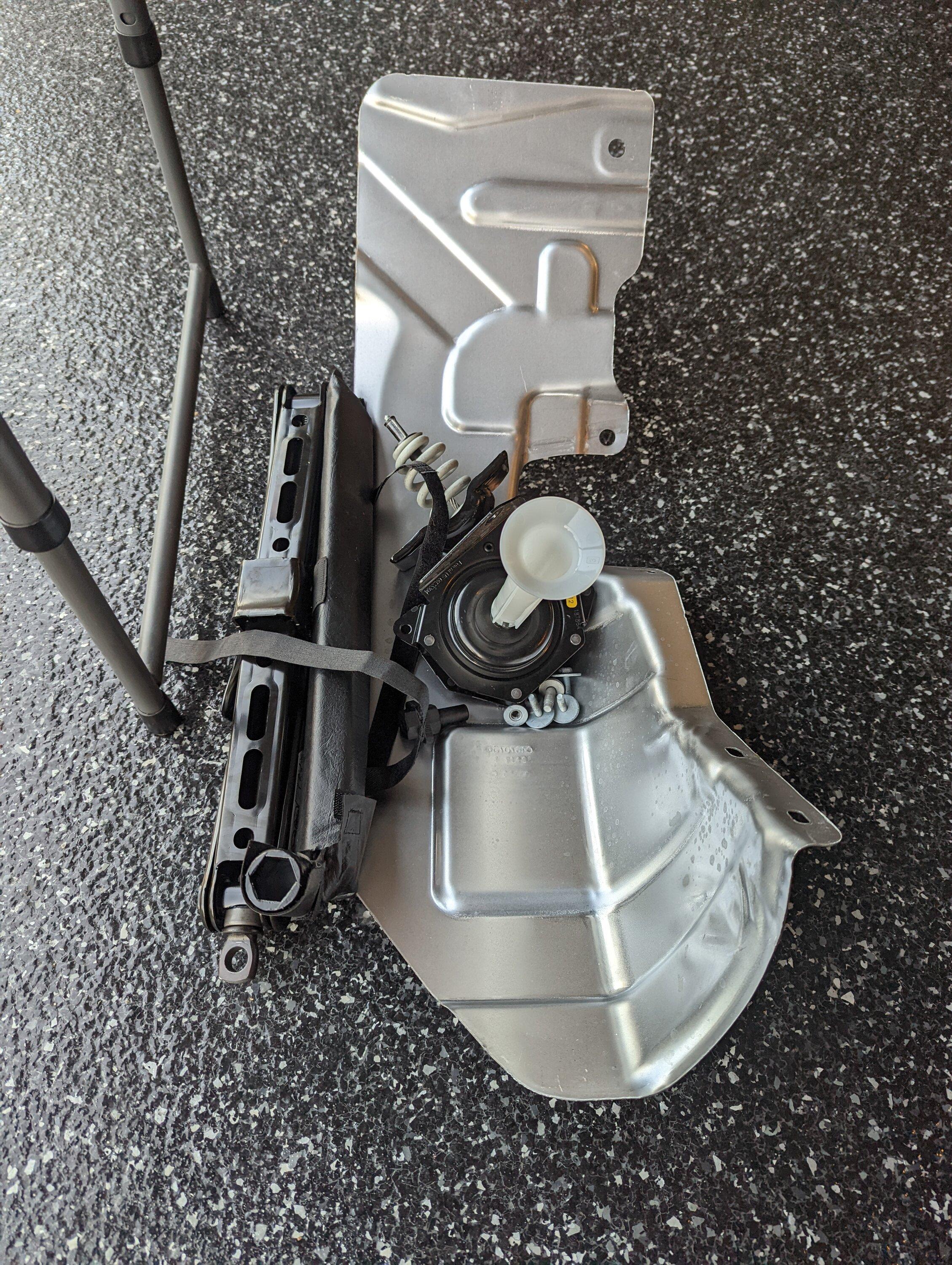

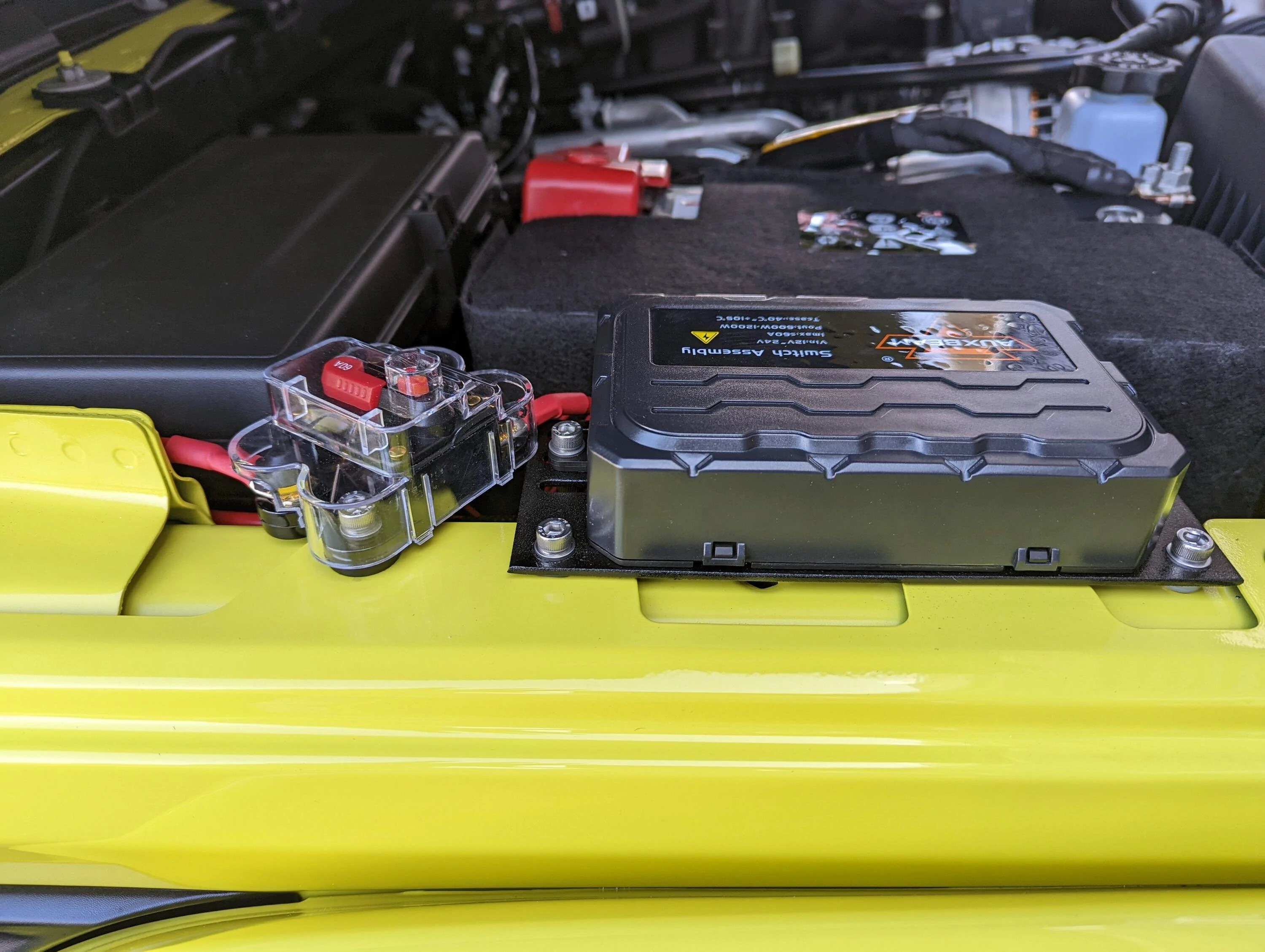

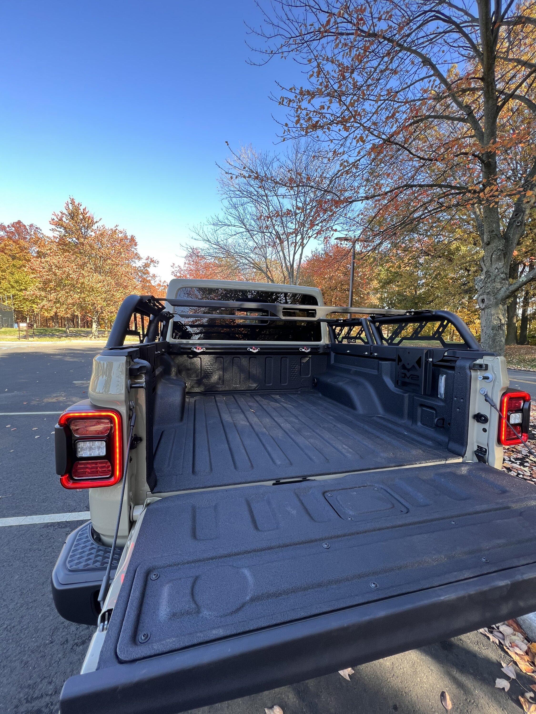

A couple quick things down today.........drop the spare out and took all of this shit out since it's now useless. Dropped 103.5lbs. Yes I weighed it all.
Just waiting on a Mirco2 add a circuit and I can finish this install.

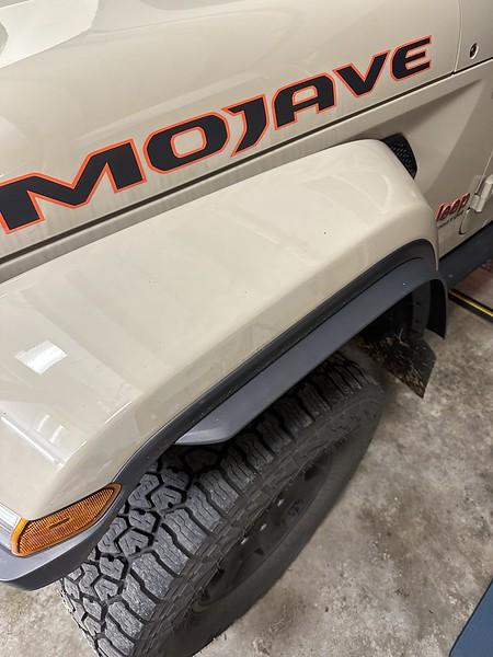

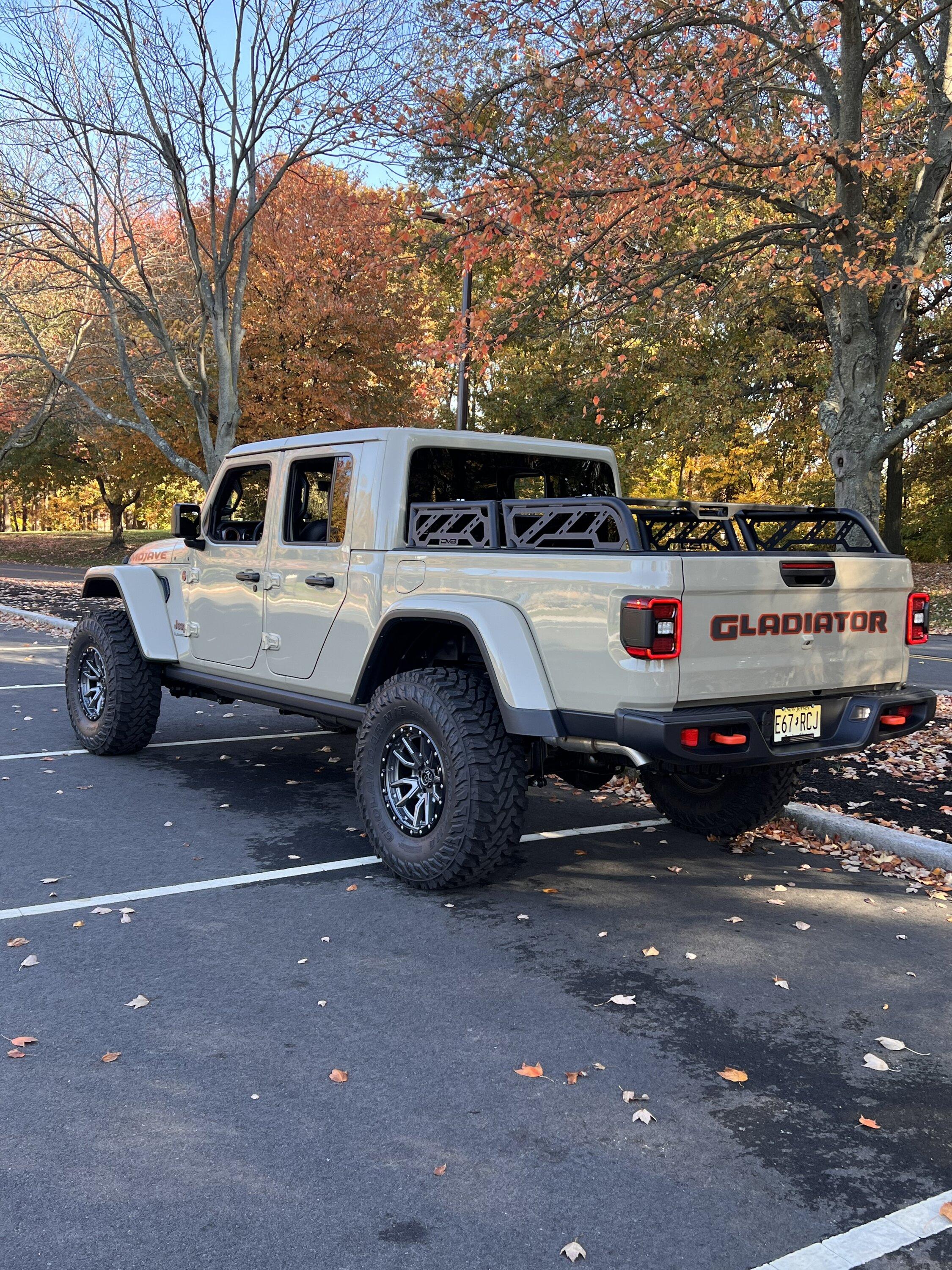

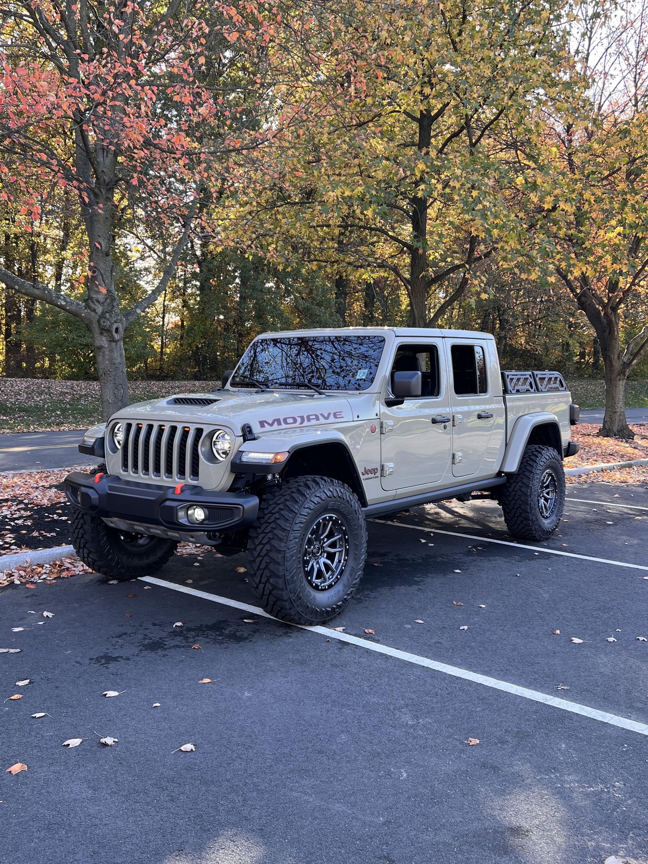

Oil and filter change.
Then installed the recon fender extensions that I had sitting in my garage.

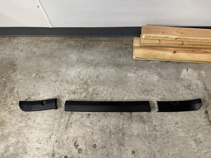

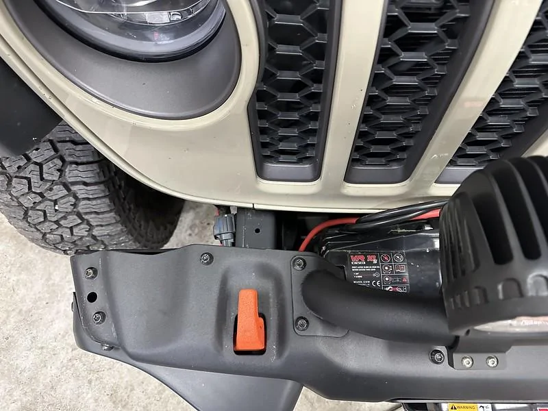

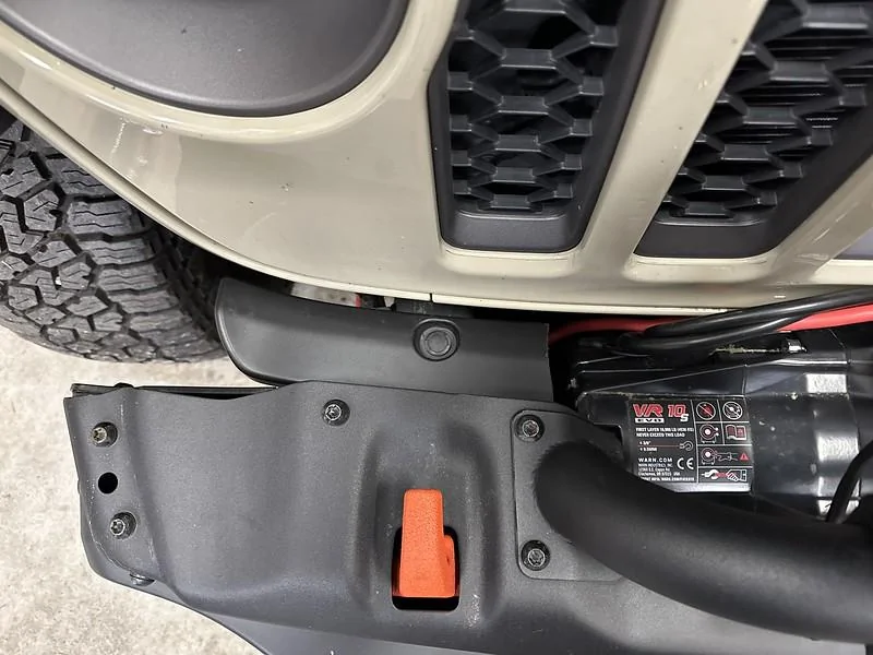

Did an adjustment to the drag link to see if it will correct my steering wheel position, will find out when I get to drive it tmrw.
Also cut up the plastic trim for the metal rubicon bumper, I installed a winch over a year ago and just had this piece sitting on a shelf.

Great idea on replacing the plastic ends after installing a winch. I'm gonna do that today!

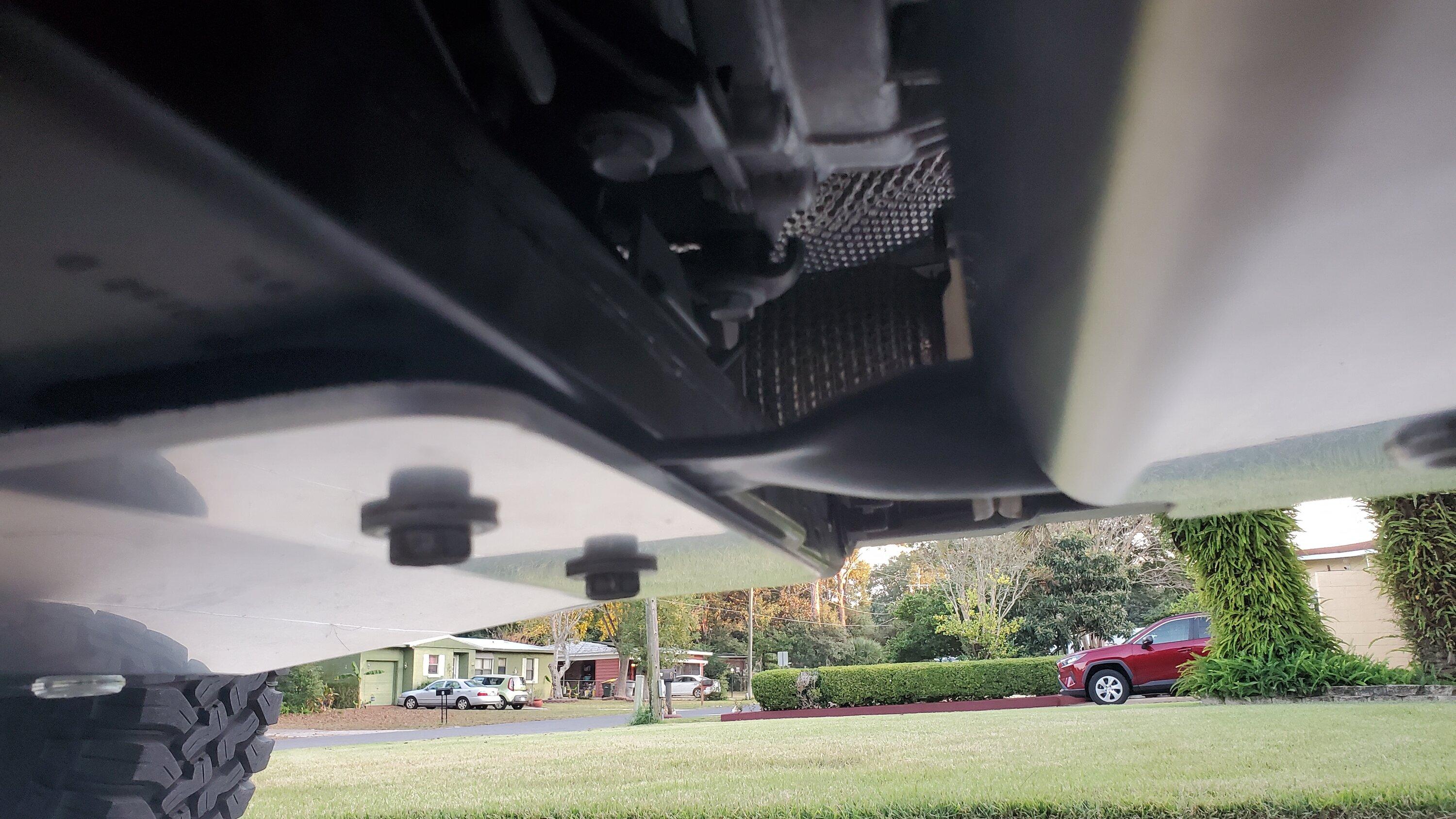

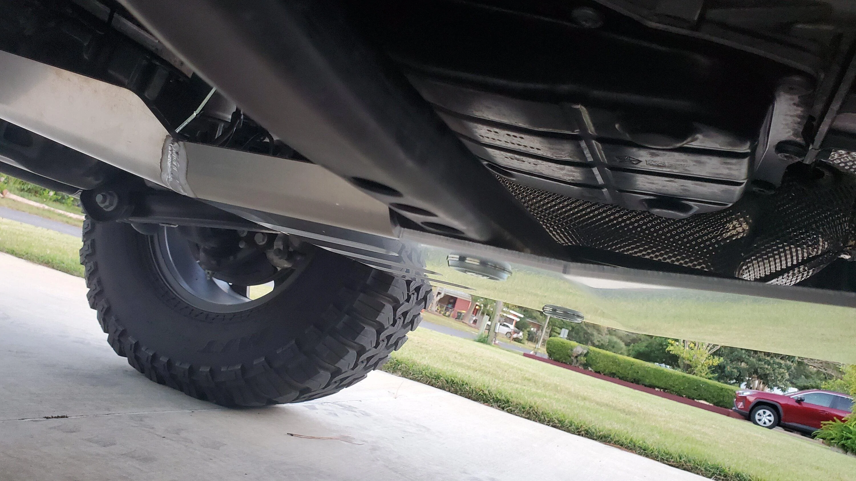

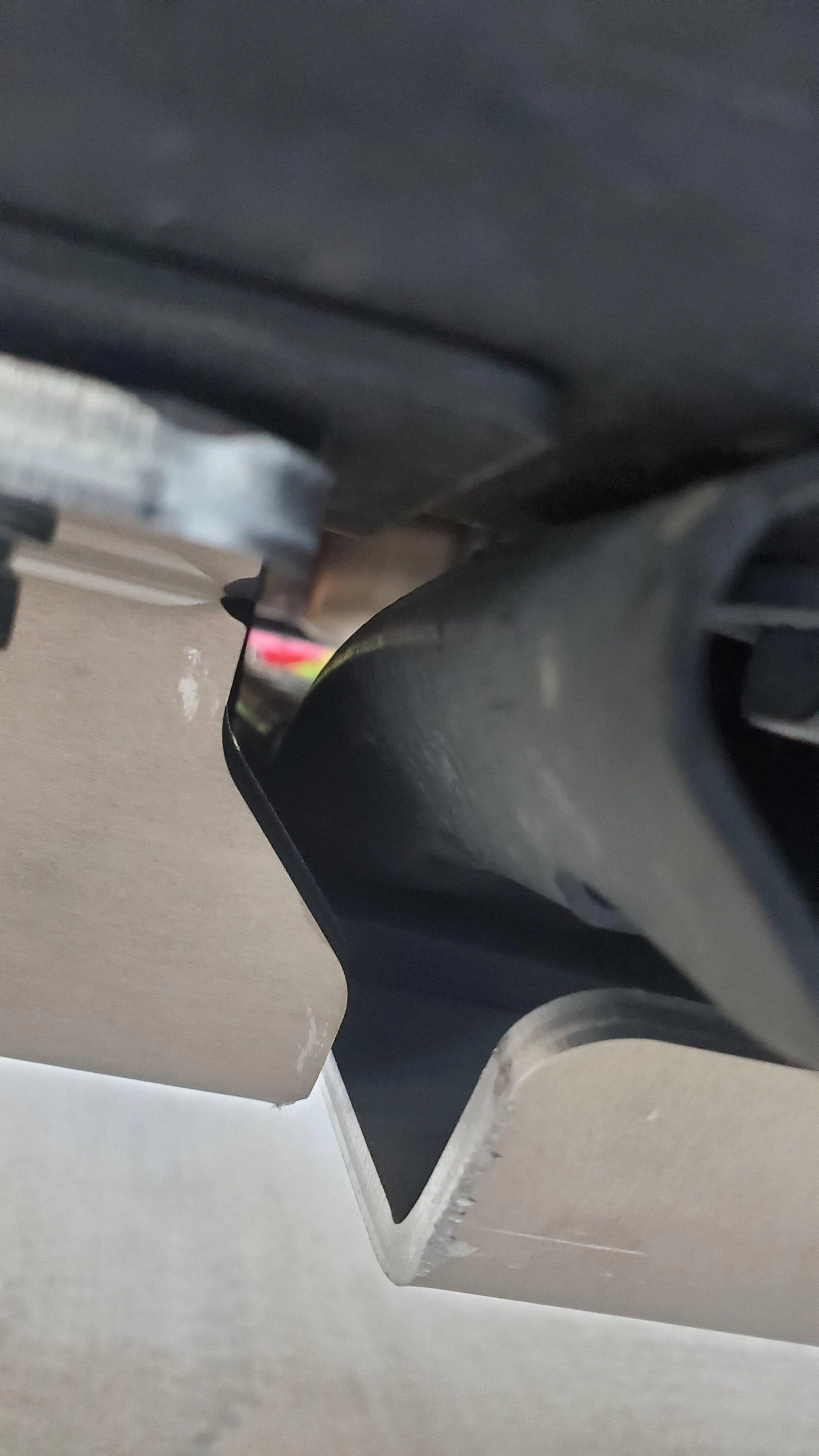

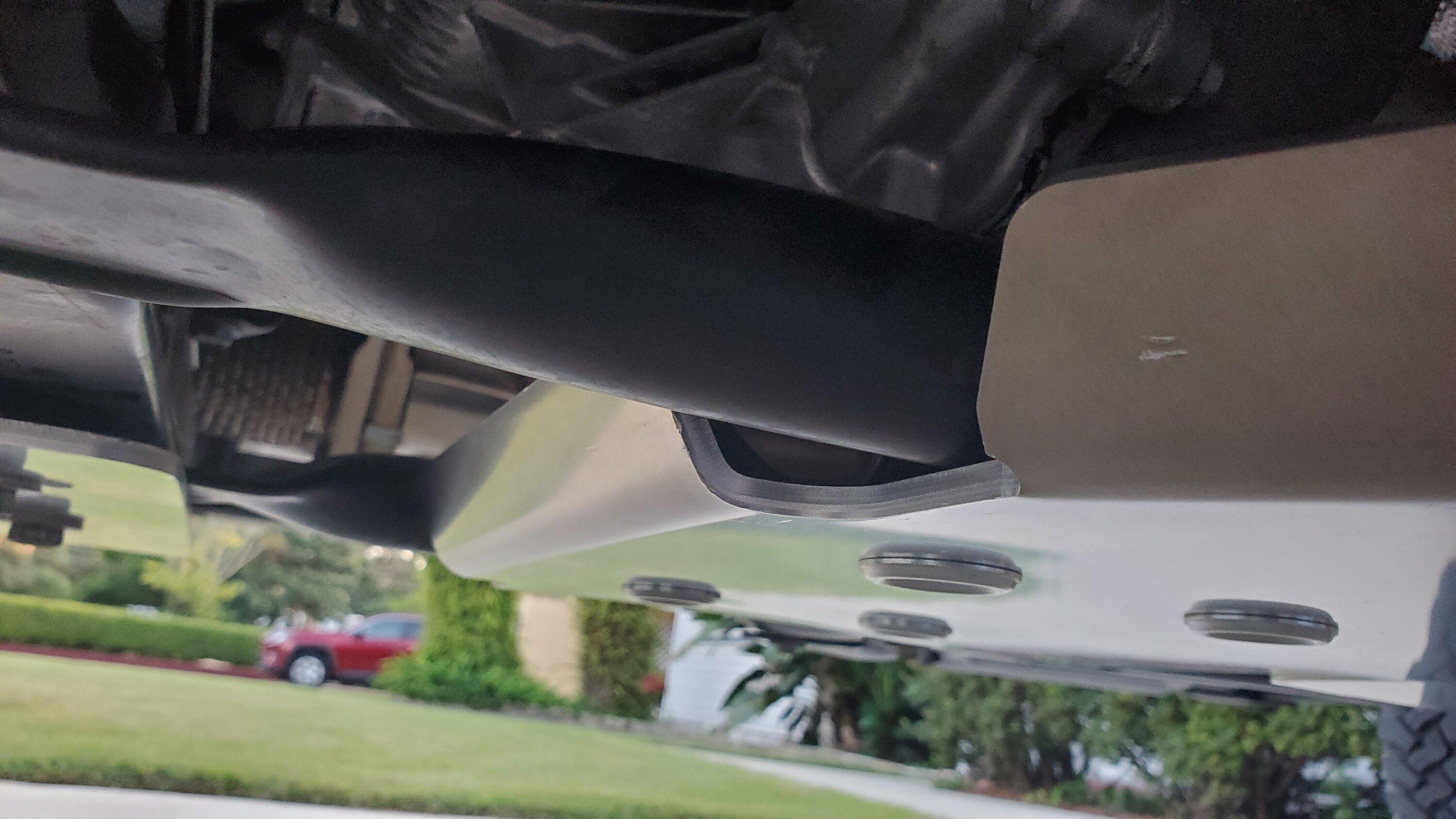

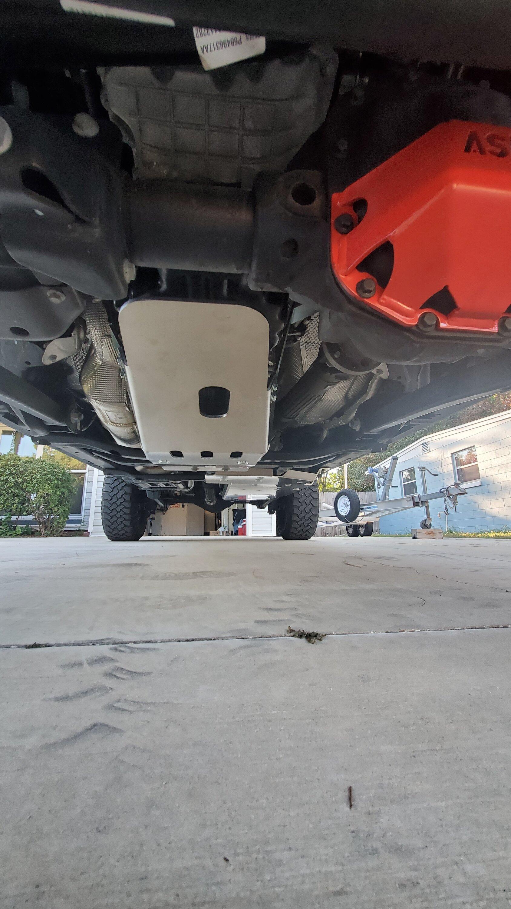

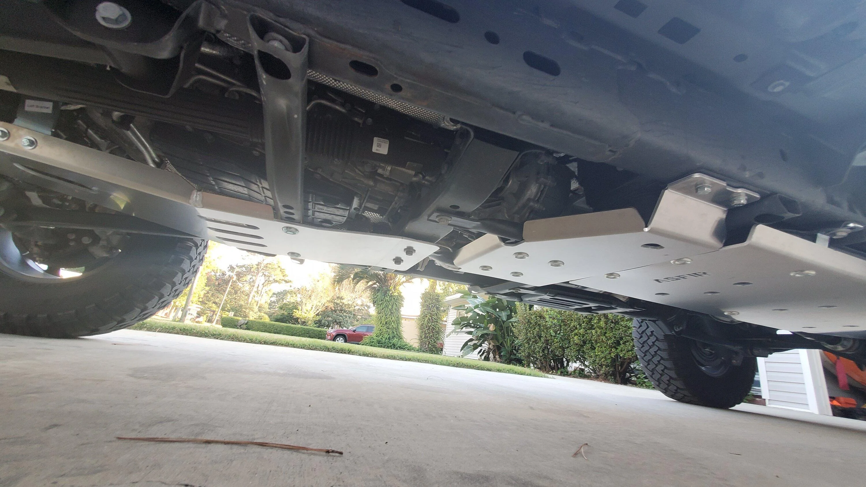

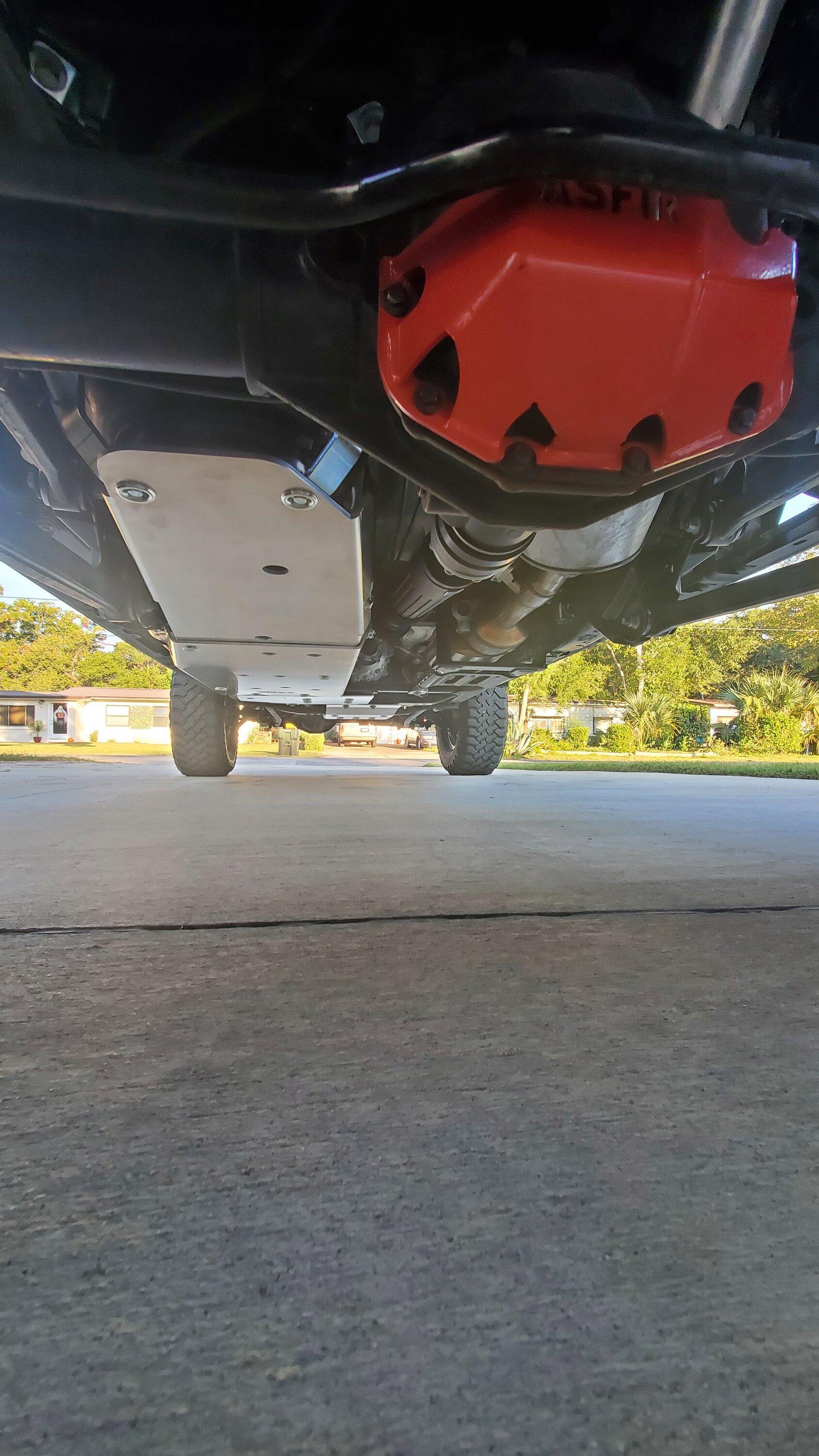

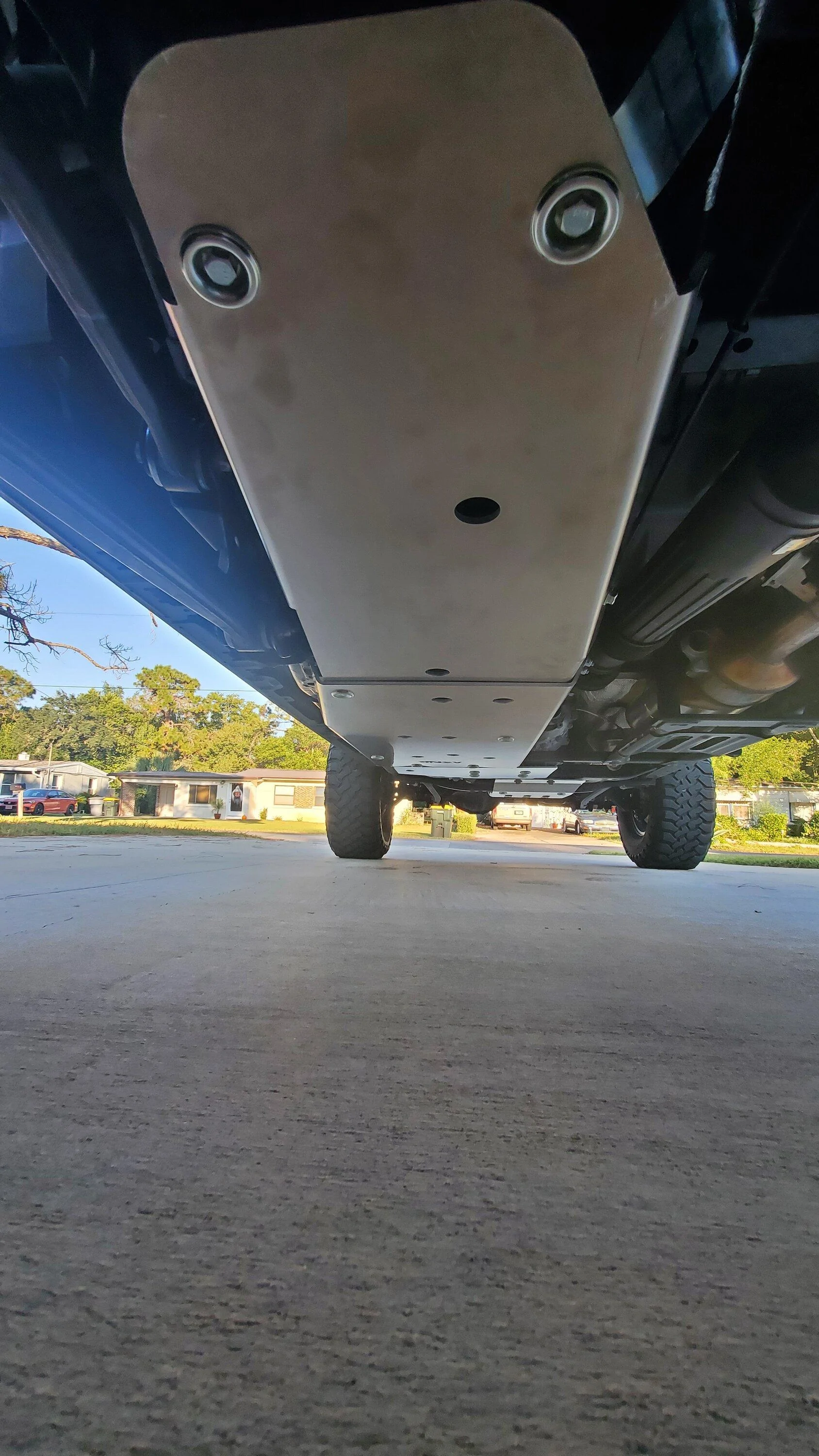

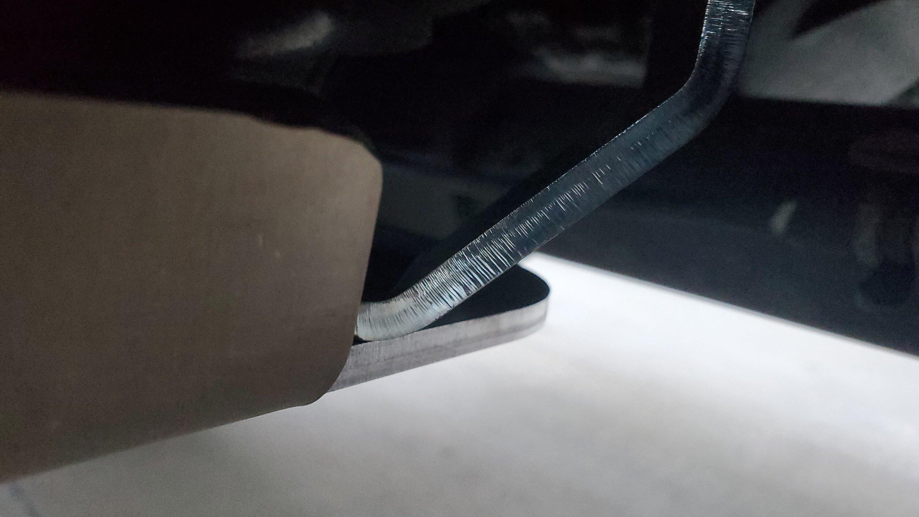

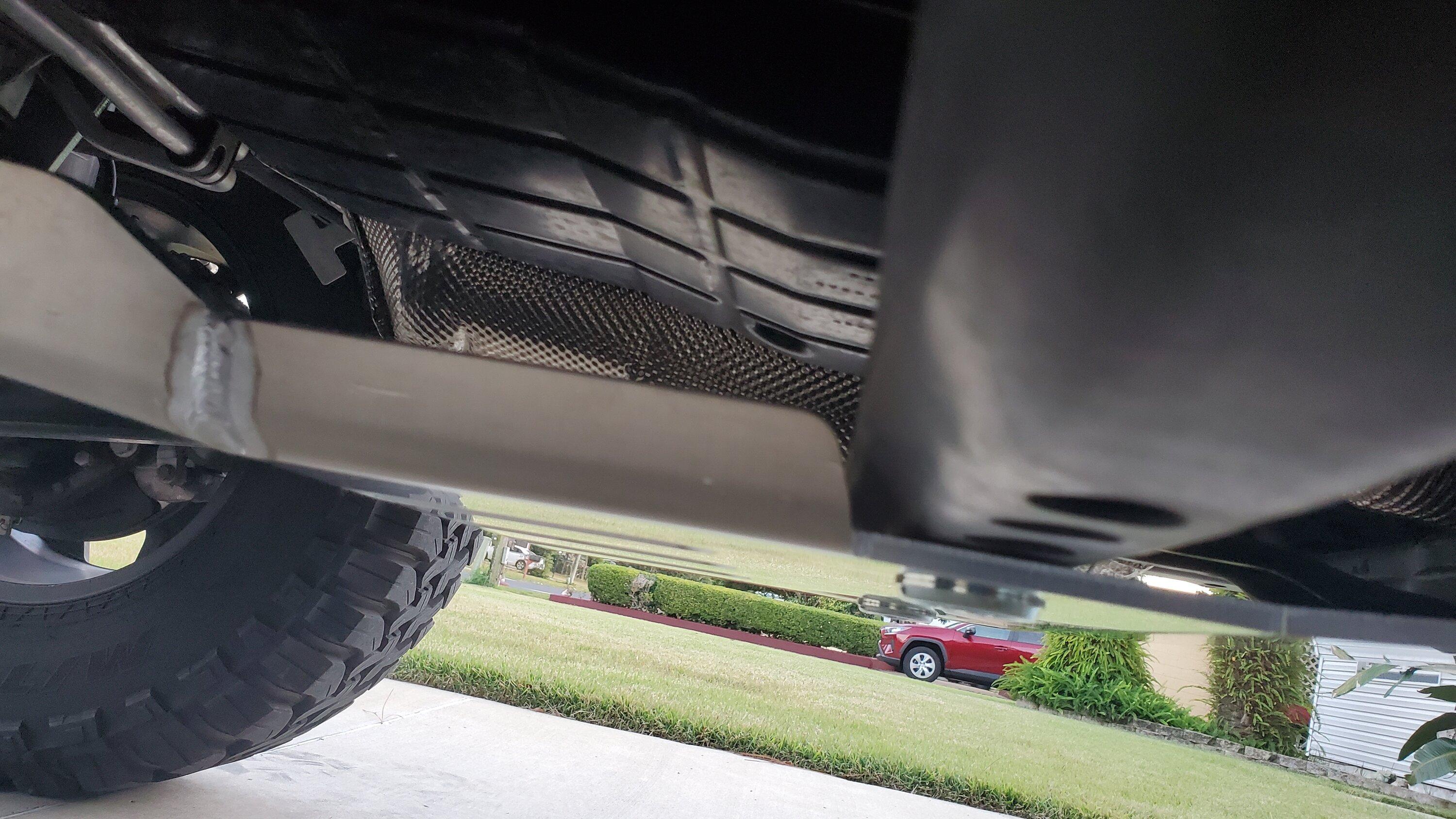

Any idea how much ground clearance is lost? Pretty sure this is on my "needs" list.
It's 1/4" aluminum that bolts directly to the frame at the lowest points, so with the bolt heads, maybe lose 1/2"??

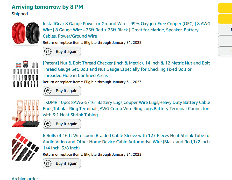

If you're talking about the Voswitch power cables, I'm actually going to be tackling that project myself this weekend, just finished talking to one of the reps via email and they recommended 8 gauge OFC wire with 5/16 terminals to fit the switch. Luckily the original wires are only bolted in, no solder on the main board needed.
Here's what I ordered:

I thought about this too but wasn’t sure how you crimp 8+ga wiring.

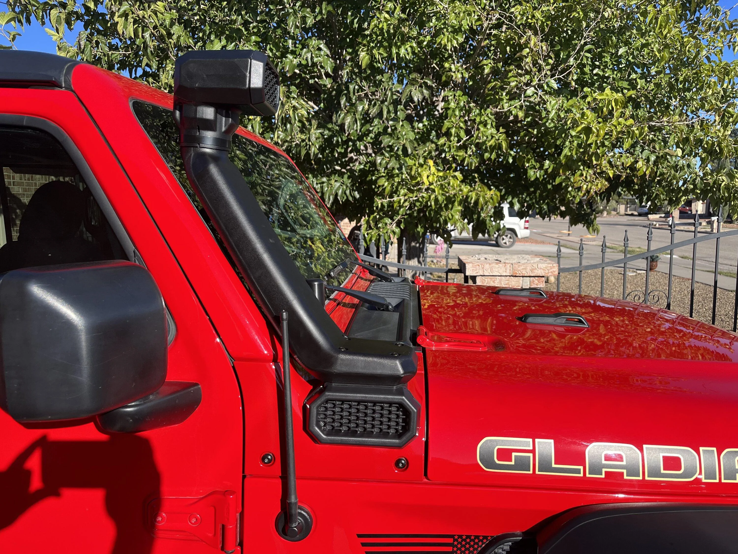

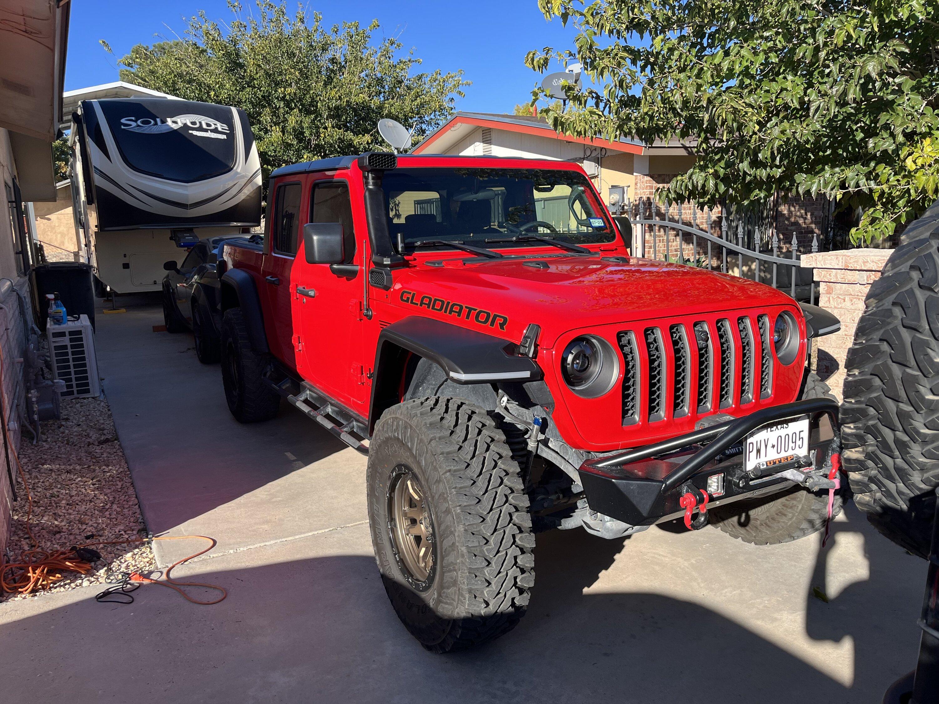

Saw someone selling their RR snorkel for 200 ducks, so I decided to snap it up because I've always liked the look.
Got it painted for another 75 ducks and test fitted it, I dig it!
Jeep Gladiator What did you do TO your Gladiator today? [ADMIN WARNING: NO POLITICS, NO GUN TALK] IMG_5580
Jeep Gladiator What did you do TO your Gladiator today? [ADMIN WARNING: NO POLITICS, NO GUN TALK] IMG_5579.JPG
Now I need to relocate my Voswitch box to the driver side, so that means that I'll also need to move the ARB compressor to just over the fuse box. I don't mind the re-config, I like the look enough to go through with it.

You'll need a hydraulic crimping tool, just search 8 gauge hydraulic crimp tool, there's a ton of options.

This is the correct way to crimp those lugs, but if your limited on funds to buy such fancy tools you can use a square head bit with channel lock pliers like I use. Makes a solid crimp even with 2gauge and 1/2” lugs for free. Just sayin
