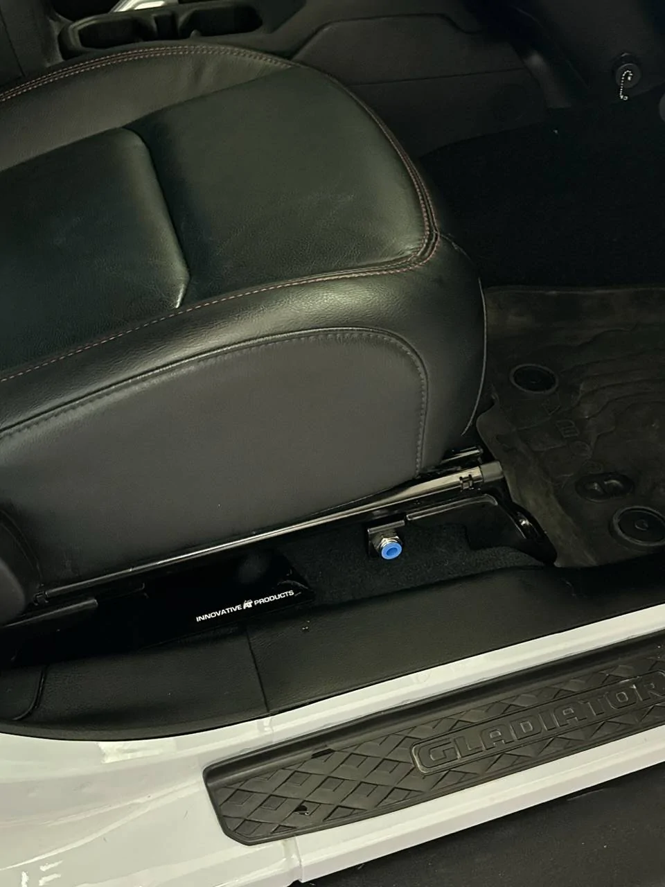

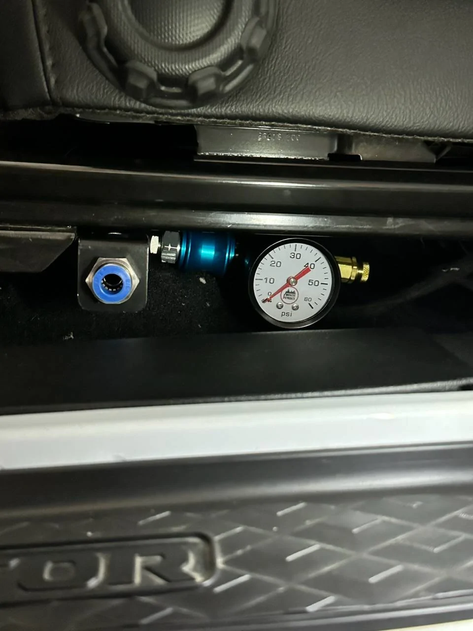

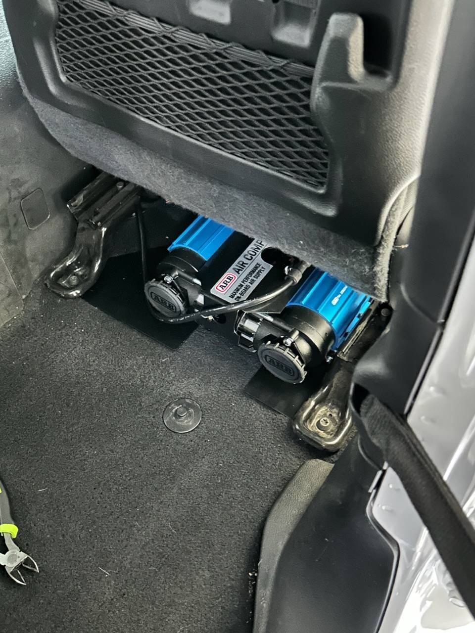

On board air. Picked up this kit from Innovative AT Products. Owner was very responsive on Instagram to a few questions I had. Now I need to figure out if ArmorLite is still an option or not.
Also replaced the original battery with a DieHard and bypassed the Aux battery.
Armorlite is an option. I mounted the same Innovative AT dual compressor mount at the same time as my armorlite, and it fit fine. However, if you ran the power cables through your front or rear drain passenger side drain, you will have trouble fastening down the armorlite drain plug. When the weather is better this spring, I will rerun the cables.

Yeah, I went with the drain plug underneath the passenger seat. I wanted to try going under the cowl and through the space behind the windshield frame and run it under the passenger side floor panel but the ARB harness wasn’t long enough for that.

I did the same. I think the solution is step bit on a drill, some paint and a new grommet. I can't reach up high enough while laying on my driveway so I will get it done on someone's lift.
