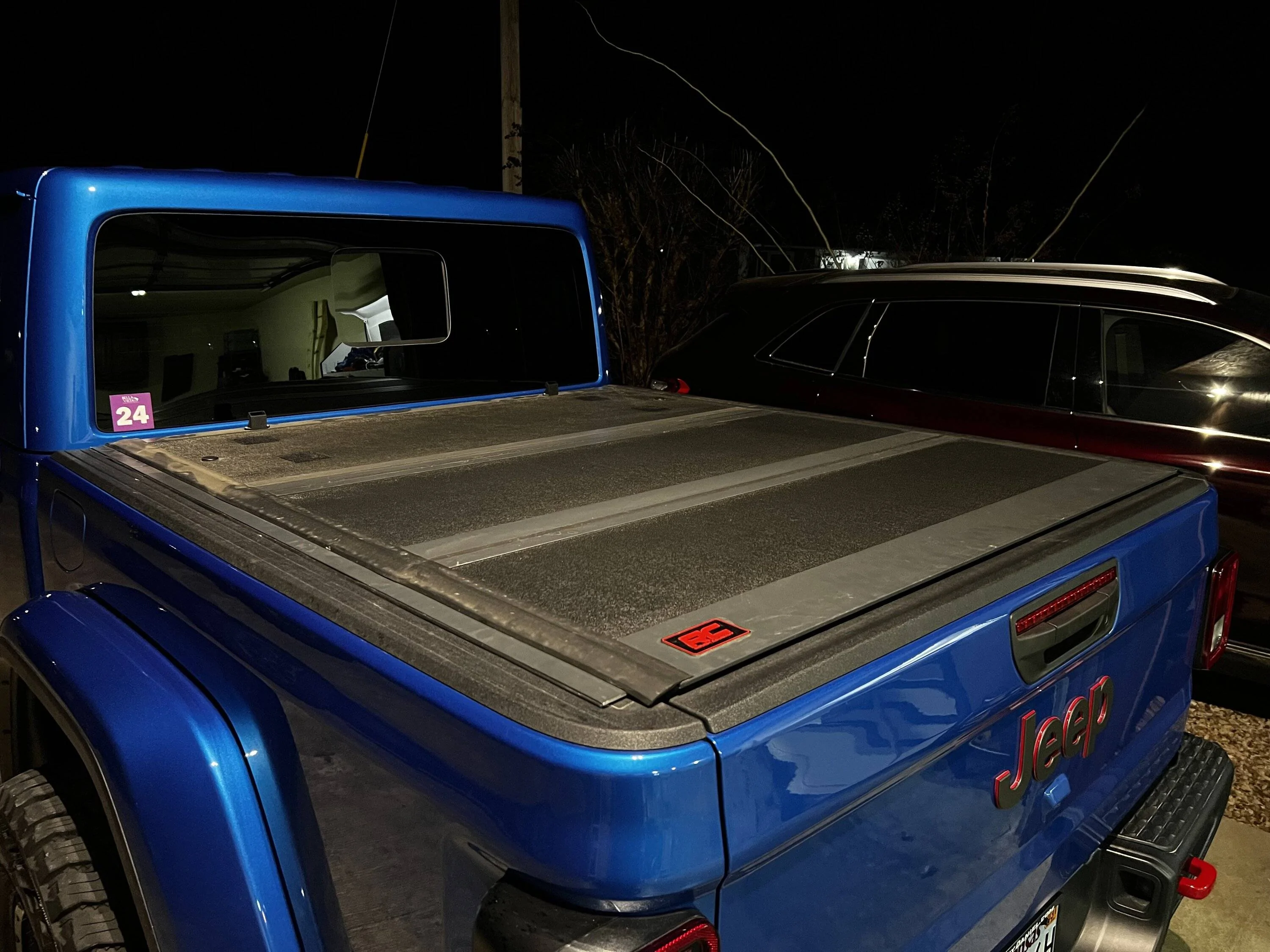

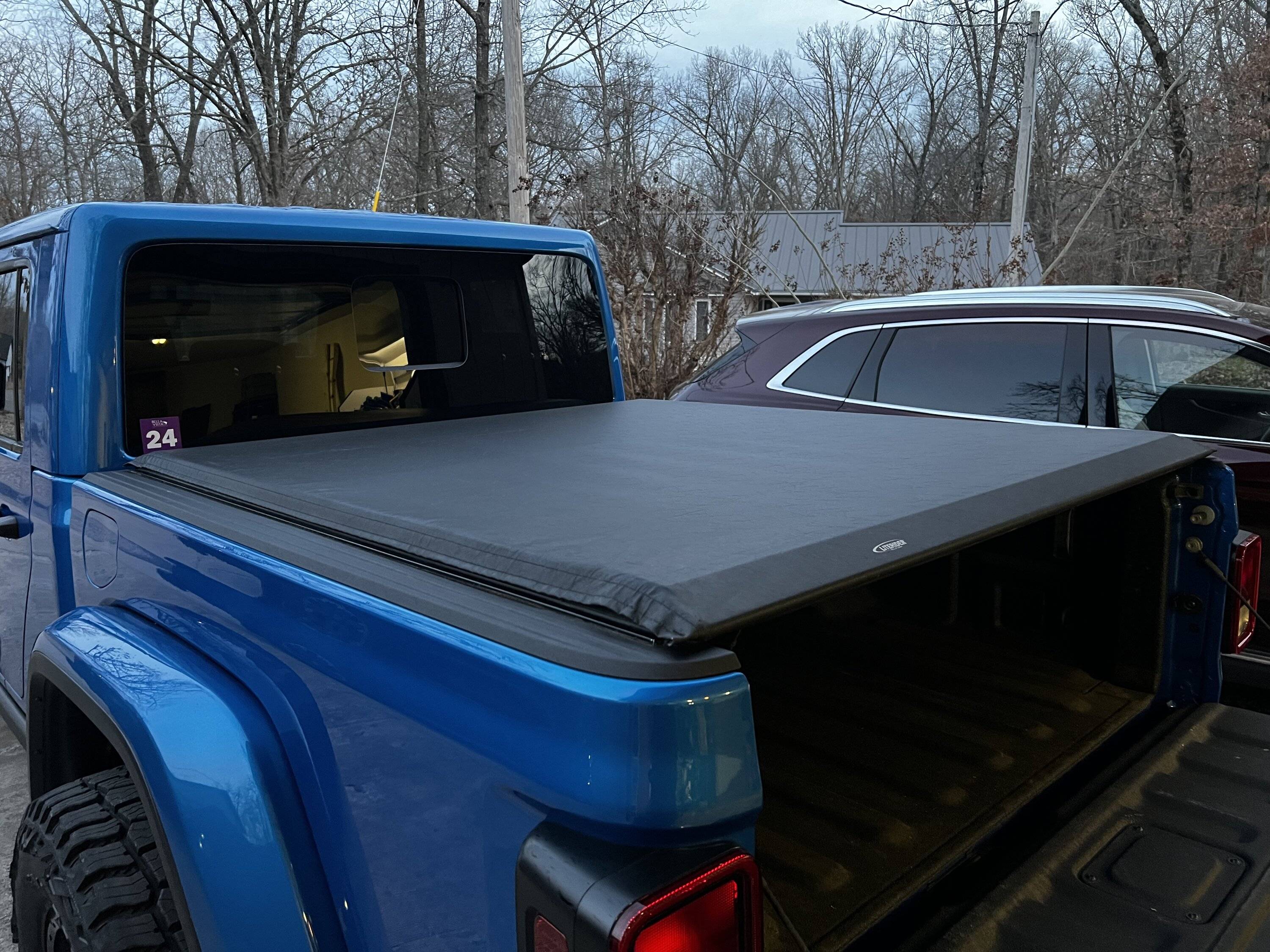

I swapped out a soft rollup tonneau for a hard tri fold. Not a big thing but I’ve always preferred the tri folds….and it was free so winner winner!

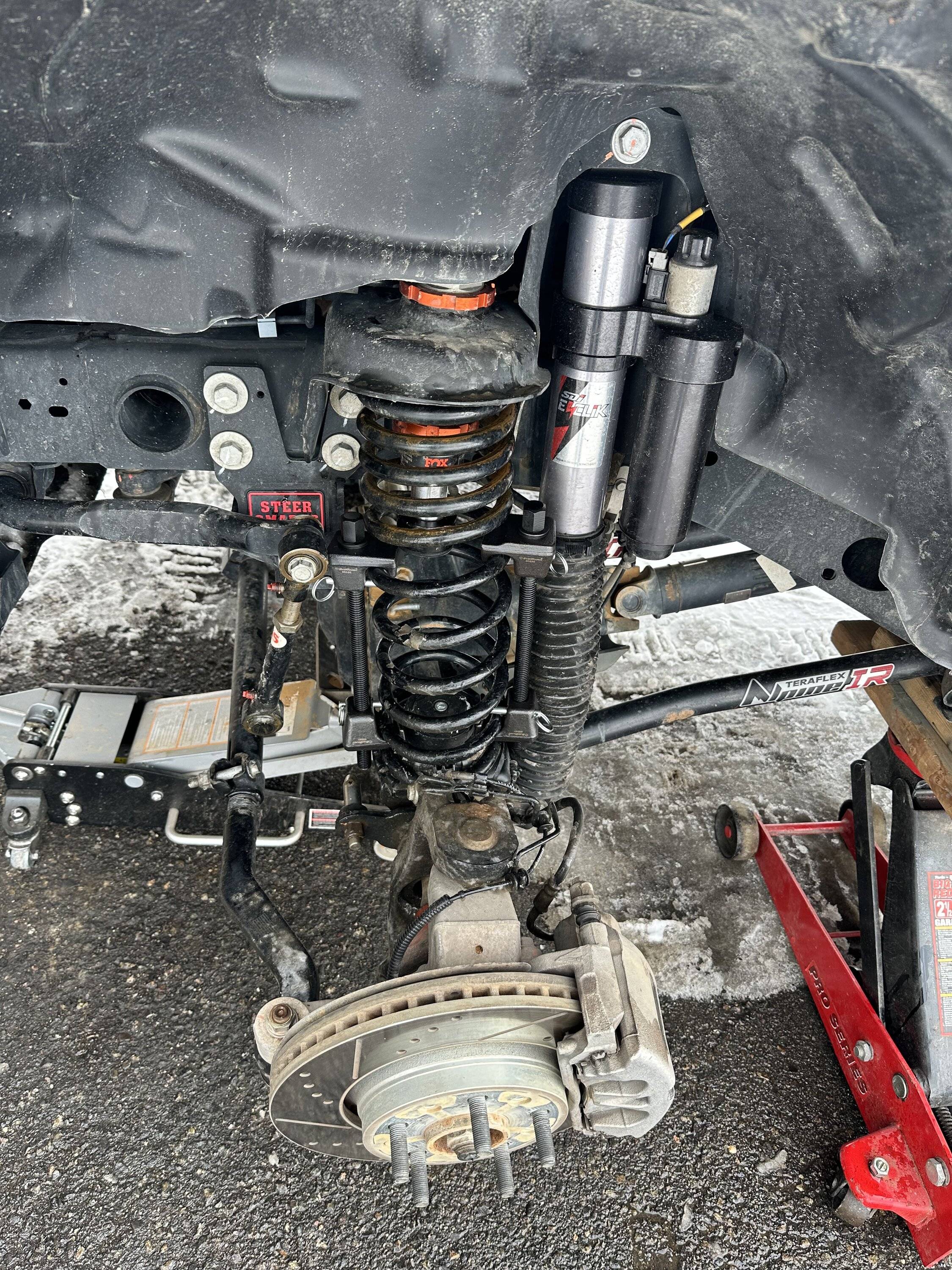

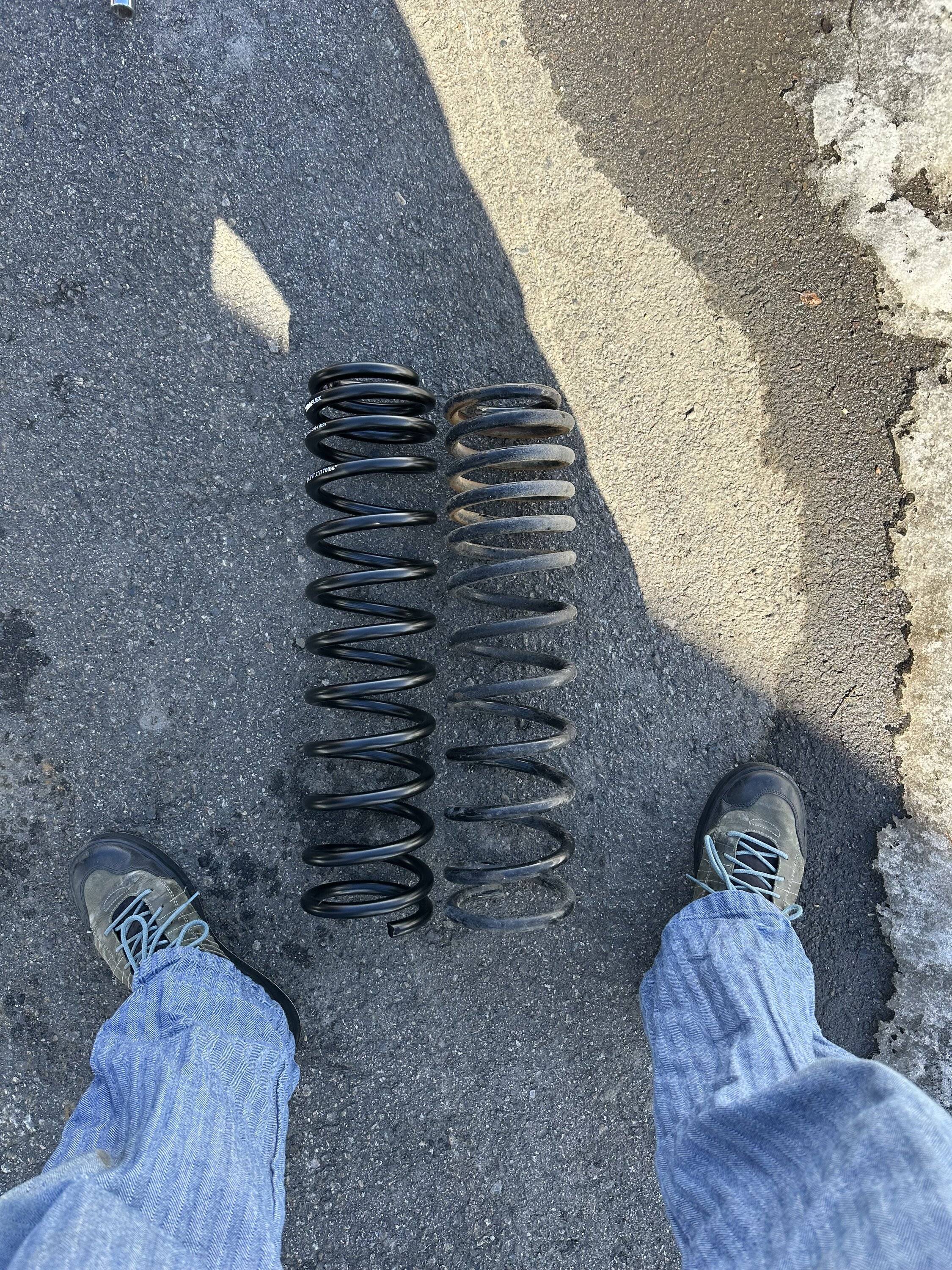

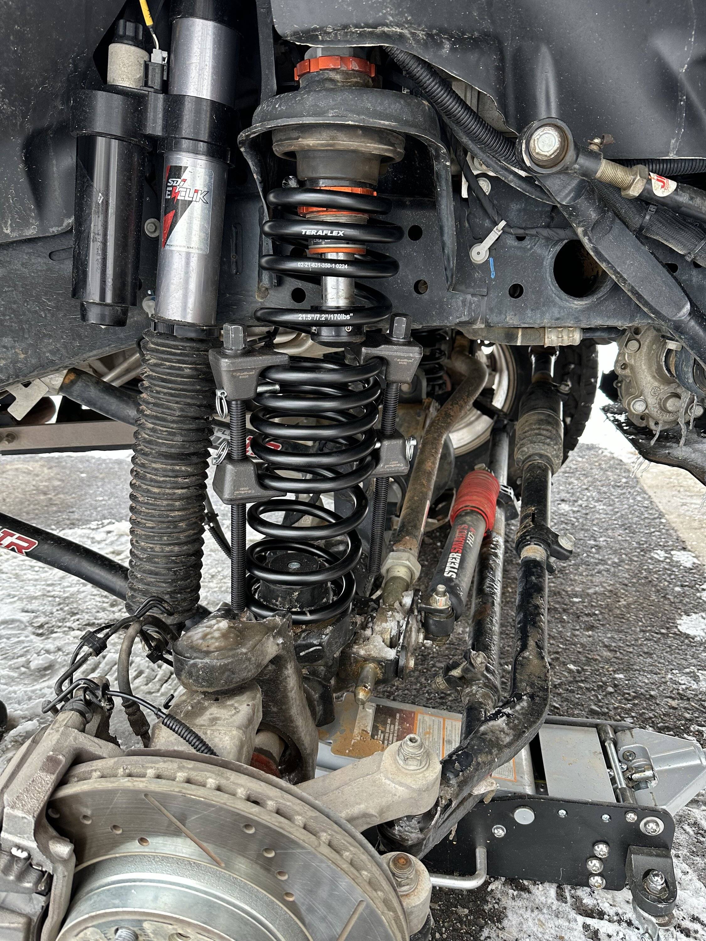

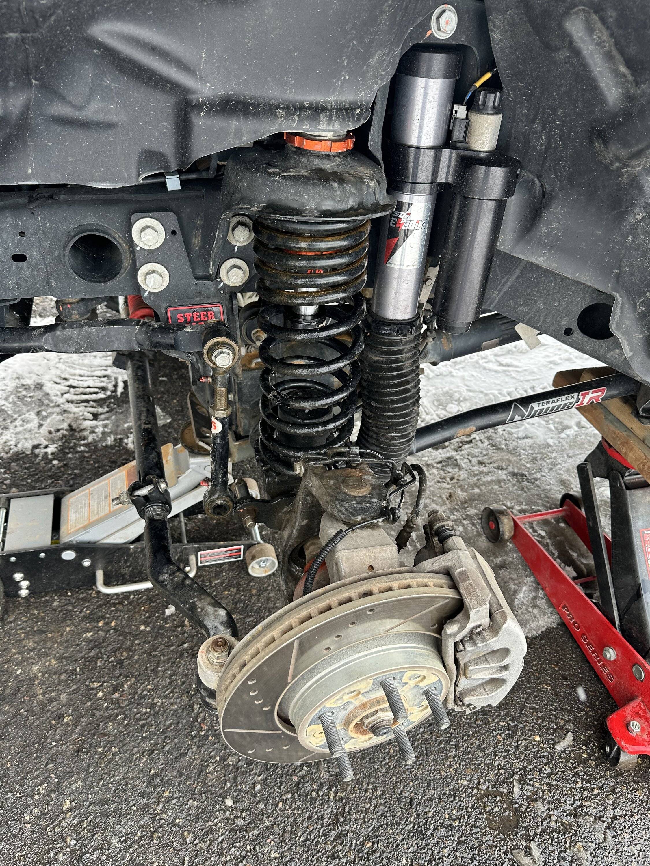

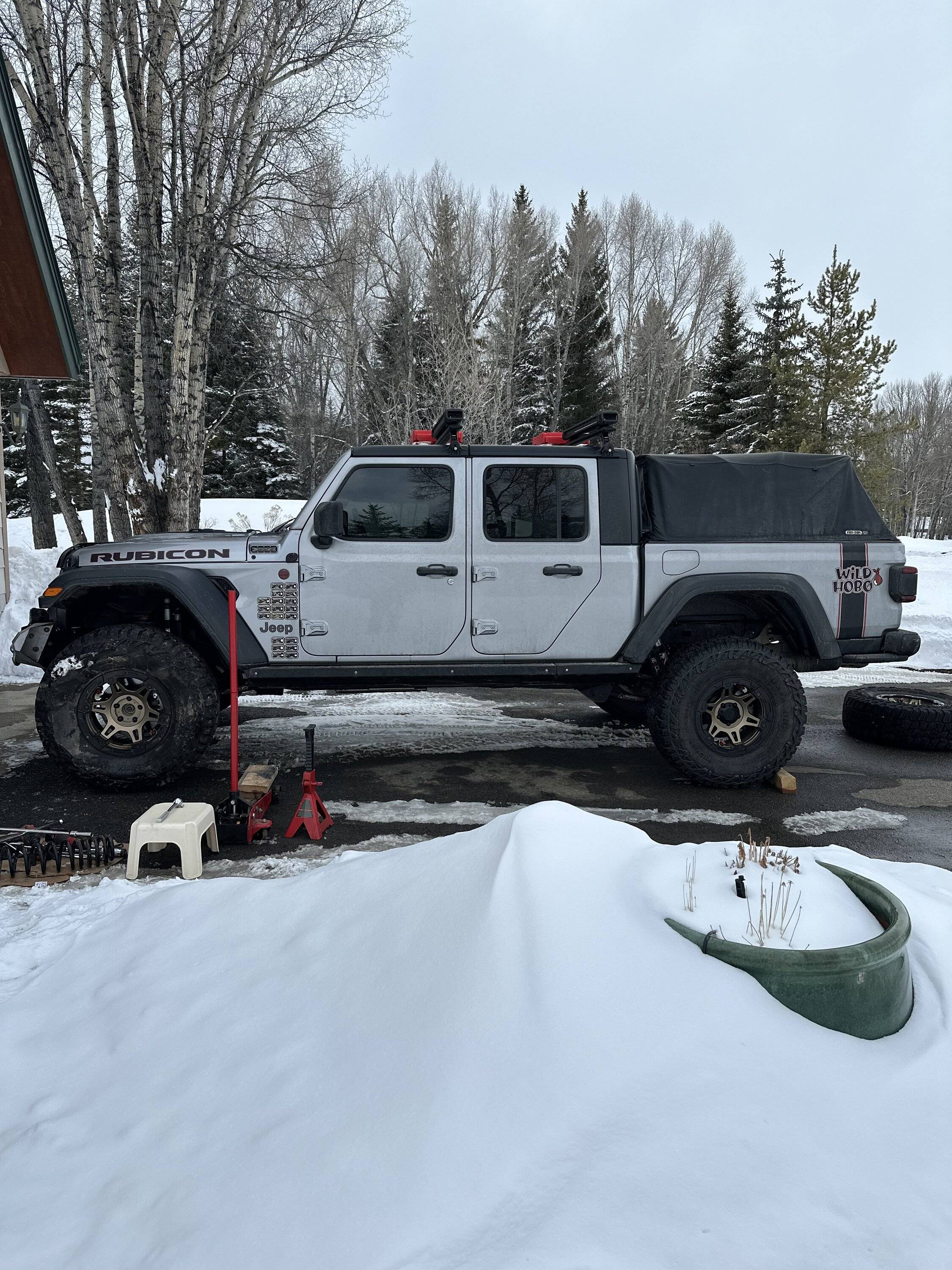

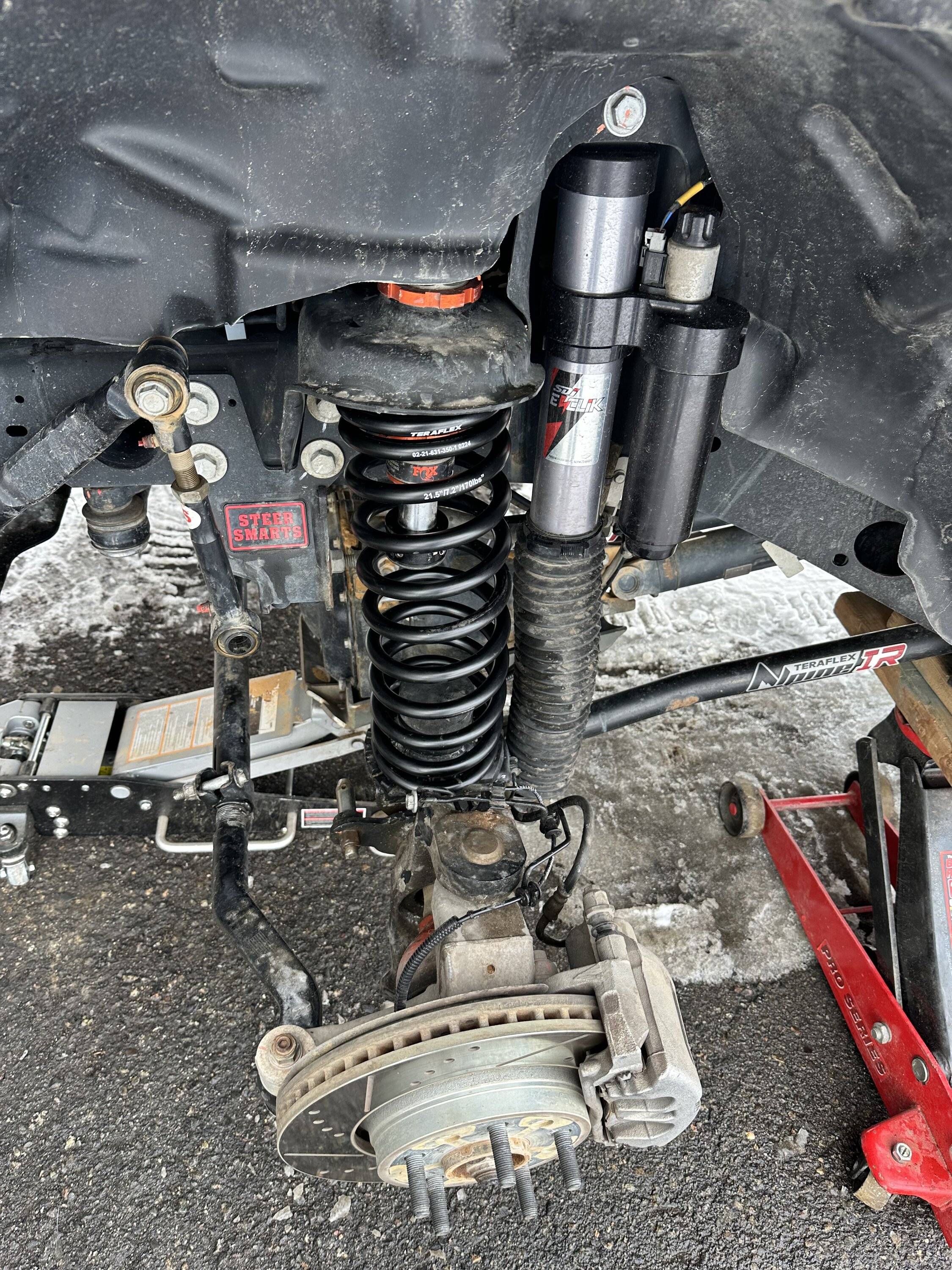

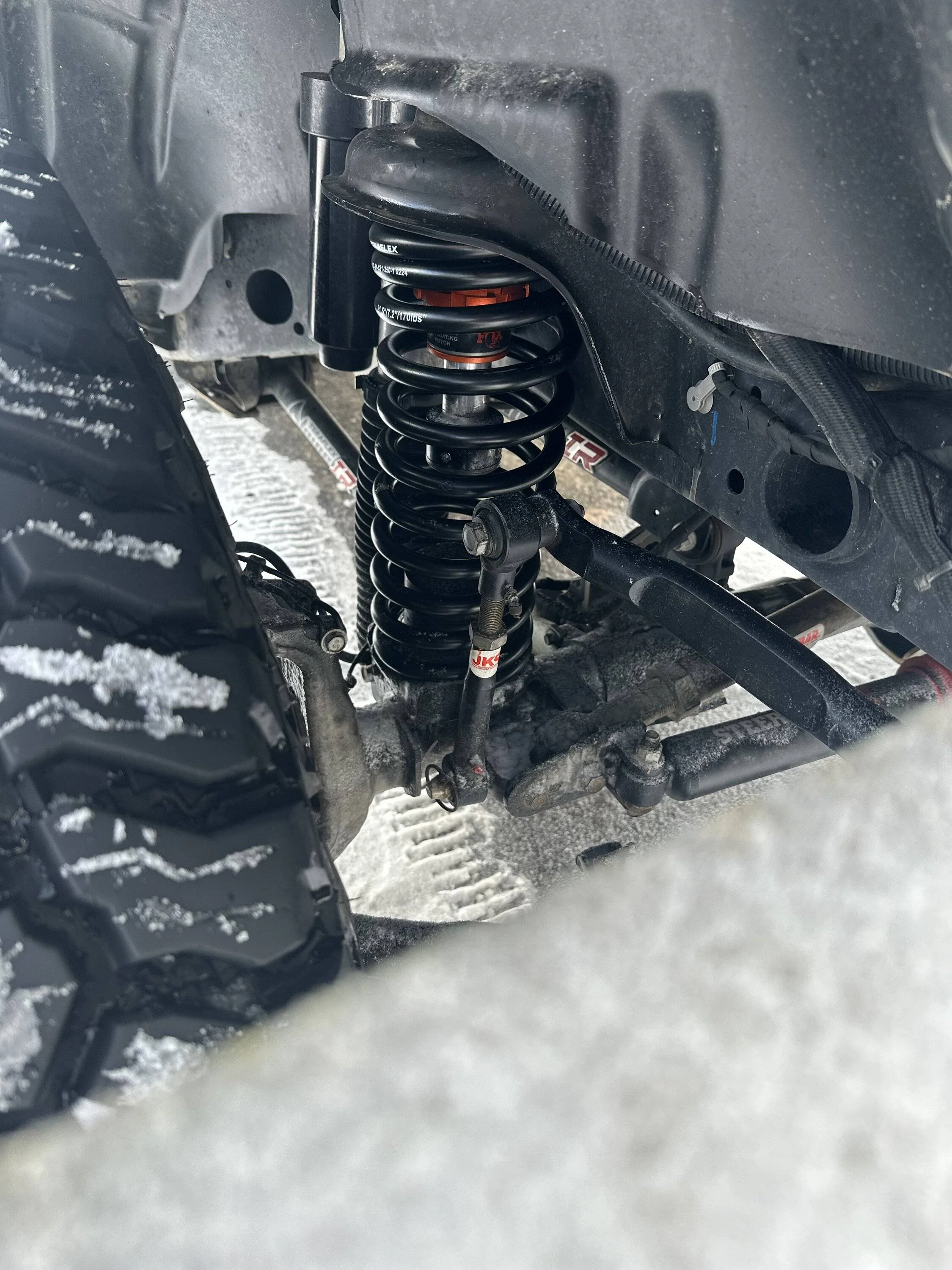

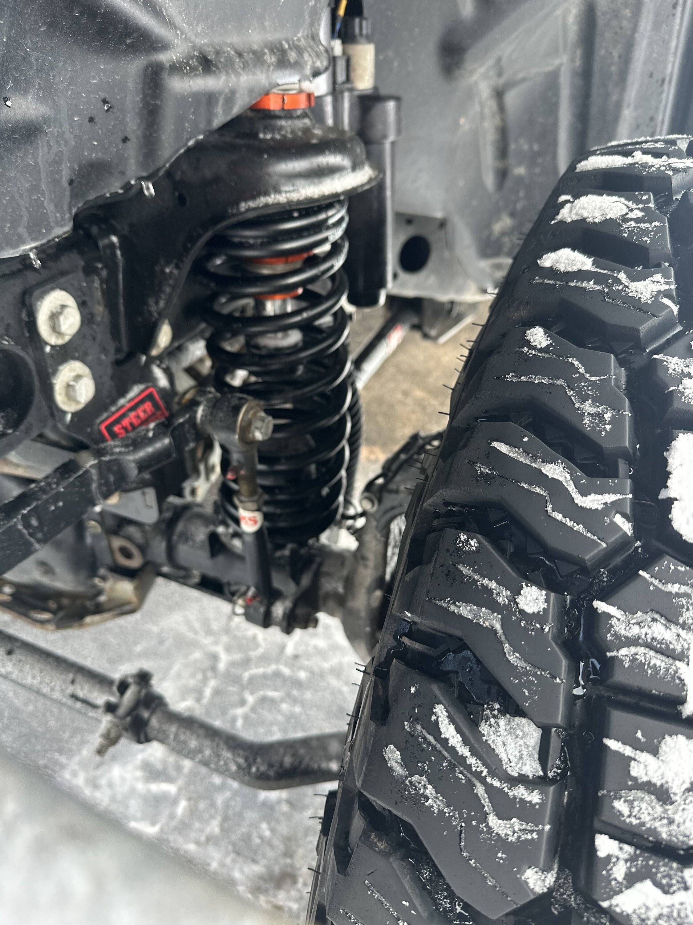

I swapped out the JKS 3” lift springs for Teraflex 3.5” HD (Outback) springs. I left the 1/2” spacer that was already installed. Spring compressors made this pretty easy. I was able to start and finish in 3 hours. I adjusted the drag link for the few degrees the wheel was off center. It’s clear that the old springs weren’t handling the weight added when I modified the bumper, and the heavier winch added last year. It was obvious when I realized it added just over 2” between the tire and fender flare.
I’ll need to lengthen the front control arms a hair to move the axle back forward a bit. But it was fine to finish for the day. It drives fine and tracks straight. I’m sure the track bar needs a tiny amount of lengthening, but I’ll do that and the control arms another day. The axle is not noticeably off center, but I’m sure it’s a 1/2” off or so. Sitting on the ground the springs aren’t that much longer, but they support the weight better.
The first two pictures are of the old springs, prior to and during removal.
If organic, free range, and cooked with some imagination, I’ll happily eat some crow meat for @Jems007. I initially resisted his suggestion that my front springs weren’t cutting the mustard anymore. He was correct
I believe JKS are some of the softest springs available.

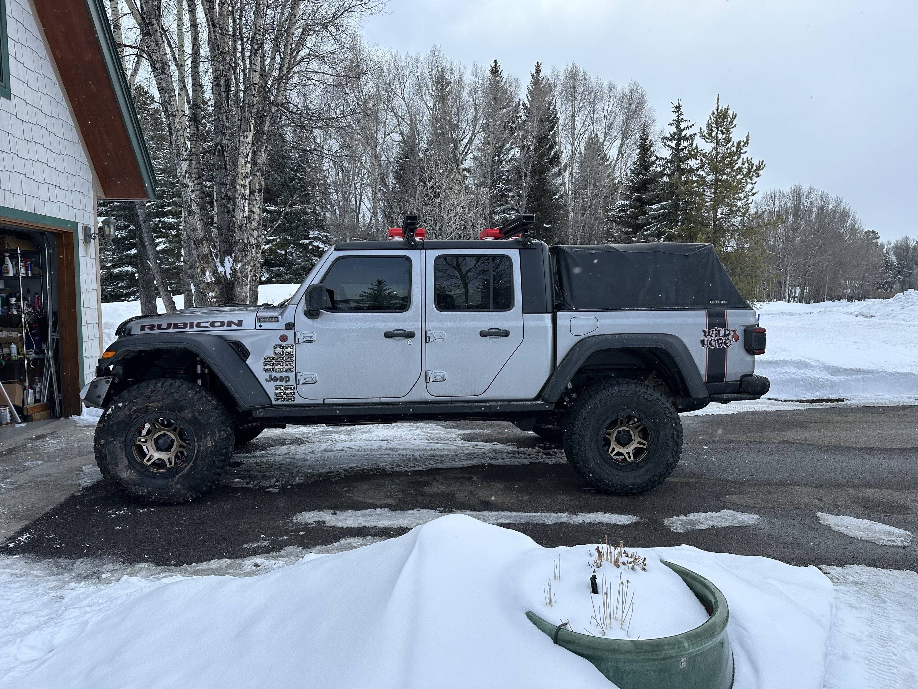

I realized I didn’t take any pictures of the springs with it back together. I also measured axle centering today, granted not on perfectly level ground, but pretty close. It was within 1/16” between the sides. So it must have been off before. Hilarious that I might have adjusted the axle position for the better with different springs.
