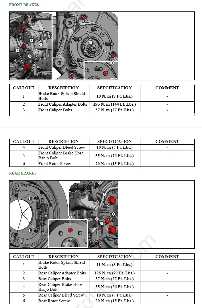

Welp, I broke it :headbang:
Was going to pick up a friend from the airport in stop n go rush hour, started feeling some shuddering. Road didn’t seem that bumpy? When I started driving again shuddering got instantly worse then passenger rear wheel locked up.
Luckily I was right in front of an exit median so got another ten feet forward dragging the tire.
When I looked underneath, I saw the bottom caliper bolt had come out, and the caliper pivoted down and got wedged by the rotation of the wheel.
Shifted the dust shield forward. Can’t tell if it bent the hub. Ground a groove into the inside of the wheel.
did you know front sway bar bolts are same thread?
I still had my old ones sitting in my toolbox, so I was able to make a quick “trail” repair so I could at least get off the highway.
Could hear on and off grinding and my tire slowly lost pressure.
want to guess what all will be broken? Just a bent brake caliper + I’m guessing the wheels since it’s leaking. Will the hub be bent? Will the whole axle be bent/trashed?
Front - 144 (21mm socket)
Rear - 92 (18mm socket)
NAH that only got the wheel. Had a guy in his EVO 9 lose a caliper bolt. ate right through his Advan GT wheels. split it clean in half. but the rest of the car was fine. no bent spindle, busted, or snapped CV. So I imagine your solid axle is A ok.
