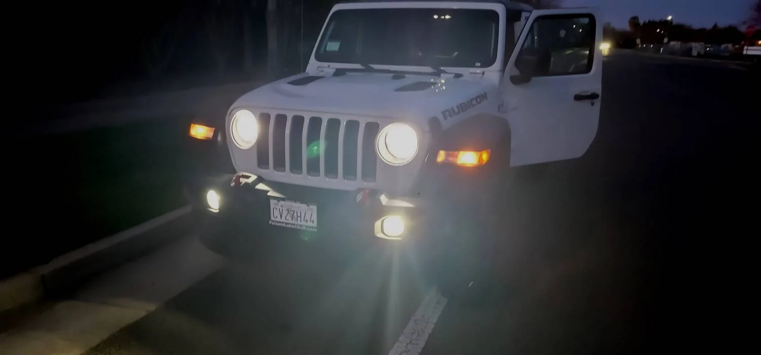

Took mine to a local Jeep shop and had them replace the halogen with LED bulbs
For headlights, I went with this.
https://www.auxito.com/collections/...icon~ml_High Beam and Low Beam - Off-road Use
For fogs, went with this (several folks here are running this as well!):
https://www.amazon.com/dp/B01A1YU2TS?psc=1&ref=ppx_yo2ov_dt_b_product_details
Fairy cheap mods but made a night/day difference in lighting (no pun intended!). Drove around at dusk in my neighborhood and its SO much better than the stock halogens. The cutoff is about the same as oem but much more brighter and cleaner and has a wider coverage. I might run this till the bulbs die out, etc and then do a full headlight swap but for now, these will suffice (very happy with the outcome!). No flickering and literally plug-n-play. Works with 'start/stop' as well (I ran some cheap LED bulbs on my now-traded Ford Ranger and they wouldn't fire 100% when the start/stop feature kicked in).

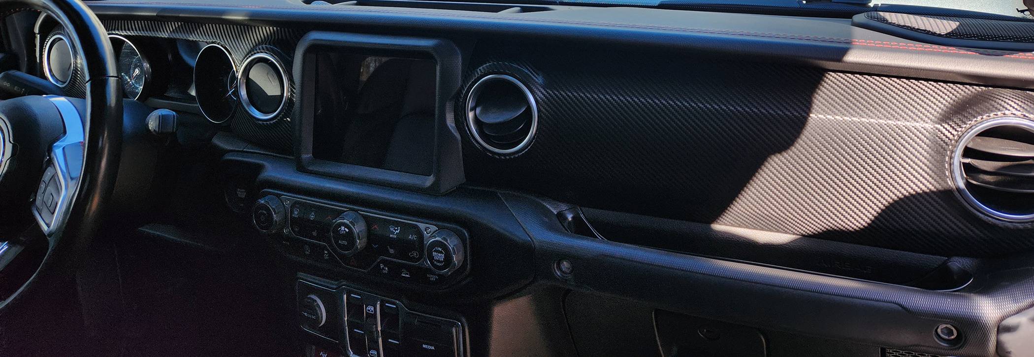

Wrapped my dash panels. This should be a factory option IMO.
Any concerns about the airbag deployment being affected by the wrap?
(Yes the flaps open right along the center of the panel).

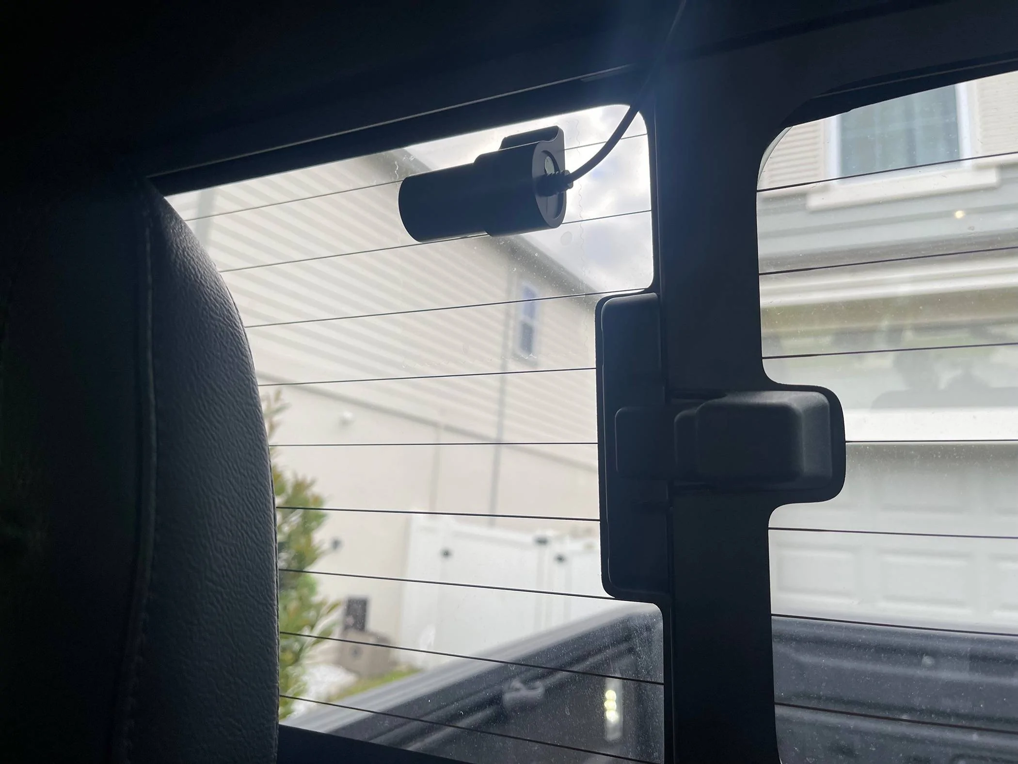

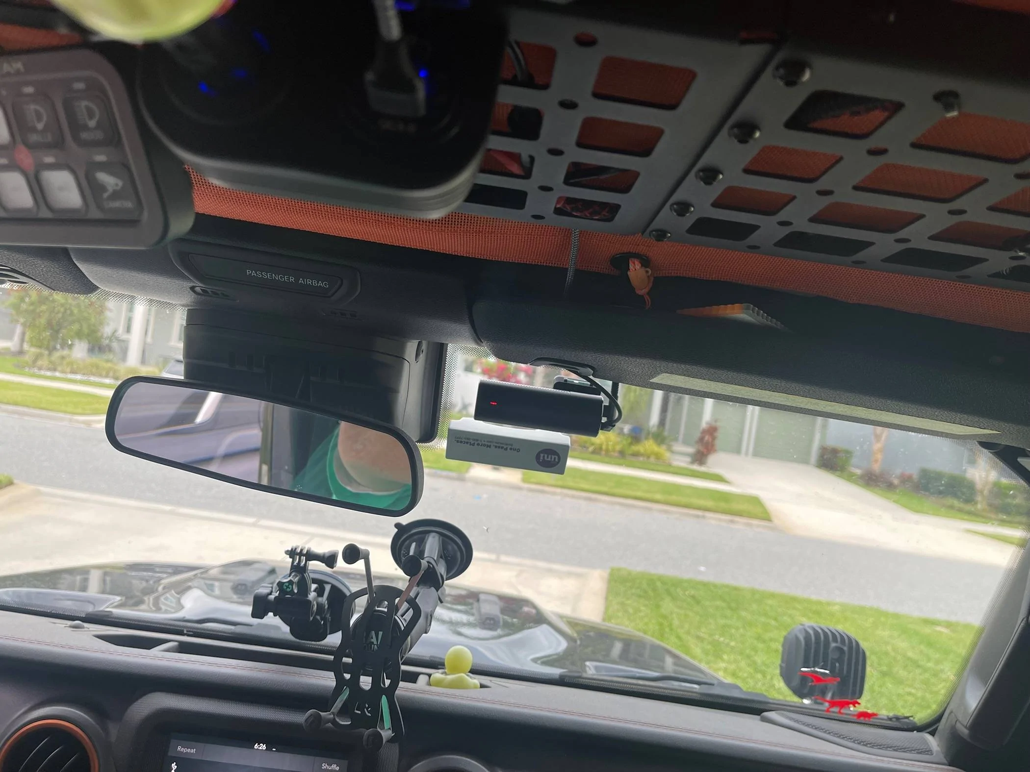

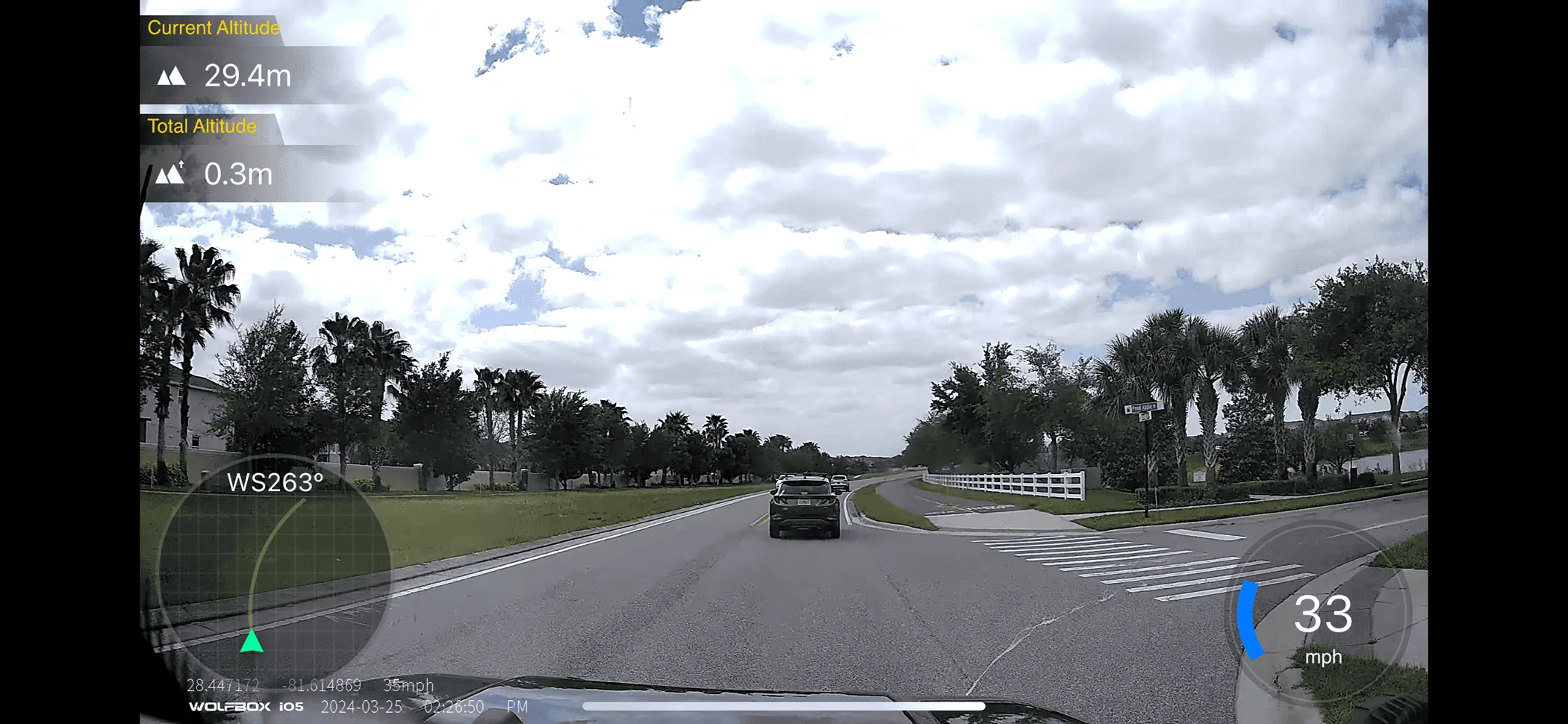

Caved and added front and rear cameras. Last week in a double turn lane I had a woman decide she wanted to use both lanes and drove into my front tire. Luckily no damage to the truck. Dented her door and put rubber swirl marks down the side of her suv.
WOLFBOX 4K Dash Cam Front and Rear, WiFi UHD 2160P/1080P Mini Dash Camera for Cars,Free 32G Card,Built-in GPS,WDR,Night Vision,24H Parking Mode, G-Sensor, Loop Recording,Supports 256GB Max https://a.co/d/0Lb2D1x
Install was straight forward and quality seems good for under $100.
Is it hard wired or are you connecting through usb/cigarette lighter? I think I might give this a try.
