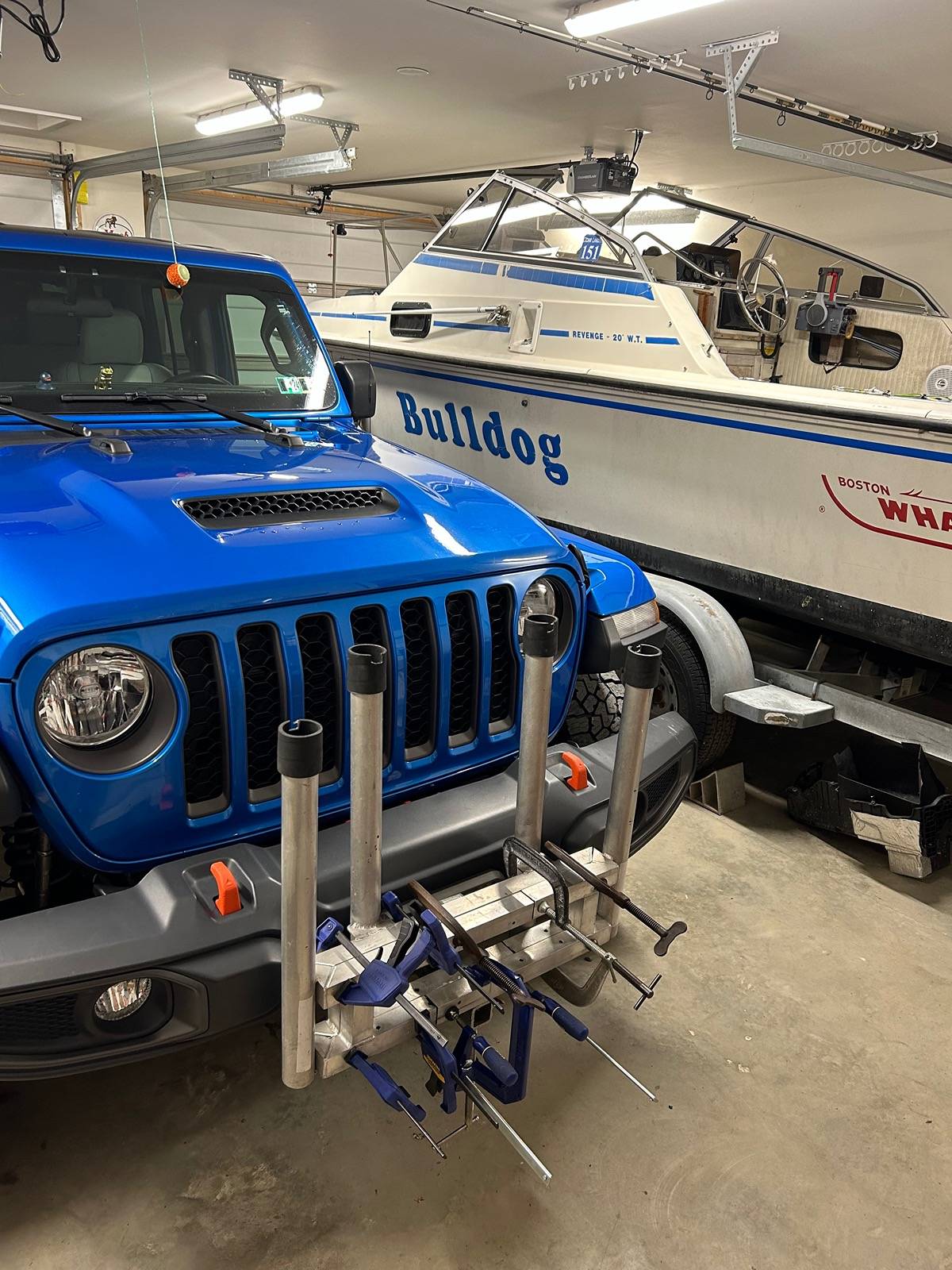

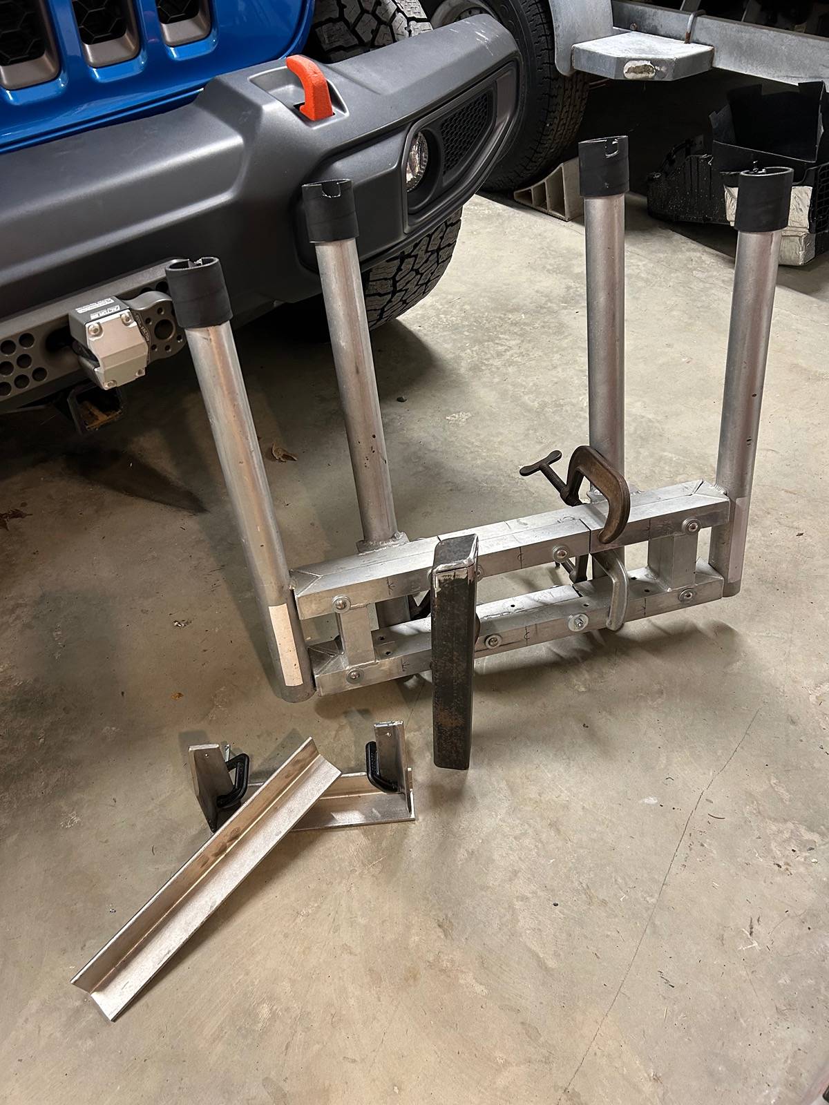

Fabbing a new surf rod holder for fishing, cut up a large cooler rack that has been on four trucks over the years. Will have license plates for surf permits on front. Has to get welded yet, you can never have enough clamps! In background is other project I’m working on……Jack
Jeep Gladiator What did you do TO your Gladiator today? [ADMIN WARNING: NO POLITICS, NO GUN TALK] IMG_0815
Second photo three hours later ready for welder!

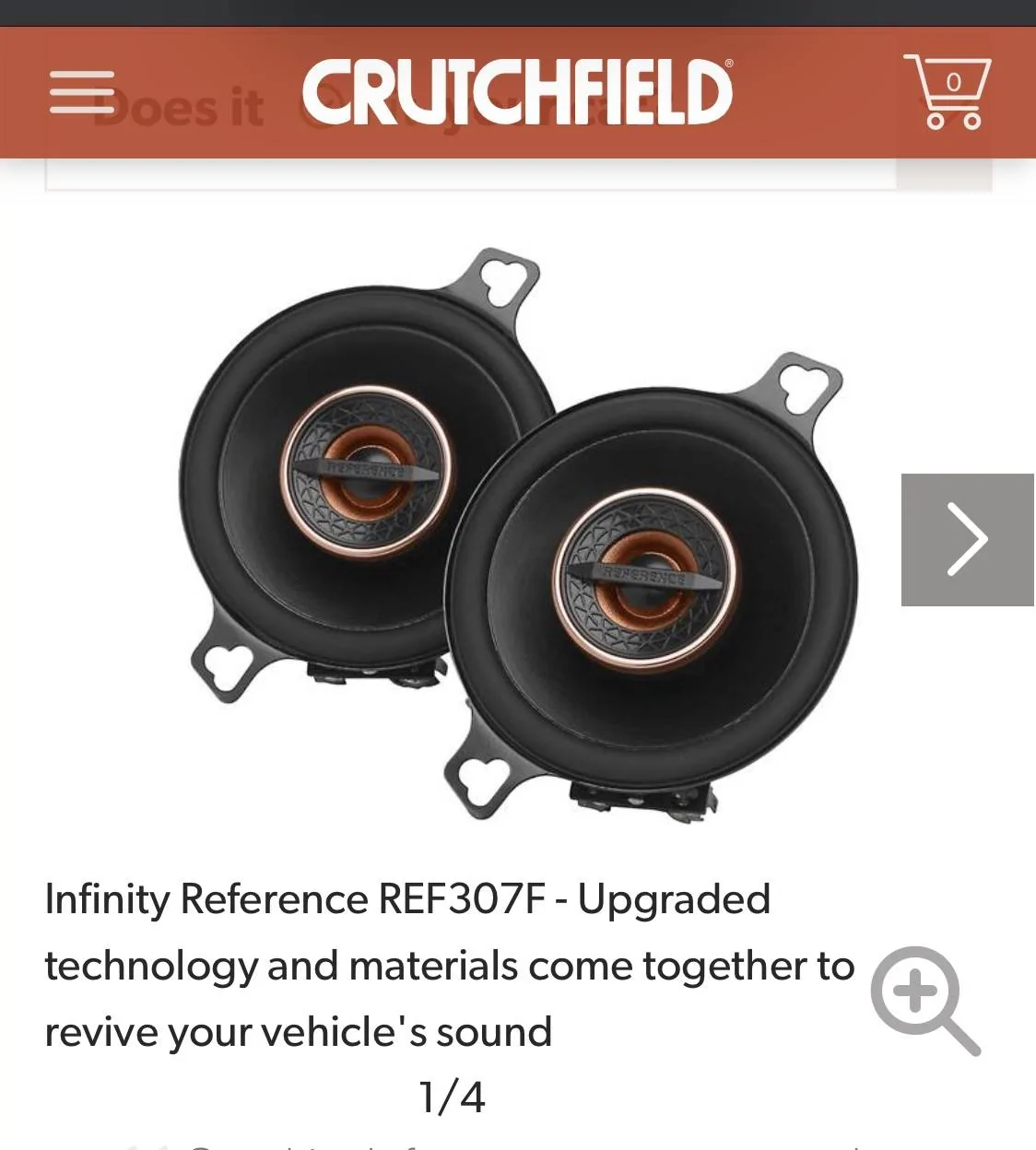

Installed my new corner dash speakers -Infinity Reference REF307F. Huge improvement over the supposedly premium Alpine speakers in my Mojave. Really nicely balanced yet powerful sound for such small speakers and no added amp.
