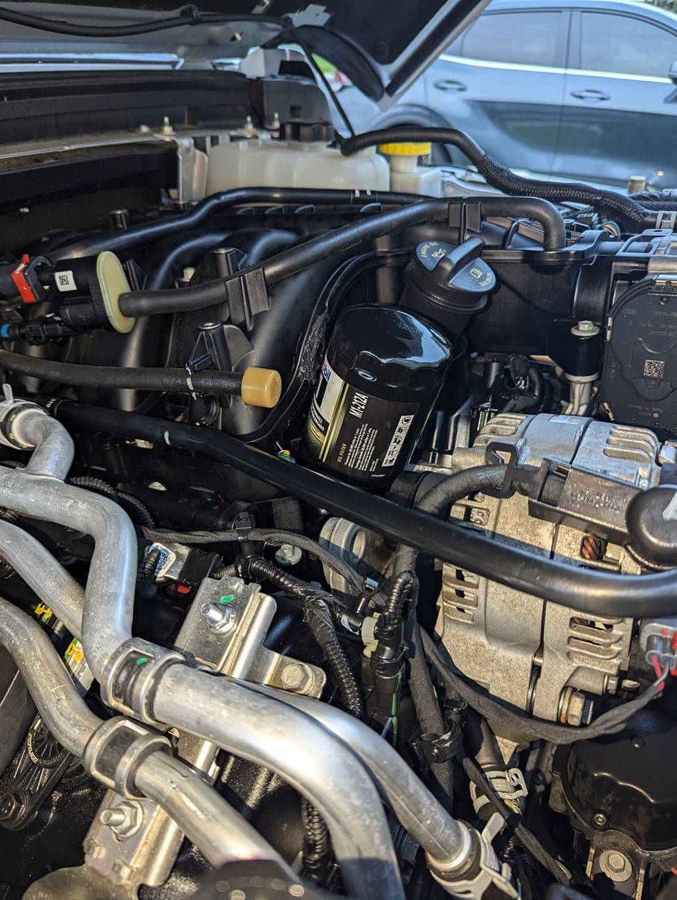

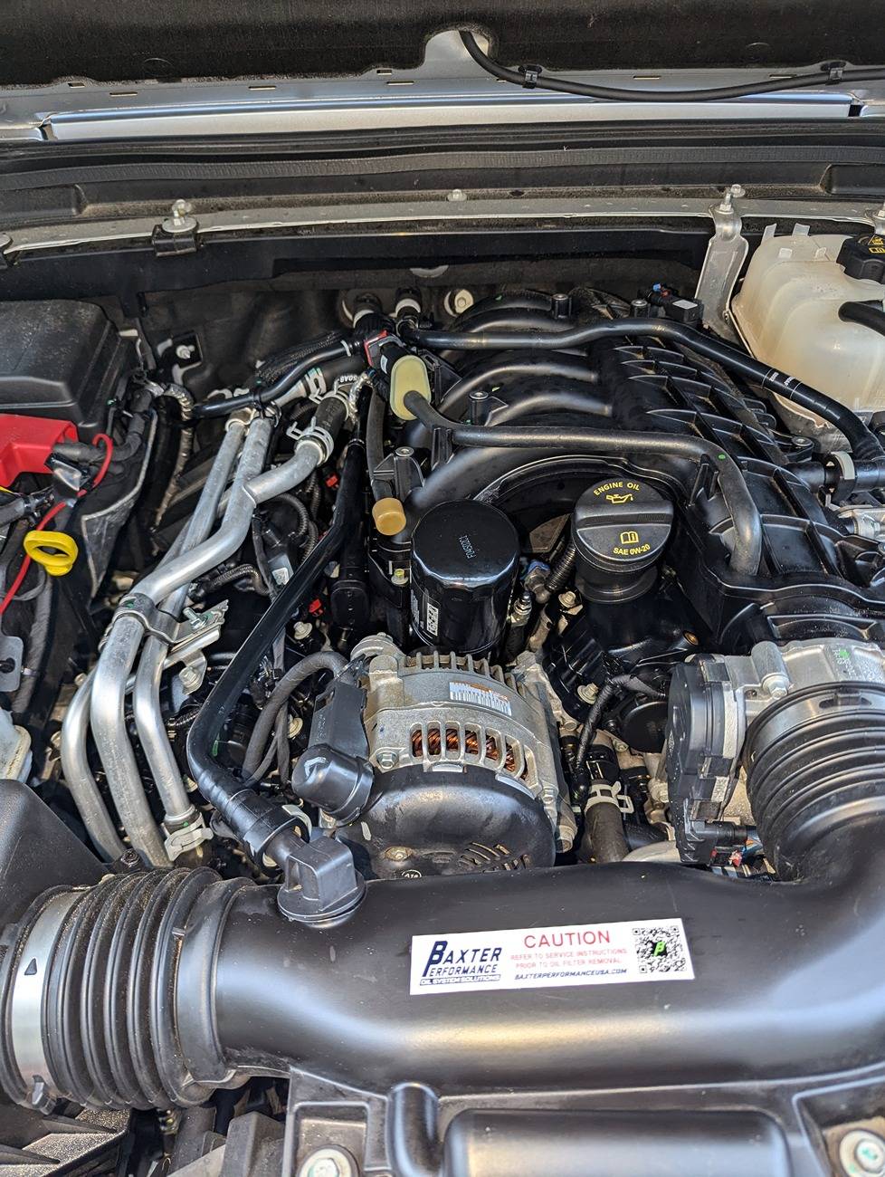

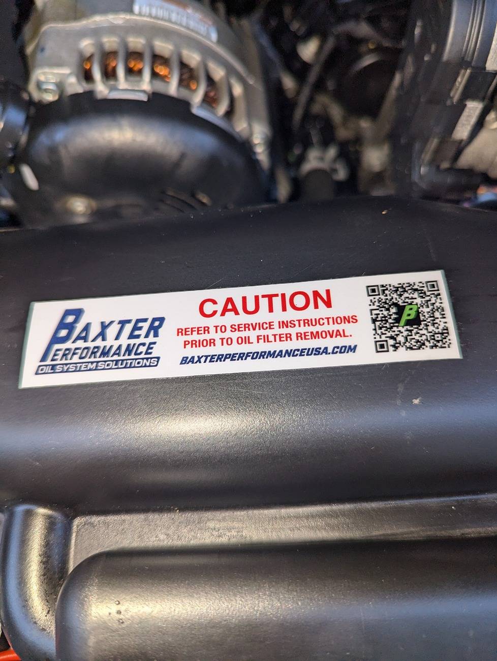

Installed the Baxter Oil Filter Adapter

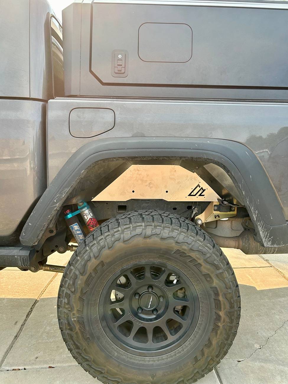

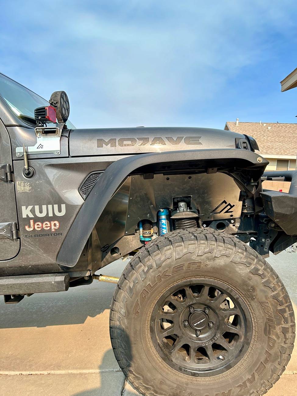

Installed American Adventure Labs raw inner fenders (front & rear), and the cowl mount. Modified the middle to make the bumpstop fit.
Cheers.

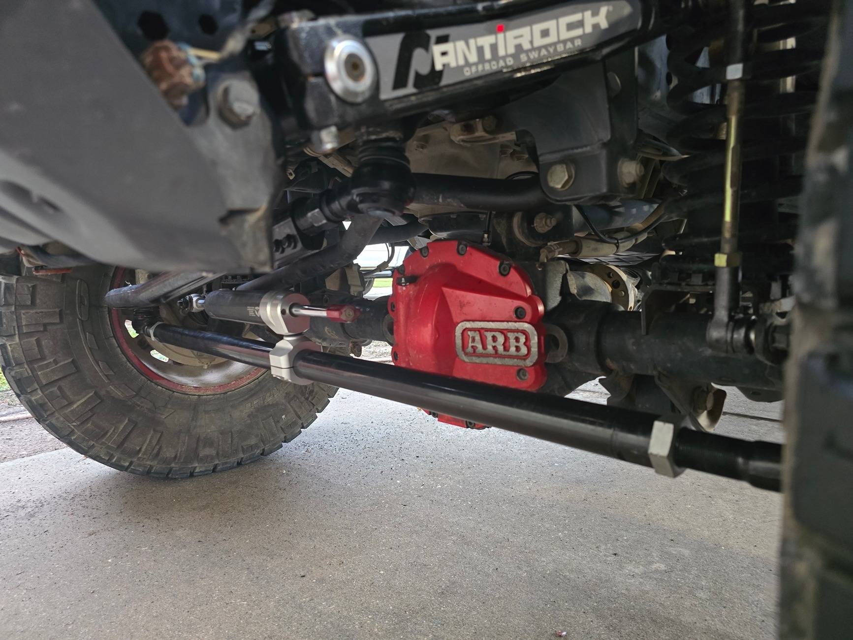

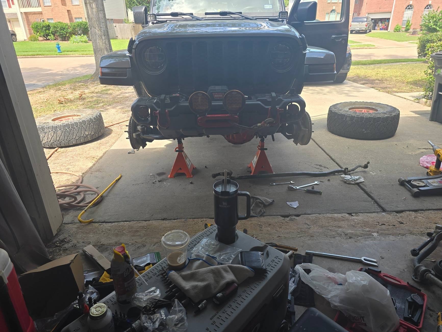

Finished up doing ball joints. Metalcloak support helped me out sorting some issues.
Steering feels really light now, I think I'm going to need to tighten up the castle nuts a touch more.
How you liking these so far & How was the install? Been eyeing these for quite some time.

Q: How many rolls of paper towels does it take per oil change with that upside down oil filter?
It has a Schaefer valve that uses compressed air to push the oil out of the filter.

I like the idea of the Baxter kit but not a fan of having to take that extra step of finding a mini bike pump to flush out the oil before removing the filter.
Curious if you can install a Baxter then add a filter relocation kit on top of it. Then relocate the filter at a location at the level of the oil sump.
https://www.manciniracing.com/marageniiioi.html
Baxter actually makes that setup to plumb in for a filter relocation kit.
https://www.baxterperformanceusa.co...er-mr-202-bk-cartridge-to-remote-adapter.html
That being said, I run the Baxter setup with the filter up top. It really is not that big of a deal to plan around having a air source for the 30 seconds it take to evacuate the oil out and into the sump.
The one main drawback I find with it, is that you need to be committed to doing every oil change with it yourself or have a half-way intelligent mechanic know what they are looking at to do the oil filter changes. Taking it in to any dealer or quickie lube place is asking for disaster if they touch it at all.
Thank You for this. Did not know Baxter had a kit like that. BUT looks like you still have to purge the oil anyways.
