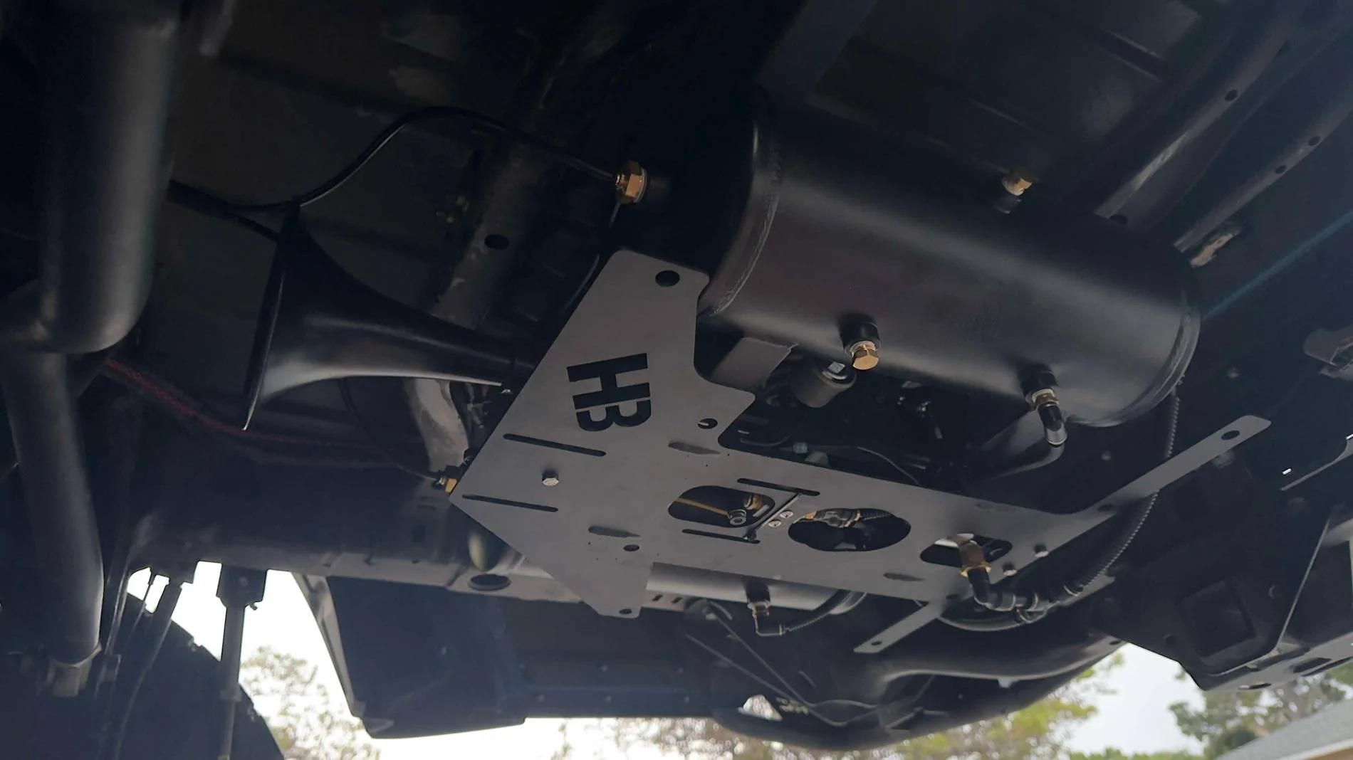

More like what have I been doing for the last month...

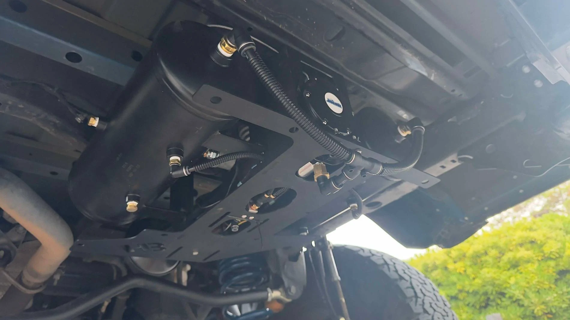

For awhile, I've been wanting to upgrade to an ARB Twin Compressor with tanks. The mounting options for tanks either don't work with my exhaust or don't work with the skid plates, so the project grew into: "what if I got air horns". Initially I liked the spare tire stealth bracket from HornBlasters, but I wanted more capacity (two 2 gallon tanks vs. one 2 gallon).
Unfortunately, the horns mount to the bottom of that bracket, and I didn't like how exposed they were (both visually and clearance-wise). So that turned into: "well I'm not using the area where the compressor goes, so I can slide a single horn through there".
That resulted in a lot of modification to the bracket, but successfully fitting their safety horn (which is cooler anyways; sounds like a fire truck). Then came running all the wires and air lines.

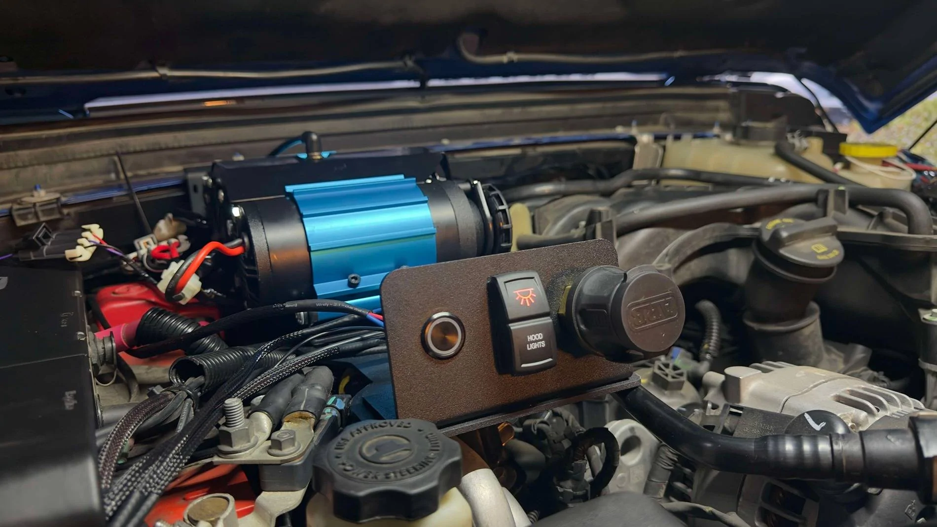

I opted for getting a digital air pressure gauge in my a-pillar, so there is a pressure sender on one of the tanks that requires a signal wire. I also opted for draining the tanks with an electric air valve (which is powered by the black circular button on my compressor mount). The horn valve itself is controlled by a relay in the engine compartment which gets power from one of my aux switches, and is "closed"/turned on via a lead from the actual factory horn wire. That allows me to enable/disable the air horn via the aux switch, and honk it via the steering wheel horn itself.

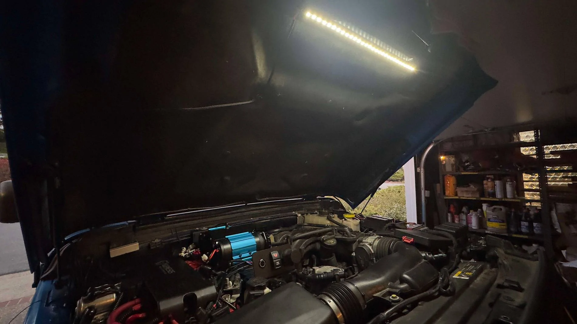

As a bonus (mostly because I needed to fill out the switch hole), I added a small LED light strip to the hood which gets power from the other switch on the compressor bracket and is only grounded when the hood opens (so it will turn off in case I forget to flip the switch.
So far the compressor and drain valve works. I'm wrapping up one final wire to finish the horn relay.

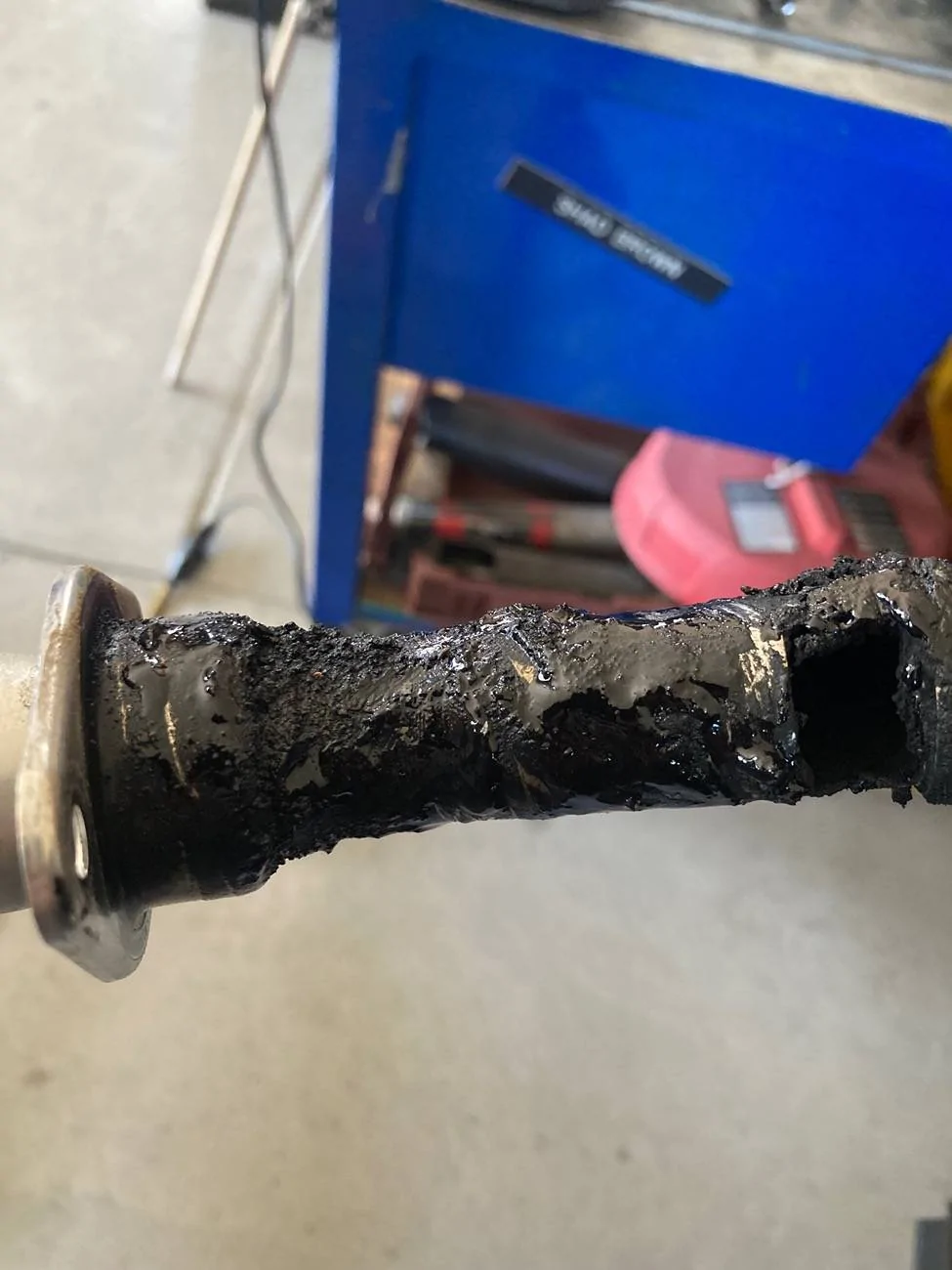

I cleaned out the EGR return tube just to see if my intake was as dirty as others I’ve seen here…. Needless to say, confirmed.
How many miles?

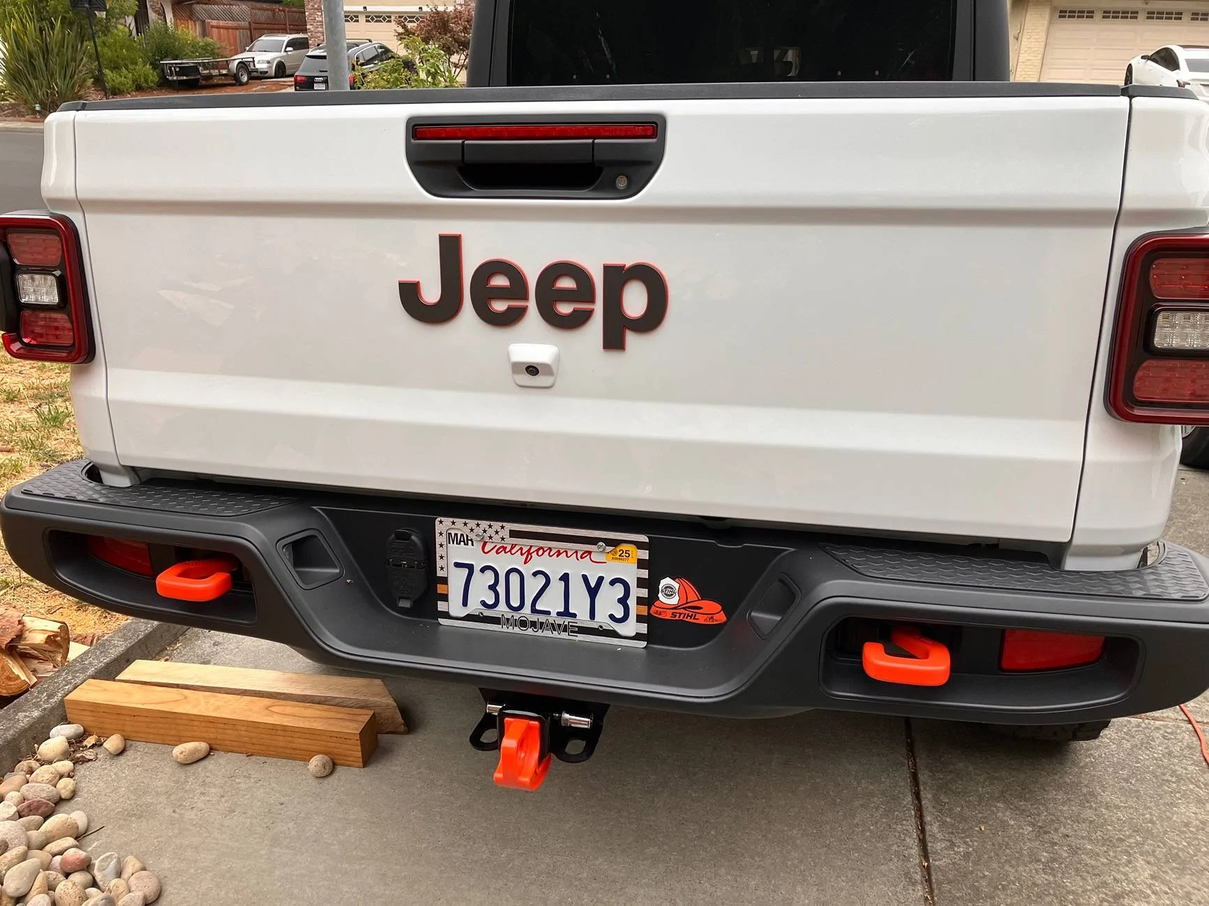

Painted the 41.22 hitch skid to match the hooks. Not a perfect match but way closer than the light tangerine color that it was prior to painting.
