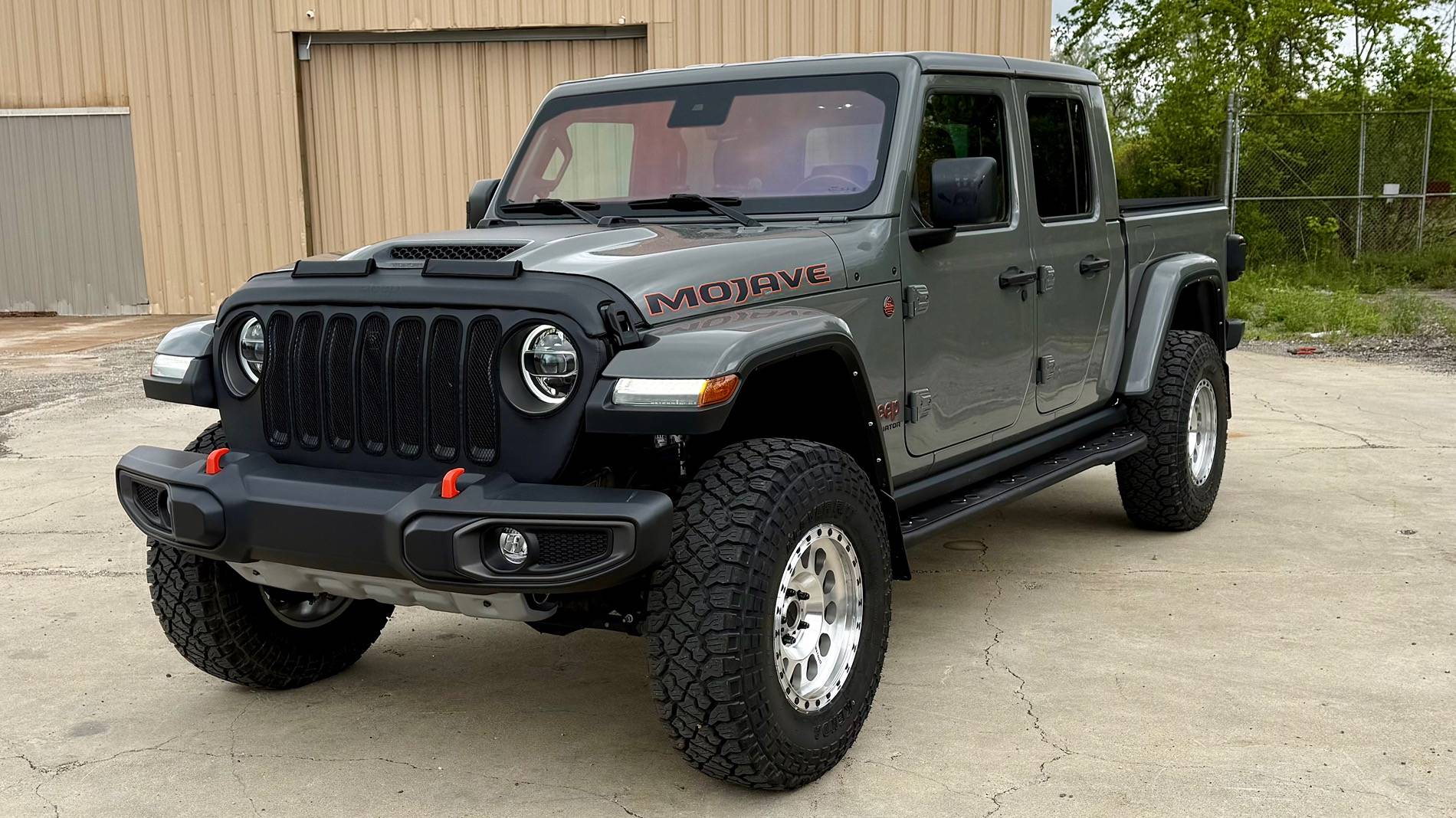

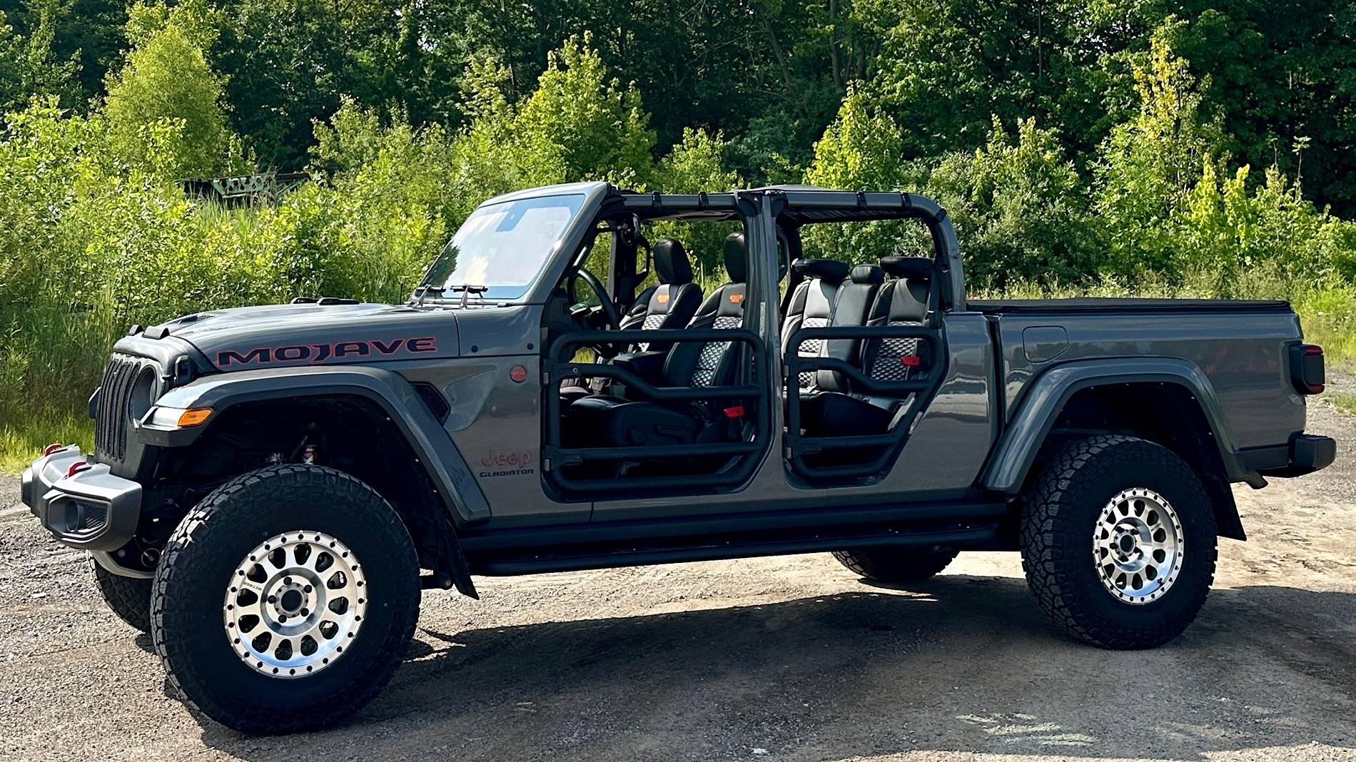

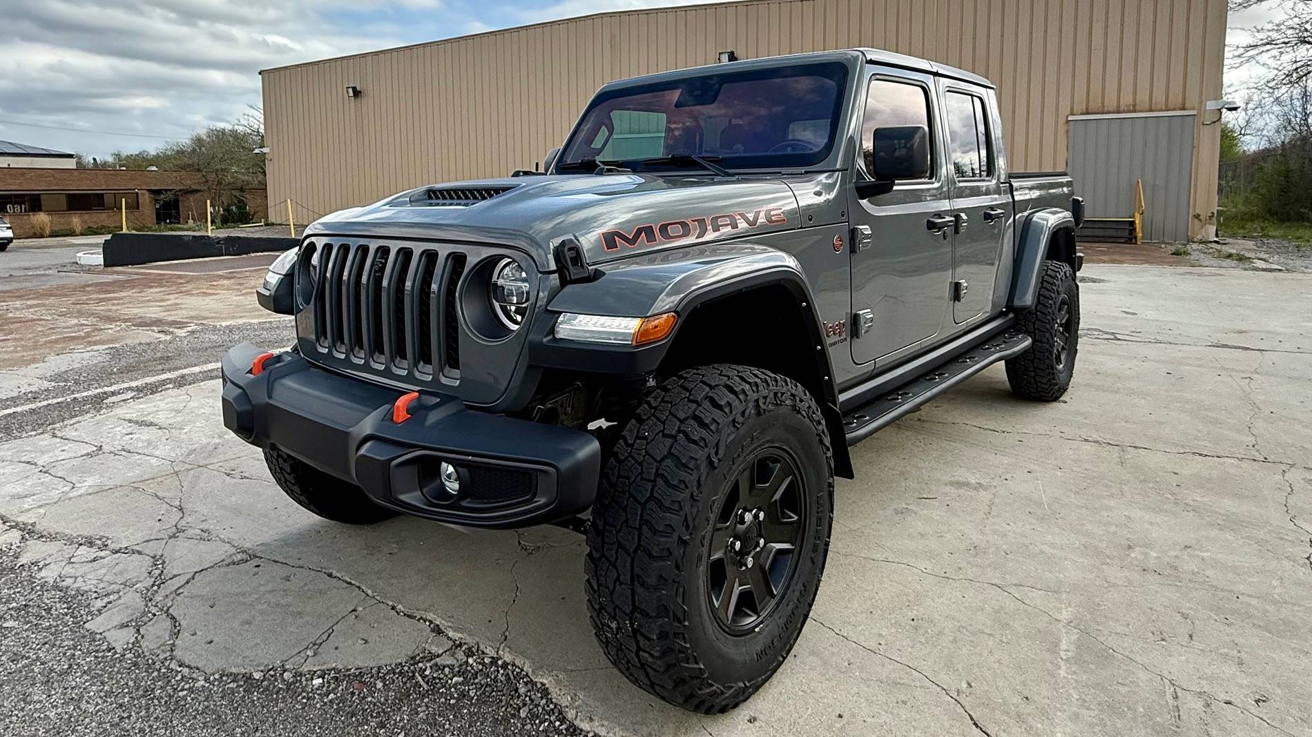

2022 Jeep Gladiator Mojave. First Jeep.
Finally got a chance to put back on its warmer weather/summer things. Tires/Wheels and hood/grill covers. Just don’t call it an “Bra!” Lol. Also added just a little “bling” with the Mopar pedal covers.
Another week and the roof/doors should be off for the remainder of the summer season - Labor Day-ish.
Cold/Winter months;
Mickey Thompson Baja Boss A/T
255/85R17 (34.6x10x17) on base Mojave wheels.
Jeep Gladiator What did you do TO your Gladiator today? [ADMIN WARNING: NO POLITICS, NO GUN TALK] IMG_1710
Warm/Summer months;
Kenda Klever R/T 35x10.5x17
Method 315 17x8.5 & 0 offset.
Jeep Gladiator What did you do TO your Gladiator today? [ADMIN WARNING: NO POLITICS, NO GUN TALK] IMG_1921
Bling Bling.
Mopar.
Jeep Gladiator What did you do TO your Gladiator today? [ADMIN WARNING: NO POLITICS, NO GUN TALK] IMG_1788

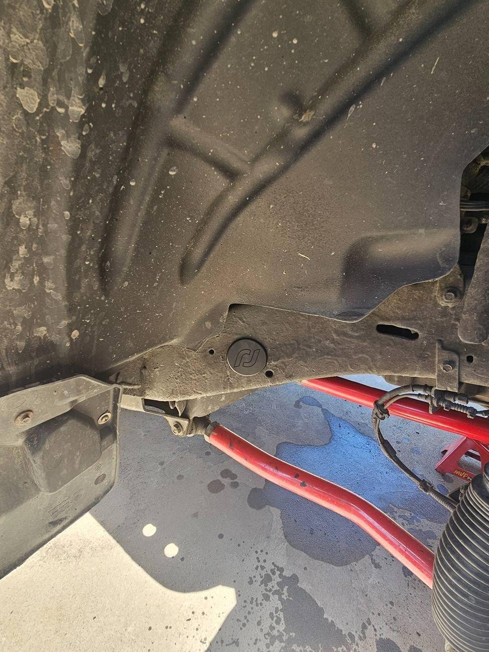

Installed the Rock Jock frame plugs. The ones in the frame were easy to install. Took a razor knife and cleaned the hole. Then used a rubber mallet to tap into place. The plugs for the cross over tube were a PITA because the holes are not exactly round. They are kind of egg shaped from welding. Had to use a die grinder with a burr bit to round out the holes.
Jeep Gladiator What did you do TO your Gladiator today? [ADMIN WARNING: NO POLITICS, NO GUN TALK] 1748316005071-a0
Jeep Gladiator What did you do TO your Gladiator today? [ADMIN WARNING: NO POLITICS, NO GUN TALK] 1748316032518-va

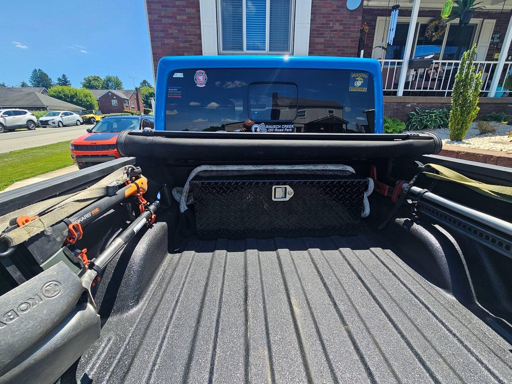

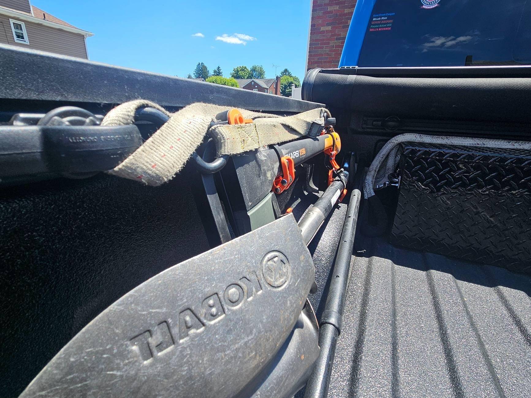

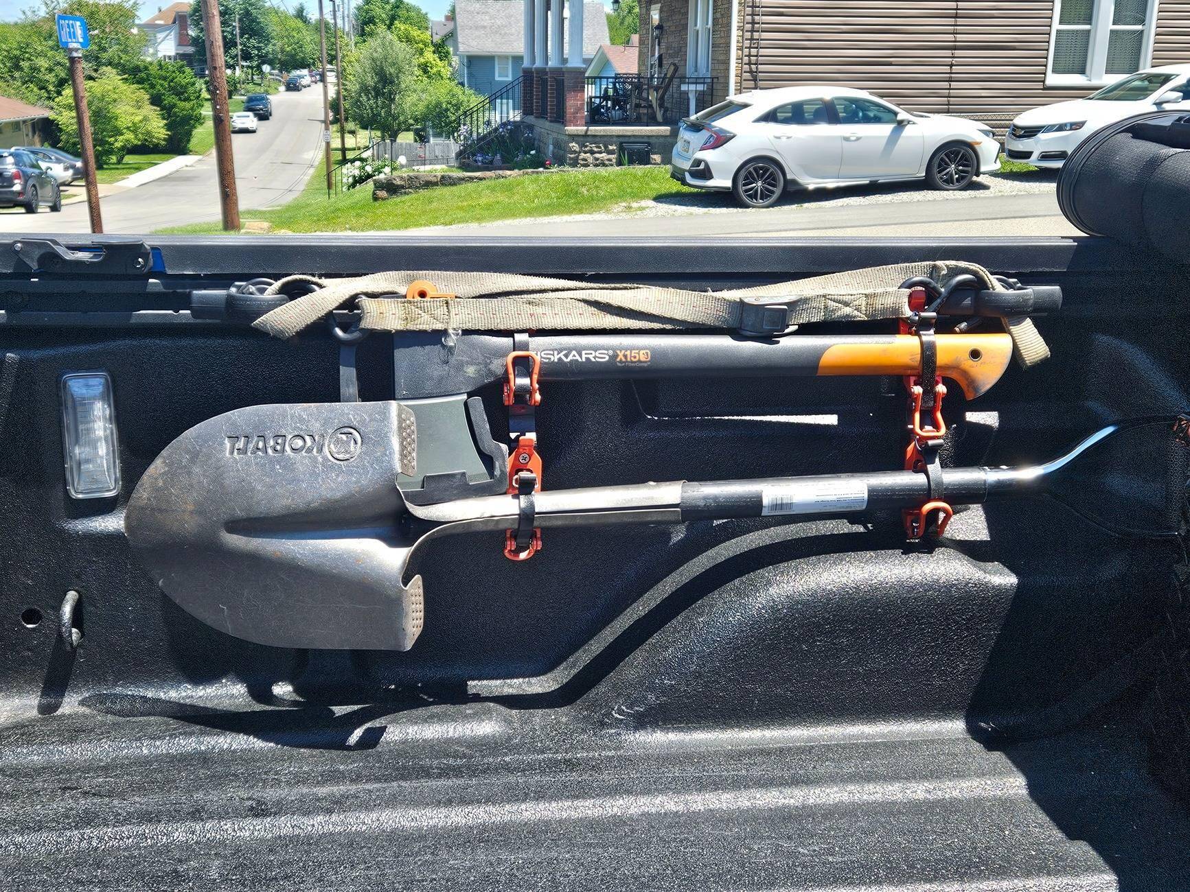

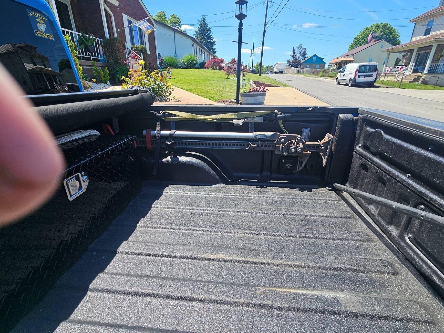

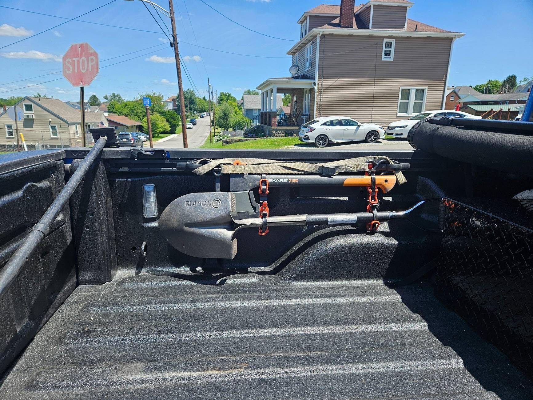

Finished installing the brackets to hold my shovel and axe.
Jeep Gladiator What did you do TO your Gladiator today? [ADMIN WARNING: NO POLITICS, NO GUN TALK] 1748316148899-ic
Jeep Gladiator What did you do TO your Gladiator today? [ADMIN WARNING: NO POLITICS, NO GUN TALK] 1748316177320-vt
Jeep Gladiator What did you do TO your Gladiator today? [ADMIN WARNING: NO POLITICS, NO GUN TALK] 1748316220465-pt
Jeep Gladiator What did you do TO your Gladiator today? [ADMIN WARNING: NO POLITICS, NO GUN TALK] 1748316251478-j5
Jeep Gladiator What did you do TO your Gladiator today? [ADMIN WARNING: NO POLITICS, NO GUN TALK] 1748316288722-3

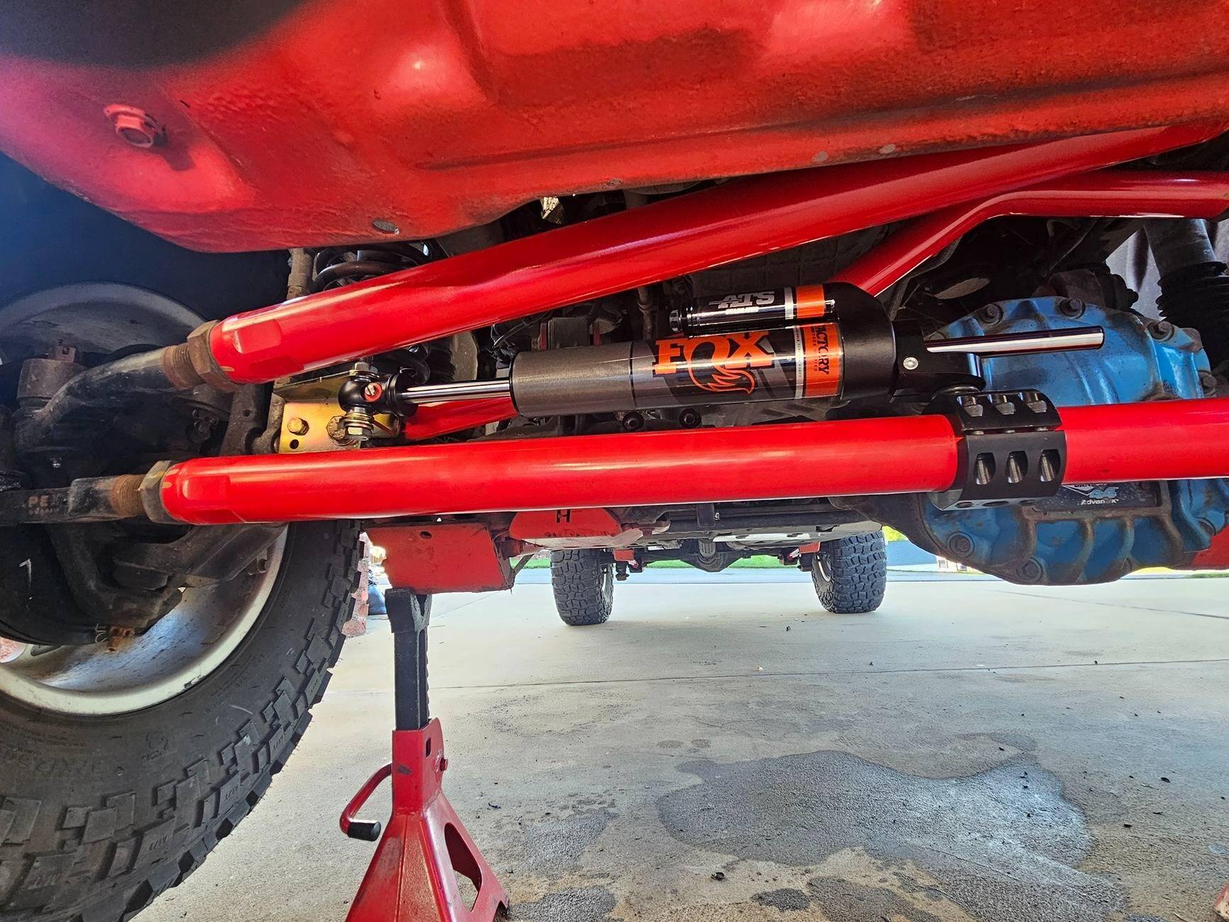

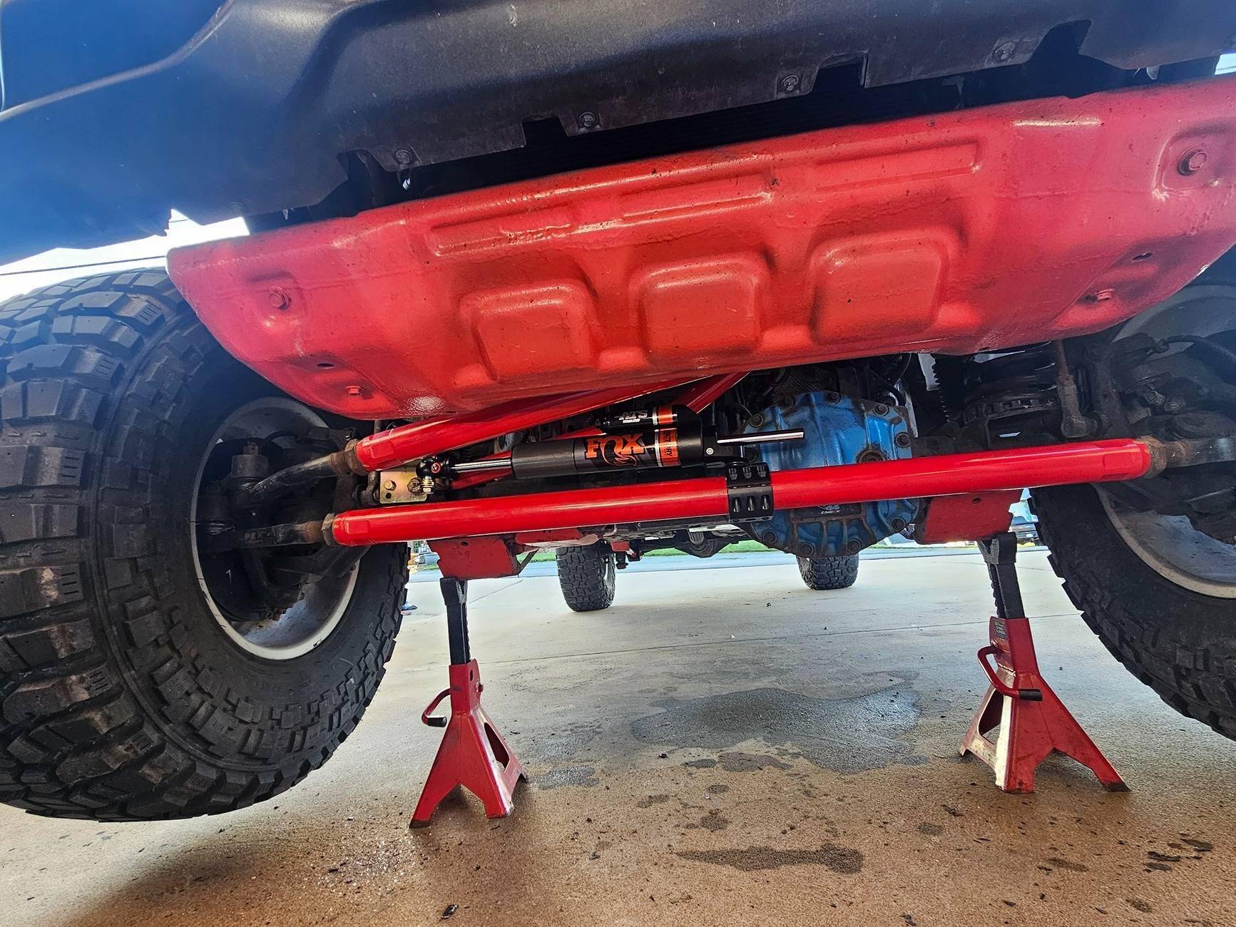

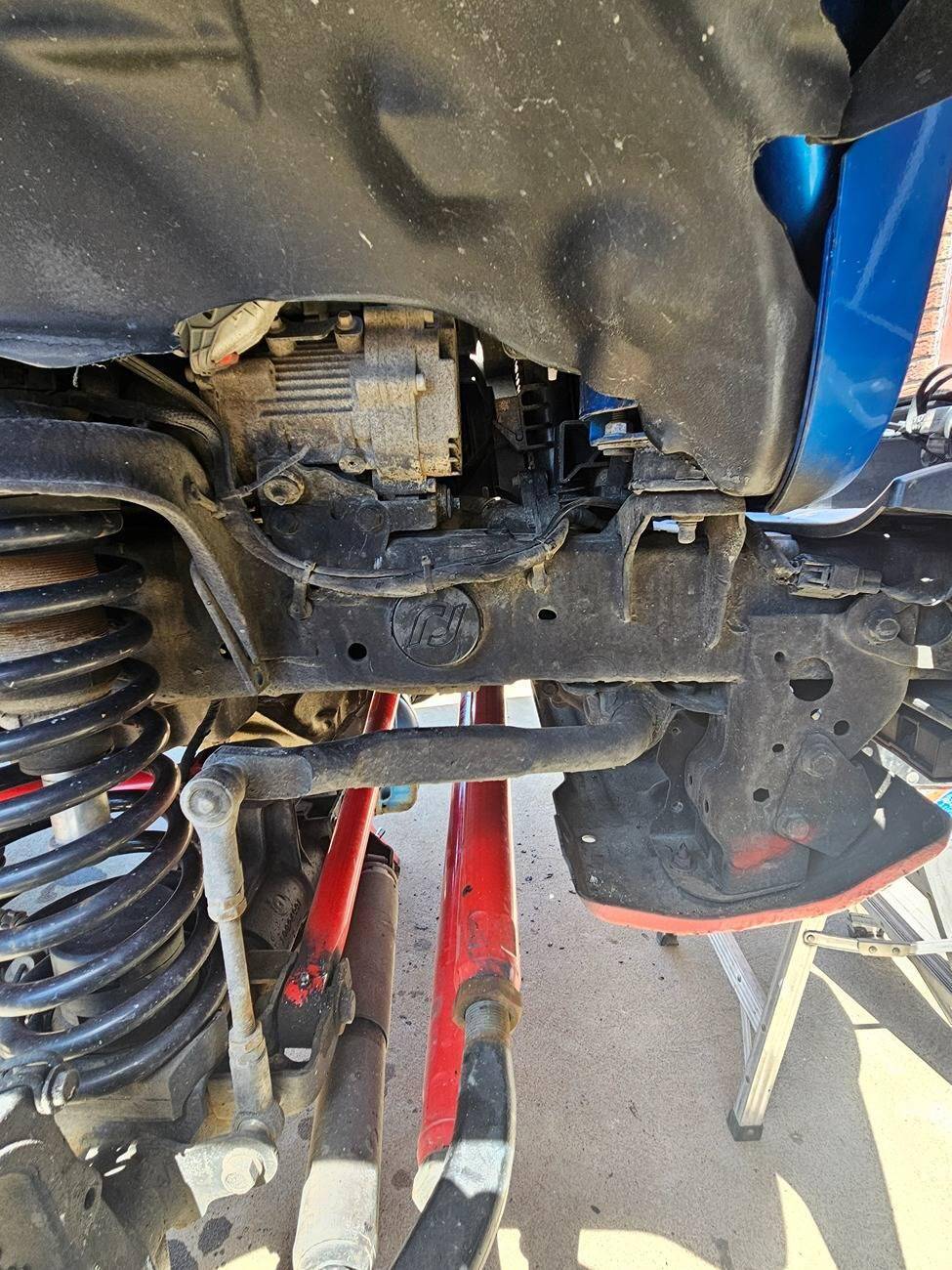

Installed the Fox ATS steering stabilizer.
Jeep Gladiator What did you do TO your Gladiator today? [ADMIN WARNING: NO POLITICS, NO GUN TALK] 1748316369051-jb
Jeep Gladiator What did you do TO your Gladiator today? [ADMIN WARNING: NO POLITICS, NO GUN TALK] 1748316400294-iq
I loved the steering feel with mine, but for the life of me couldn’t figure out clearances.
If those red, what look like red painted rock hard, Lca skids stay red, I’ll be so impressed. :) mine are now scratch colored.
