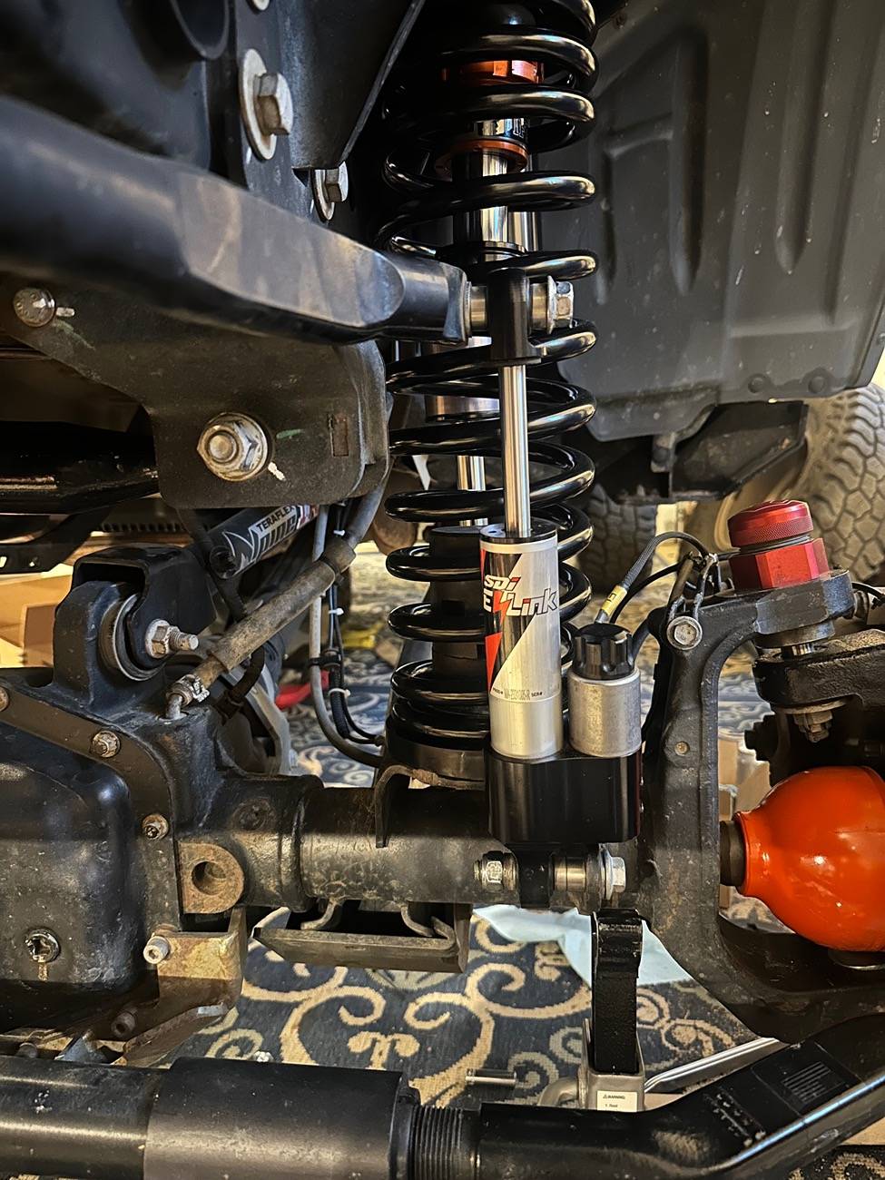

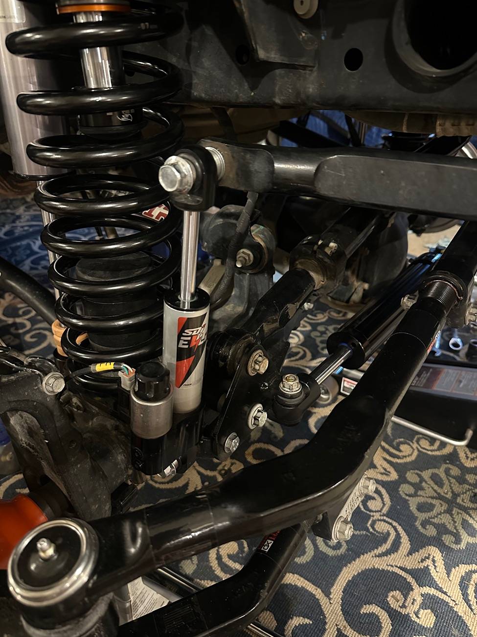

Switched around some hardware and did some measurements. Swaybar links are back in. I swapped to nylocks and orange thread locker. I got fed up with the oval lock nuts.
The only things on the front end not torqued are the track bar and drag link adjustment sleeve. I’m meeting those until it’s on the ground. I’m still going to change up control arm lengths as well to push the axle a hair forward and make the drive shaft angle a little more gentle without destroying the caster angle.

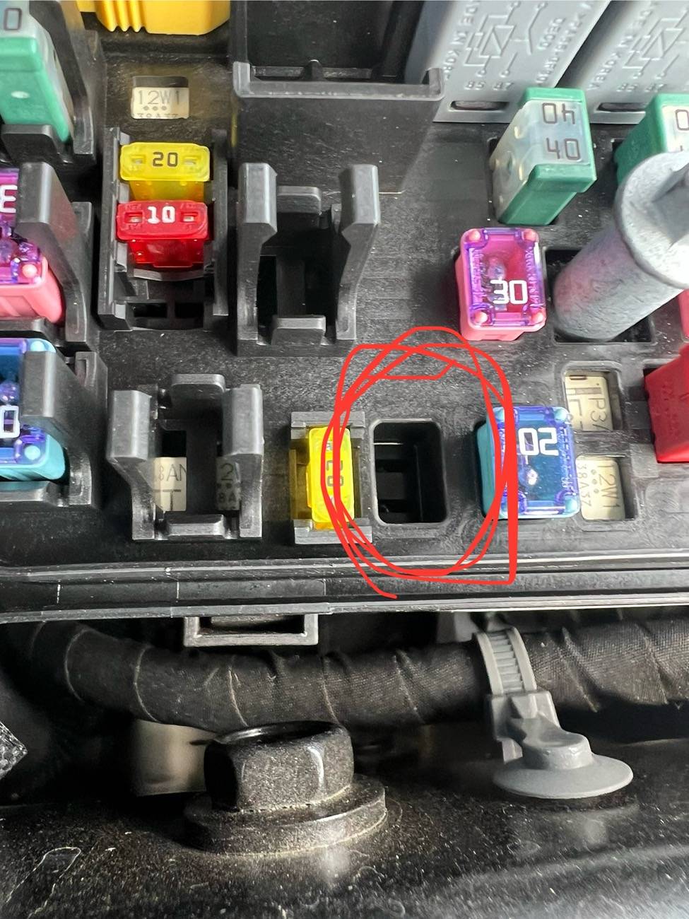

Well, I went to the dealership to have my self-installed 115v outlet activated. No luck. The tech said that there were fuse connectors missing. Does anyone with a 115v outlet in the bed have this fuse?

I will go look at mine and report back.

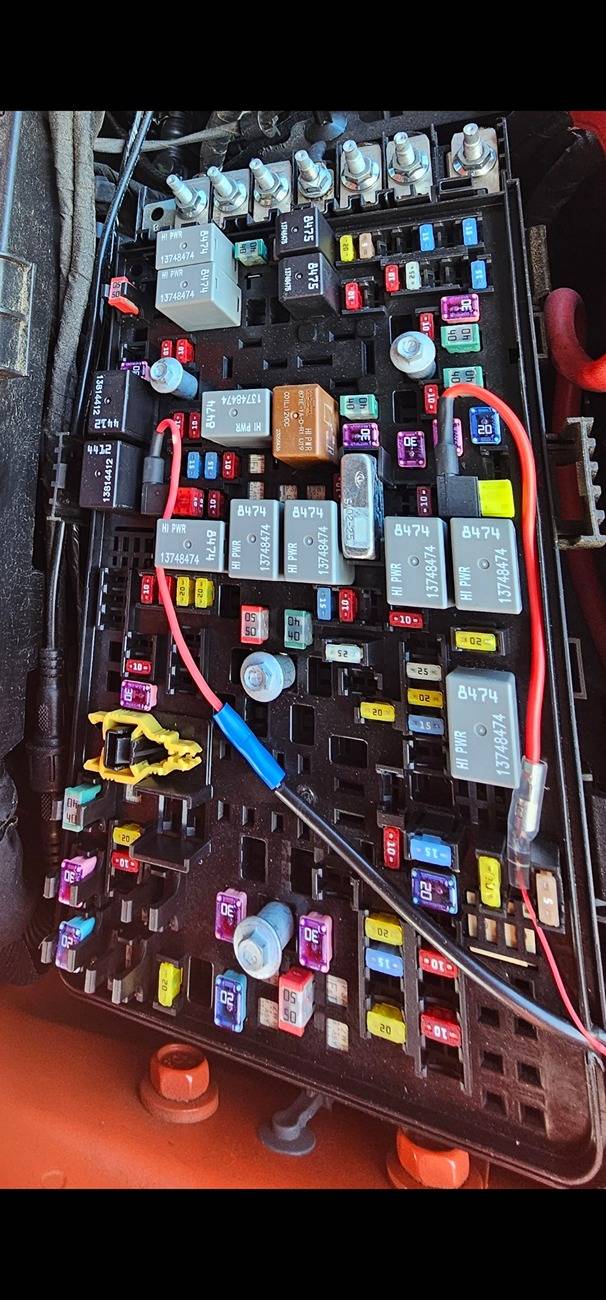

Couldnt make out which position your picture was over the fuse box, but I just took an over the top of my entire fuse box. I have the outlet in the bed so should have whatever you're looking for.

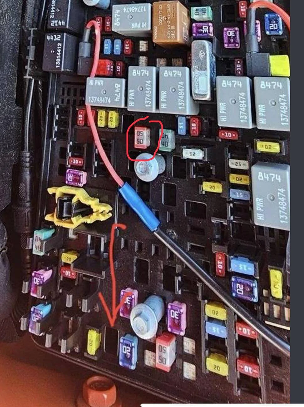

Thanks Trent. You don’t have it either. It’s F110 which is for the 115v Inverter. But my 115v inverter works in the back of the center console. Weird.
