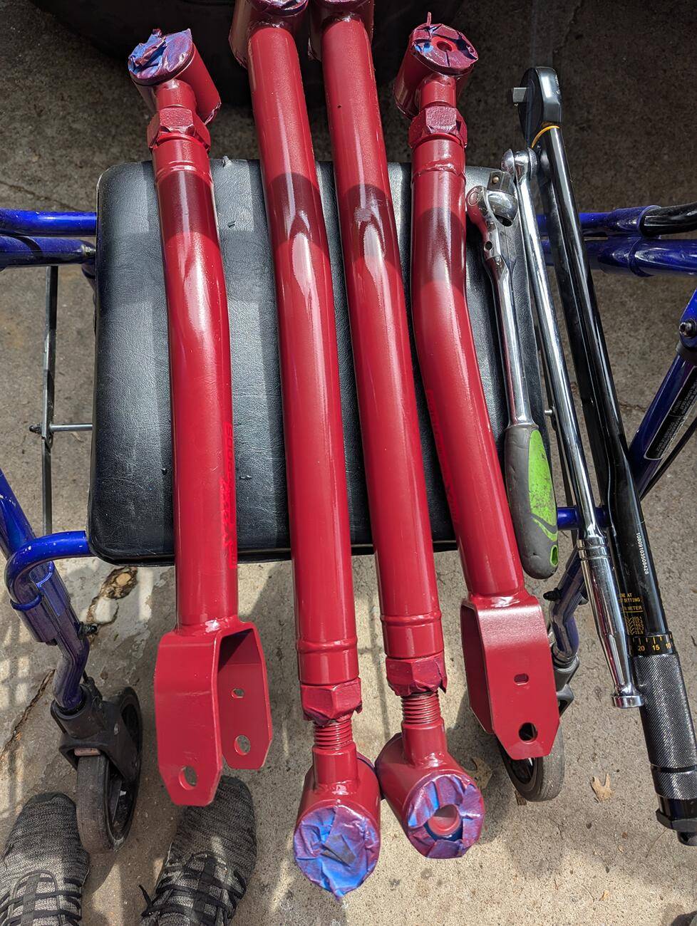

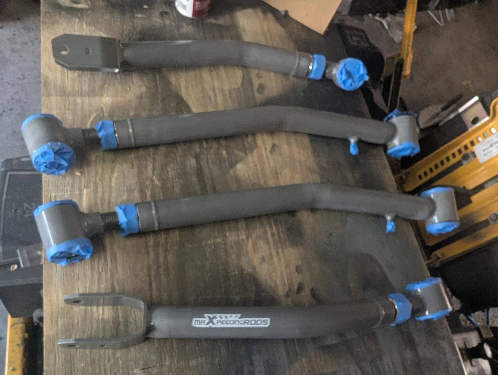

So today I decided against family and DR'S order installed my upper and lower adjustable control arms. all went fine due to already removing and installing all but the axle side lower nuts and bolts. Well as @Rusty PW likes to refer to one freaking nut.. well you know! but all is installed, but tomorrow I'll torque everything and tighten the jam nuts. I am pretty sure every angle is where it is supposed to be. Oh and I had painted them prior to install..
Before:
Jeep Gladiator What did you do TO your Gladiator today? [ADMIN WARNING: NO POLITICS, NO GUN TALK] Control arms grey
After:
Jeep Gladiator What did you do TO your Gladiator today? [ADMIN WARNING: NO POLITICS, NO GUN TALK] Control arms red
Before:
After:
So much work. The rear is easier though. :). You did the hard part.

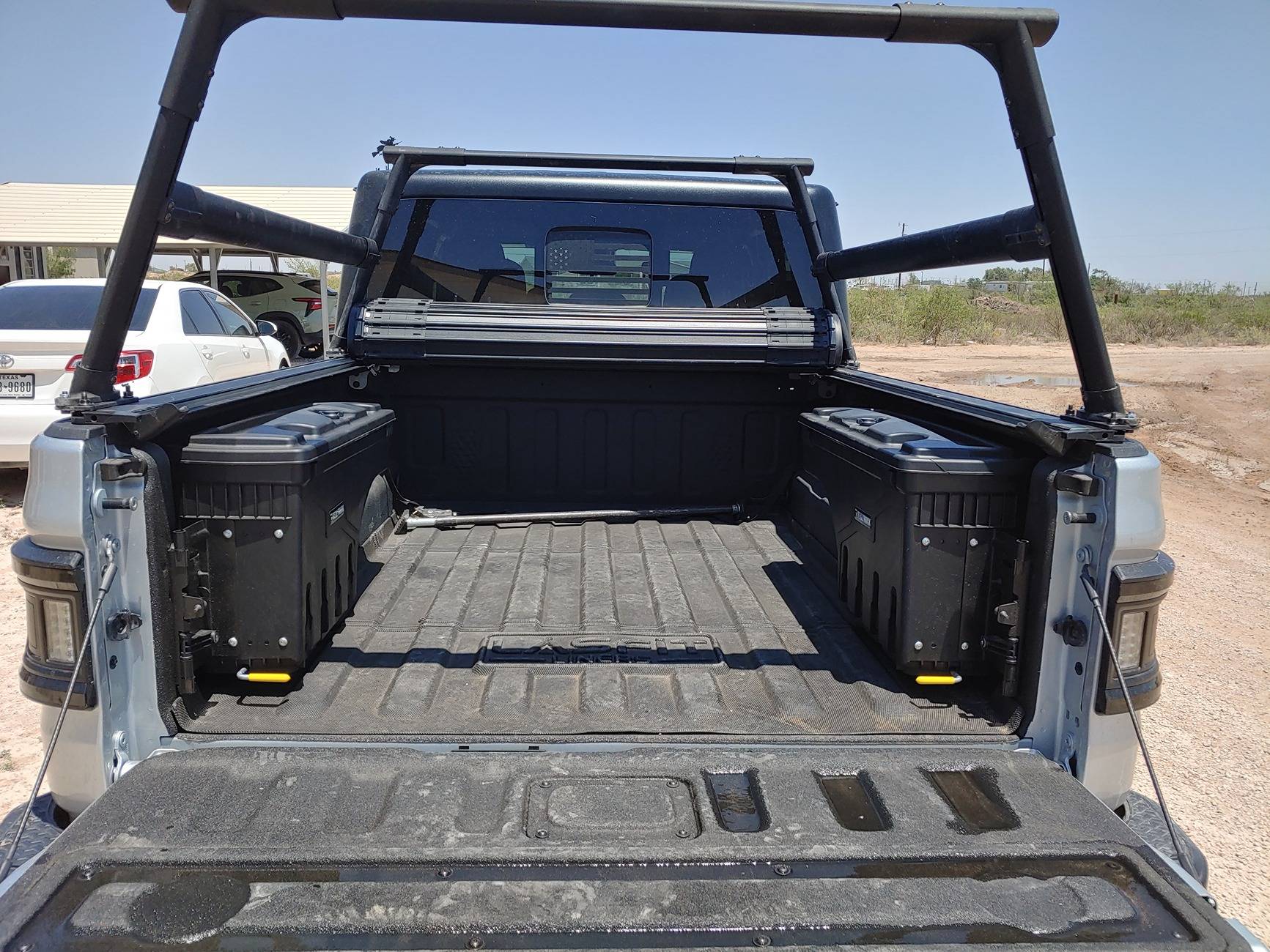

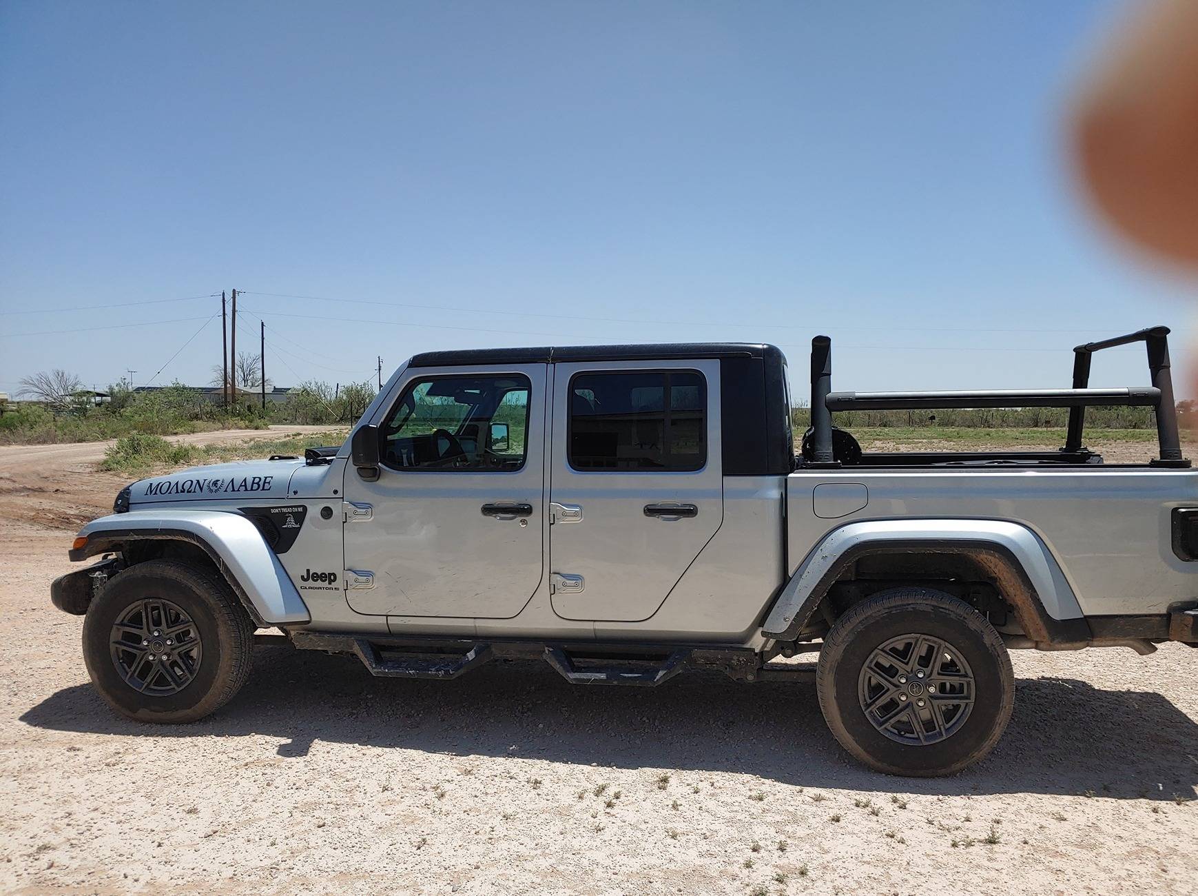

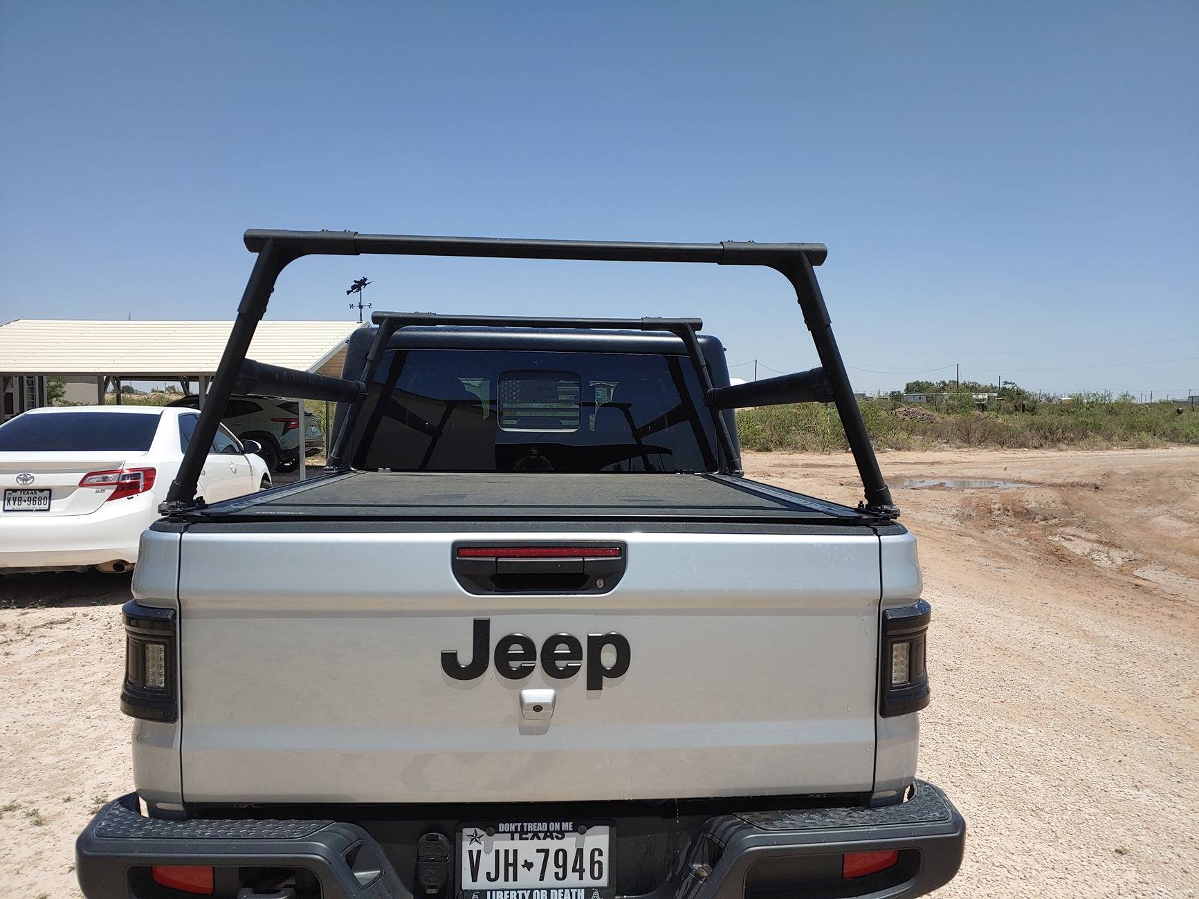

Received a bed rack last week. After putting it together I found that it was a bit wide to fit my tonneau tee tracks, plus it was in the way of rolling the tonneau. I really didn't want to drill holes in the bed sides, so I put my metalworker mind to work and decided that four pieces of 1/4" x 2" flat bar would do the trick. Drilled the holes, rounded off the corners, painted, and it turned out perfectly. It also doesn't block rolling up the tonneau.
Jeep Gladiator What did you do TO your Gladiator today? [ADMIN WARNING: NO POLITICS, NO GUN TALK] 0606251438
Jeep Gladiator What did you do TO your Gladiator today? [ADMIN WARNING: NO POLITICS, NO GUN TALK] 0606251439
Jeep Gladiator What did you do TO your Gladiator today? [ADMIN WARNING: NO POLITICS, NO GUN TALK] 0606251438_HDR
The tonneau rolled up. Oh yeah, I also put those two swing cases in to store my hitch, straps and tools.

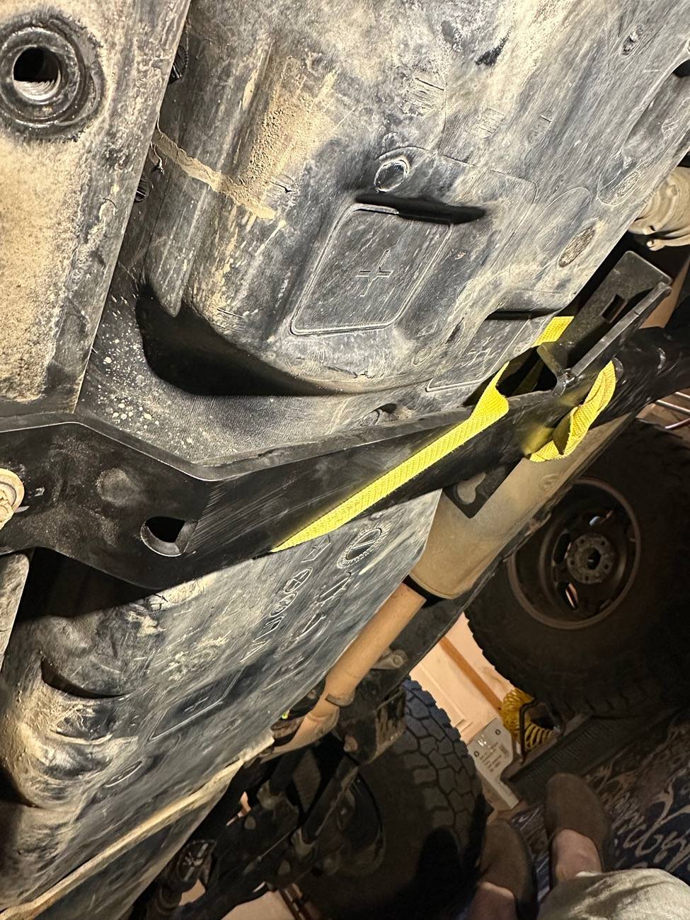

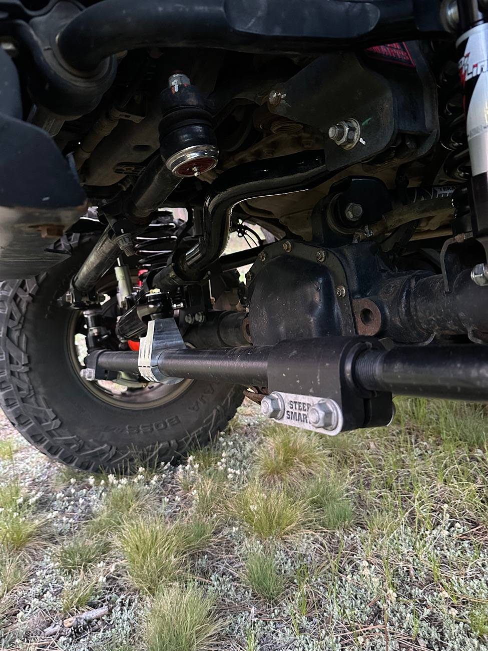

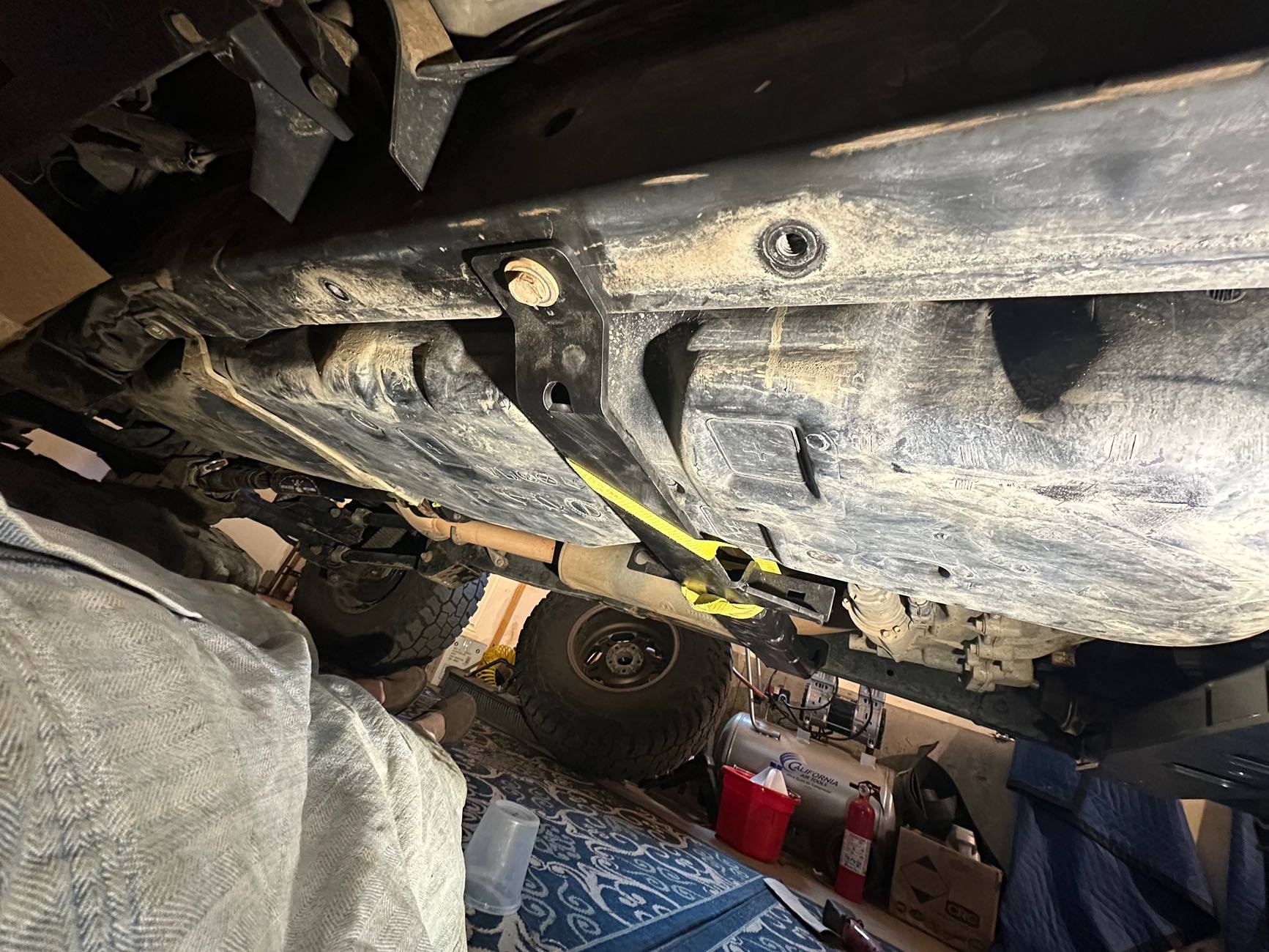

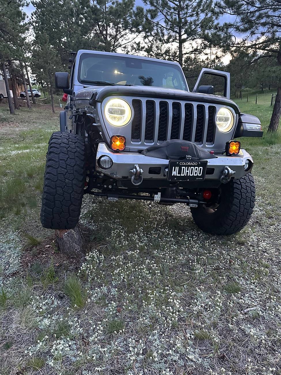

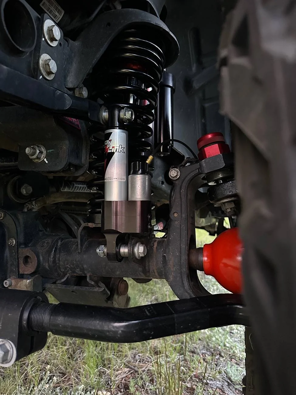

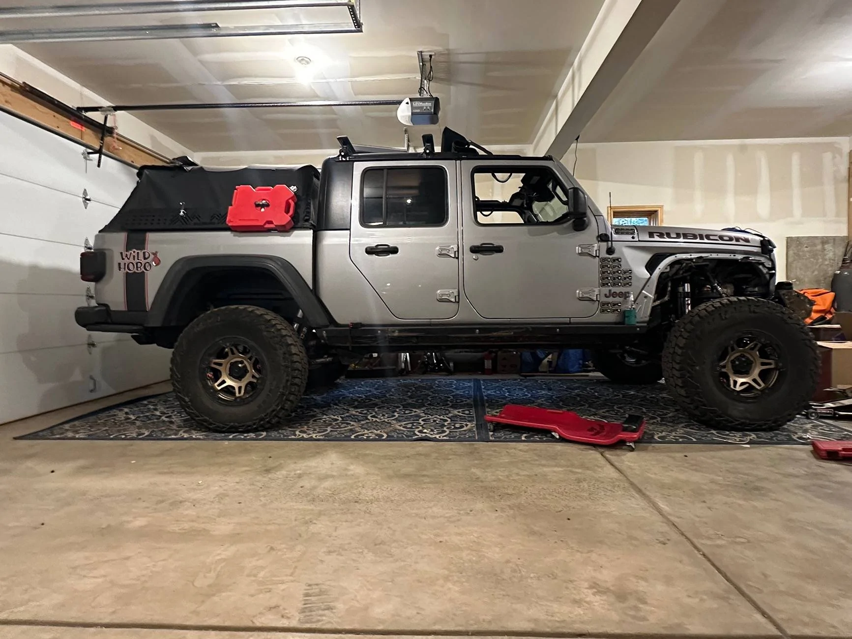

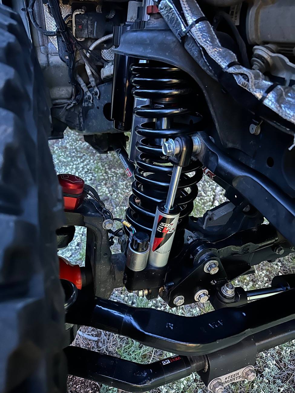

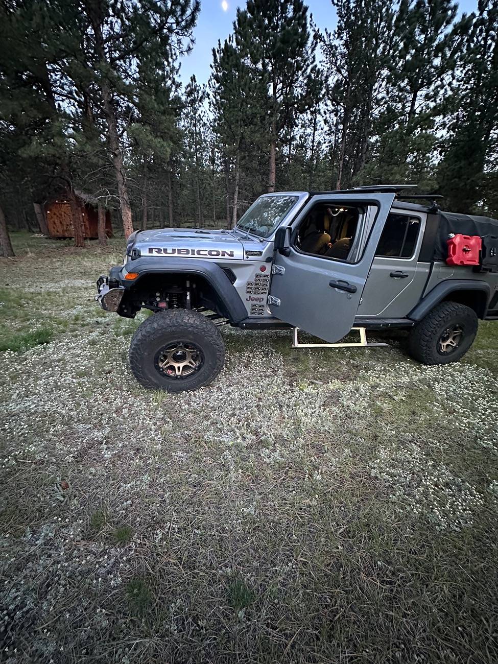

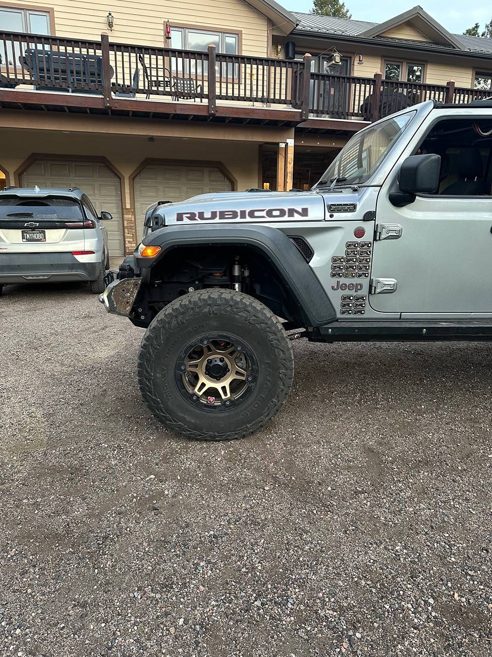

Big day. Front wheels are on. And I backed it out of the garage for the first time since 4/19. The gas tank is attached with a lashing strap. The track bar isn’t torqued, the wheel is crooked. But I hadn’t done any of that yet. But I needed to see if I could get it out of the garage, and it hadn’t even moved since a tranny own replacement and fluid change. It shifted like butter. Of course I didn’t go further than my driveway or yard. But it didn’t grenade. RCVs are silent and butter smooth after the rebuilds. It still needs all the skids, and don’t have the tank skid replacement yet, but it was a big step.
I did lose my rake. There’s 5/8ā€ of it left. So I’m going to need taller rear springs. No way to know until it was on the ground though. Thanks for everyone’s support through this process.
I did some super basic articulation tests in the yard. I don’t think I’m at any risk of bottoming out the shocks with how the bumps are setup. The jury is out regarding the drag link. But I think it might be ok.
