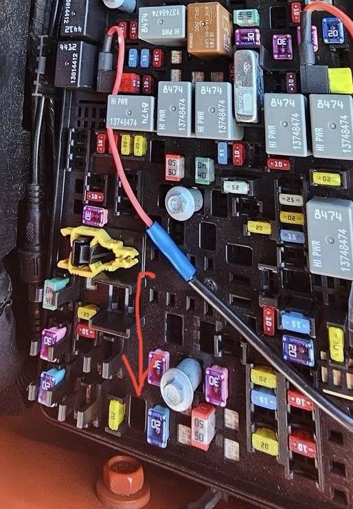

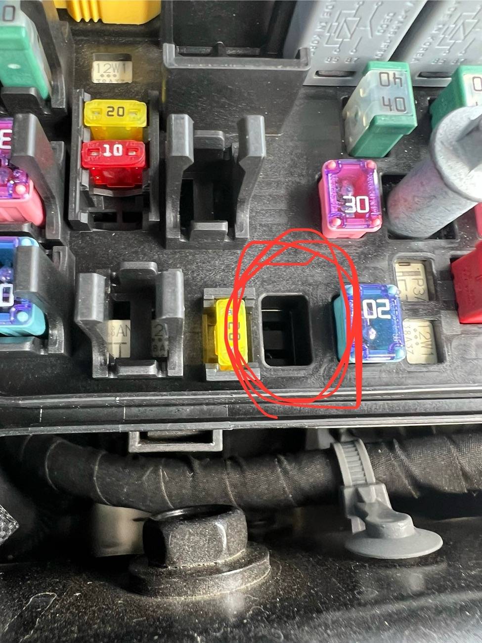

Thanks Trent. You don’t have it either. It’s F110 which is for the 115v Inverter. But my 115v inverter works in the back of the center console. Weird.
I have both the inverter on the back of the console and the outlet in the bed. So could be the tech was misinformed on what you were missing. Sorry I couldn't help with finding what was wrong but glad to assist and let you see what I've got there.
I have a set of 2025 wiring diagrams on my computer at work I will verify tomorrow, but starting in 2022+, they list that slot in the owners manual as F110 "Power Inverter 150W*" with the asterisk as "If Equipped". 150 Watts is pretty weak sauce. Prior model years had that slot as blank/spare with fuses F65 and F51 for the 400 watt inverter that supplied both the center console and bed outlets.
Attached are the diagrams for a 2020 for reference.
Thanks Don! It turns out that it's not something that will load into my Jeep without a Tazer, Jscan, or AlfaOBD. Benny @AllMoparParts.com r came to the rescue (as he always does) and pulled the necessary sales code as XBE and my Jeep (although it has all of the equipment) won't take an XBE sales code. Now to dig through the 7,320 pages of Tazer vs. Jscan vs. AlfaOBD threads to pick one. After that I'm going to start threads on tires and oil!!!!! :devil: The dealership is talking to Jeep engineering and I'm also going to shoot @JeepCares a DM and see if they have a solution.
If you look at the 155v outlet kit thread you'll see the hilarious saga of me trying to install this thing. :CWL:
https://www.jeepgladiatorforum.com/forum/threads/2024-mojave-x-add-bed-115v-outlet.90703/

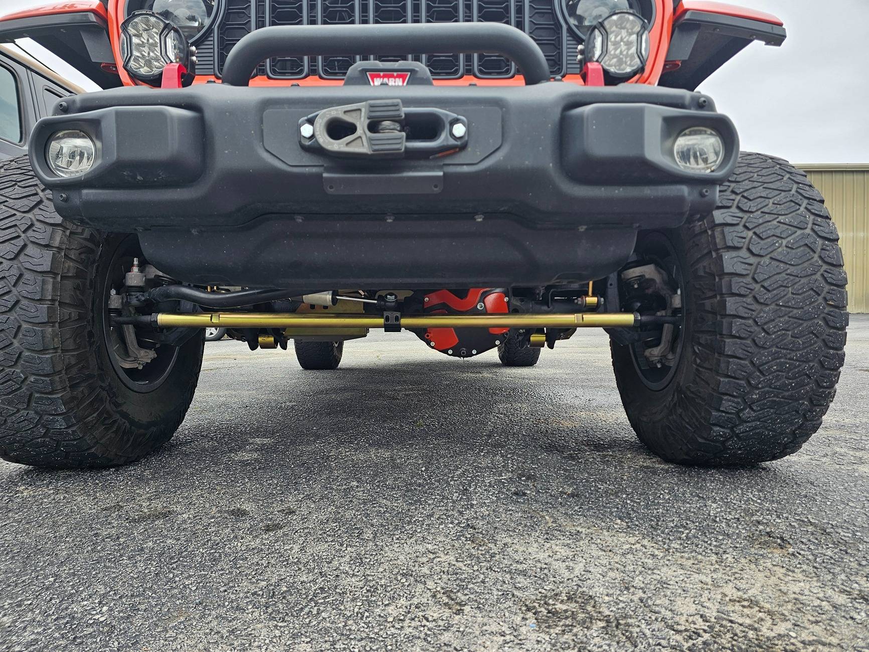

Lengthened my front upper control arms to 20 3/8, as a start after changing to 4.5” springs. The lowers were pretty close to 24.5” already, but I still think they need to be longer. Unfortunately, one of the upper frame side bolts broke upon torquing. Not super surprising as it’s probably been pulled and put back at least 8 times. But I had to cut what was left of it to get th stupid flag nut out. No luck finding what I wanted locally. So the dealer will take me over the coals tomorrow, to the tune of $8 per bolt and $16 per nut. Dammit. Oh well.
11,505
30,691
Ahhhh.............one broken bolt away from turning a 3 hr job into a 3 day shit show.

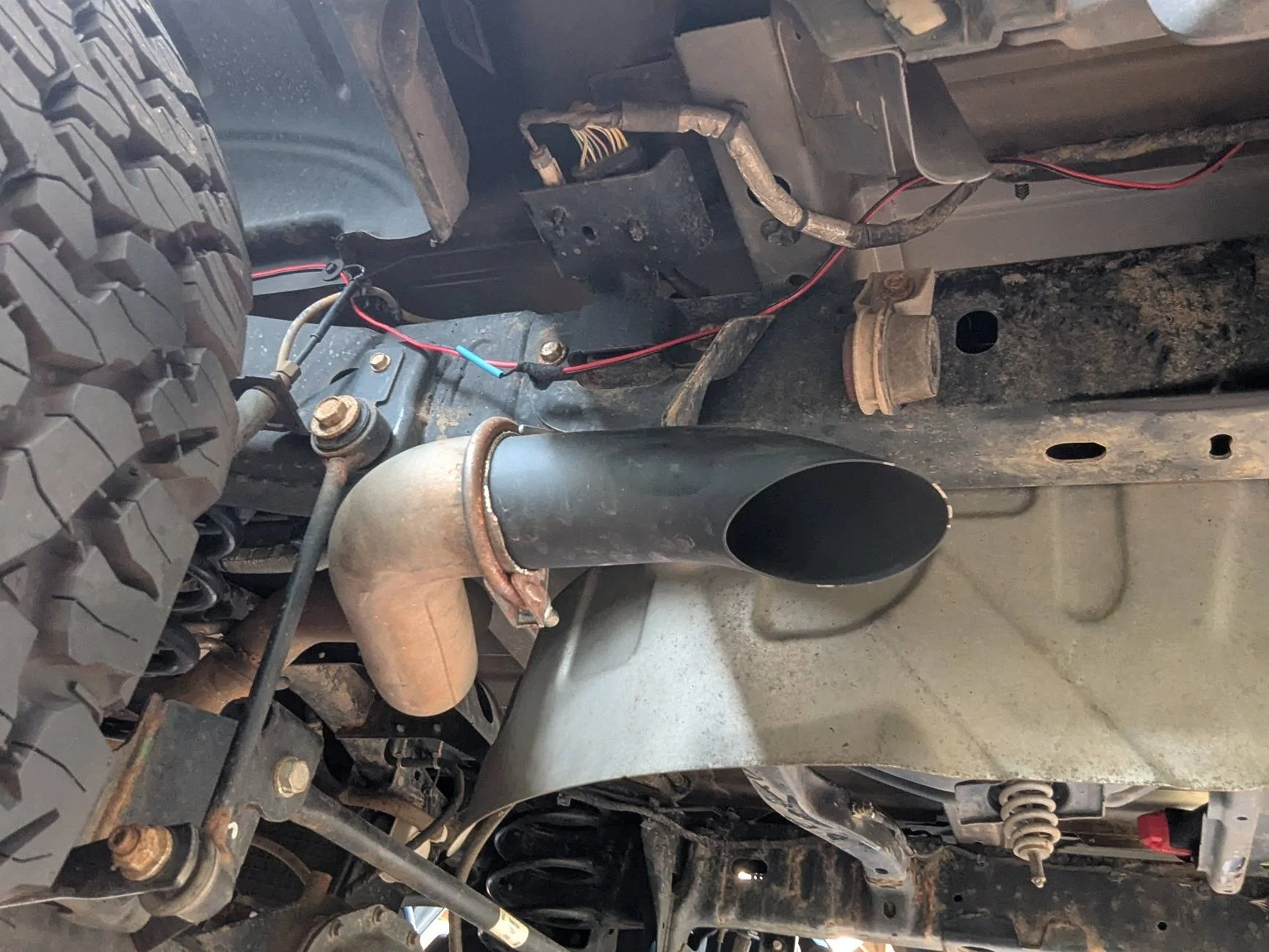

Since you made me paranoid I just cut a piece off the stock turn down and added it with a 3/8” self tapper and painted it black. It fit really nice actually.
Did mine a couple of weeks ago!
Jeep Gladiator What did you do TO your Gladiator today? [ADMIN WARNING: NO POLITICS, NO GUN TALK] exhaust turn down ti
