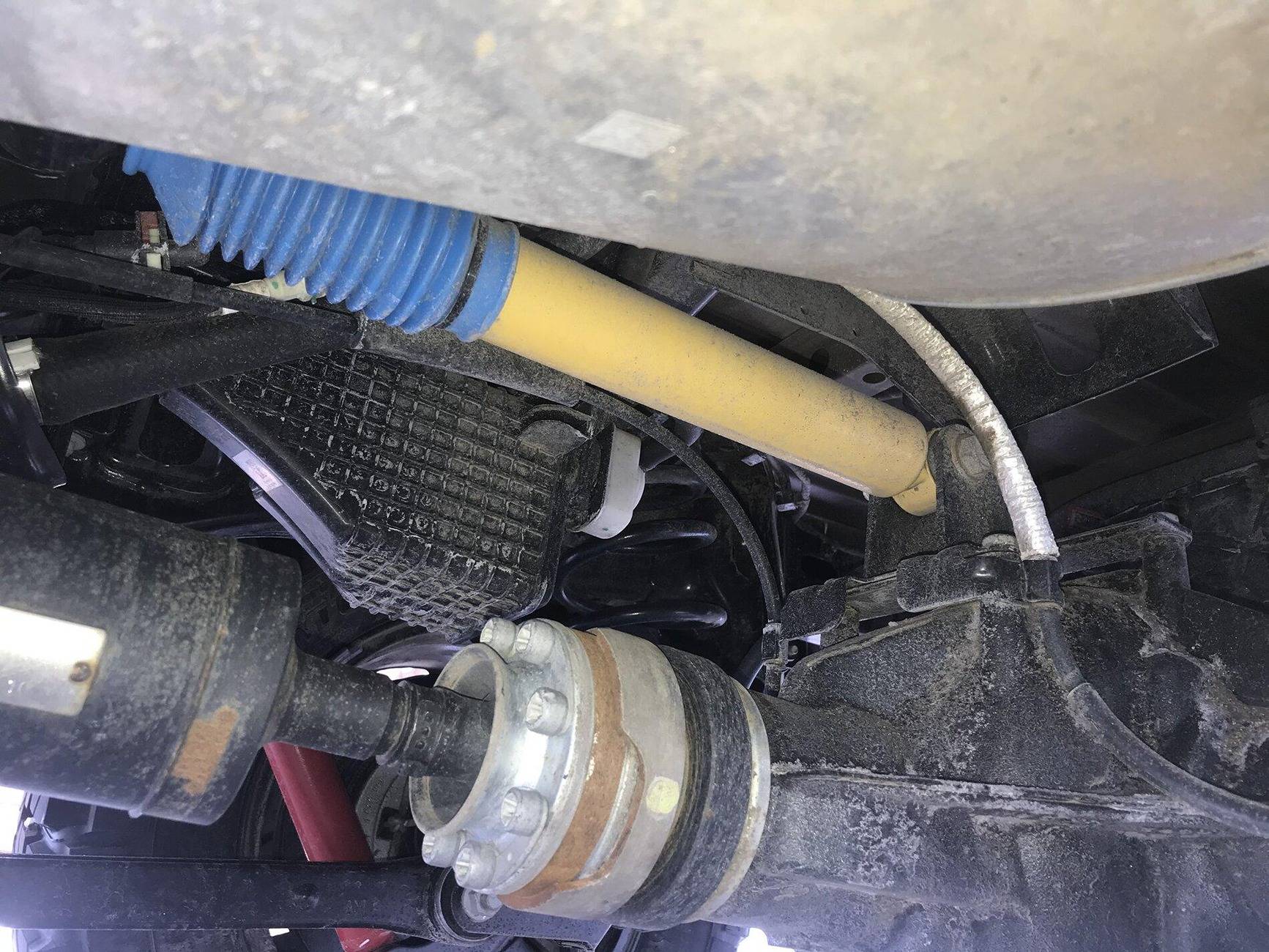

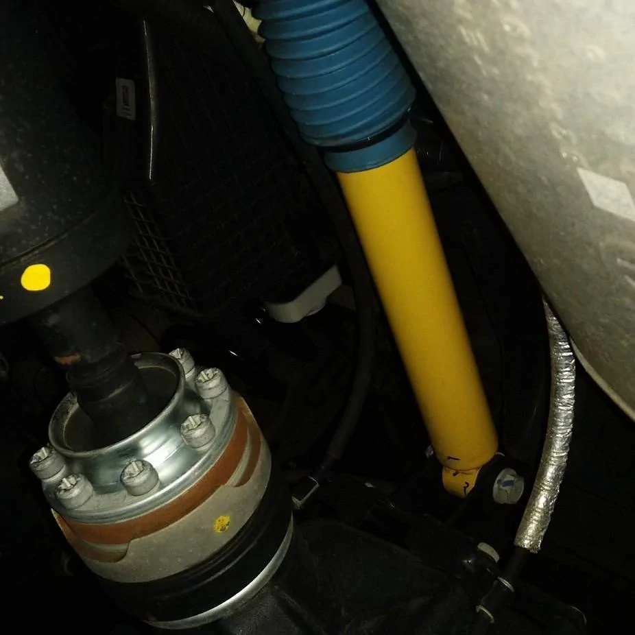

I have had severe axle hop with a prior JT in the snow pulling my trailer up an incline. It was so bad I thought I was going to break something. I really wish that JT had that "shock" on it at the time.
With the close proximity of the upper and lower control arms to each other, I'm surprised more people haven't had that problem.
I have the anti hop shock with my manual JT, but I haven't driven any other JT without it, so nothing to compare it to, to say that it makes a difference. It's also found on some Ram HD variations. Not a cheap shock to replace.

I installed the rear diff shock on my Mojave , wheel hop in the sand happened with the Mojave then the other seven trucks I have had on the sand over forty years. Was not terrible but the shock stopped it totally can’t make it happen now and only way to say it is the rear end just feels planted and tighter. I consider it a great mod. Have to thank Matt “Green71” who brought up to us, he is gone now moved onto full-size for towing a big camper ……Jack
