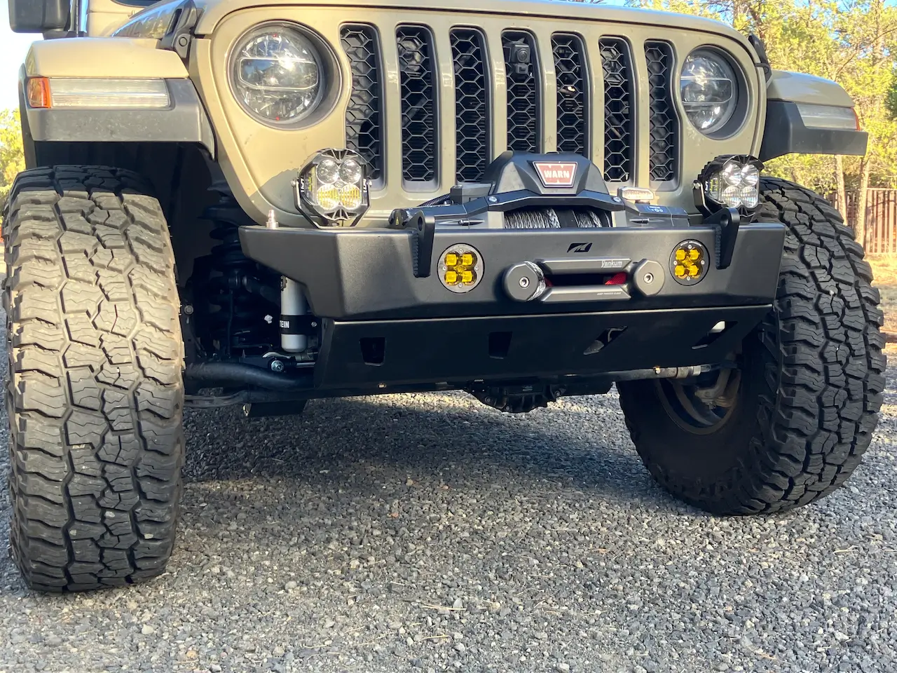

Finished giving her a nose job. (New bumper, skid plate and fairlead).
Jeep Gladiator What did you do TO your Gladiator today? [ADMIN WARNING: NO POLITICS, NO GUN TALK] IMG_2587

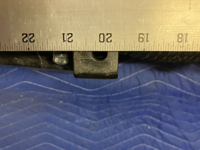

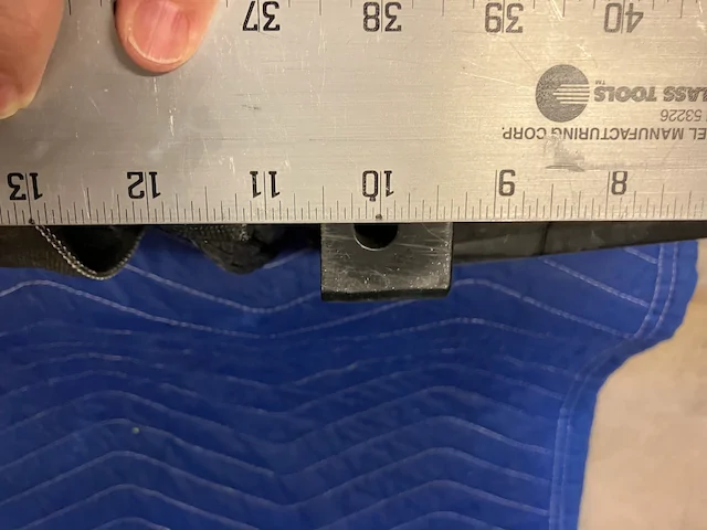

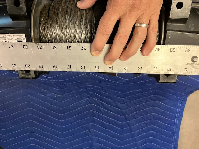

PSA: I haven't seen it mentioned anywhere but the mounting holes on the bottom of at least my Zeon 10-S are not 10 inches on center. The new winch mounting plate had round holes drilled precisely 10 inches on center, but when I was test fitting everything before taking it in to be powder coated, the winch mounting bolts had no chance of lining up. Oddly enough, the old Mopar mounting plate has oval slots instead of round holes.
Jeep Gladiator What did you do TO your Gladiator today? [ADMIN WARNING: NO POLITICS, NO GUN TALK] IMG_2563
Jeep Gladiator What did you do TO your Gladiator today? [ADMIN WARNING: NO POLITICS, NO GUN TALK] IMG_2564
Jeep Gladiator What did you do TO your Gladiator today? [ADMIN WARNING: NO POLITICS, NO GUN TALK] IMG_2565

I’ve been through that. It’s the winch. It’s a little splayed out. I had a Zeon platinum 12s that they replaced. The second one was perfect and hasn’t been an issue with three installs. Check the reveals where the spool goes into the two sides of the winch and take pictures. If it doesn’t look right, it’s an assembly issue. I’m guessing one bad batch that didn’t get caught by QC

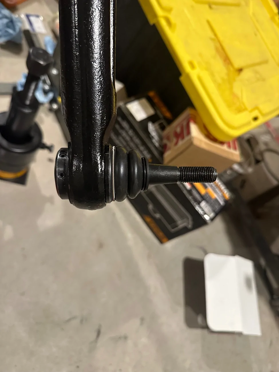

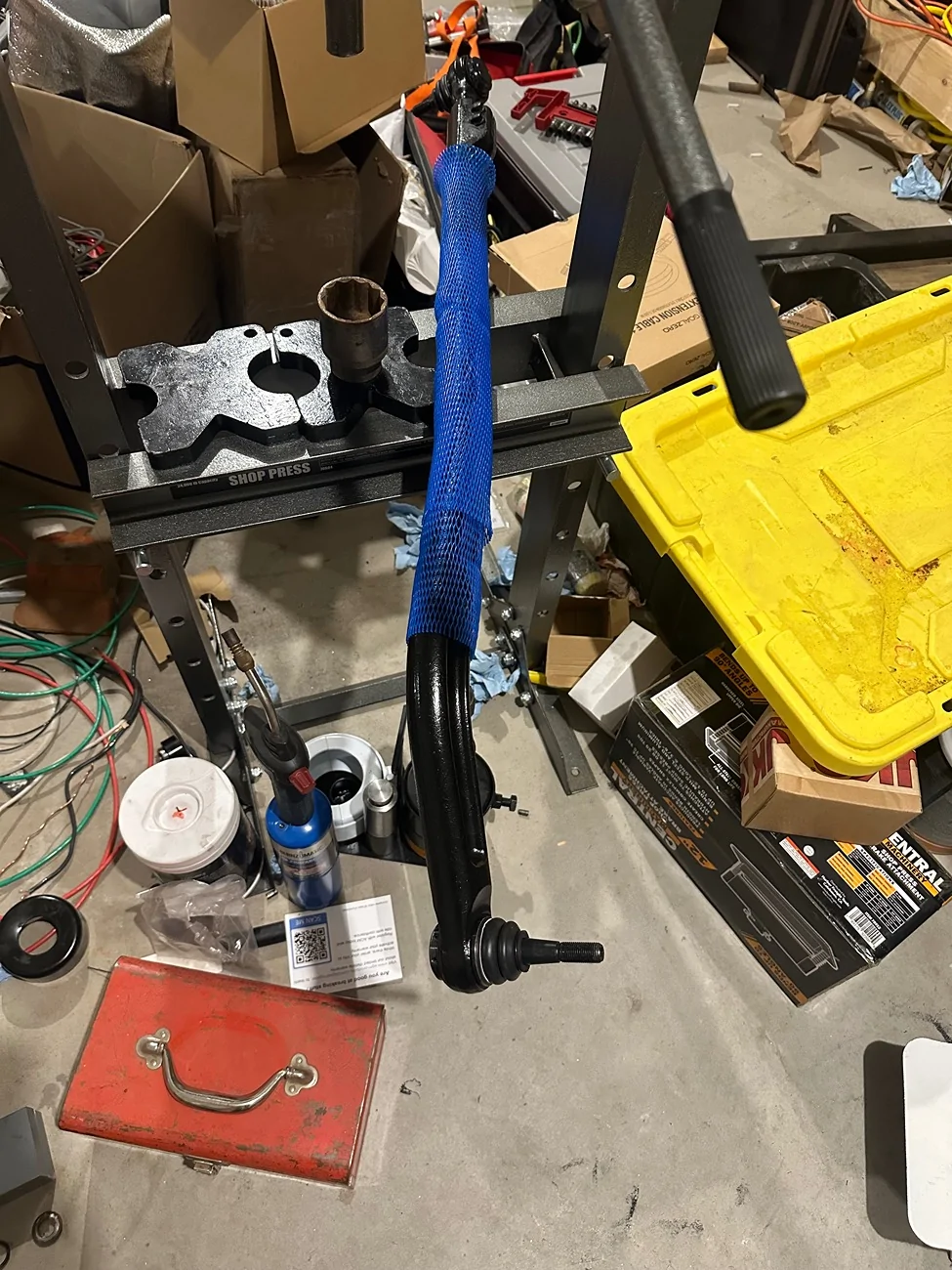

Pressed the knuckle end joint out of my new teraflex drag link. It’s symmetrical per teraflex, so I pressed it back in from the bottom, so I can install it as a top mount. They don’t sell it as a top mount, but I have their blessing to do so. I wanted their clamp style, so was fine making this change. I got a taper sleeve from apex chassis to handle the taper. Not installing tonight as I need to drive it in the morning to get its EXOshield installed.
Jeep Gladiator What did you do TO your Gladiator today? [ADMIN WARNING: NO POLITICS, NO GUN TALK] IMG_3899
Jeep Gladiator What did you do TO your Gladiator today? [ADMIN WARNING: NO POLITICS, NO GUN TALK] IMG_3900

Are you drilling the knuckle ?

Yes. My current top steer drag link is a no drill setup from steersmarts. They handle it with a special sleeve that goes into the bottom. But this will take a 7/8ā€ straight hole. The apex taper sleeve is split so it compresses as it’s tapped into the drill hole. If it needs to be switched back to bottom mount, the sleeve can be tapped out and put into the bottom.

So it is going to be trial and error to see if it improves handling ?

Figured it would be faster and easier to grind the holes in the mounting plate into an oval shape than try to get Warn to replace a used 2 year old winch that as far as I can tell works fine. The distance between the two sides of the winch is set by that top piece. I haven't messed with those bolts that bolt the top piece to the sides.

I’m not worried about that. It’s already setup with a top mount. I just killed the joint on the current link, on the pitman end. Squeak squeak and lots of play. So with all the drag links to choose from, there aren’t many strong ones that aren’t jam nut style. And I really like the two piece design instead of three, along with their super low profile clamp.
