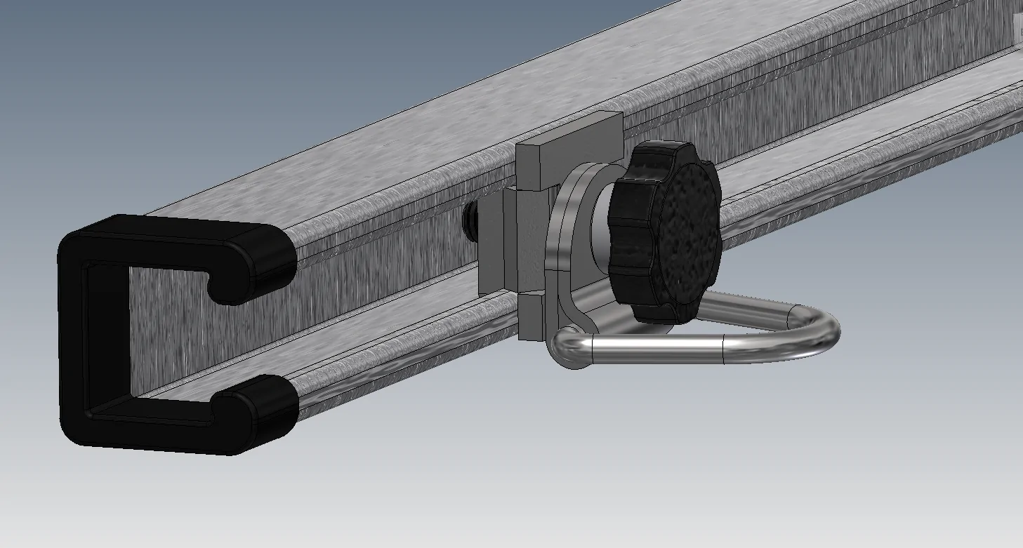

Coltron I would like to see the list and thanks for sharing.
I knocked it down to the bare minimum, I also had some tools I picked up like an M6 tap to clean out the nutsert threads of paint in the bed. And a deburring tool for the holes I drilled in the strut channels to mount them.
  • Front rail -- 3310T818 (Low profile, solid, black powder coated steel, 4 ft. lg)
  • Side rails (x2) -- 3310T589 (Standard profile, solid, black powder coated steel, 4 ft. lg)
  • Strut channel caps, low profile (x2, front) -- 3312T11
  • Strut channel caps, standard profile (x4 both sides) -- 3312T19
  • M6-1 x 20mm Flanged button head cap screws, 316 SS (box of 25, you'll need 12 minimum) -- 90909A729 (Don't have to be stainless, but I decided to. Be sure to lubricate threads to prevent galling. Blue Loctite will work for this. I ended up using 8 more of these for tonneau cover hardware, plus 4 M6 strut channel nuts for the front tonneau cover brackets -- 3259T33)
I went with solid channels because the slotted channels don't seem to line up with factory's placement of the nutserts in the bed. They have very wacky spacing. If I'm drilling holes anyway, no sense having wasted slots in the way IMO.
Tie downs were made using:
  • 800lb Tie down ring (x4) -- 33815T52
  • No-spin strut channel washer w/ 3/8" hole (x4) -- 3585T12
  • Plastic head thumb screws, 3/8-16 (x4) -- 91185A871
  • Strut channel nut, 3/8"-16 (x4) -- 3259T32
  • Unthreaded spacer, 3/4" OD, 3/8" Long, for 3/8" Screw -- 92510A795 (I went wrong here, because the CAD model where I put this all together made it appear that a 1/4" thick spacer would have been enough. I ended up finding 3/8" tall spacers at a local hardware, of course more costly, that made it work. McMaster's model of the tiedown loop isn't quite accurate.)
Below shows the way the channel washers, tie down, spacer and thumb screws all go together. This is showing it with the incorrect in real life 1/4" thick spacer. But you get the idea.
