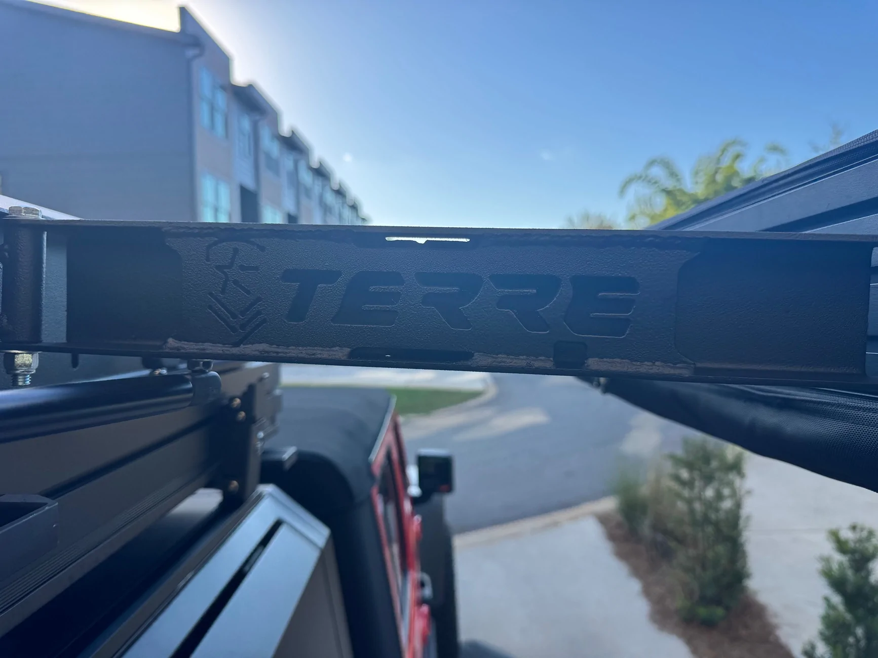

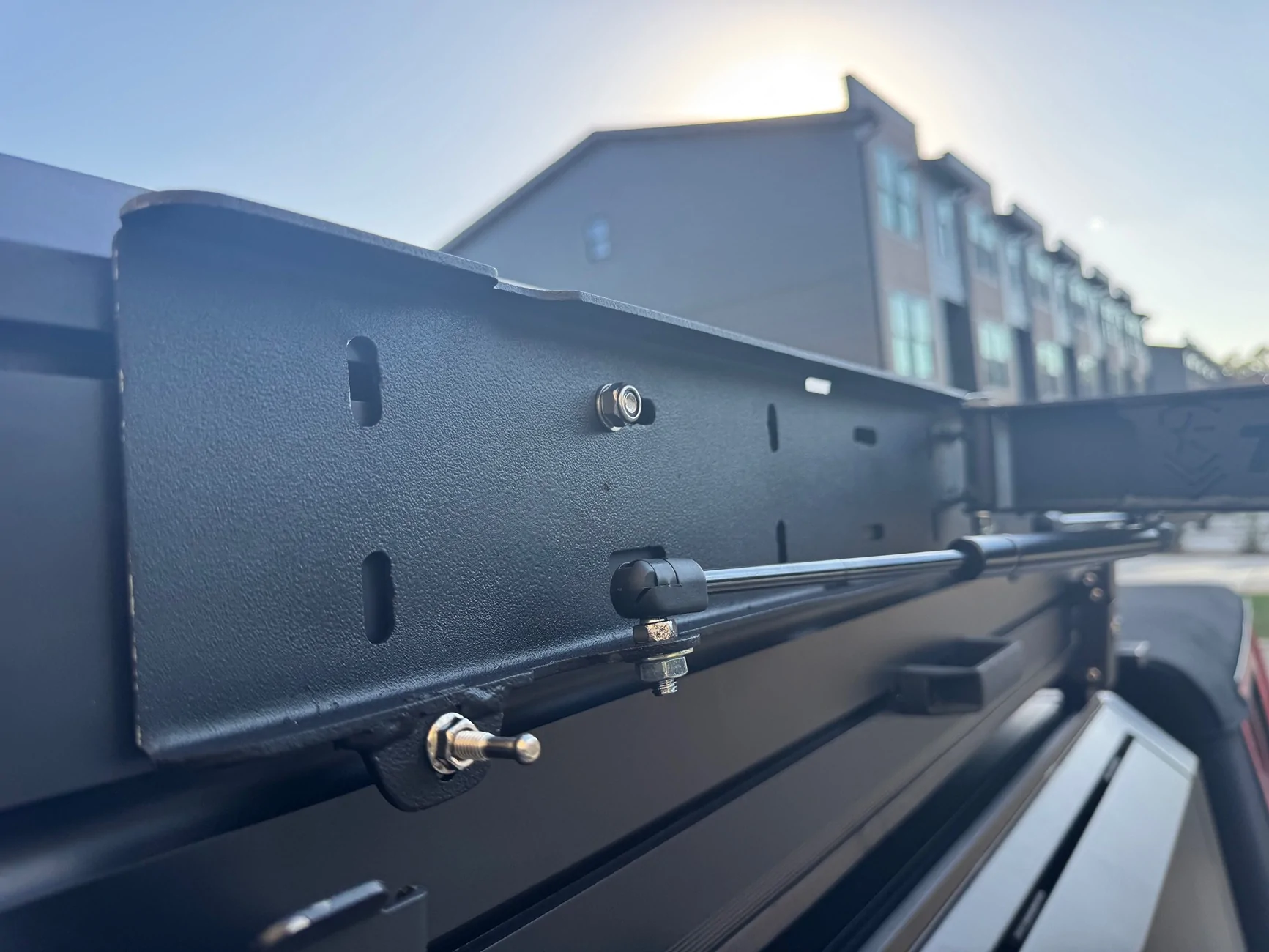

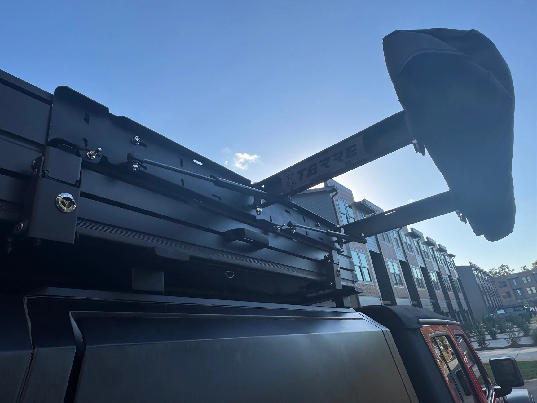

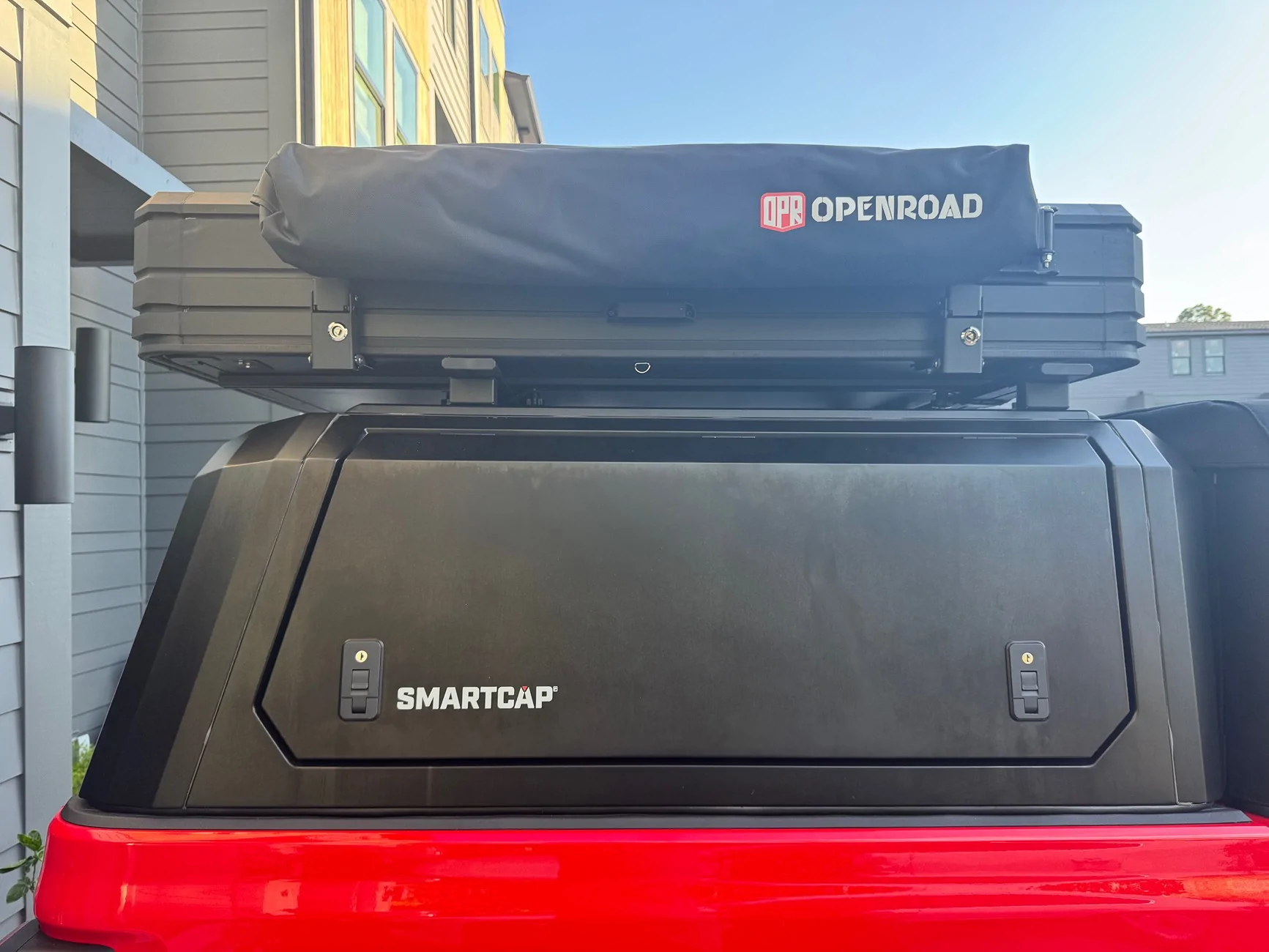

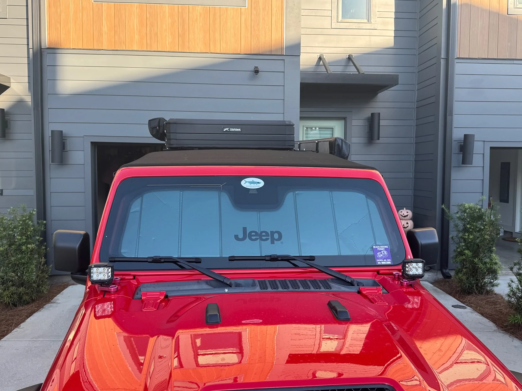

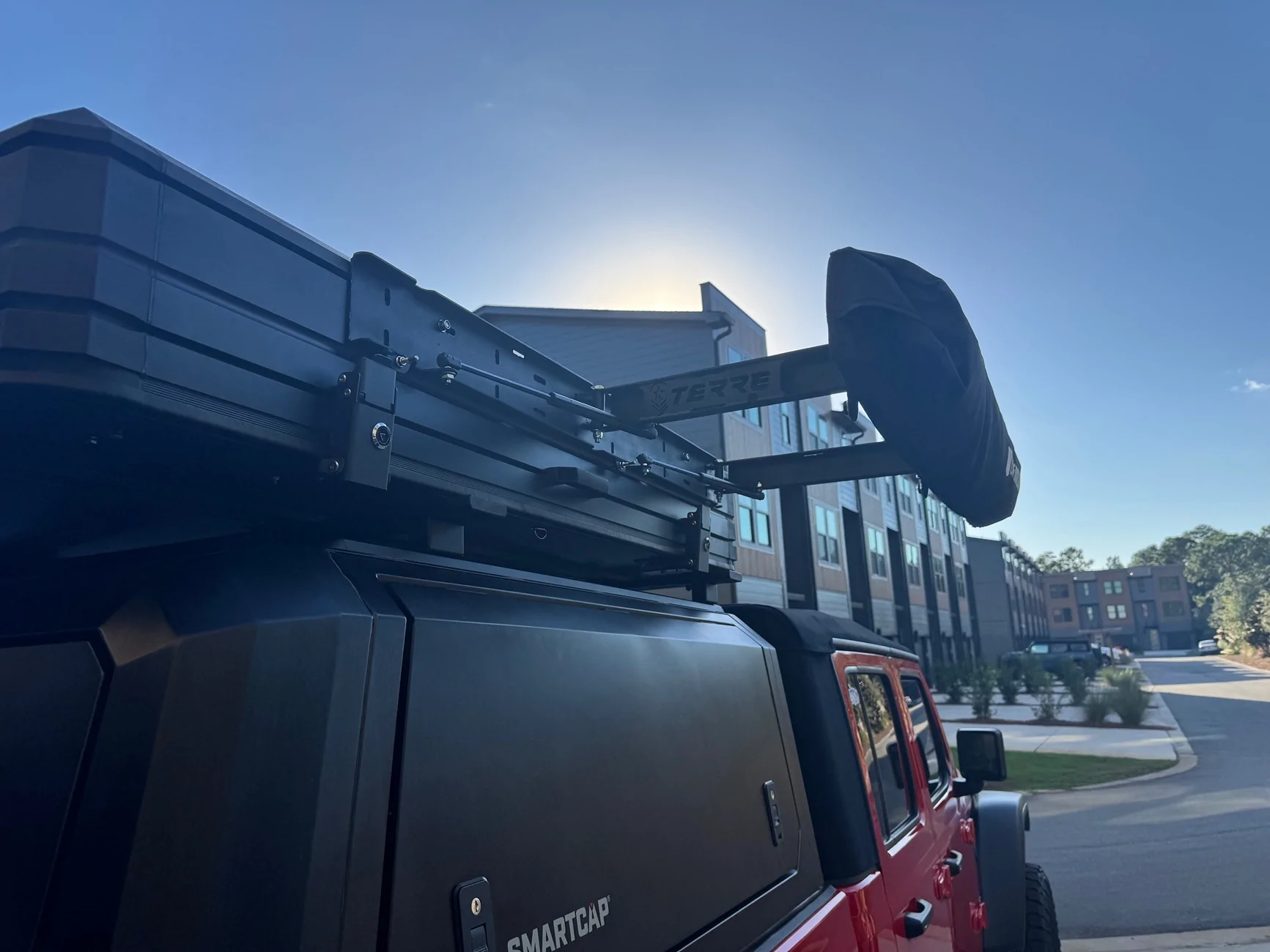

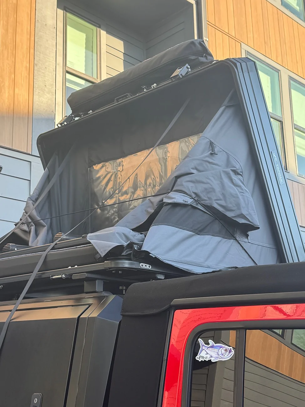

installed my Open Road 4X4 shower awning to my aluminum RTT hard shell tent ,mounted to a custom extension mount made by Baja overland, if anyone is interested he can be found on instagram. It wasn't cheap at 490 but worth every penny, quality fabrication and powder coating and extends the awning 16 inches away from the side of the vehicle. this awning is exactly the same as the 23Zero shower awning but much cheaper! I was concerned that the tent wouldn't stay open with the weight of the awning(17 pounds and mount approximately 20 pounds) but no issues, just needs a extra push to pop it open and extend all the way. I might get some heavier rated struts just to be safe. I have it mounted to the tent with 2 8mm bolts but going to ACE in the AM to get two more just to be safe. awning mounted to the bracket with 4 bolts, 2 on each extension arm bracket and this thing is solid.

I like the extension product, but I don’t get why you wouldn’t want to use the awning with the tent deployed.
good question, not a big deal to collapse the tent to use the awning IMO, I dont have any other place to mount it other than to the rails on the bottom of the RTT itself, which would mount horizontally across the back over the tailgate and a little lower than I would like. if I mounted it to the cross bars, the awning would prevent the tent platform from extending and also the side door wouldn't open enough to access the bin. New to this whole camping thing but really liking it so far and still tweaking my set up, if it become a hassle to use as mounted I will switch it to the other location, Honestly, I will give both a try but some compromises are expected.

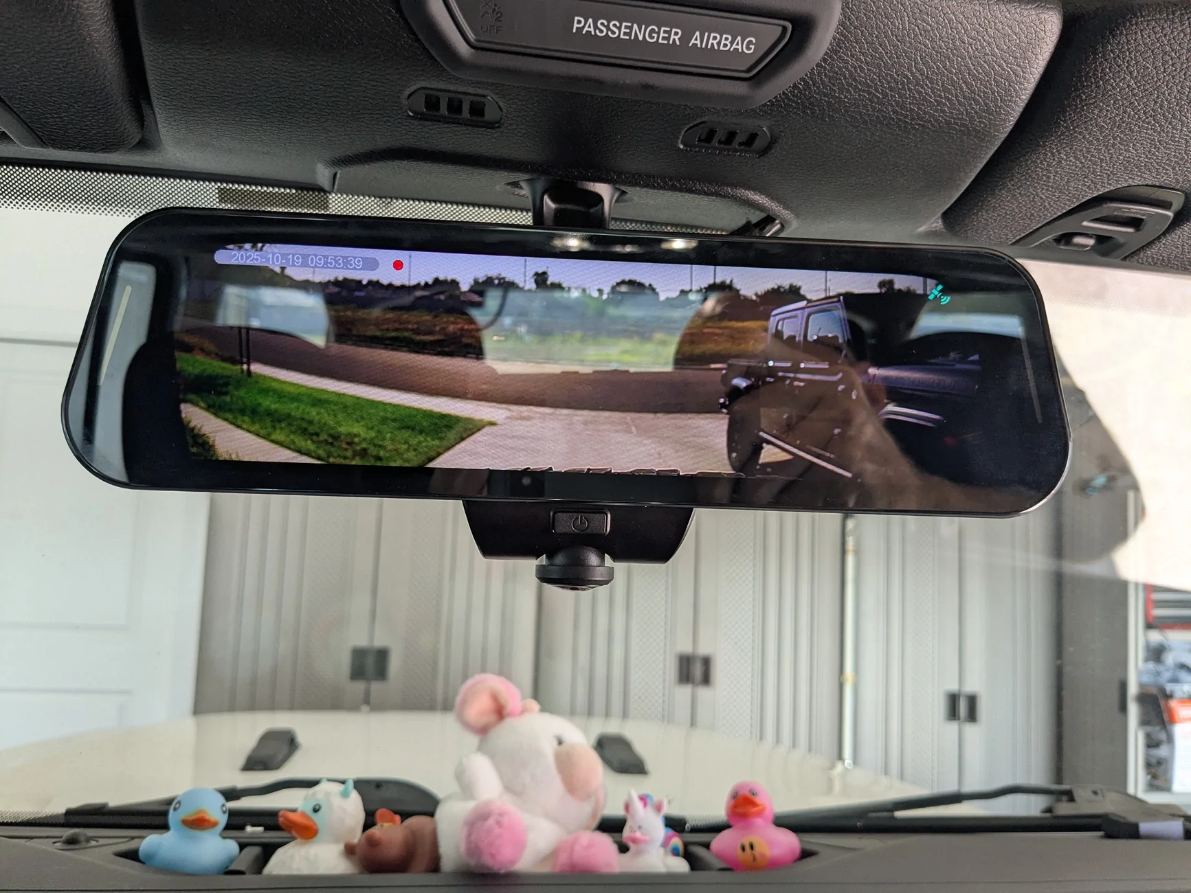

Added a Rydeen Tombo 360x dashcam, take-off from @WILDHOBO to my wife's JLU. With the bad drivers down in the RGV, and her JLU hit at least 3 times in parking lots, anything to catch video of any instance is better than nothing. I'll likely get the same unit for mine.
That’s my favorite thing about camping. Deciding what gear and how to set it up. I change things almost every time. So much fun.
