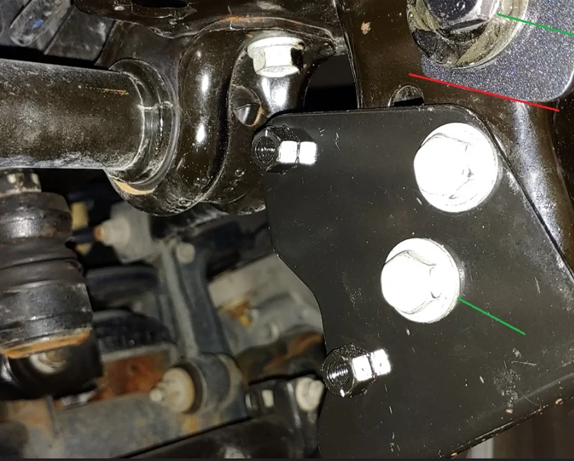

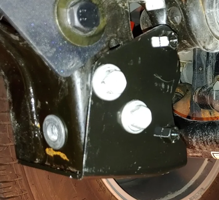

I ended up removing the skid plate brackets to get access to the sway bar mounting bolts. My recollection is that your skid plate brackets aren't as easily removable, so you might want to take a look to see if you can even get the sway bar bolts out. Otherwise it could be a spring project after your plow bracket removal.
Due to your current physical restrictions, when you're ready I can help get yours to where you can work on it and you can also see how well the manual knob works.
Odd, because the skid plate brackets are off to the inside of the frame and the sway bar bracket bolts are in the centers of the frame rails. I dug out pictures, and didn't see where the brackets would have to come off, but it's really not hard to remove them anyway.

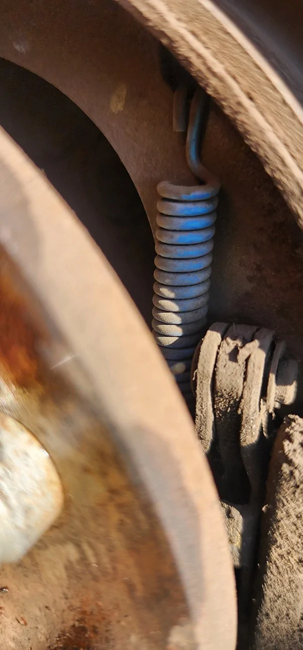

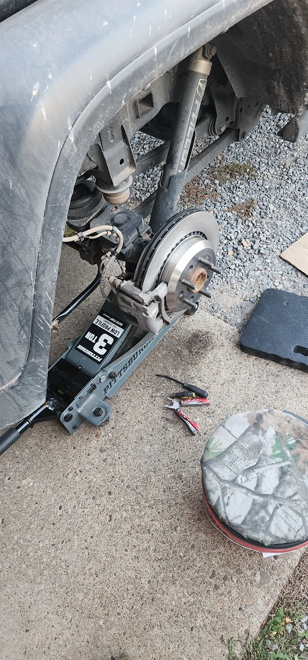

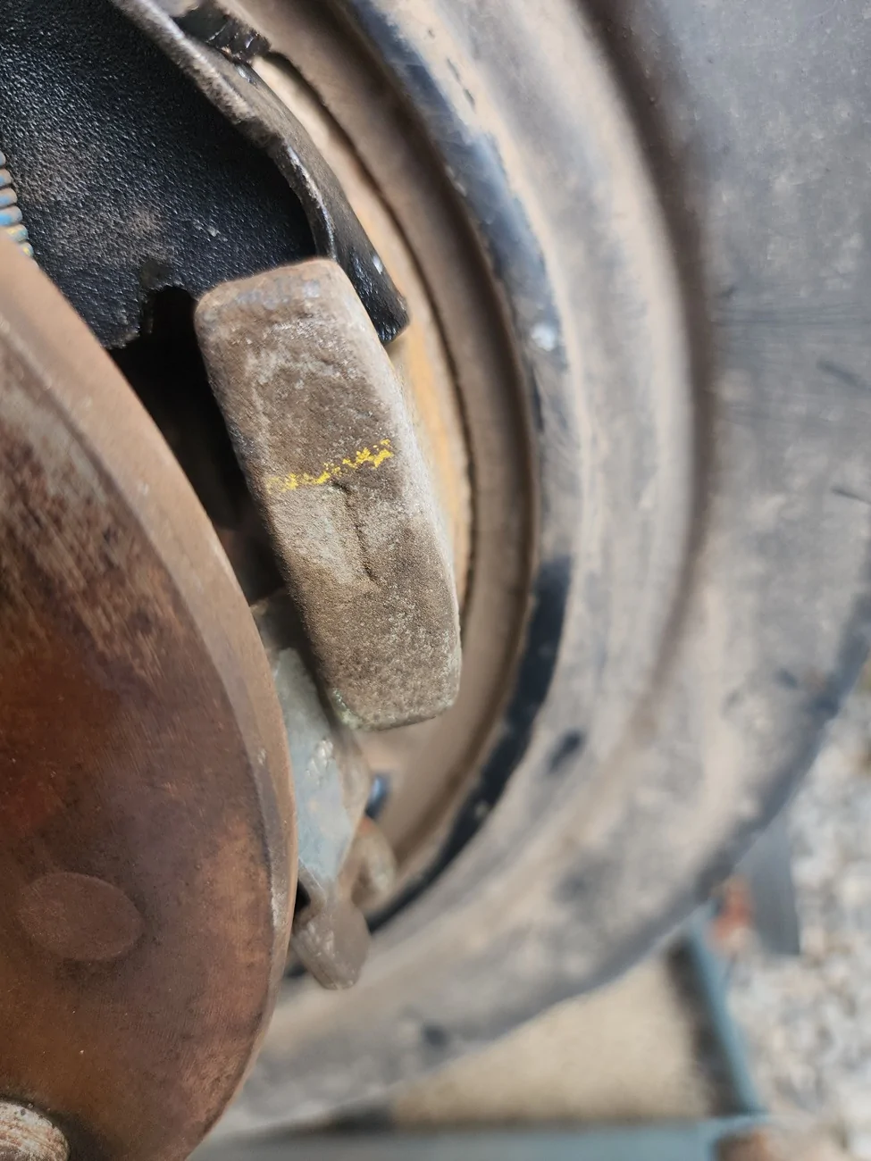

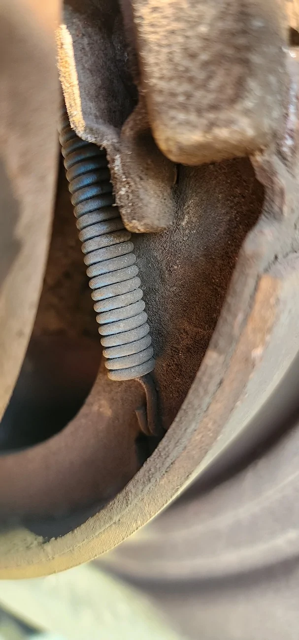

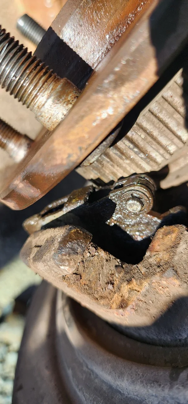

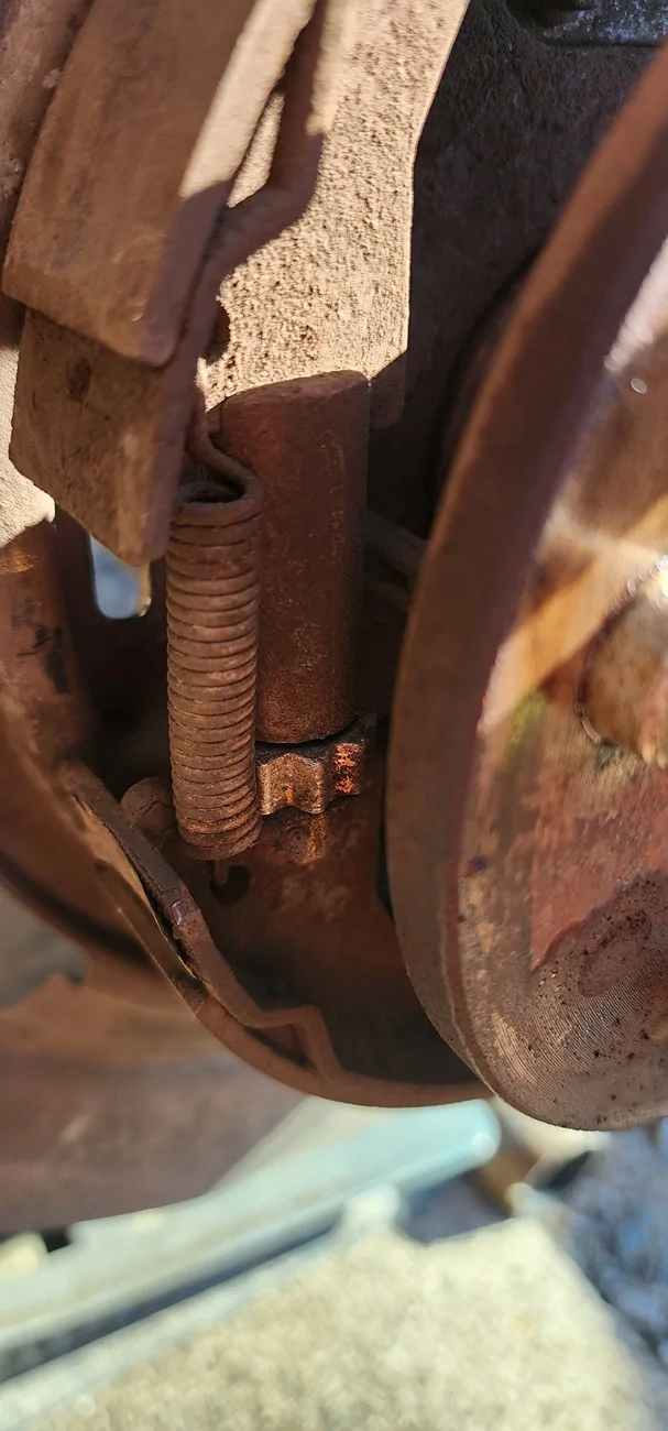

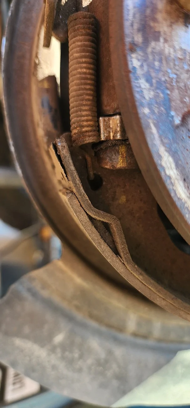

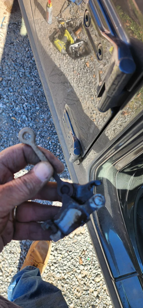

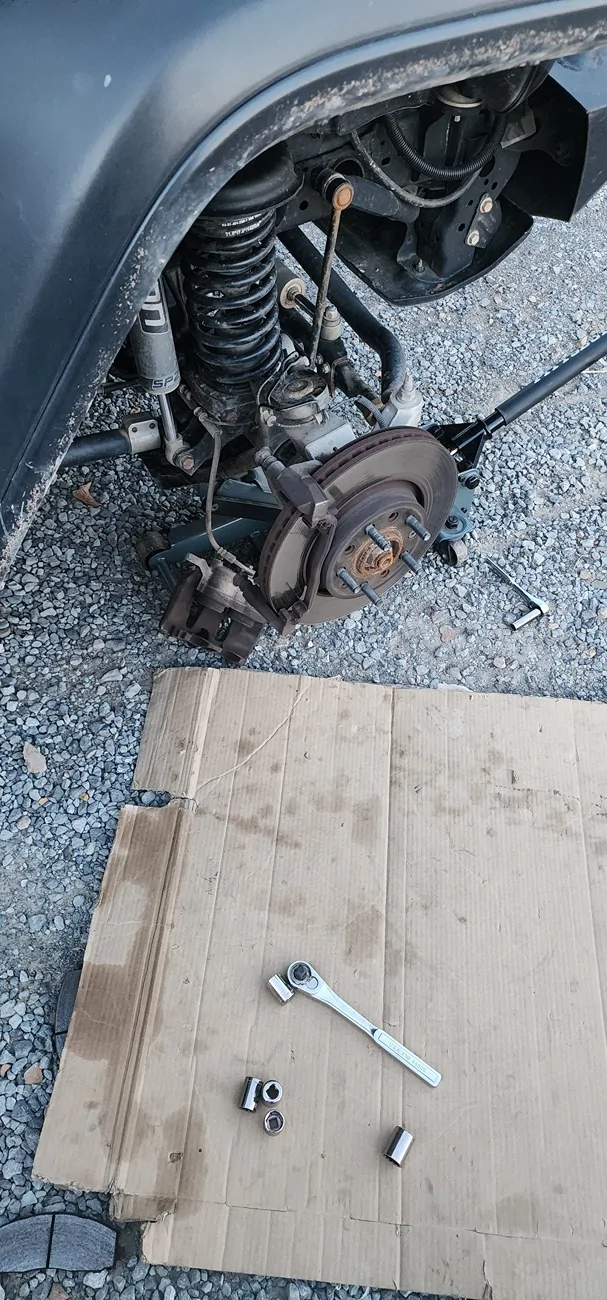

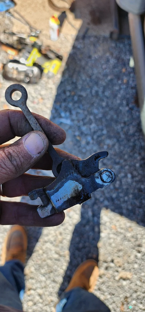

I got it done about an hour ago , but I didn't stop with the rears I did the front rotors and pads also . And rotated the tires . I hope to NEVER have to replace those emergency brake shoes again.
OMG those things was soooo freaking difficult. You was right @WILDHOBO , the cantilever shoe spreader was frozen on bothe sides. It is super weird that the adjuster and the spreader are backward from the opposite side . Obviously the reason for the arrow in the casting. Only thing I can figure is that the adjuster would screw backwards so they flipped everything....oooooor 🤷 this allows them to come on at the same time 🤷🤦
The Devil designed those E-Brakes
I am embarrassed at how long it took me but with frozen parts and then the spring from the Devils workshop I had a Heck Of a time . I WILL SAY IT TWICE. I hope to never have to replace those E-Brakes again.
Have you worked on brakes before these?
Oh yeah but those are the most difficult I ever done i have never seen a design like that either. Those springs have extreme force and the one in the back then in the front ( the long ones 😳) just horrid !
Additionally the cantilever spreader is super difficult to hold in place while trying to get thos springs on there is so little room . Awful job. I was many many hours.
Just wondering as there have been left and right adjuster screws since forever.
Yes but in this design the spreader is upside down versus the other side which doesn't make sense.
Me too. Hopefully never again. But happy I did it.
I have SO MANY times, for a diy person that is. And those parking brake shoes are rough. Really rough.
And he has, many times from what I gather talking to him. It’s just an awkward setup that requires you to have seven hands and an octopus brain.
