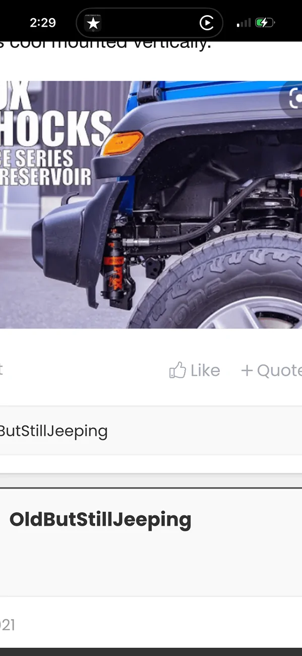

They do sometimes get in the way of things there. @ShadowsPapa had to move his in to clear his plow brackets. He and I tried to mount a rubicon swaybar on his, but the reservoirs are in the way. I’ve heard other examples of why the reservoirs needed to be moved. I like my piggyback reservoirs for that reason.

Something like this could work though, with virtually any bumper.
https://www.jeepgladiatorforum.com/...ng-mojaves-shock-reservoirs.43922/post-707646
Jeep Gladiator What did you do TO your Gladiator today? [ADMIN WARNING: NO POLITICS, NO GUN TALK] IMG_5334
And these brackets could likely be used pretty much anywhere.
https://barnes4wd.com/products/jeep...aYTPhhzsEKYbbN65cjfkVphj4qmXDWzcfC76_1fwfGaxx

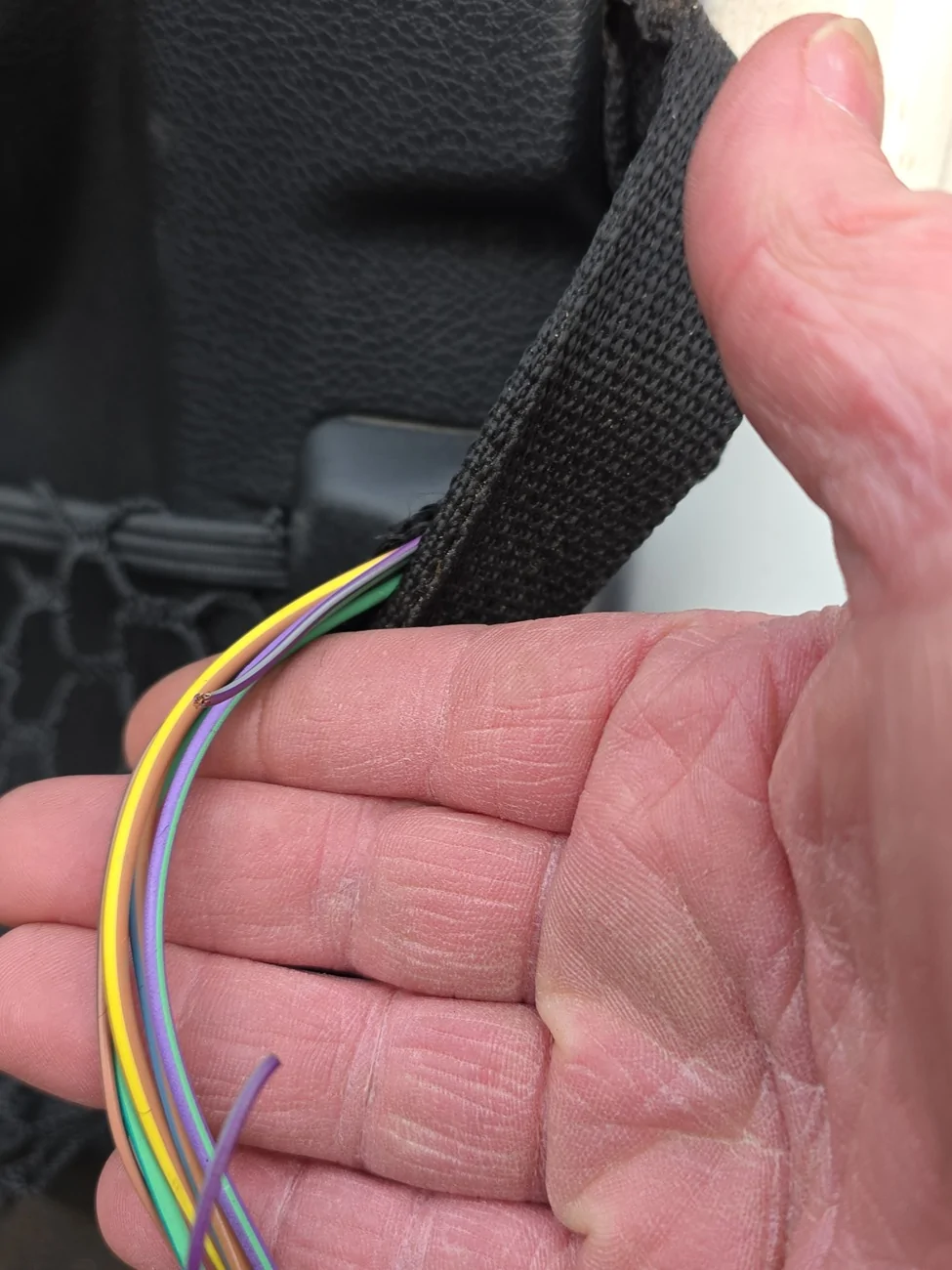

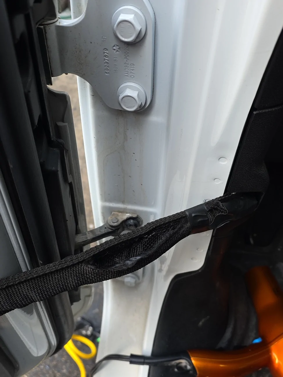

Today I fixed the wiring for the driver's rear door
Jeep Gladiator What did you do TO your Gladiator today? [ADMIN WARNING: NO POLITICS, NO GUN TALK] a7c51e2c-e8cd-4f61-bb73-6a7b62bbb615
No shit. Dome light didn't work for that door. Stealership wanted to replace the door latch actuator. No thanks, I'll figure it out. Rear door was easier than driver's front door. Both were about halfway, where the strap bends when door is closed.
Jeep Gladiator What did you do TO your Gladiator today? [ADMIN WARNING: NO POLITICS, NO GUN TALK] 841804ab-a0ca-4755-b6a3-8a59cc863290
Nice work. I really need to check my passenger front. The mirror won’t adjust on the down/up axis. I’m guessing a broken wire based on your post. How did you open the fabric cover?
