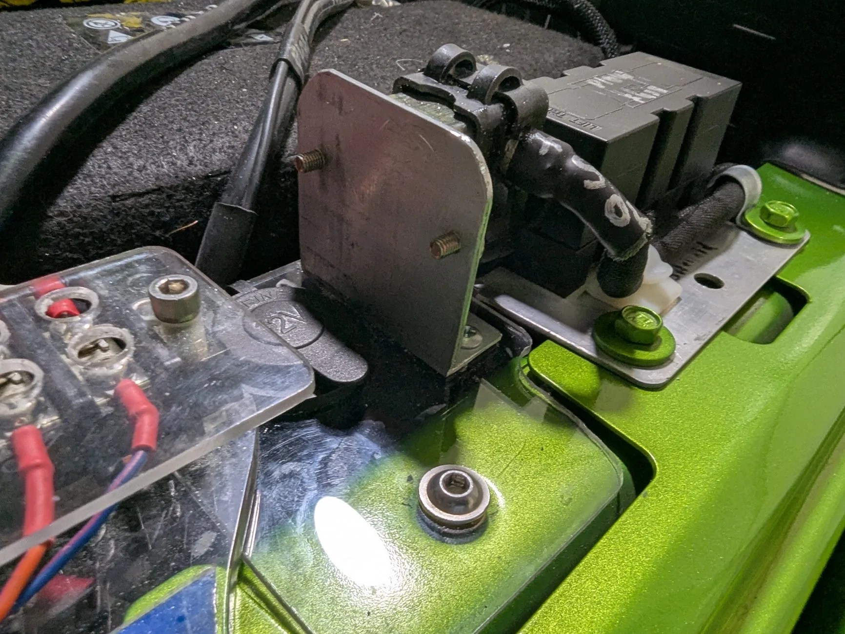

Made myself totally sick for a few hours............ tried to run a wiring harness into the bed to supply power for my trailer winch and got so far and had to quit. Can't lay on a creeper working under things any more.
I did get the panel in and the wiring started, but this is as far as I got before I had to stop. At this rate working minutes at a time or when I don't care if I get a headache and dizzy - it will take days just to run the harness to the engine bay!
I also ran another wire in the bundle to hook an aux switch to the bumper mounted Oracle backup lights so I can run them any time I want for light at the rear. That's the reason the tail light is out..
This panel came from a forum member who prints them.
I'll likely run from here over to the left side and put a 12v outlet there to power things like a cooler and so on. I'll use the plastic panel they started putting on the left side of the bed in 24 model year for that.
Gotta run this up along the top of the frame and strap it to existing wiring, and up into the engine bay to connect to a breaker for the heavy wiring for the trailer winch, and the other to the terminal strip for the aux switches.
You can just see the diode in there - I'll connect the aux switch wire to the other terminal on that. The backup lights are already running through it to power the extra backup lights

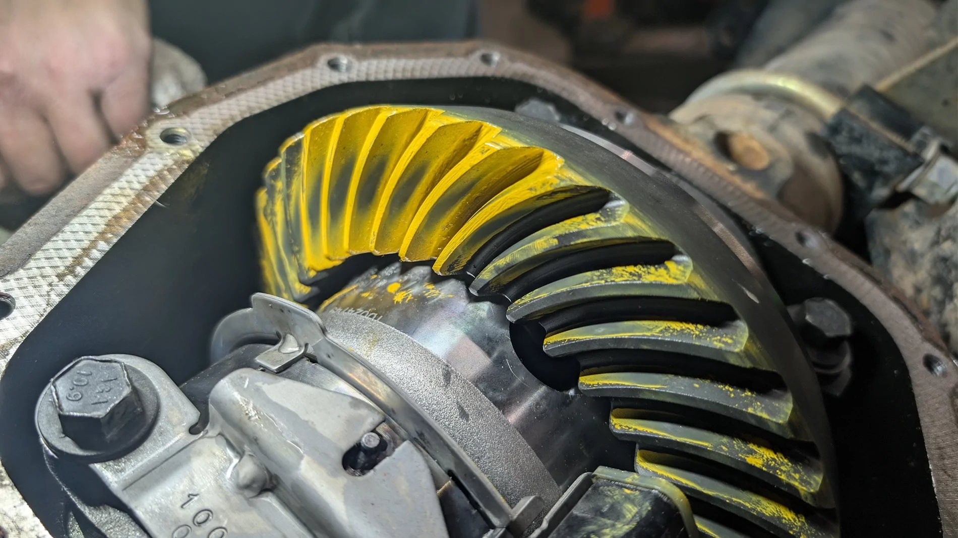

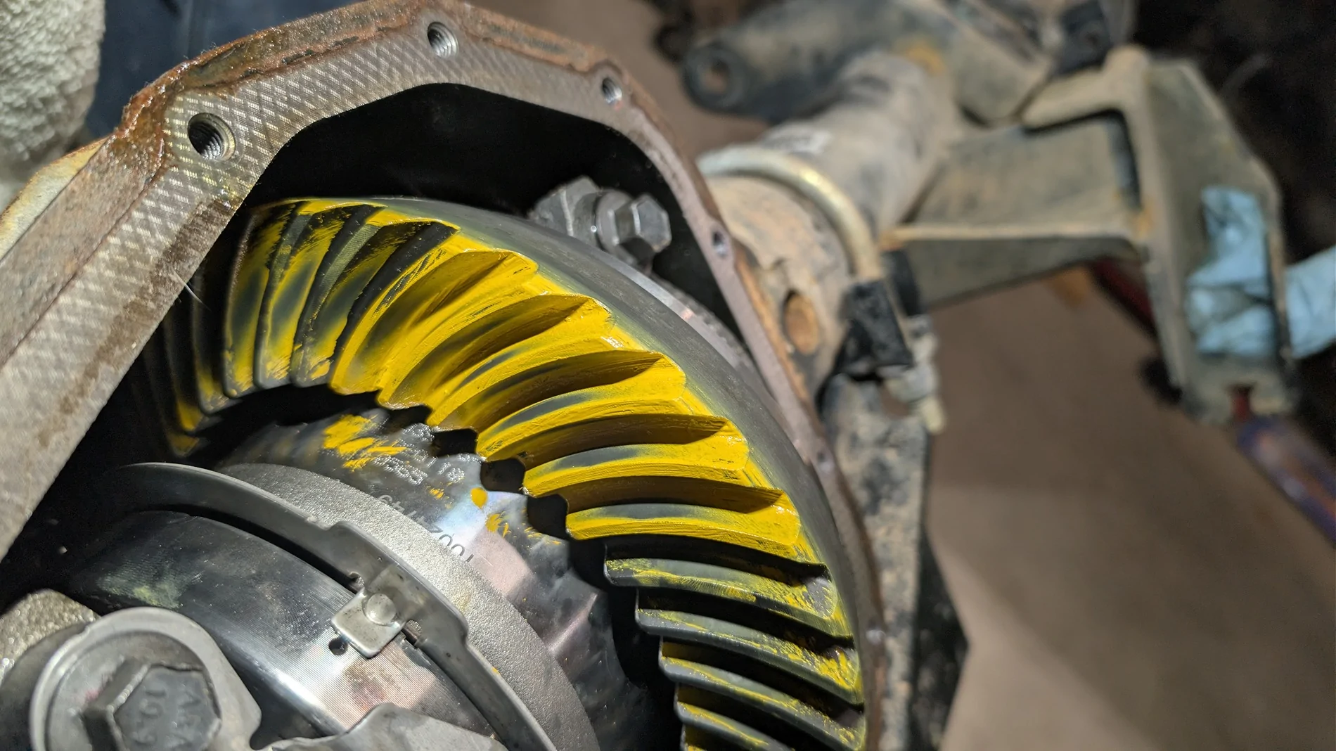

Gears done. Truss burned on.
Front pattern was really difficult to get acceptable. Rear ran an almost perfect pattern with the factory shims.
I've got more work to do before I throw them back under the jeep.
I had a old D-44 that getting a good pattern was a PTA. Old castings and machining with a 60 plus year old design.

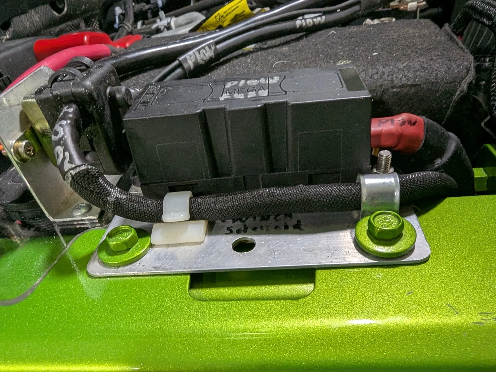

Details and pictures later - but the bundle of wires wildhobo helped run along the frame into the engine bay is all terminated and tested out.
I can trigger the winch solenoid (aux 3) to provide power to the rear anderson connectors.
aux 4 and I have live bumper backup lights without being in reverse or running
Aux 2 and I have power to the USB charging ports in the bed and eventually for a 12v outlet in the bed as well.
I had to make a bracket to raise the 50 amp breaker up and out of the way and those 8 gauge wires take a lot of space and don't flex a lot once the protection is on the wires.
the wire here coming from the right to the breaker comes from the winch side of the disconnect solenoid. so powering the solenoid powers the winch in front, and the Anderson connector in the bed that will power my trailer winch.
