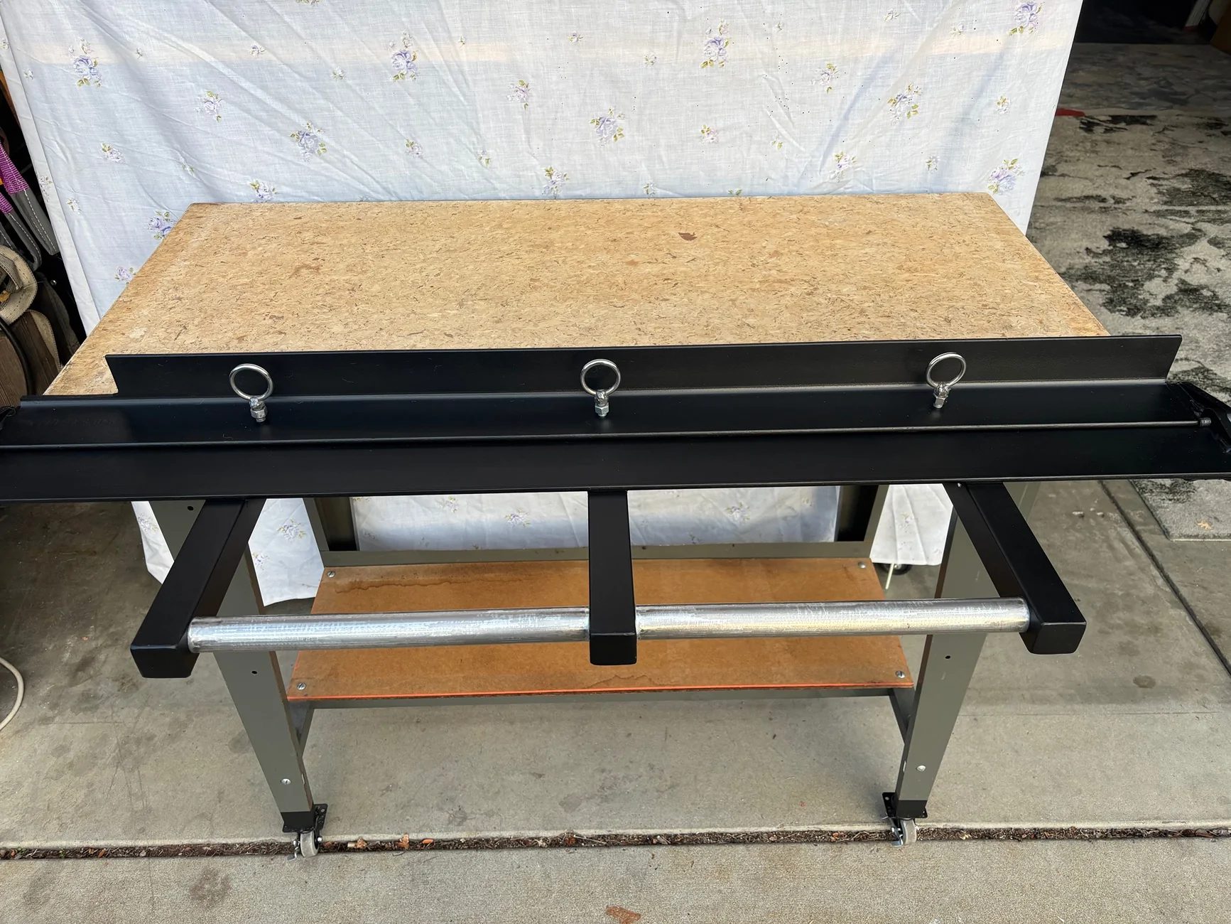

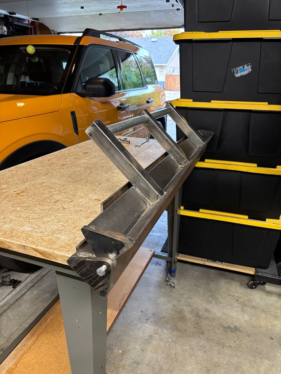

Yep…I built this one, it’s a 48”, I use it a lot more than I thought I would.
You built your own brake?! Damned impressive.

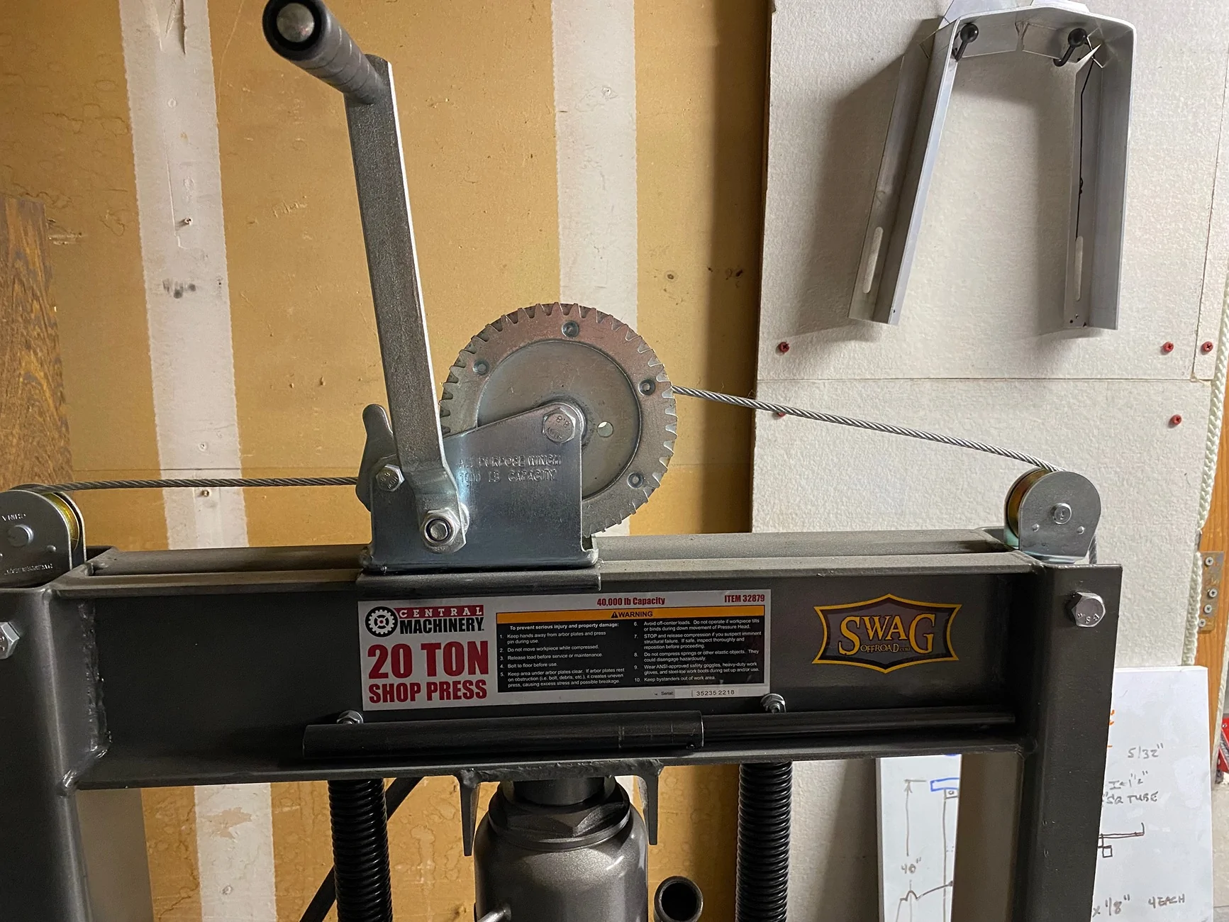

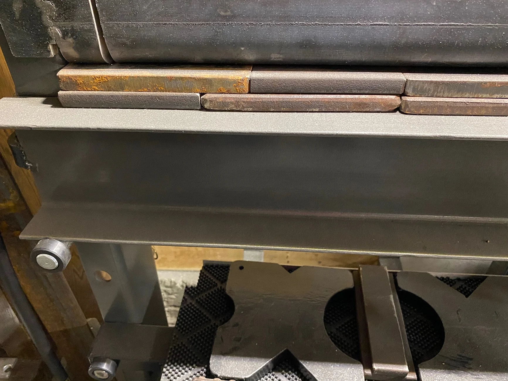

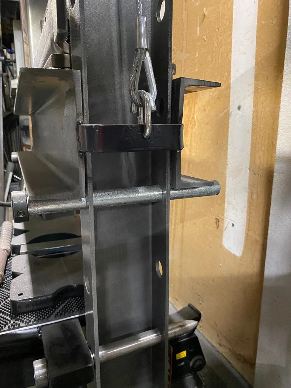

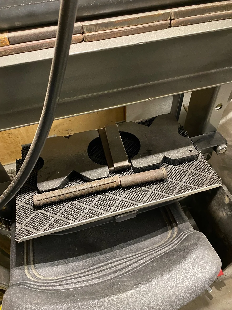

SWAG off road has a finger break for the multiple bends, it comes in a kit as well. I’ve got the 20 ton HF press, I can do 16” width. I also bought an air over hydraulic 20 ton jack for it…that was HF, it takes most of the work out of the bending and it’s fast. I’ve done 5/8” mild steel with it. You’ll never have to buy brackets again.
I've been thinking of building something similar, or just buying one from HF that fits in my hydraulic press. The HF one can only do 12", but I can't think of any time I needed to do anything longer than that.

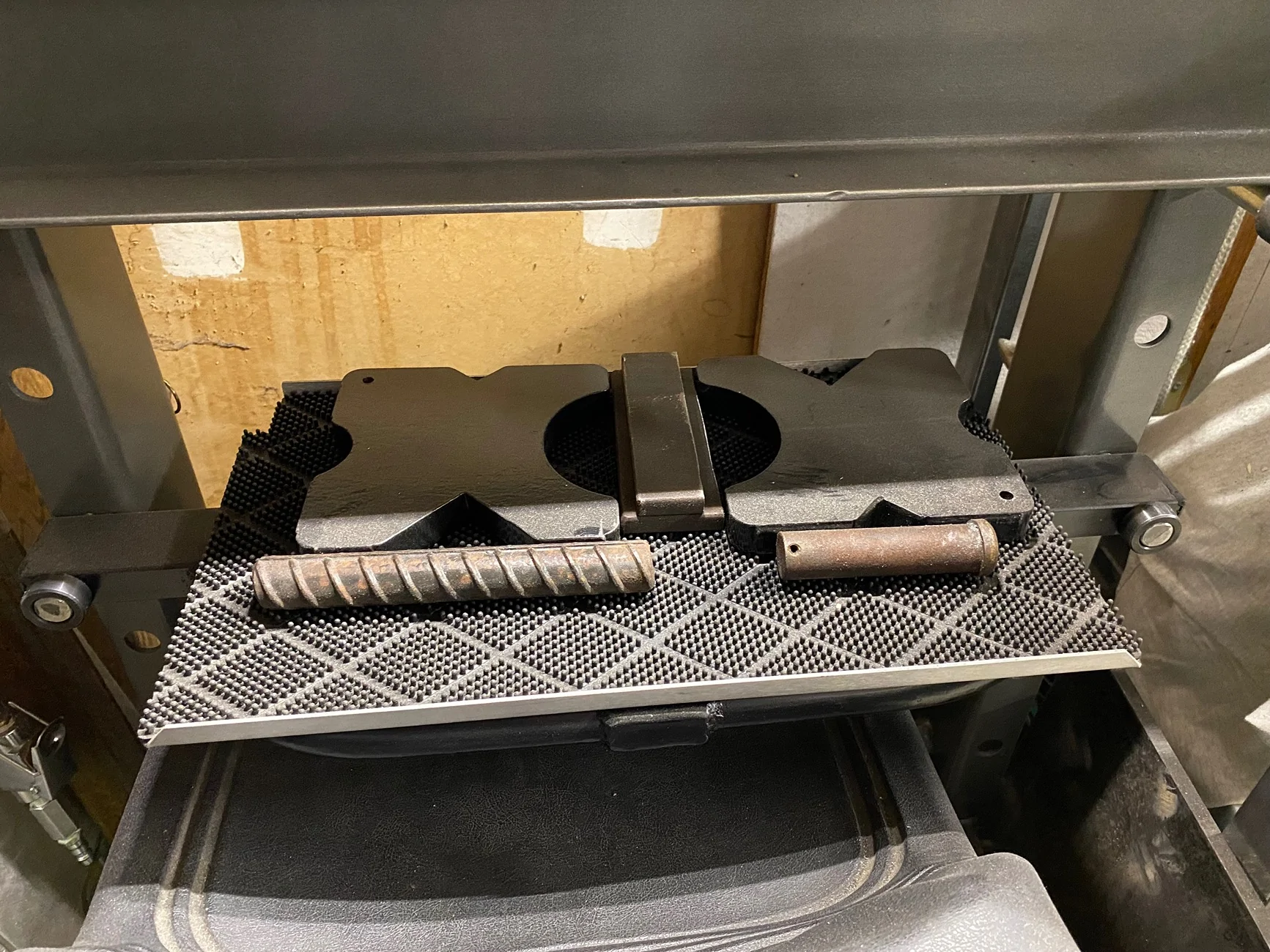

The 12 ton from HF is a pos in my opinion, but it’s been demoted to be a press brake only. Works fine for that. But I’ll be getting a real press before the next gear job. I had to drive to a shop and borrow their press last time. But I’ll keep of for the 12” brake, as it was like $160. So screw it. I’ve only used it a couple times, but love that I can make custom brackets. I used to be limited to cutting pieces of angle iron or c channel to figure out usable brackets.

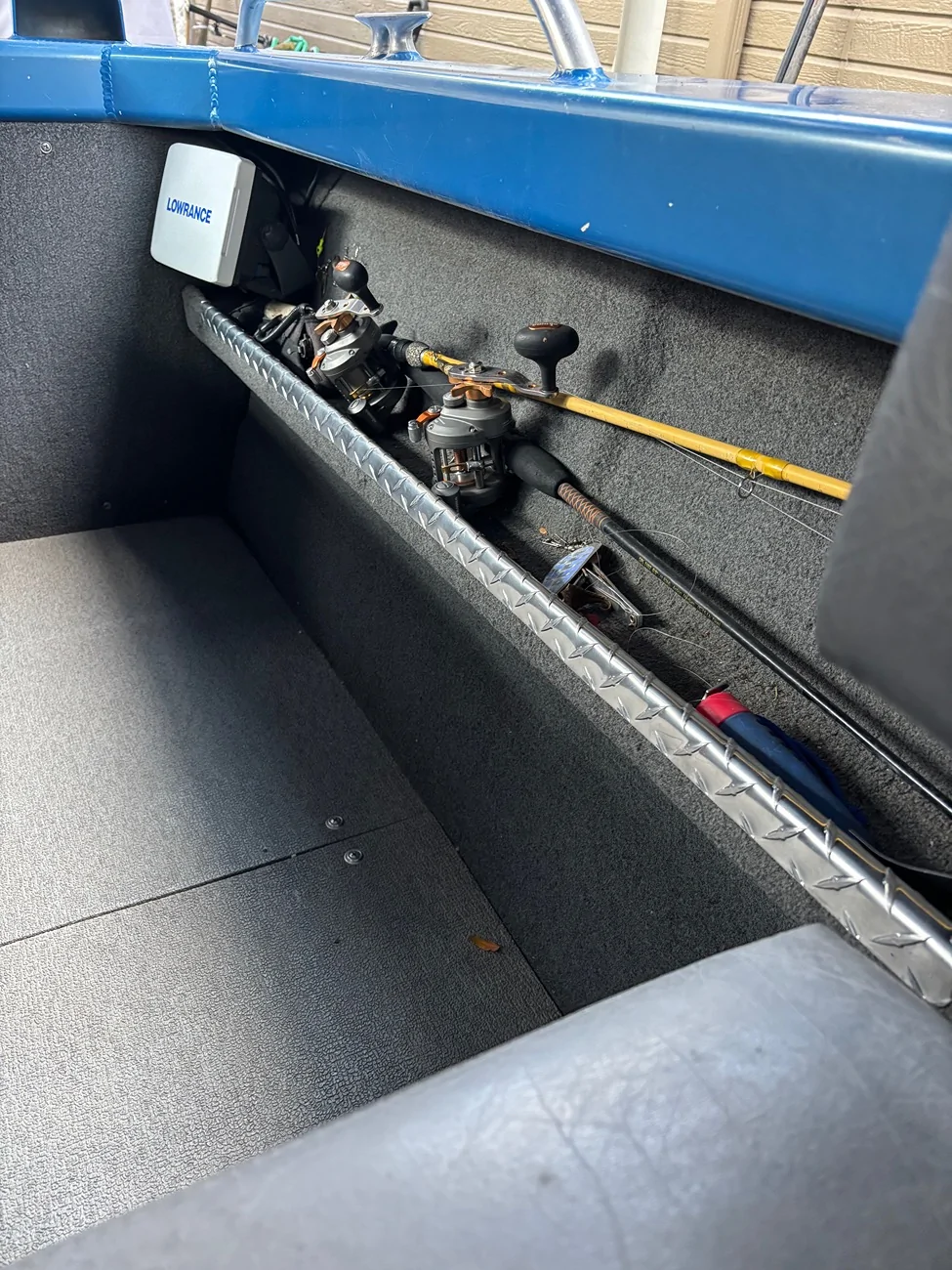

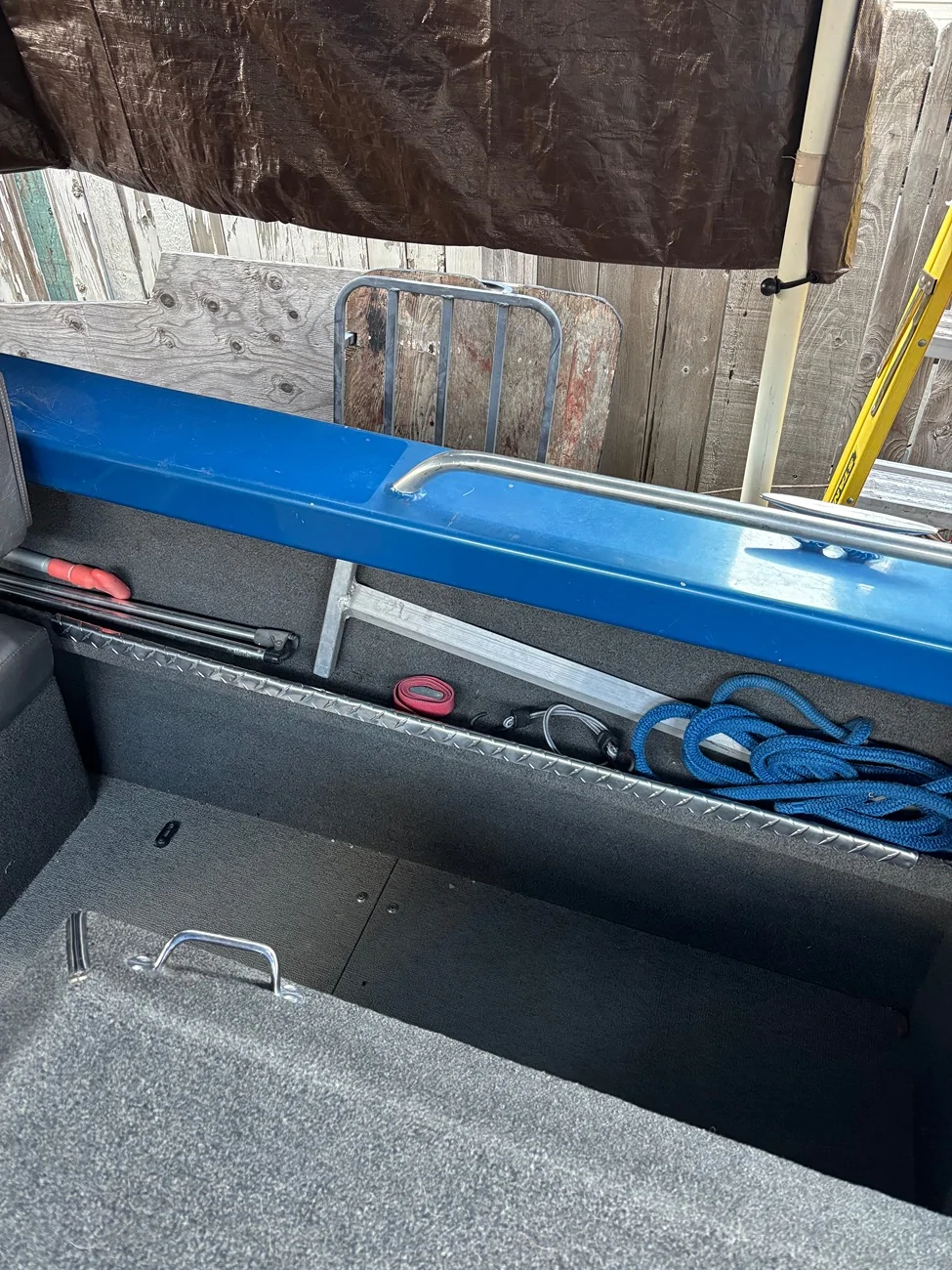

it’s first duty was bending 10 gauge aluminum diamond plate wear treads for the jetboat
So amazing to be able to make things that you previously “hoped” some vendor would sell you for a 200% markup.
The 20 ton is bigger and better suited for my needs, but I also spent some time on it to improve some things…casters, a hand winch to move the press table up and down, added some 1/2” plate on top of the press plate for added strength and no flexing, a movable table below the plate to hold most everything you need while doing work on it. With those upgrades it’s now a keeper for me.
Flexing was my issue for sure. Absolutely unsafe to press bearings to a carrier. Maybe I’ll add some reinforcements. Great idea. Thanks.
