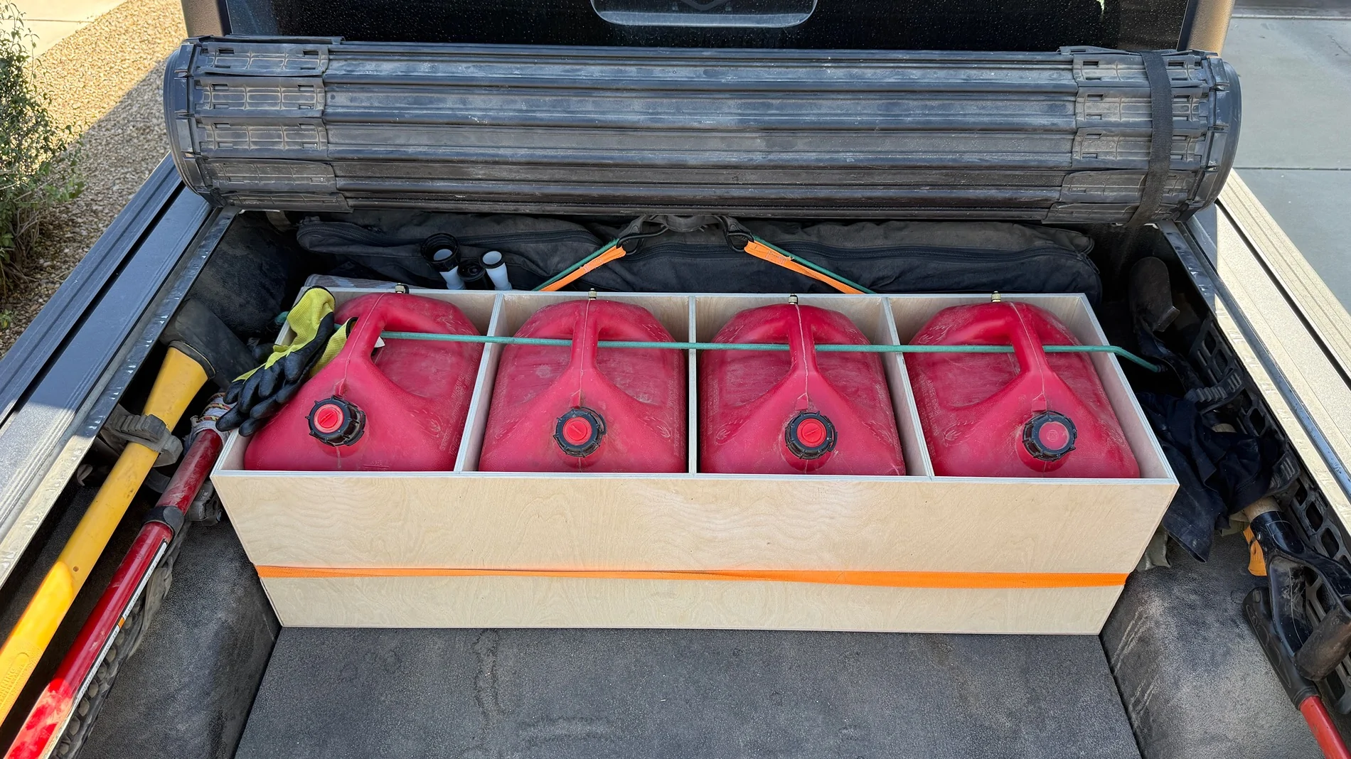

Built a new fuel box to hold all four cans instead of the one I made before that held two cans. I still have 39 inches of bed left so hopefully I can fit all my camping junk LOL
You take 20 gallons of fuel with you camping?! :surprised:
Guess I need to up my game. Looks good! I may steal that solution for the 2 Jerry cans I’m planning.
Depends on where and how long. Stations in the middle of nowhere out here are few and far between and when I’m loaded down and offroad, the mpg’s drop hard. I’ve been on a few trips where that was barely enough.

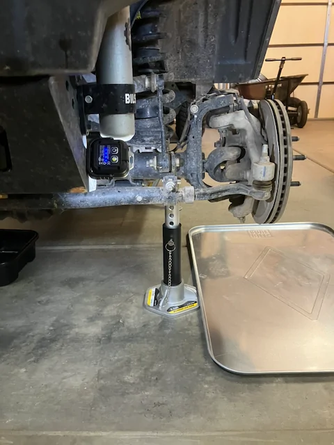

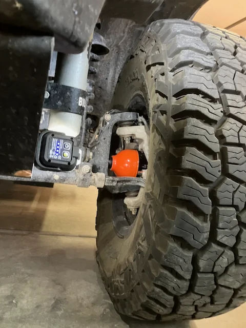

Finished installing the RCV front axles. They are so very nice.
The before:
The after:

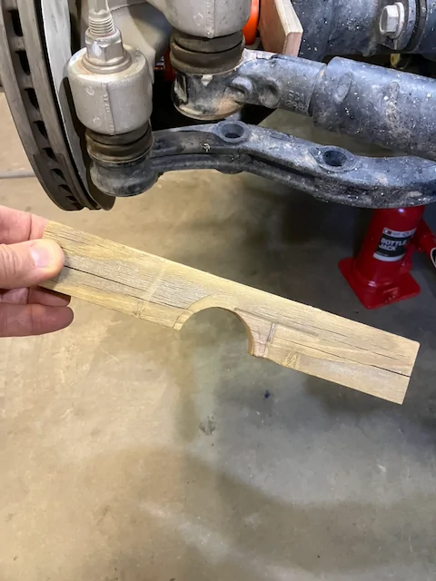

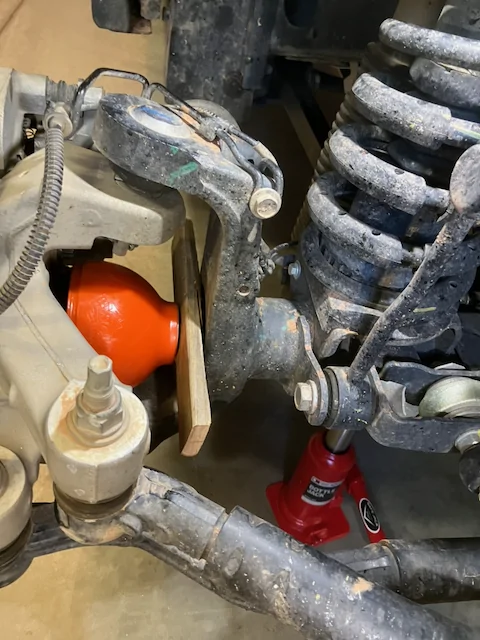

I'd still be out there working on it if I hadn't stopped and made this "backstop" out of scrap 2x4 so that I could just focus on pushing the CV joint into the boot. (Yes I had the zip tie between the CV joint and the boot.) I just didn't have the coordination / strength to smash the greasy heavy bowling ball of the joint into the boot. This let me work on just pushing the joint into the boot since the boot was pinned against the board which was then pinned against the "C" of the axle housing.
I had a hole saw that was bigger in diameter than the section of the axle shaft where the small end of the boot rides, but smaller than the outer diameter of the small end of the boot. The piece I ended up using was about 15/16" - 1" thick.
If you don't have a similar hole saw, it is probably easier to just make two cuts at 45 degrees to create a 90 degree notch in the board that would land on the section of axle shaft where the inner lip of the boot rides.
Here is a shot of a scrap piece placed to show where I had the actual piece I used when I did the install.
If the board is too thin the axle shaft will bottom out into the diff before you can get the boot on. Too thick and the boot is out into the knuckle and can't expand as you're trying force the CV joint into it.
