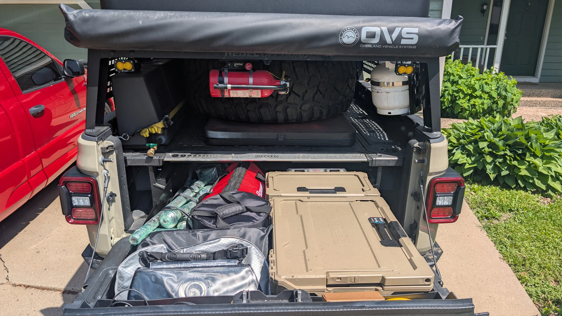

Awe yeah she's back! MAF cleaner and some sun did the trick.
Rubicon here I come!
Amongst other places.
Ugh!!!! Rubicon is on my bucket list!! Wish my rig was ready to go for it now. Maybe in a year or 2. I’m only about 9 hours away from the trail head. Have fun out there and remember……PICS OR IT NEVER HAPPENED!!!!
