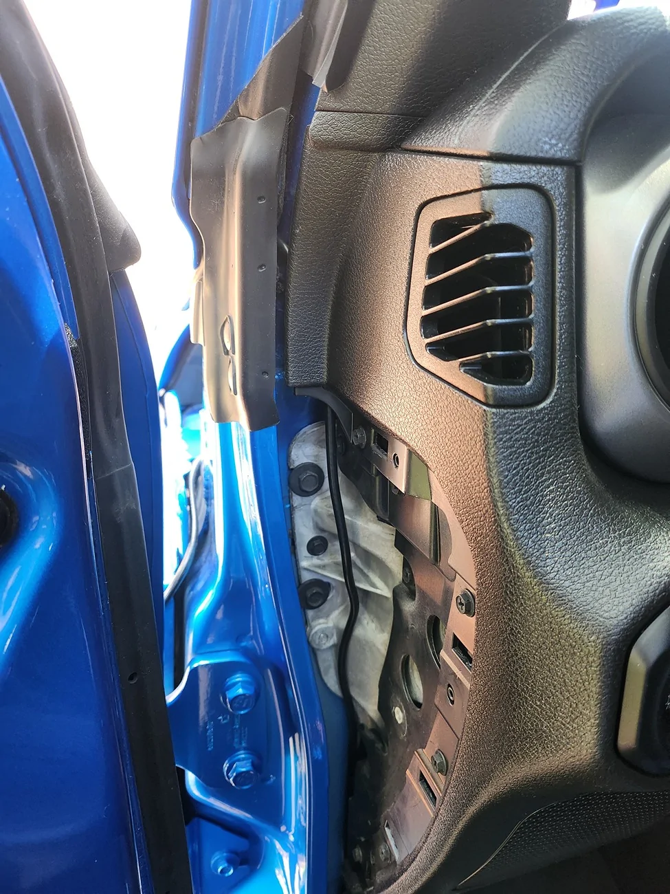

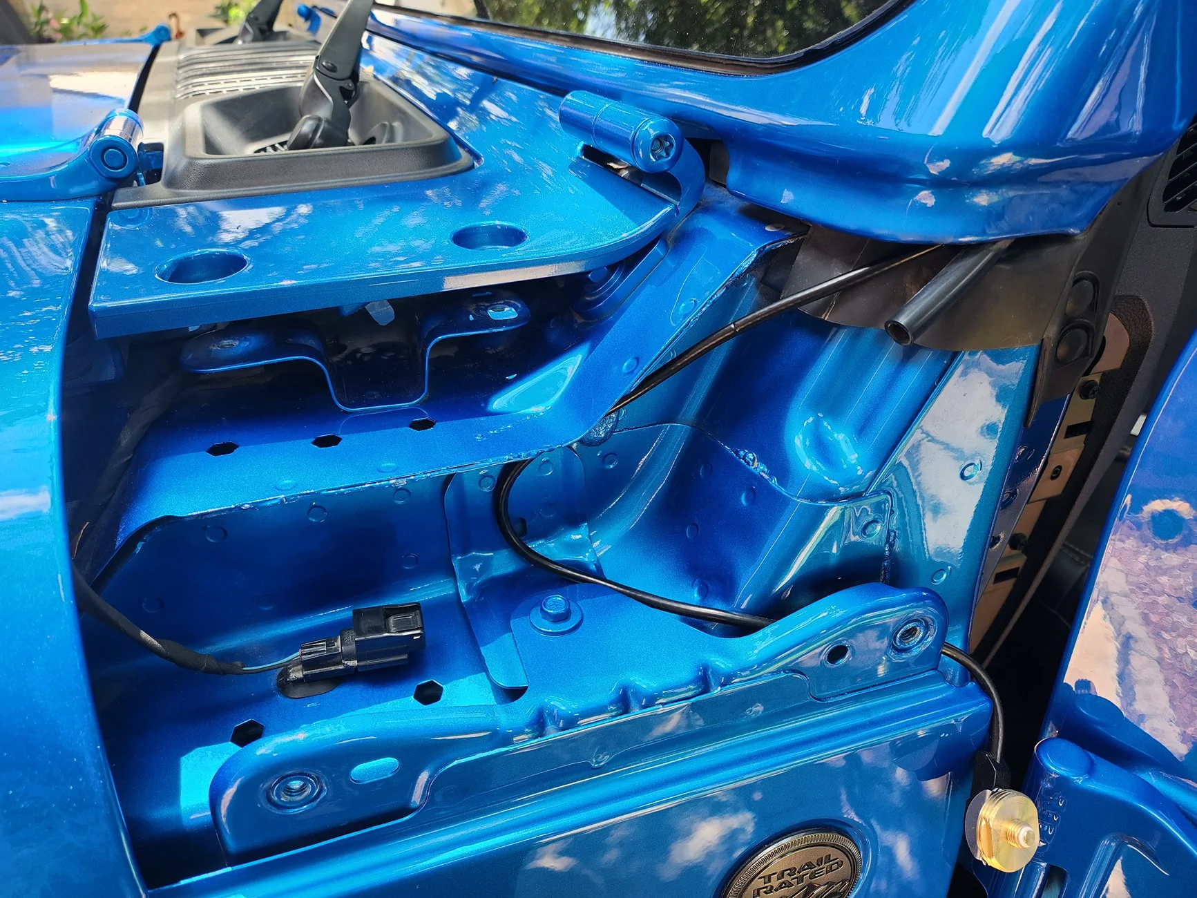

Antenna wire run. Anyone know what that plug is for ?
Jeep Gladiator What did you do TO your Gladiator today? [ADMIN WARNING: NO POLITICS, NO GUN TALK] Antenna Run

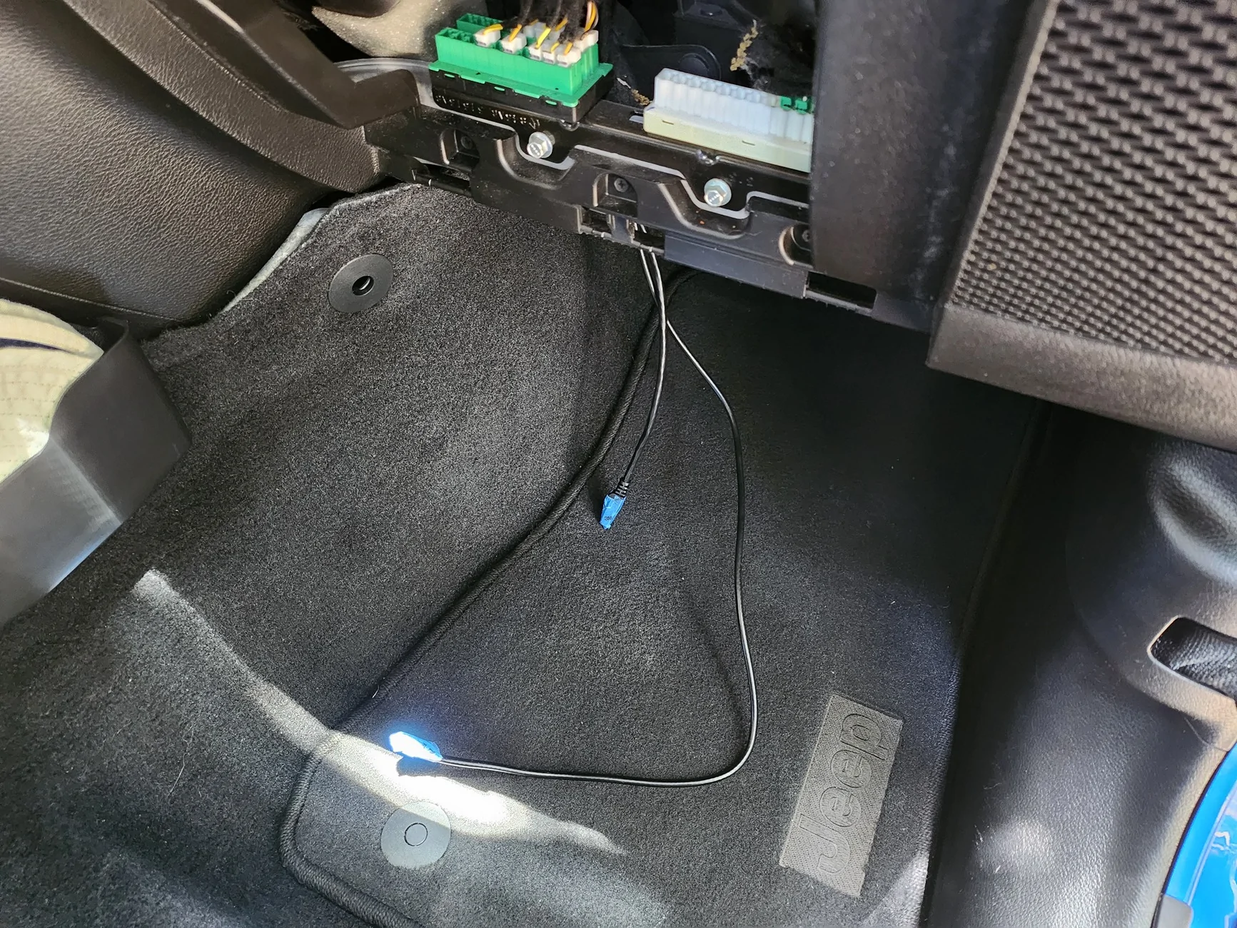

Ran inside and under dash.

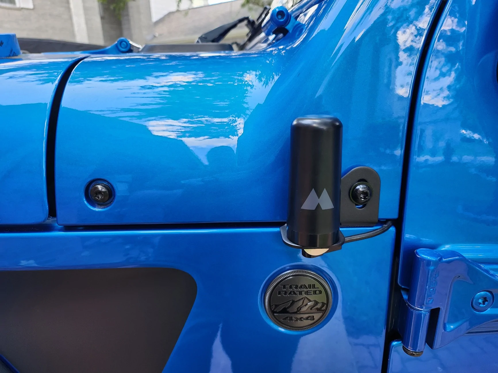

Jeep Gladiator What did you do TO your Gladiator today? [ADMIN WARNING: NO POLITICS, NO GUN TALK] Antenna Installed
Antenna completed. I put some thin rubber on the bracket where it rests on the fender, just cuz.

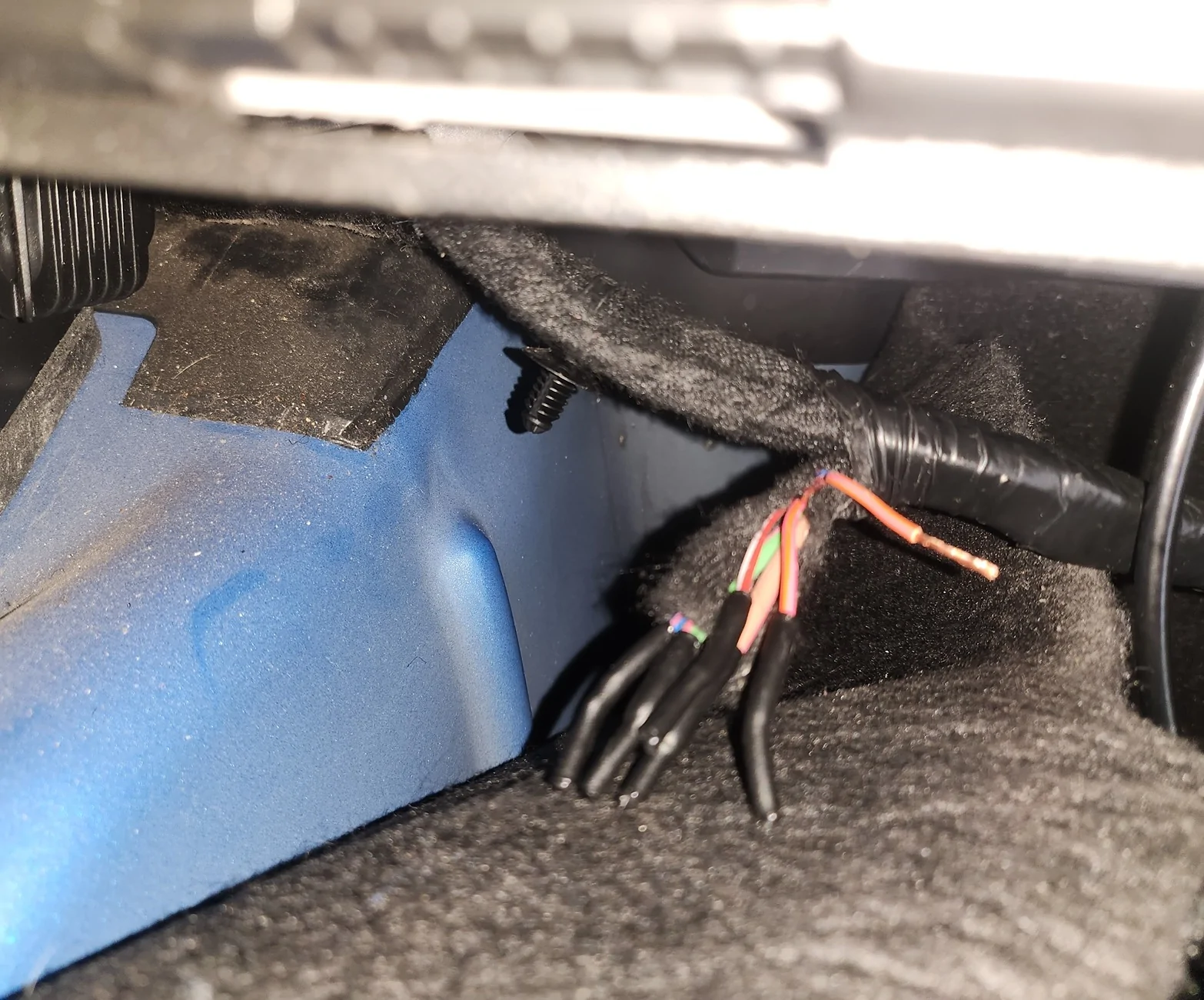

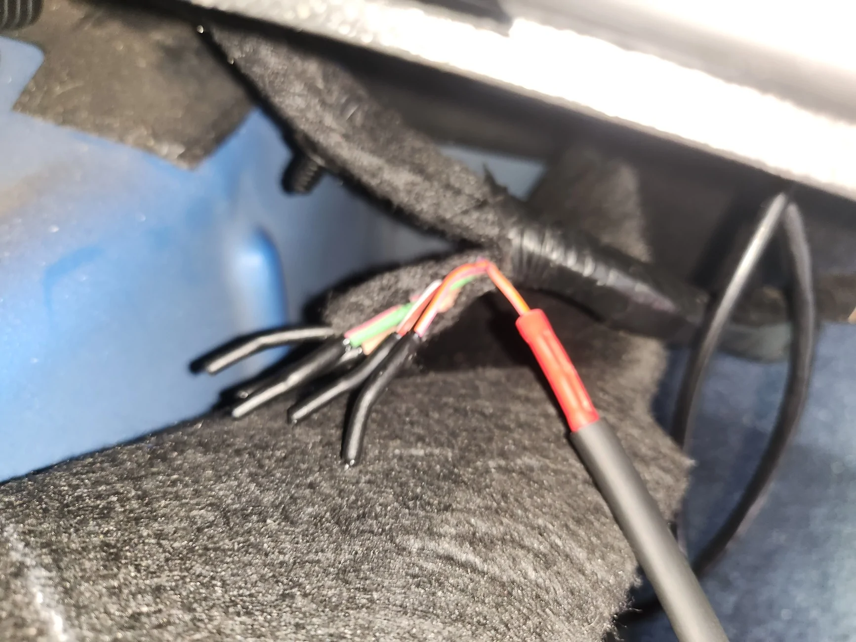

Jeep Gladiator What did you do TO your Gladiator today? [ADMIN WARNING: NO POLITICS, NO GUN TALK] AUX Wire Location
The AUX wire bundle is above the passenger side hump. Took a while to find it and unwrap it. The now-stripped orange/pink wire is for switch 3.
Jeep Gladiator What did you do TO your Gladiator today? [ADMIN WARNING: NO POLITICS, NO GUN TALK] AUX 3 Crimped
Wire for the positive side of the 12v outlet is crimped on, I was sliding on the heat shrink tubing over the splice. I always try to put on heat shrink on any connection. No pic of the completed heat shrink, we've all seen that....

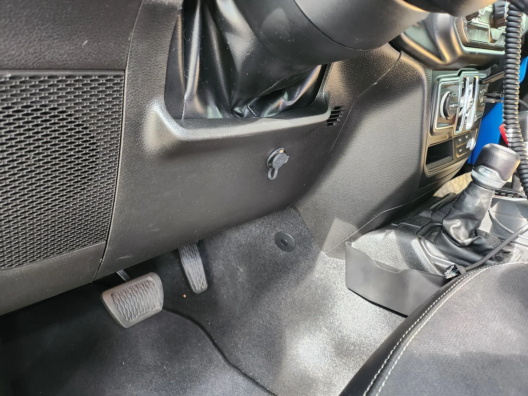

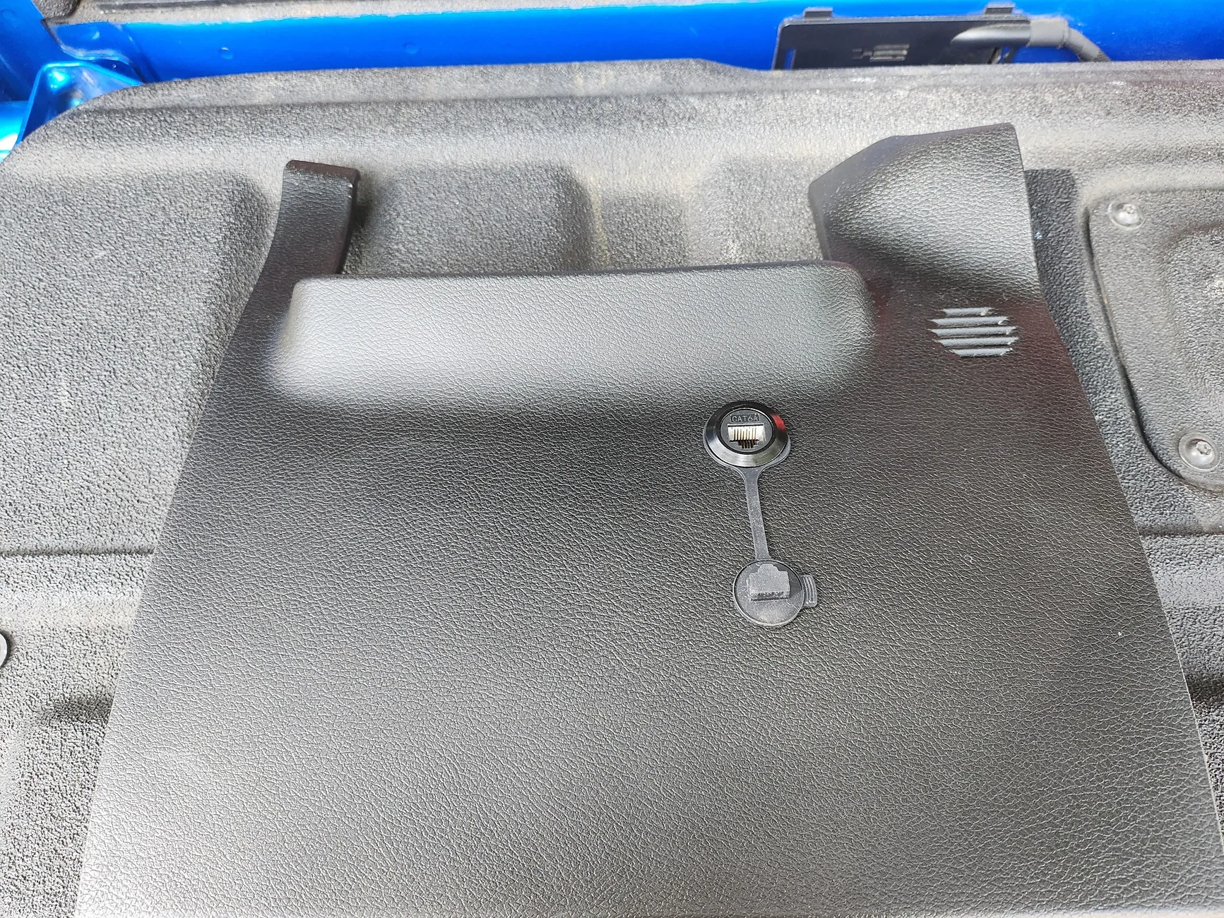

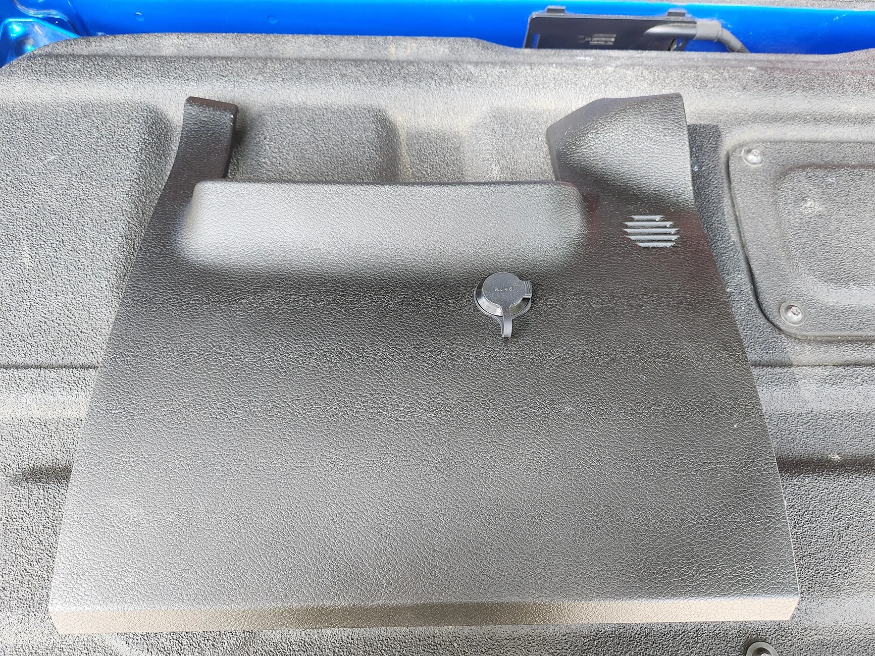

Jeep Gladiator What did you do TO your Gladiator today? [ADMIN WARNING: NO POLITICS, NO GUN TALK] RJ45 Jack II
Put the RJ45 (CAT 6e) in the panel. Used a UniBit step bit to drill the hole.
Jeep Gladiator What did you do TO your Gladiator today? [ADMIN WARNING: NO POLITICS, NO GUN TALK] RJ45 Jack Installed
Jeep Gladiator What did you do TO your Gladiator today? [ADMIN WARNING: NO POLITICS, NO GUN TALK] Finished II
Re-installed, CAT6e plugged in. antenna and CAT6e run over to passenger area. Rubber plug not fully seated, I was doing a visual check

It actually wasn't that complicated at all, the Jeep designers made it uber-easy to do !! The sweating and contortions necessary took the fun out of it though, that's for sure. The only concerning part was taking that UniBit to the panel. I decided to go panel because it was easily replaceable and somewhat cheap. I contemplated dash mounting, but them parts are pricey.
It met my main objective; I wanted the casual looker to look inside my vehicle and think it's bone stock, no flashy expensive toys in view. If they want to steal my ducks, have at it. :LOL:
