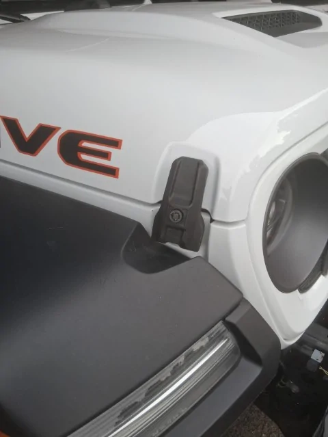

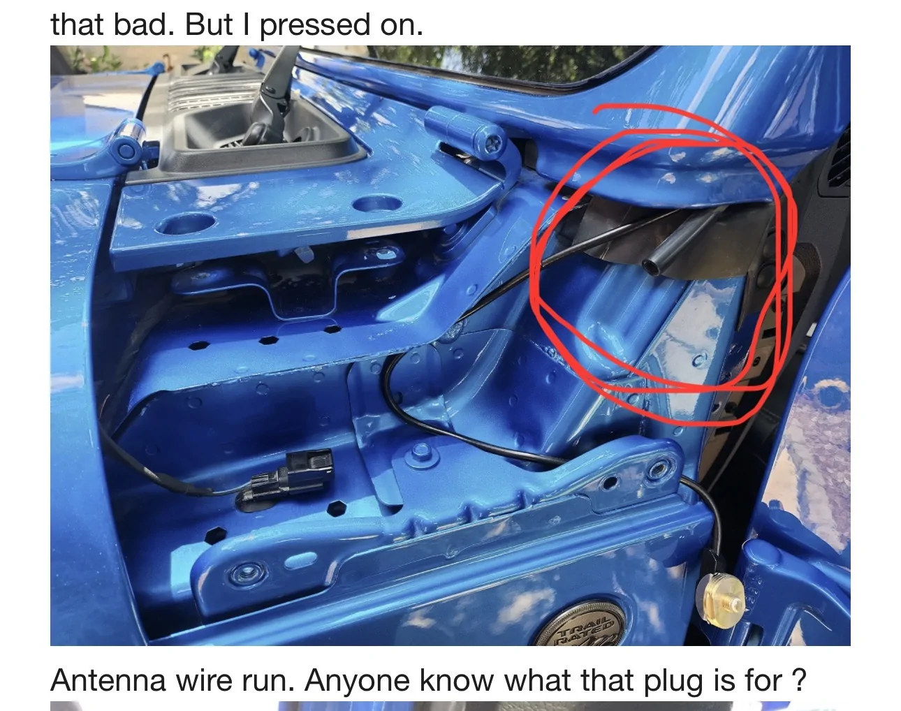

Antenna wire run. Anyone know what that plug is for ?
Ran inside and under dash.
Antenna completed. I put some thin rubber on the bracket where it rests on the fender, just cuz.

This may be a silly question but . . . . can I ask how you got your antenna wire through from the outside quarter panel area under your windscreen into the inside of your vehicle, in your picture below?
Like does it just push through or what? Did you have to fold the windscreen down?
Yes you have to fold the windshield down a little, but once you do theres a decent gap that you can fit wires through, and once you st the windshiled back into place theres enough room that the wires don't get pinched. Theres a few threads around here, and some youtube videos that show more.
Otherwise, if you have an auto transmission theres a hole in the firewall where the clutch master cyl would be. It's really easy to access from under the hood.
I didn't have to fold my windshield down. On the side of the windshield is a plastic gasket cover thingy (techie term) that is held on with two push pins. Pop that off, pull the gasket free (it's press fitted, not glued) and work the wire behind it, then press the gasket back in place. It ends up running next to what I believe is a drain tube for....something. I just made sure I put that gasket back EXACTLY as it was. If I caused leaks, I'd castrate myself. Explaining it makes it seem more difficult than it was...
The "stress loop" of antenna wire was excessive, but I had a LOT of wire to deal with.
Oh, the Midland wire has a removeable PL259 connector, that made it uber-easy to fish the wire.
Awesome, thank you for the feedback and information.
Great additional information, thank you! When I end up getting my radio I’ll probably want to feed the antenna wire through there in a similar fashion.
When you get into it, you'll see how easy it was, it's almost intuitive. This Jeep is designed well and promotes things like this. Make sure you get an antenna with a removeable connector, otherwise what I did will be impossible.

I saw mention of a “stress loop” above for antenna wiring. If you do this make sure it’s not an actual full loop. A curve is fine but you really don’t want anywhere where the wire crosses back onto itself. If you end up with a significant amount of extra wire route it under the carpet or behind the dash or somewhere so your line is all straight without crossing itself. Even if it’s a shielded line this can cause some screwy stuff with signal to the radio.
No loop under the cowl, just a U bend. Actually less than the pic shows, I pull up some slack. I started with a antenna cable that was only 10' long, perfect for my setup. The connector and cable sucked BAD and was out of spec for the mount (even though the web site claimed otherwise). Returned. So I then got the Midland cable and it's 19' long. Excellent job on the antenna mount. The freaking vehicle is a tad over 18', absolutely no need for 19' wire run. I'm running from the driver's cowl to the passenger footwell. As of right now it's loosely coiled behind the dash, drivers side. My plan is to snip the wire, put on my own fitting. I haven't done that since my CB days, I'm sure it'll come back to me.

Yeah I’m probably just going to run down behind the drivers seat and back around to under the dash. Those things are so sensitive to alterations and such I don’t want to mess with it.
Now that there is a stellar idea !! Getting the passenger kick panel off to access the factory ground lug was a mutha, but now that I know how, it should go easier (he said optimistically).
