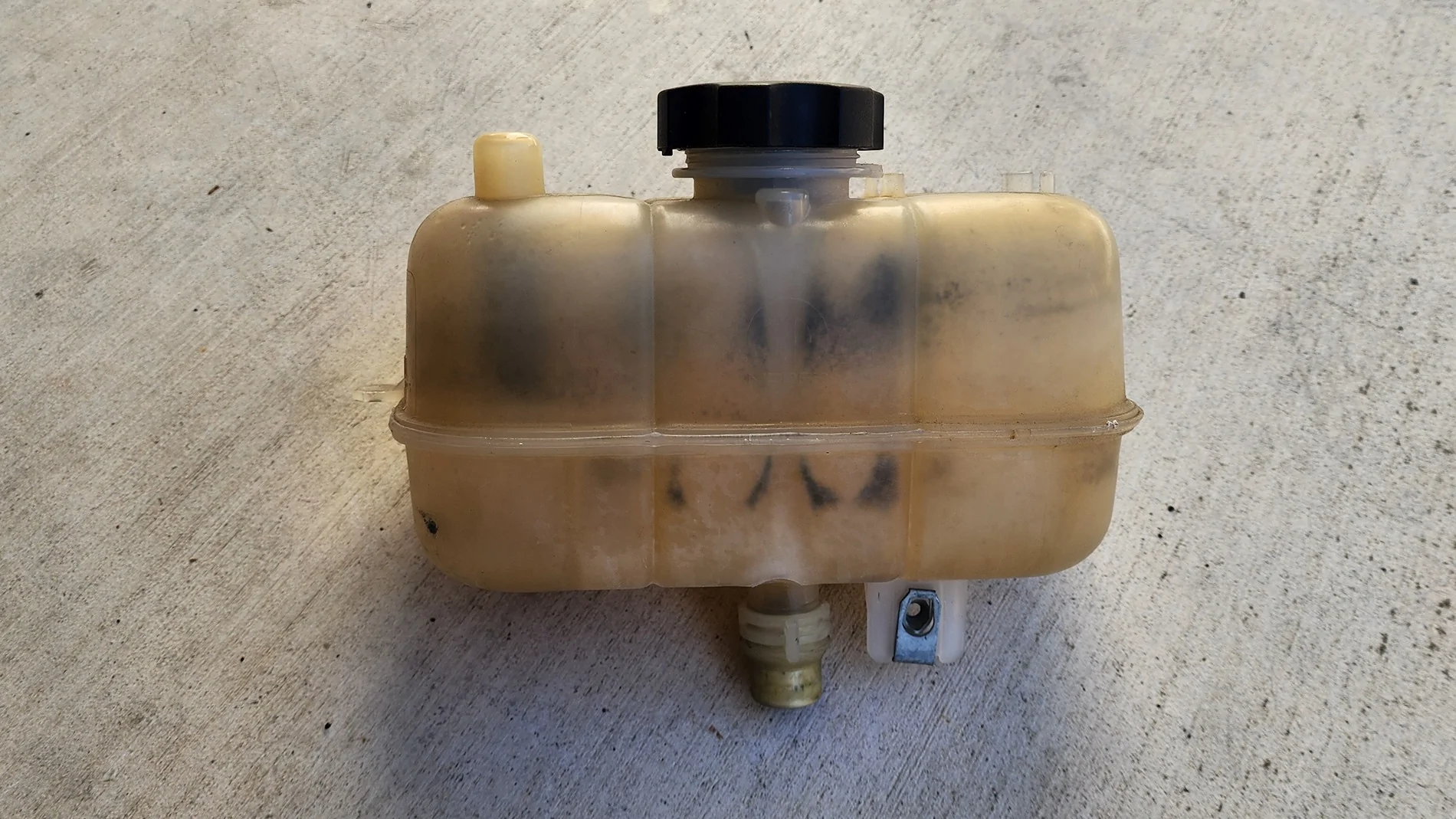

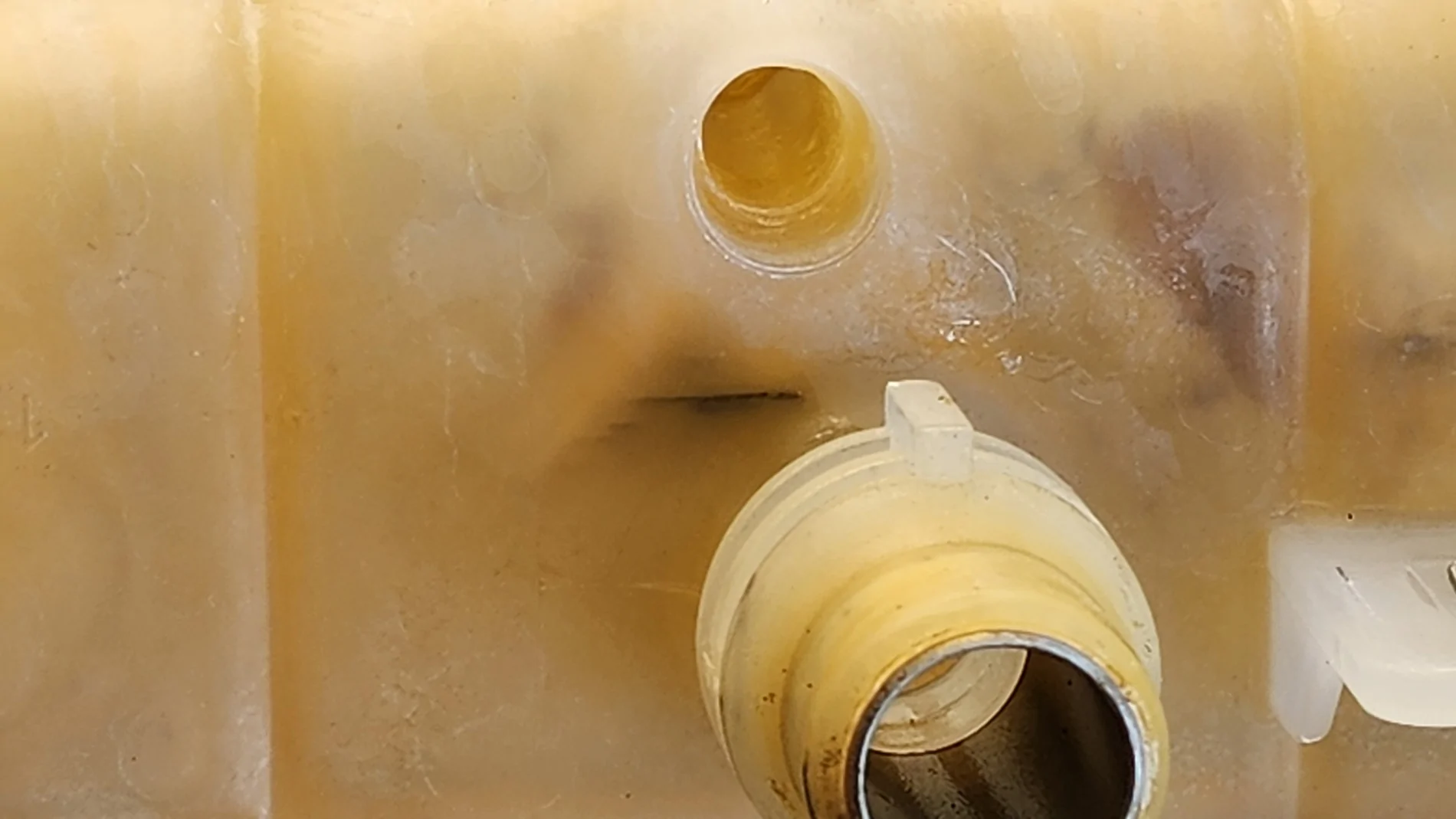

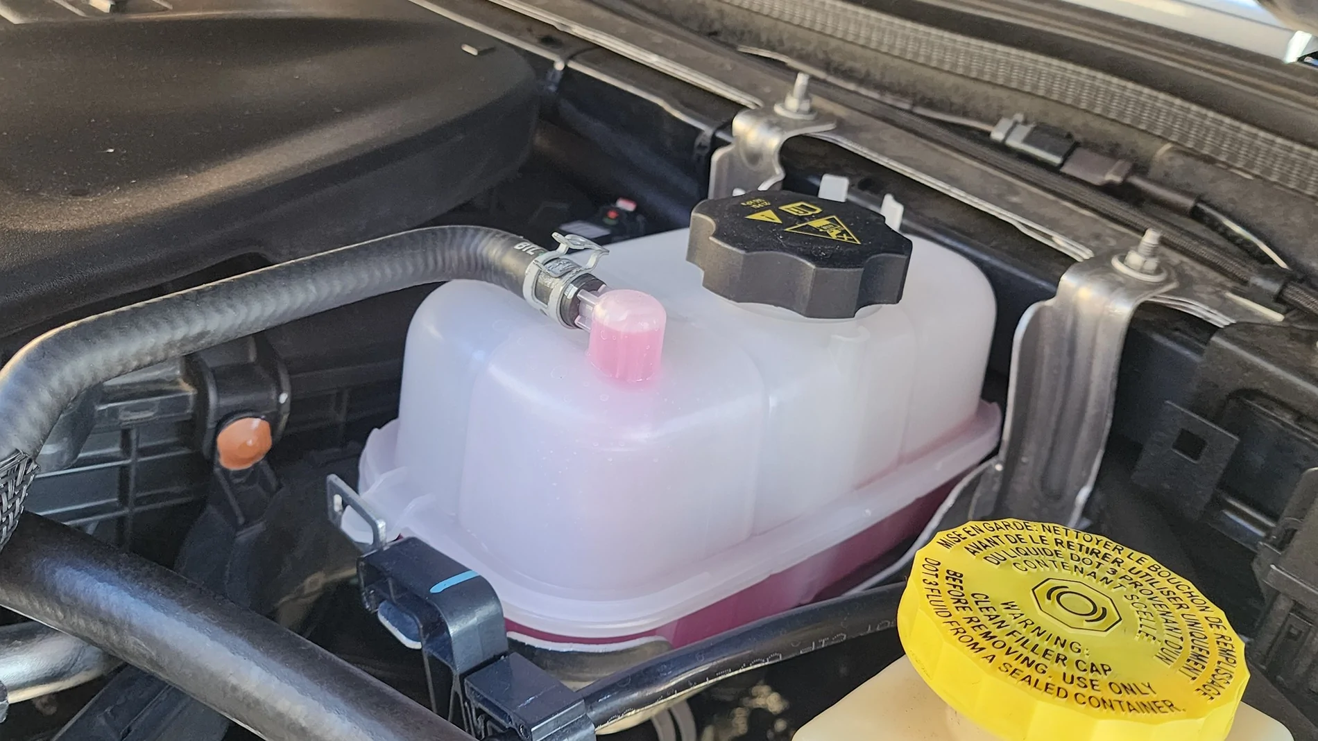

Replaced my coolant reservoir and outlet hose. I think I found the source of the leak. Looks like a crack near the outlet nipple on the bottom. The new coolant reservoir looks so much better. Didn't realize how dirty the old one was.

I haven’t unpacked it yet, but I’m replacing mine with the Mishimoto aluminum one. No idea if it comes with a hose. But glad the transfer pump worked. If it doesn’t come with a hose, I’ll just inspect and replace. If the hose looks terrible, I’ll order one first. Thanks for the links.
