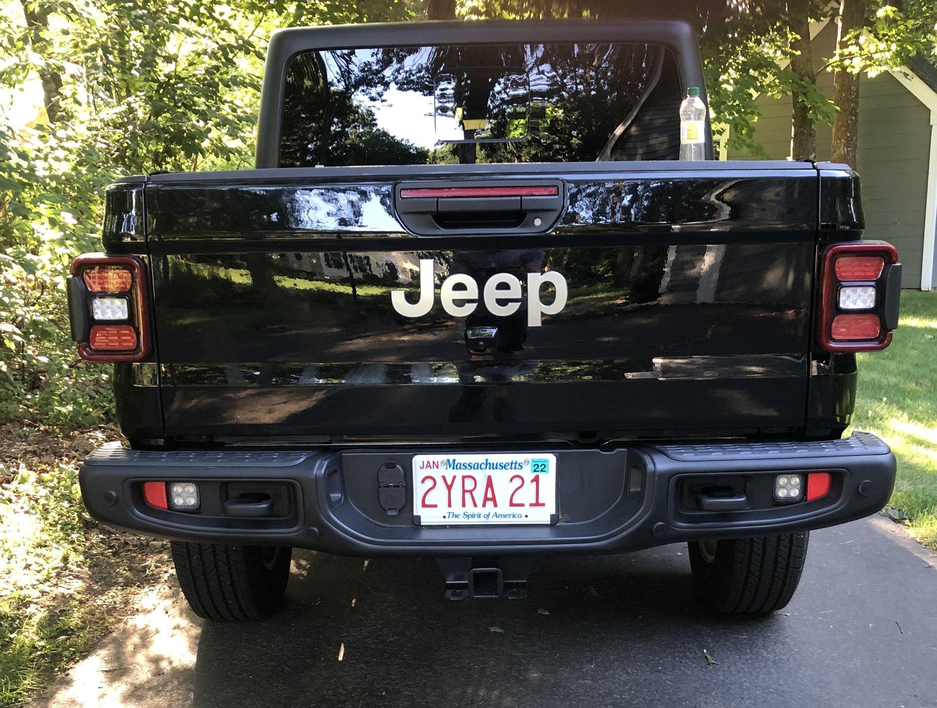

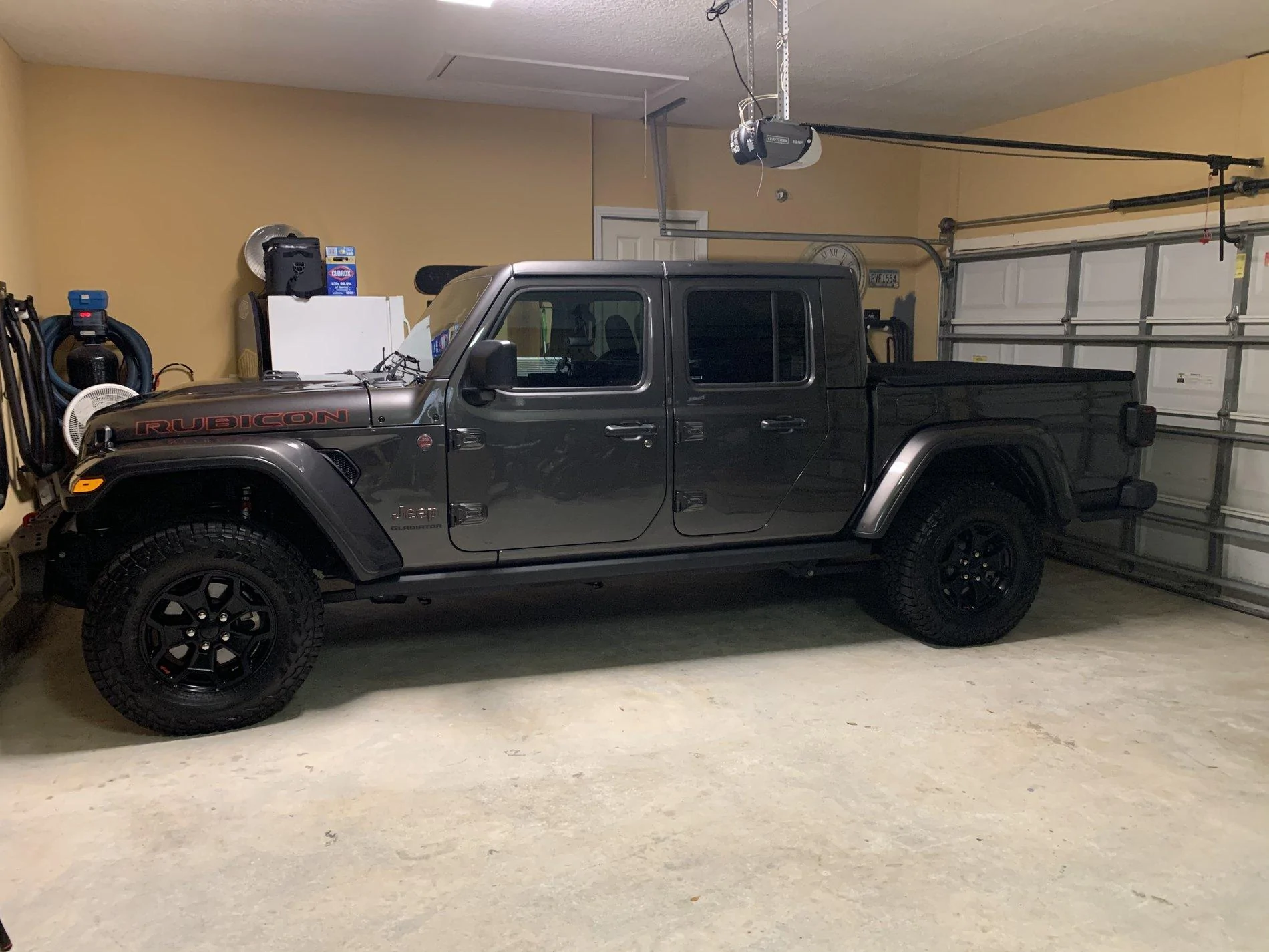

Installed a full size overland wheel as my spare and a steel rubicon bumper.
Anyone who can tell me how the park sensors are supposed to be oriented in this thing I’d really appreciate it.
I’m trying to understand your question. Are you trying to understand what wire goes to what sensor?
did you do a take off bumper from a Rubicon or the Mopar accessory Rubicon steel rear bumper? I guess you added another tow hook but painted it black?
it looks good, I plan on ordering that bumper for my overland. All gladiators should have a steel rear bumper.

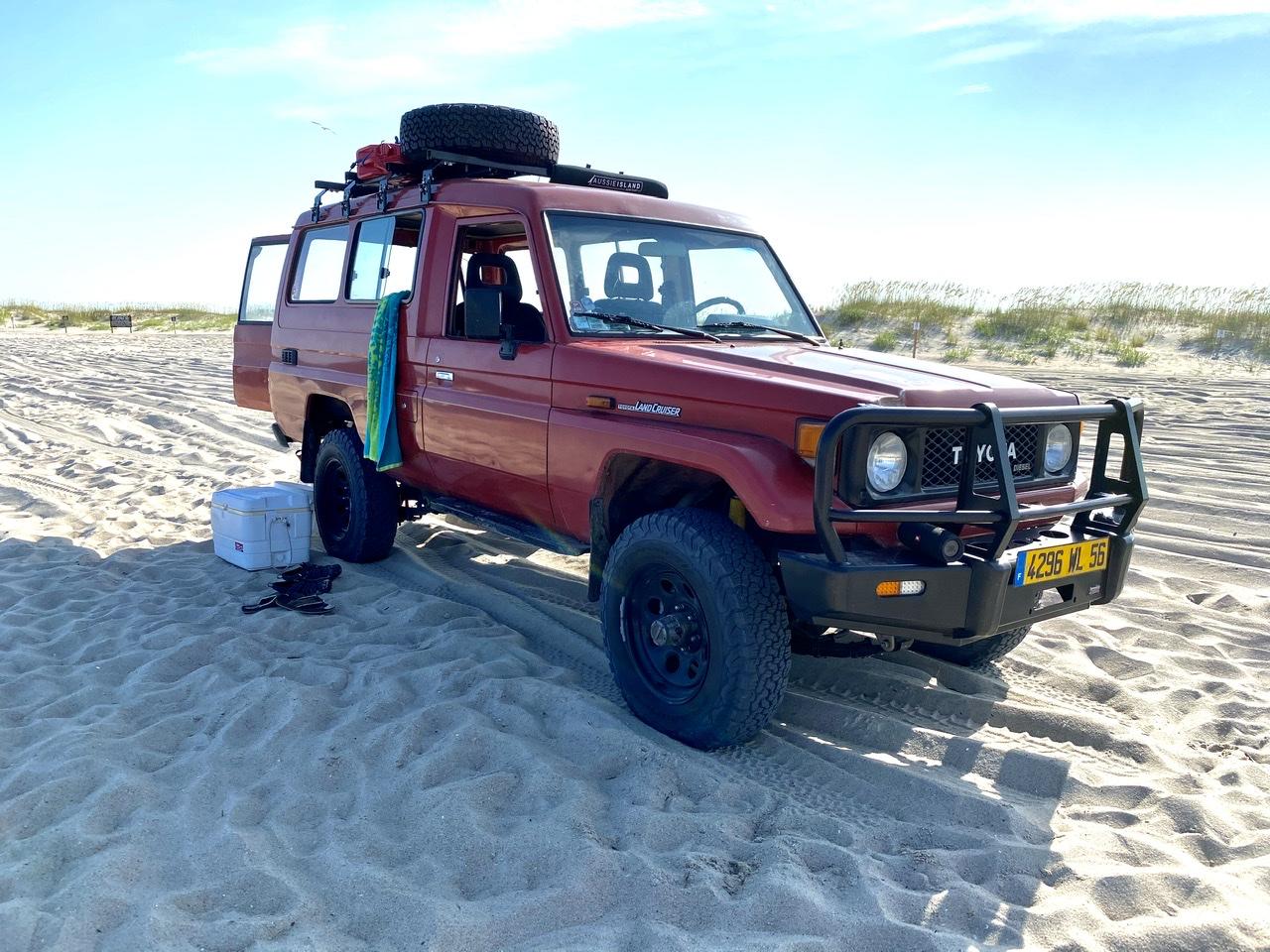

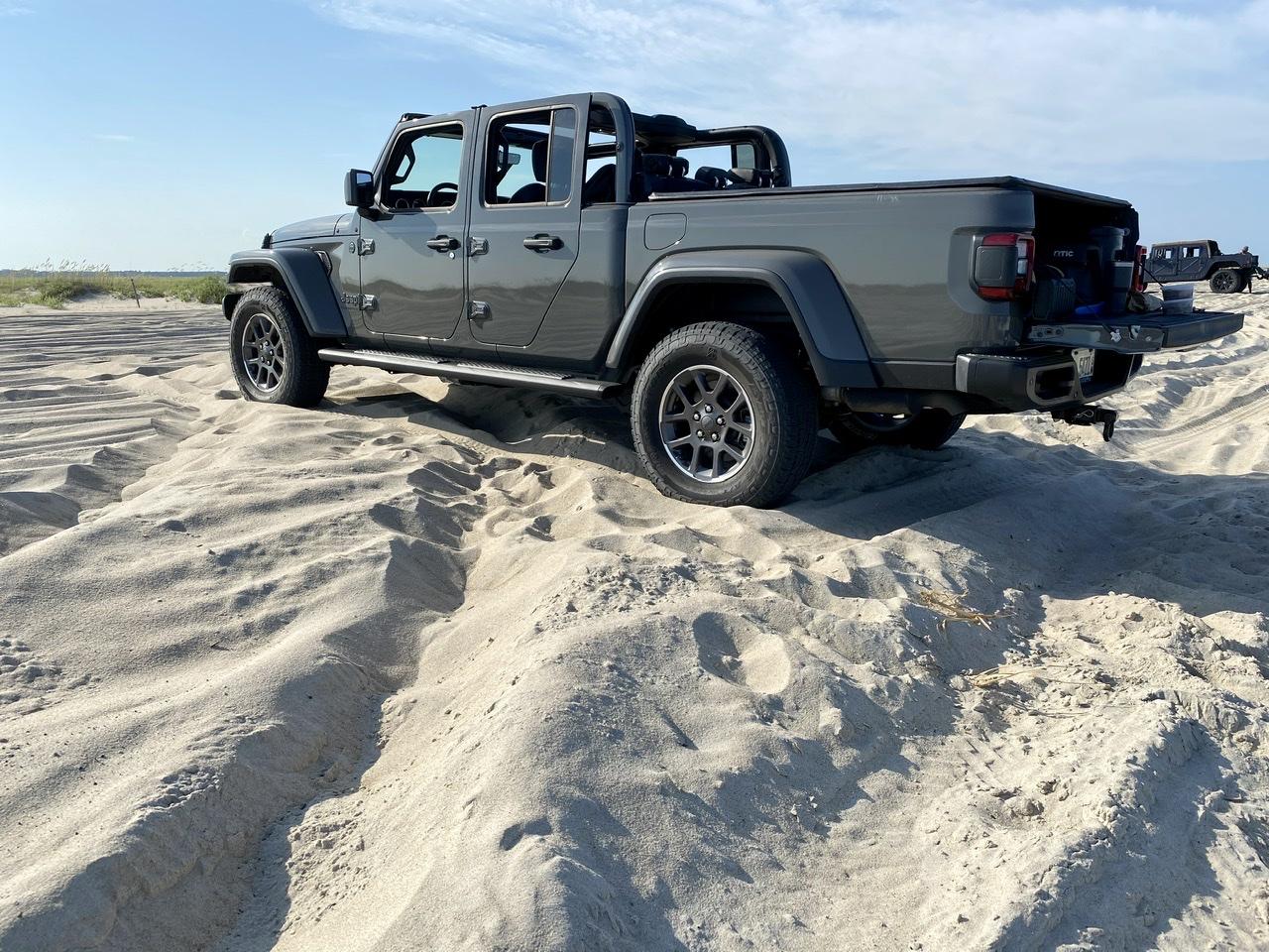

guy in the background just casually driving a humvee
And the other side of me was a sweet Land Cruiser 78 series troop transport inported out of France.
We drove all the way down to the end of the off-road vehicle access to get away from the crowds and those were the only two vehicles down there. That was at Ft Fisher State park just south of Kure Beach.
ive got the sensors installed with no issues. Not sure the orientation of the bezels is correct though. Depending on how they are turned points the sensors in different ways. My sensors work when I’m reversing but doesn’t seem to pick up as far out as they used to.
its a take off bumper not purchased from Mopar.
I ordered the black tow hook so I didn’t need to paint it.
