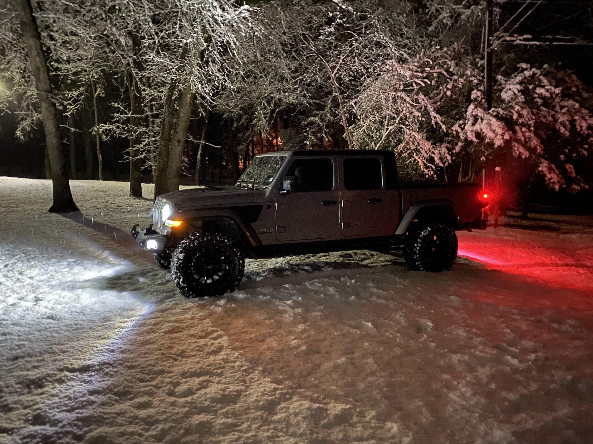

Can you share your experience installing front receiver? Many members have problem properly fitting it on a Rubicon. Thanks. Here's the link https://www.jeepgladiatorforum.com/forum/threads/front-hitch-receiver.24377/
I had a receiver on mine until I installed the steel bumper. It wasn't the bumper but were those rivnuts and the skid plate brackets that made it so I could no longer fit the receiver between the two frame rails. The rivnuts stick out, then the brackets go onto those and now you have about .25" less space between frame rails and the receiver no longer fits. Leave out those nuts, leave off the skid plate lower/rear brackets and you would probably be ok.
I mentioned to my wife about the hassle of plowing snow and joked about a blade on the truck and she said "I told you last fall you should put a blade on the front of your truck"
I didn't feel like explaining that my wanting to have a steel bumper and winch on the front meant I had to remove the receiver and was sort of screwed now until I find another way to get a receiver in there.
