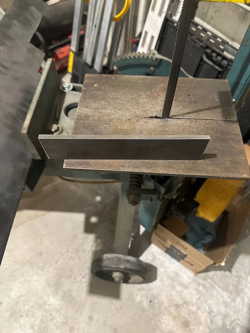

This is getting to be a habit for many of us, so I thought it needed a thread. Seems like a fun one for one off mod collaboration.

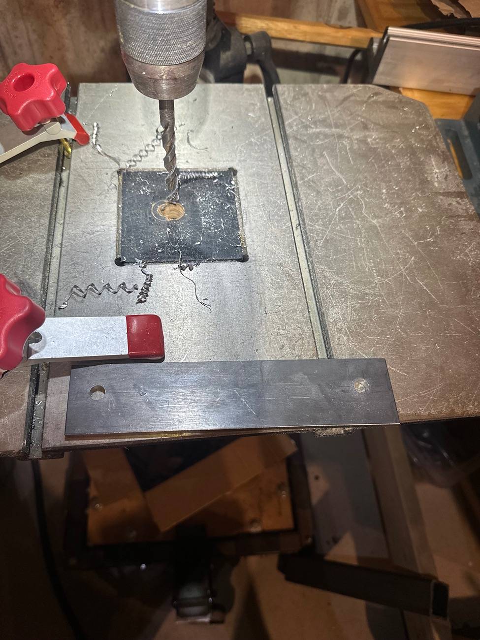

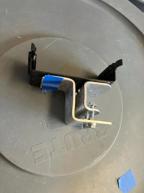

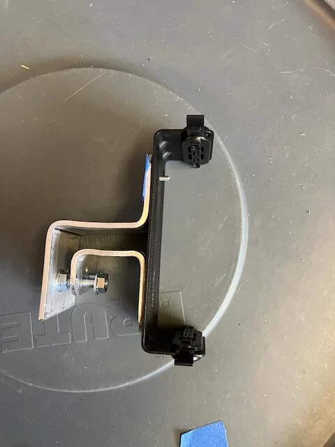

For a friend, @tredzlitely, made a spacer to fix a clearance issue. A new, very nice rear bumper caused a clearance issue opening the trailer wiring covers. Made a quick 1/4” steel spacer to drop the connectors that much lower. We’ll see tomorrow if it needs any adjustments before paint.

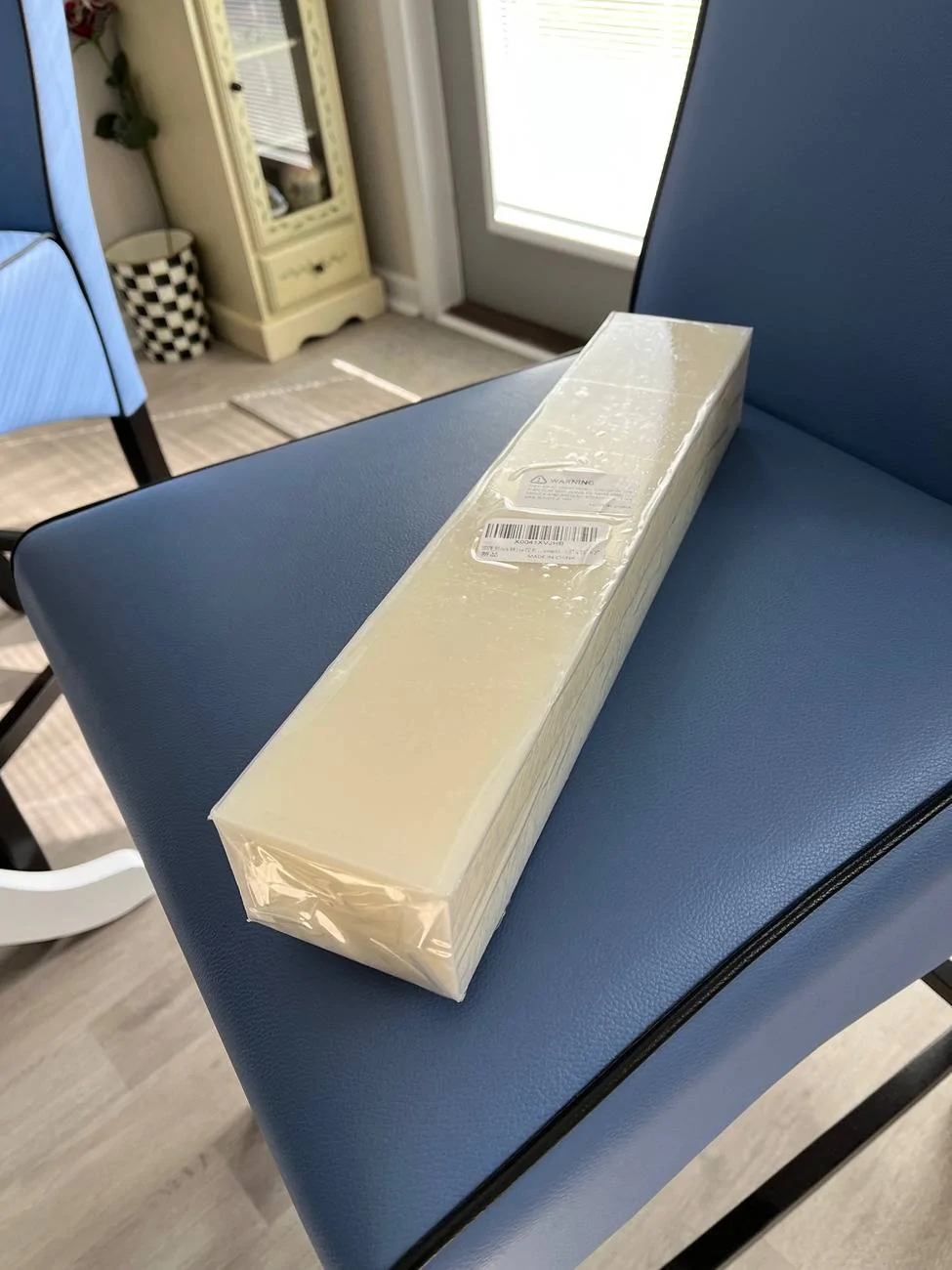

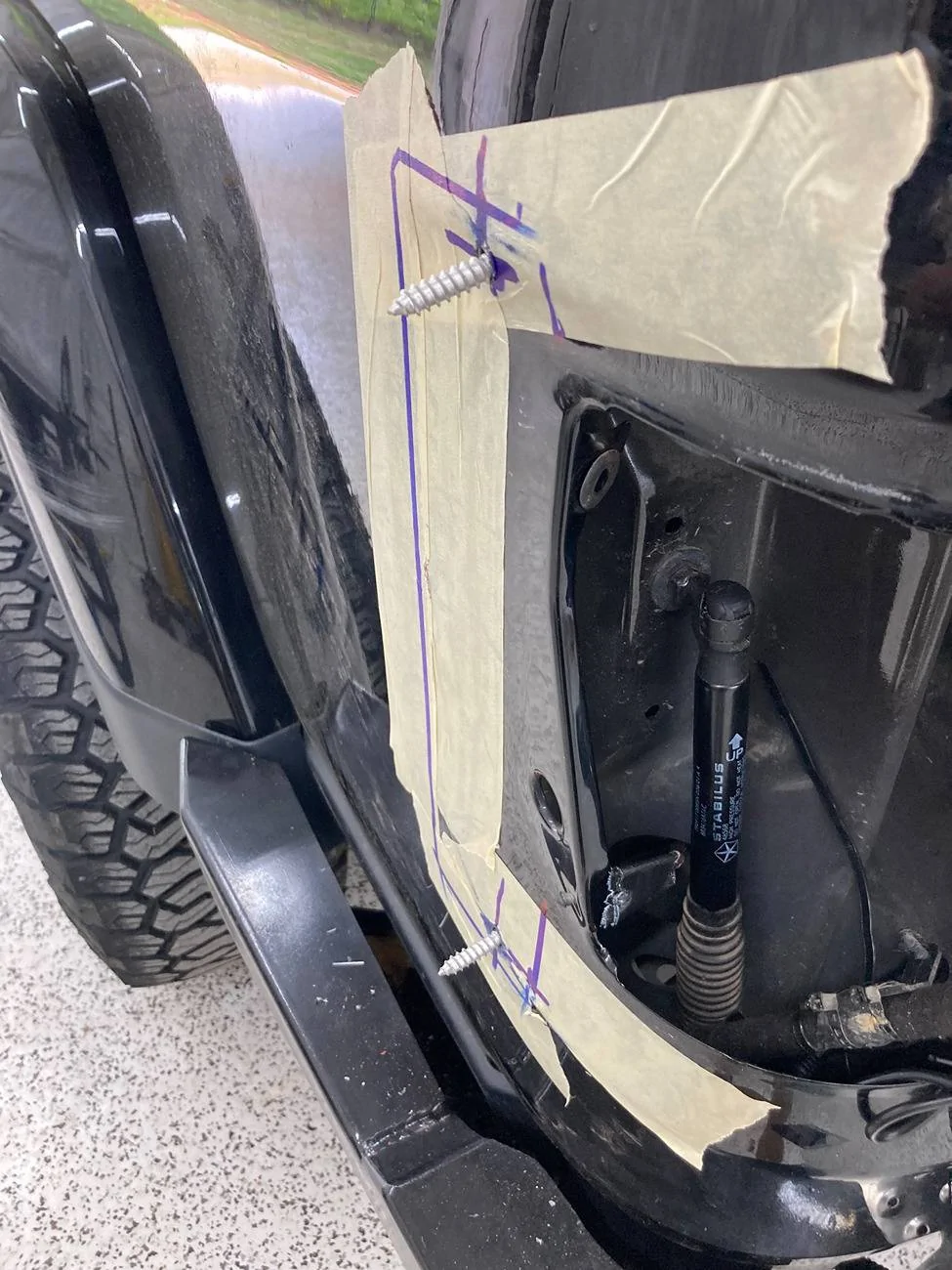

hello my friend, i will gladly add to this new thread. this week, i will unscrupulously modify this piece of hdpe into body mounted tail light guards. SPOILER ALERT : oh the heavens, it requires DRILLING INTO SHEET METAL!!!

Instslled the spacer on my friends JL today while doing his tranny fluid. Fit great and you can’t even see it. Fixed the problem perfectly.

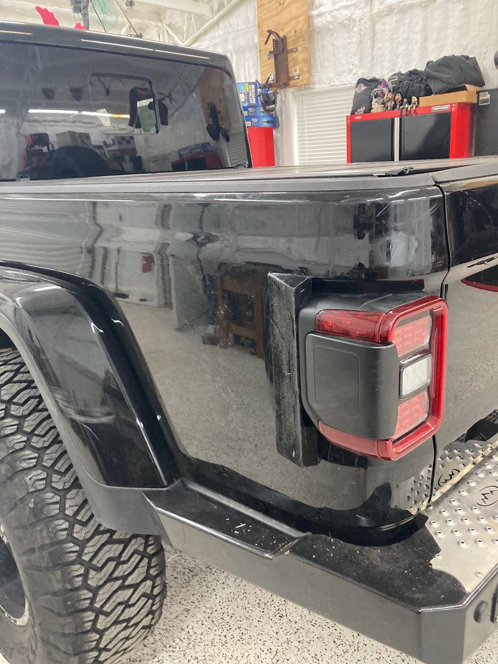

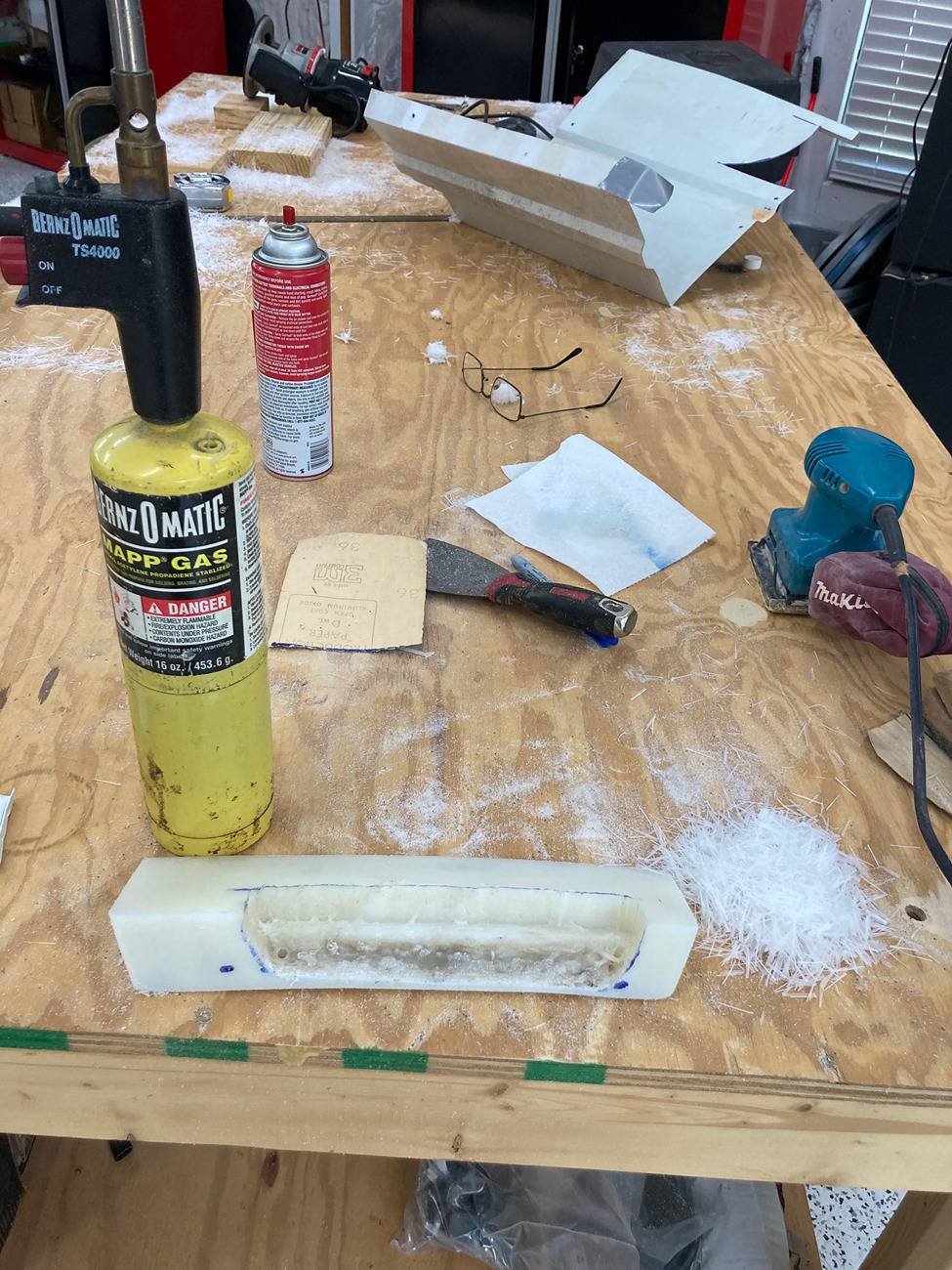

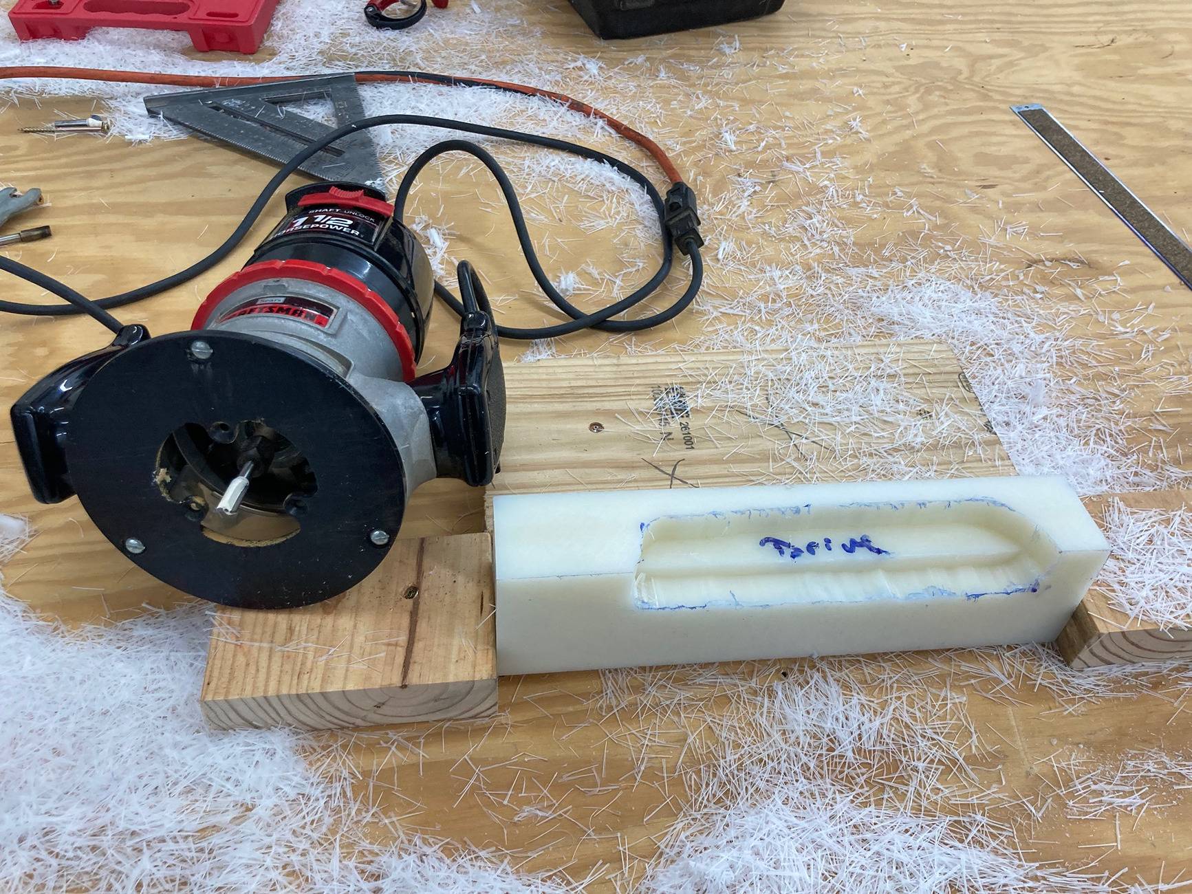

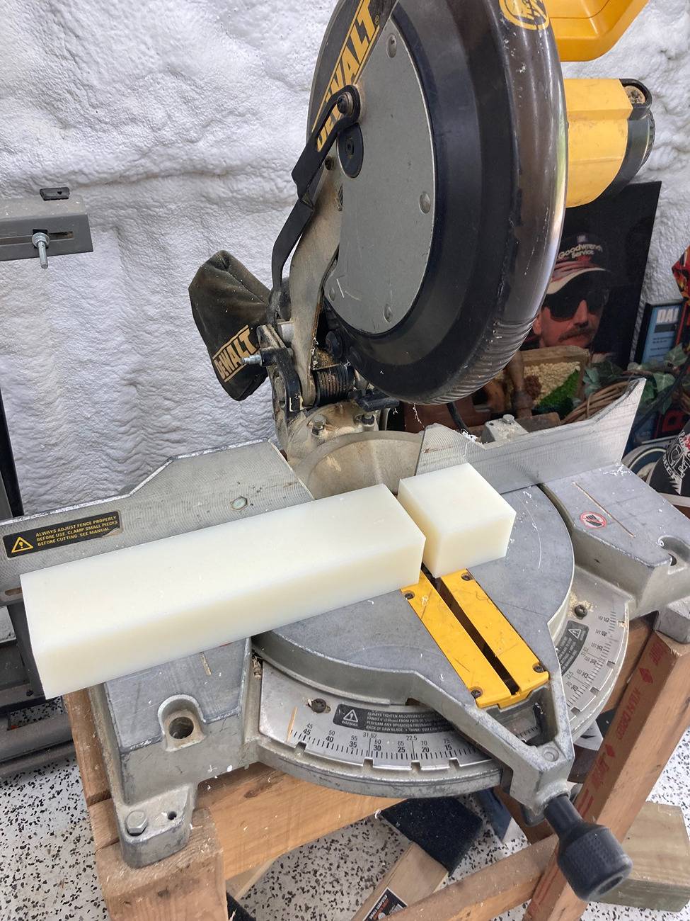

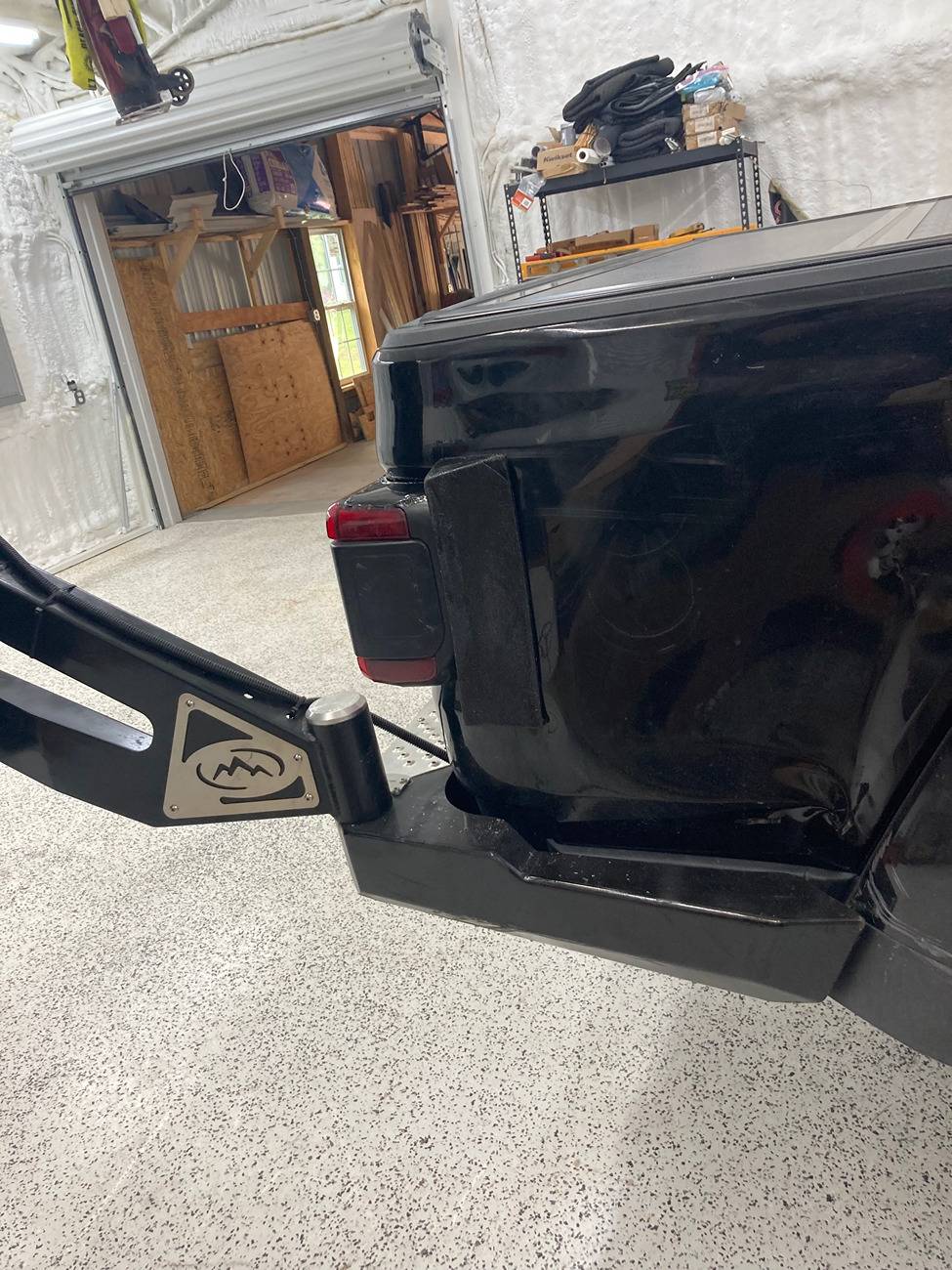

i'm ALMOST ready to contact Haas Automation for a cnc to replace my trusty Craftsman router, but not quite! like gravity, the old adage "measure once, cuss twice" is constant. yes, the table saw cut did slice into the pocket created by my cnc oops router. after exhausting the vocabulary in all of the universe to vent my frustration, think Johnny Dangerously, i could melt my mounds of shavings, not coleslaw, and repair my guffaw. the finished product, she ain't pretty but neither is my Jeep at the moment, should keep the tail lights on. yeah yeah yeah i know "slow down", "use your mirrors" "get three more spotters". i am loving the life the bride and i have. she likes it too!

I had no idea where this was going. Such a great idea. Can’t wait to see them in person in August.

What is that block of material that you "milled" your taillight guards from?

I want to know how that swing away is tied into the frame. Pics would be great. Does it flex at all?

i have not seen any side effects due to twist , flex or sag. it is from expedition one and is extremely beefy. it utilizes a double latch release which requires minimal strength to squeeze. this unit is a direct replacement for the oem bumper. i retained my towing capacity and relocated the oem camera into a sensor hole in the bumper. exp one provides plugs for the holes if yours does not have sensors. i suspect they may be a small outfit as it took eight weeks to get last year, however the engineering and fabrication of the bumper and arm is through the roof. it is listed as weighing 180 lbs, certainly heavy. from that, deduct the the weight of the oem bumper. i would buy one again in a heartbeat.
