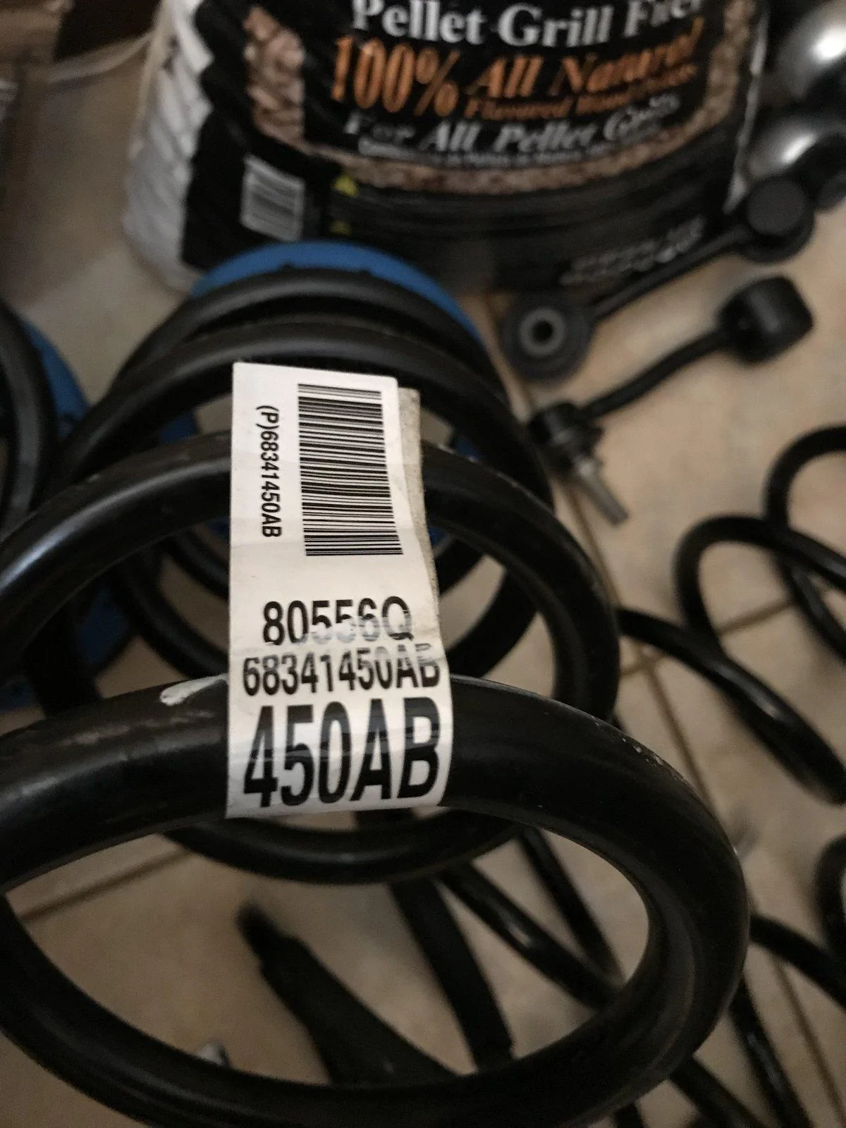

Thanks - sort of what I thought since all the others are sort of a plastic or paper.
I found the part number tags on my Javelin springs LOL........you'd think I could find these things on a brand new vehicle ;-)
Jeep Gladiator What gear oil is good? jav-sus-spring-003
Jeep Gladiator What gear oil is good? jav-spring-7

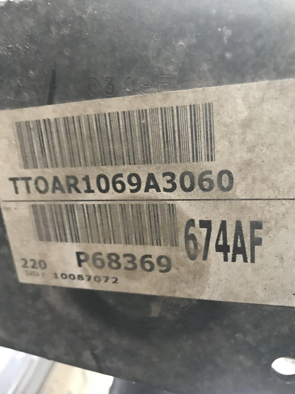

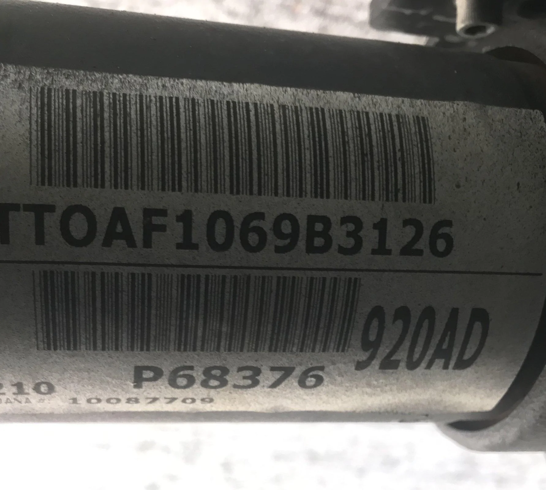

Ok here are my tags on front & rear axles on Overland
Jeep Gladiator What gear oil is good? 577EB175-10B4-4944-8508-A5F6905E5CF3
Jeep Gladiator What gear oil is good? 93283AD5-32A1-4121-947E-11846D94E838

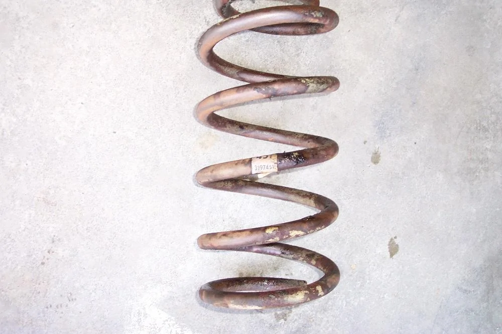

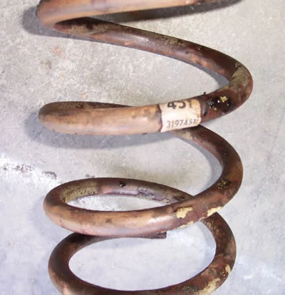

Here’s my Rubicon springs rear coil tag that i had on my Overland
Jeep Gladiator What gear oil is good? CCFFECFB-9881-4B9B-8A67-2701367261AF
My JT Overland has 439 (left) and 440 (right)
When a kind member can, he's going to pick up a set of Rubicon springs I've bought and get them shipped to me.
Likely will use the fronts under my Overland front and the Fox shocks.
my Overland springs where 440 & 441
