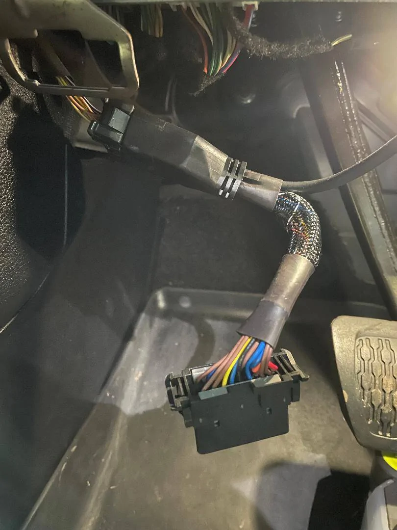

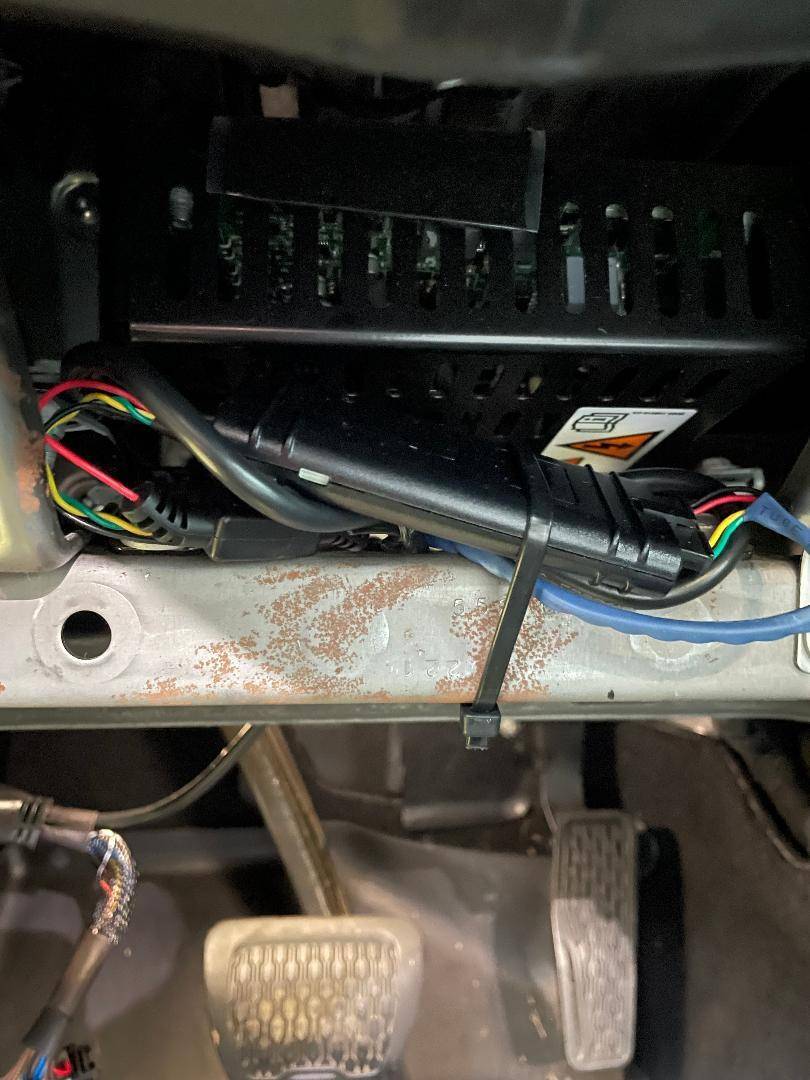

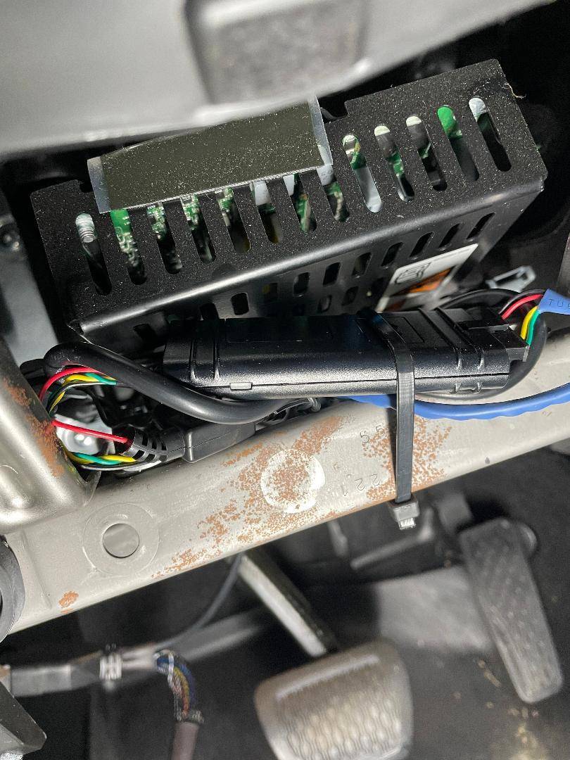

I am trying to install the AEV Procal Snap. When I pulled the OBD port it didnt look like instructions. Looking further back it looks like a splitter was installed to original port. Does anyone know if this is factory or after market? I bought a 2021 Mojave edition. I dont see anything that looks aftermarket on the gladiator but this and dont know what it is for.
When I wiggled and tried to pull apart everything on the inside power wise jumped on and off. So afraid to mess with it till I know what it is. Not sure if you can tell anything by these pics. But it looks like the zip tied item is what is hooked to the OBD port.
GPS Tracker

I removed it, installed my AEV procal Snap, set new tire size and air pressure settings. All is right with the world now.
Thanks for all the info. Didnt imagine a tracking device and didnt want to remove something that would cause vehicle problems.
