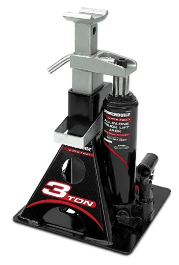

Full disclosure..I have a full shop with a 2 post lift BUT I also have the one listed above for when I Overland with my truck camper as it allows me to comfortably and safely get under the truck if needed because it is also a jack stand.
Thanks for the advise, I may give them a try, sometime I don't trust the Amazon reviews (positive or negative). Very curious how well these are actually constructed.

I have floor jacks, bottle jacks, and jack stands, there is no perfect do-al- jack, like any tool each has a specific usage depending on location and application.
I'v seen these on Amazon they look handy and considered purchasing a couple but maybe the quality is suspect.
https://www.amazon.com/gp/product/B003ULZGFU/ref=ox_sc_saved_title_2?smid=ATVPDKIKX0DER&th=1
I've had a pair of those for about 6 or 7 years now. Used them many many times on several lifted F150's even a couple MINI's and Audi's. I would buy them again. However, I also have a pair of 6ton (I think) HD jack stands, two floor Jacks, and assorted smaller jacks. These pump jack stands are not a solve-all, there will be times when you need a floor jack still.
Thank you also for verifying the quality.
I was interested in these because sometimes when wanting to use jack stands the most convenient jack point is where you want to put a jack stand. I think a pair of these would be handy for certain situations, I also have different jacking equipment to choose from wish I had a 2-post lift (just what i need, more tools).
Your reply pretty much verbatim describes why I bought them.
