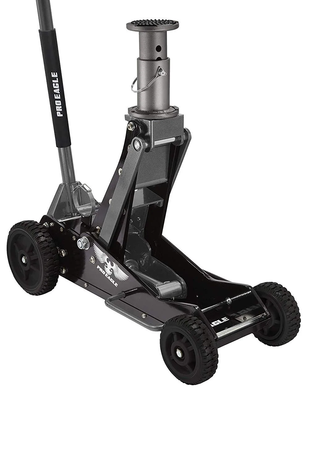

This is what I have been considering since it will be nice to have in the garage and on the trail. The only thing I have not figured out is how to store in the vehicle while off road. Anyone have suggestions?

Folks, my wife and I are getting ready to take off with the motorhome pulling the Gladiator Rubicon and I’m trying to get accessories we really should have off road. Have a compressor installed, straps, recovery ropes, shackles, snatch blocks, etc, and now looking for a jack kit of some sort. Gladiator has 3 1/2ā€ lift (although probably closer to 4) and 37ā€ Patagonia’s on it. We won’t be doing anything extreme, or at least we never have but I don’t want to get stuck out in lord knows where without appropriate equipment. I’m considering the Safe Jack’s Sargent or General Kit. A little pricey but compact and looks versatile. Space is a little concern as we fill up the back with stuff we think we need for RVing for 3 months. Any thoughts, suggestions, or guidance?

Thanks for the response. In the Safe Jack video I viewed, after adding a number of extensions, it looks like there was some looseness which could cause some off balance when using at the longer extension lengths. Is this what you’re referring to? In my case, it wouldn’t be for normal use, just as an emergency sort of thing when away from ā€œcivilizationā€. Think it’s appropriate for that type of expected use? Or should I look at something like the Pro Eagle (which I suppose I’d use around home if I had it) - expensive though, especially if you include a bed mount.

I like this concept a lot but not sure it's a great option for off roading mostly because of its size and weight (and carrying it in the JEEP)

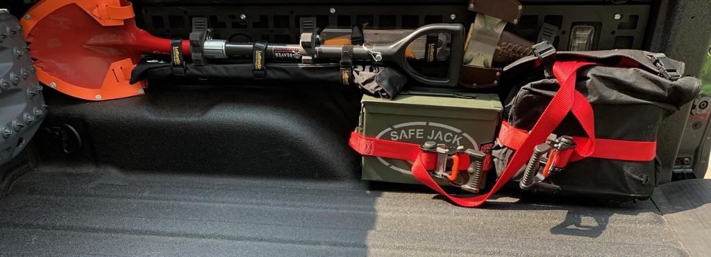

I also had a hard time deciding. I have 5 floor jacks at my house, lol... I decided to go with the Safejack "General" because of the extra base, extensions, and ease of storage. I just strapped it to my molle panels with a ratchet strap (which may also be useful to keep the suspension compressed). After looking at the "General" kit, I am pretty convinced that it can handle any trouble 37" tires get you into... I also carry a set of Maxtrax on the front of my bed, so, I can also use both of those as a base under the base if needed in sand. Here is a pic.

After the other input then seeing your setup, I’ve sorta come full circle (Safe Jack to jack stand/bottle combo to Pro Eagle). Now, again thinking Safe Jack General. Not that I think it’s the best jack, but from the space stand point. I really like your set up and use of Molle panels. Where did you get them? Did you have to drill or were they bolt on, etc? We have hard bed cover and store tow and braking system stuff in the bed, plus a few other items when traveling, so space is a premium. Maxtrax also something I’d not thought about. Any more pics and info you’d be willing to share would be greatly appreciated.
