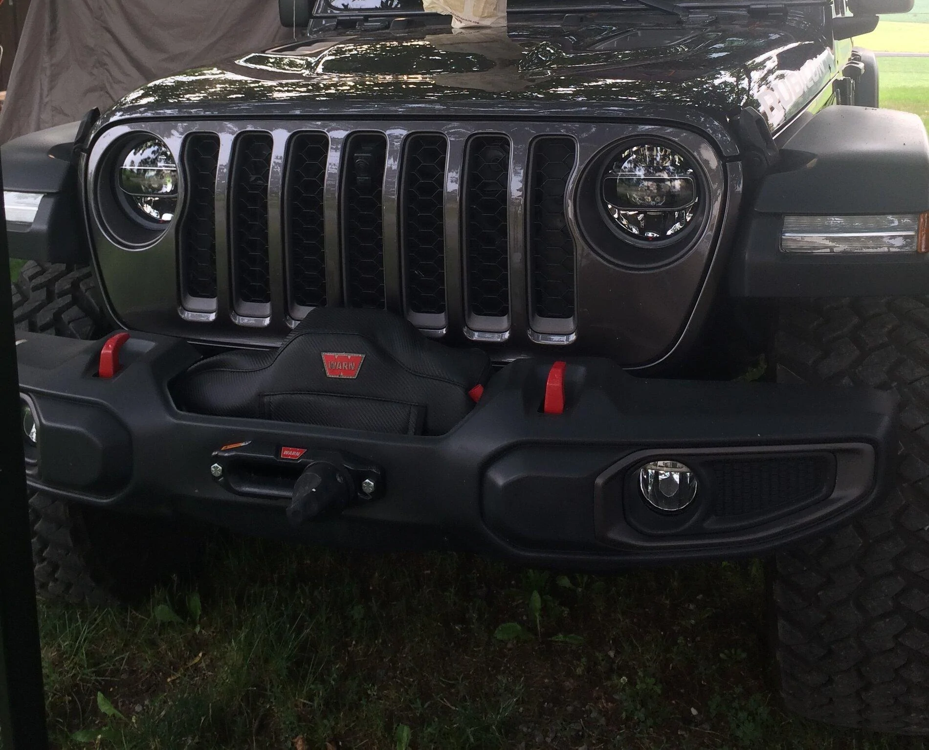

Winch, mount plate and modify the plastic bumper. Saves $. Also, I did catch my bumper on a tree while dodging a boulder on a trail, plastic bumper bent and sprung mostly back. If it were the steel one, it would have been bad. If it were a stubby, wouldn't have hit at all.
I did this to my JK factory bumper. From the picture it looks like you knocked it out of the park on this one. Very well done.

Can you go step by step how to modify the bumper?????
Step by step, not really- I didn't take pictures.
It was a fairly easy removal, remove skid plate first then bumper assembly.
I installed a Warn winch plate because it has the support for the fairlead which you need with the plastic bumper. Do not tighten mount plate yet. Use a floor jack etc. to support winch mount, even marking position when square. Place winch on plate, route wires etc. and tighten winch to plate. Then tighten plate to frame.
With the bumper apart on the floor, cut the center section out of the beam leaving only what will mount to the frame ends. Since the winch is mounted, you have a reference. Please paint the cut ends of the beam. Also beware of sharp edges that you have created.
For the actual bumper cover, I used masking tape to make my lines and followed the recess in the bumper. This replicates the panel in the steel bumper. I cut with a cutoff wheel and molten plastic flying but a hack-saw would work just fine. Finished the edge and internal corners with a file then ran some 180 grit along it. Nope, it's not perfect but decent.
Keep in mind that the mount does push on the bumper cover and it is not perfect. With the bumper in place, I pushed on the cover to reveal the holes for the bolts on the fairlead. I drilled a small hole first so that I could adjust as needed then the correct size for the bolts. Place fairlead in place and trace the hole for the cable to pass through. The hole in the mount is much larger than the plate so I just used a utility knife to open it up, being mindful to not have the bumper smaller than the guide. Even just plastic can be sharp at the wrong times.
In retrospect, I should have left more material in the corners of the cover to hide the winch a little better.
I chose a Warn VR EVO 12S for many reasons. First by watching/timing sales I bought it for nearly the same price as an off brand. ($530 from Northern Tool.) Synthetic line was must, I have seen the damage caused by steel cables and chains when they break; the bonus is the weight savings. Estimates are about 20 lbs for the line and another 10 for the fairlead. The downside is UV vulnerable, so I bought a cover for the winch and an abrasion sheath for the line which you need anyways. Add some soft shackles and you just saved 20-30 lbs. over conventional equipment.
