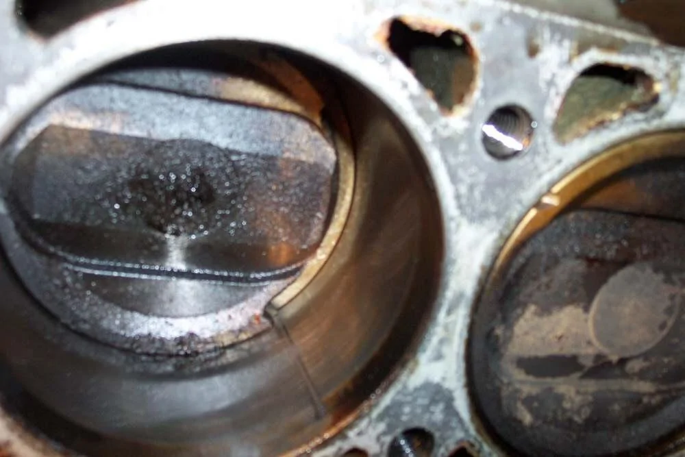

Ping is the sonic wave resonating in the combustion chamber walls when two flame fronts collide. That ping is the result of DETONATION and is almost always destructive. It blows away the cooler boundary layer from the top of the piston, it damages spark plugs, it breaks things.
They don't always ping. I have no idea where you get that, but as a professional mechanic, I can tell you - they don't - or they'd sure as hell better not.
Detonation is when the fuel SELF-IGNITES. The normal flame, started by the spark plug, progresses across the combustion chamber. As the flame front progresses is shoves the unburned mixture into a corner, so to speak. The pressure and thus heat increase in the unburned fuel until it finally ignites, creating another flame front. When the two collide, you get a sonic boom of sorts, and that makes the cylinder walls ring - the ping sound. It's destructive.
Don't tell me I don't know what to listen for - I'm college and factory trained and worked in the field for years. I've built and repaired engines since I was a teen in the 70s.
I know ping - here's a result -
Jeep Gladiator What octane gas do you guys run piston-5a
