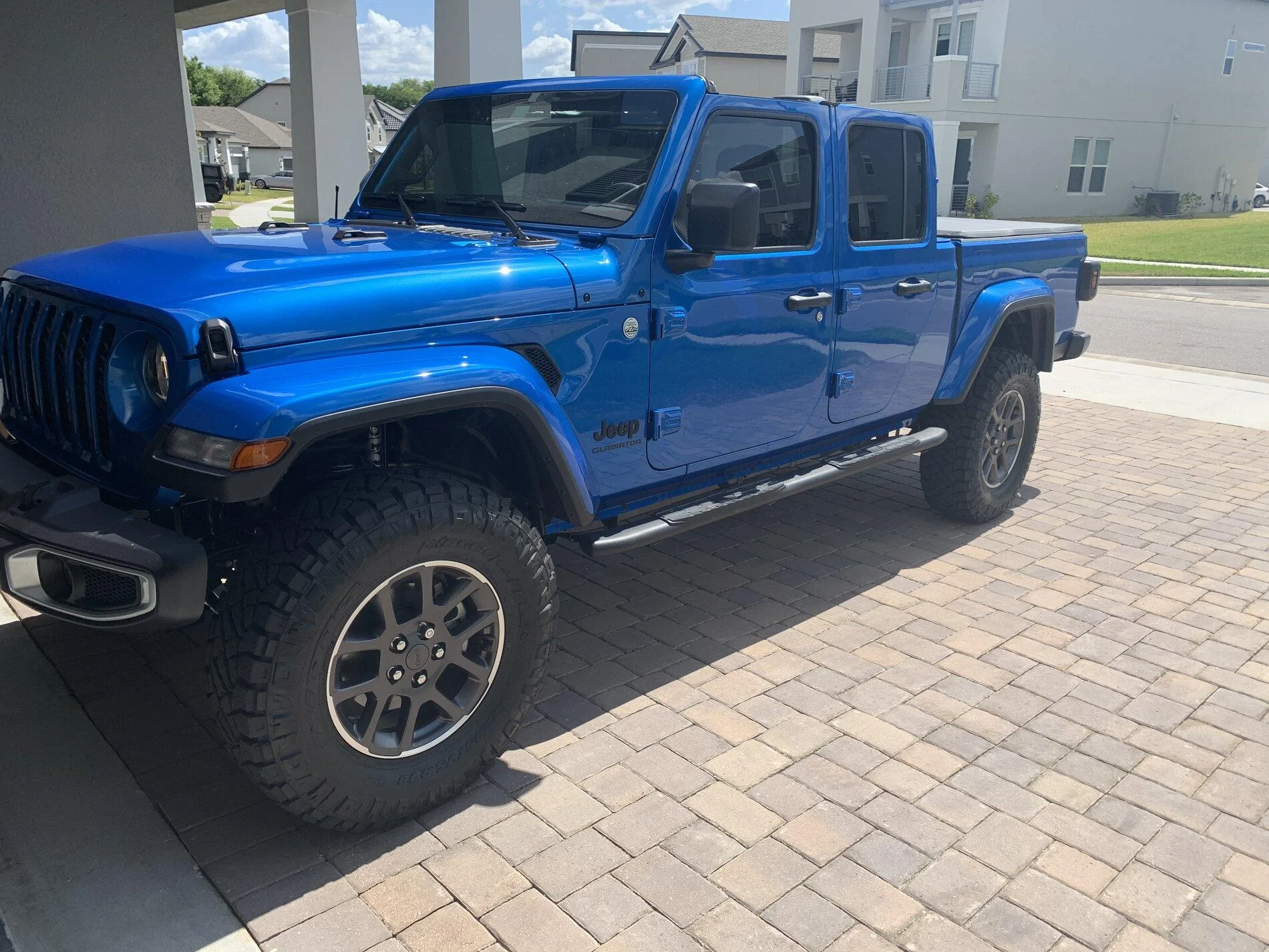

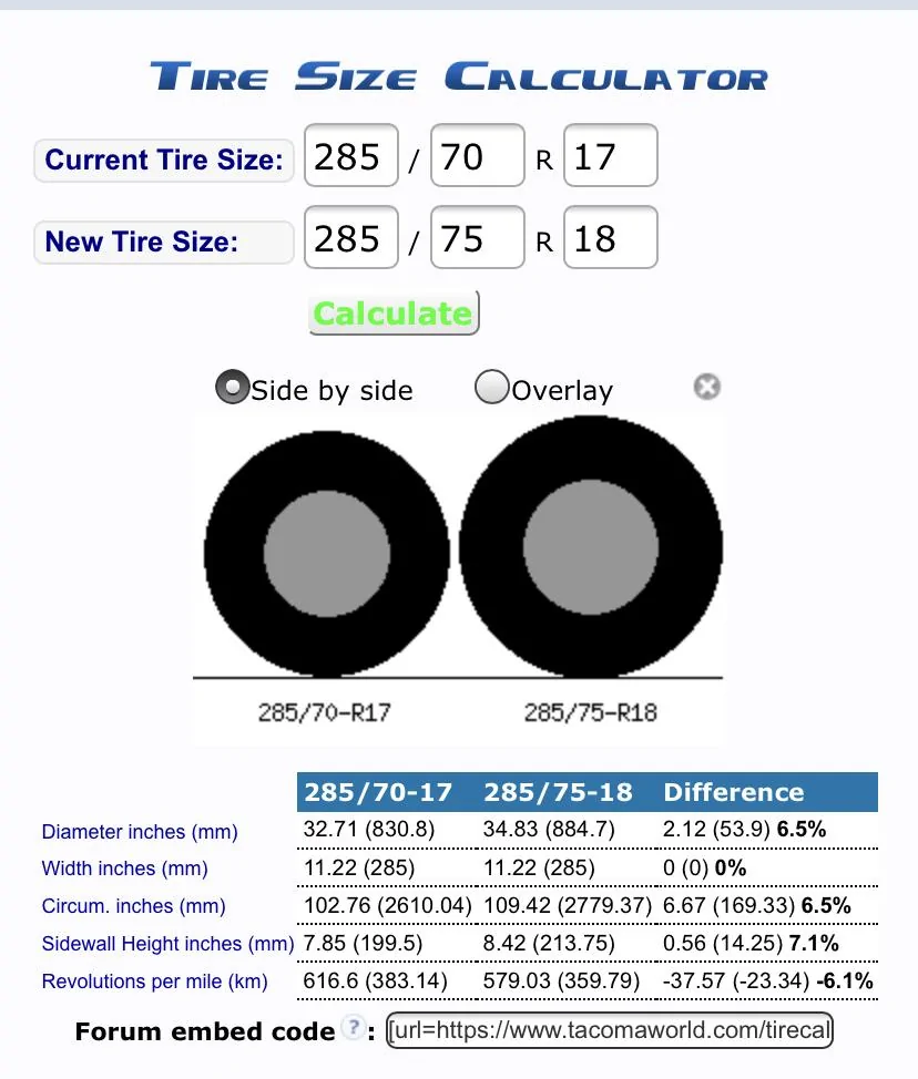

Here is a comparison for the stock rubicon ATs and the 18” tire he has. About two inches difference between the two.
I have 285/75r17 wildpeak ATs (the in the middle of the two being compared) and I like them a ton. Look great and quiet.
Jeep Gladiator What options on Overland wheels 18x7.5" 83368E59-6B55-4836-A827-A25D0E70083D
Edit: one thing I like about these wildpeaks is they aren’t too wide, and can fit on a stock 7.5” rim. I like that “tucked” taller look versus a lot of tire sticking out.

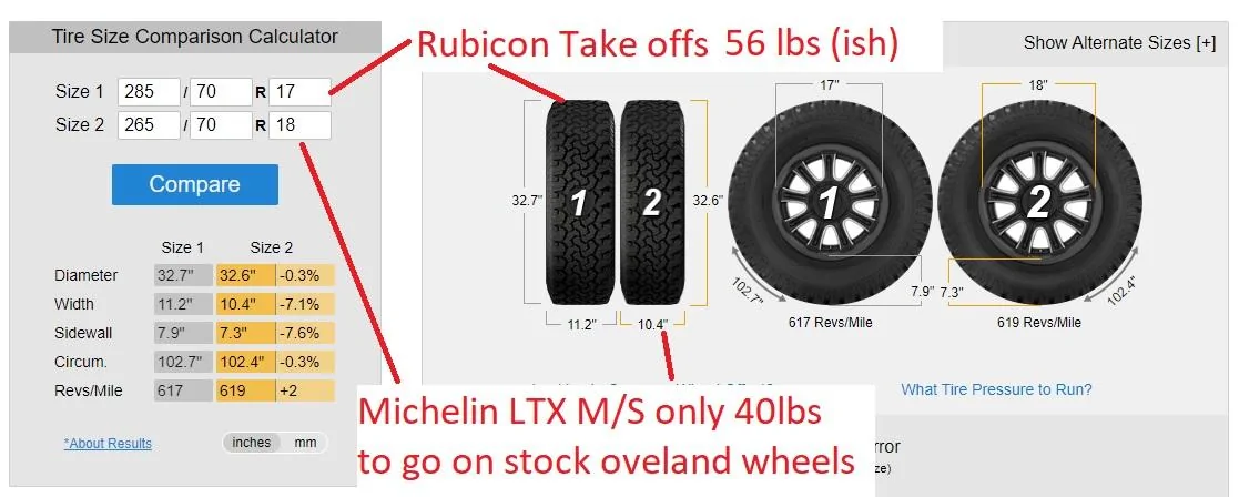

Br4hm4
Grant
Nov 5, 2019
414
392
Peyton, CO
2020 JT OE, 2016 Polaris Slingshot, 2012 Kia Sportage, 2018 Nissan LEAF
Linux Engineer
I personally want a more aggressive tire without the added weight. I had a set of Rubicon take offs with the Wildpeaks and it looked awesome...but the weight difference between the Overland setup and the Rubicon set up was substantial. My gas mileage on the Rubicon set up was around 17 mpg. With the Overland set up 22 mpg. I know I know...Jeepers don't care about mpg...but I do. lol
I went the Rubicon take offs on my overland as well. Rides is worse but looks good. It really sucks that most tires are Load E in 18" wheels. Almost no 34" or 35" that are load C
