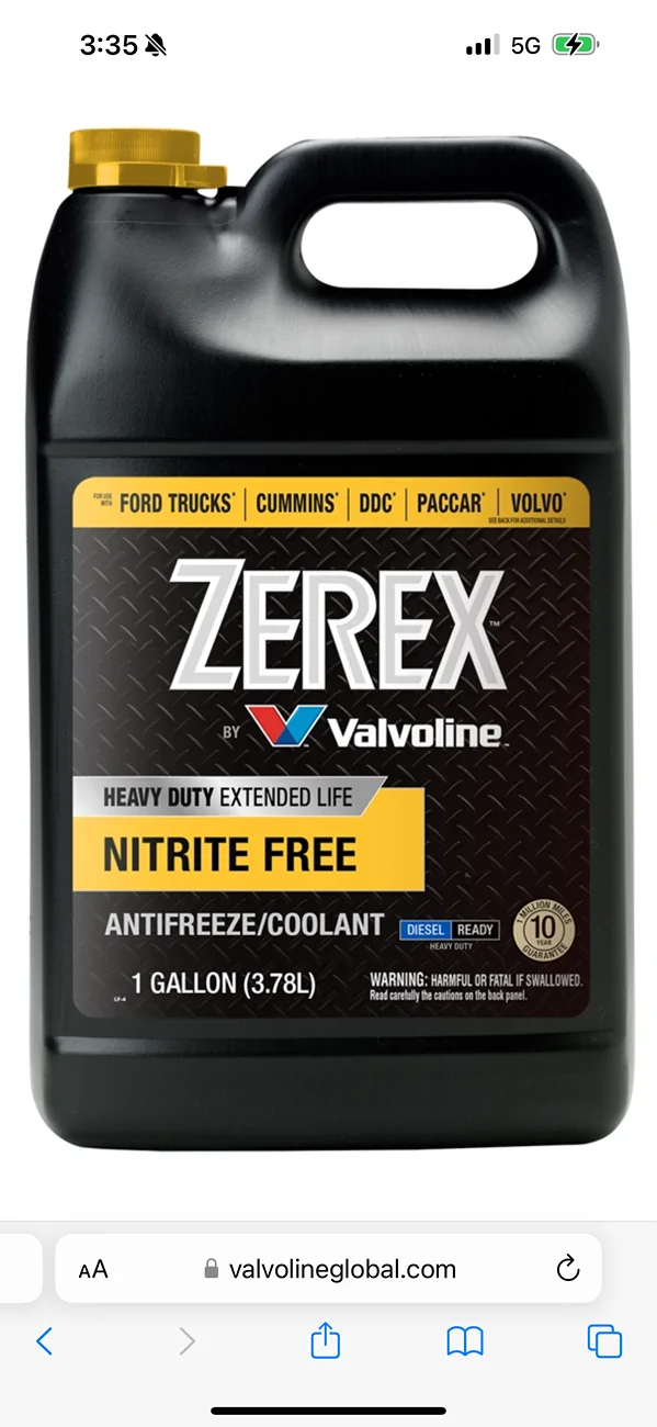

What did your coolant test out to? I also have a 2023 JTRD
With test strips, it was slightly below 7. I bought a digital tester and it was about 6.8. After draining the radiator and refilling, it was 7.2. I didn’t flush or fully drain the coolant system.

Ok thanks, I bought some of this stuff to change mine out.
