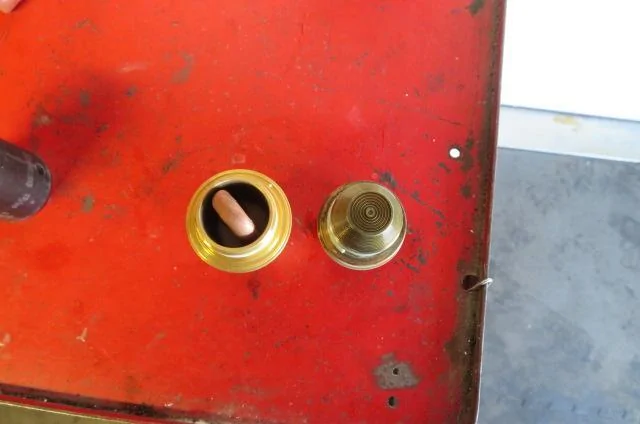

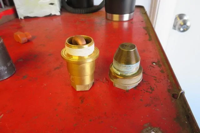

Block heaters came in them up to 2021. But you had to buy the cord from the block heater to the extension cord. 2022 on, you have to buy the block heater and install it. There is 2 different styles. One replaces the screw in brass. block plug. The other clips into the brass block plug. Plus you still have to buy the cord. Takes about 30 minutes to install. Plus another 30 minutes to route the cord. There is a couple of threads on this.
Here's the screw in block heater.

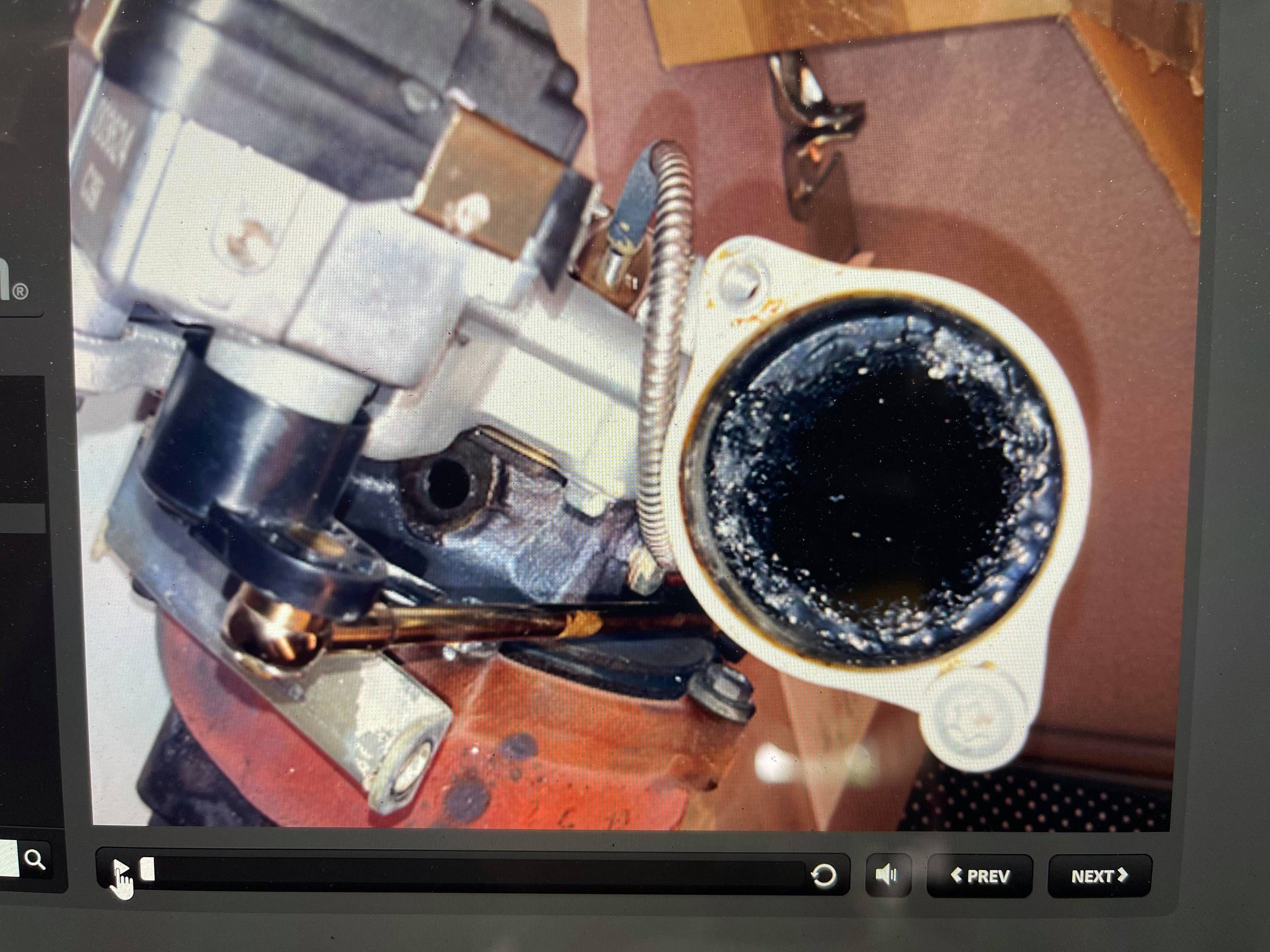

The gen3 oil spec says 5w-40 sn/sn+. Rotella t6 meets the sn spec. The build up they are talking about is most likely due to blow by oil fouling the compressor wheel/cover. That won’t kill the turbo bearing seals. We used to estimate 1-3% fuel economy loss on some slightly larger diesel engines due to this. I think any engine with closed crankcase ventilation and a turbocharger is susceptible to this fouling. I assume the SN oil spec added detergents to the oil to reduce/prevent this. It probably also reduces build up on the back of the valves like the first direct injected vwag and bmw engines had.
Just to be clear, Rotella T6 doesn't meet the MS-12991 spec, which is why a service bulletin was sent to the service departments making that known. In addition, a video was presented by the Master Tech showing pictures of a turbo that was allegedly pulled off a test mule. Here's what the picture looks like:
I would be curious to know what kind of duty cycle that ran and if it’s from blow by or turbo bearings. I see now that the service notice says the ms spec AND sn/sn+. It is hard to believe the turbo is that sensitive to a common diesel oil.
We know from internal sources that some of the test mules were run on boats out in the ocean. The service bulletin says that "using the oil specified for the GEN 2 engine in the GEN 3, will lead to deposits forming in the turbo charger, leading to reduced performance." The issue isn't the turbo. As a matter of fact, that turbo is used on other applications that are approved for Rotella T6. I've been told that Rotella T6 can't hand the high heat and internal pressures of the Gen 3 engine, which will cause coking.
