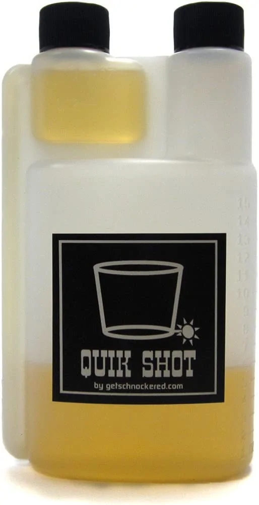

Completed some work recently involving a tune and exhaust mods. The tuner said to run 3 to 5oz. of lubricant at each fill-up when using U.S. diesel. From him:
"Yes I personally rotate between Amsoil all in one, arch oil ar6500 and hot shots edt. Periodically I will use Lucas upper cyl lube or Power Service or Optilube."
Sounds like the brand isn't as important as ensuring a hefty dose of some reputable lubricant is used. I too have been running products exclusively from Hot Shot. I ended up grabbing quart sized jugs of LX4 & EDT directly from Hot Shot. Both can be had for $49 shipped if using a 10% coupon code (last I used was HSSTEN and still seems to be valid).
I mix them 50/50 using a refillable 16oz. EDT style flask that I found on amazon:
https://www.amazon.com/dp/B00RM5FI5I?_encoding=UTF8&psc=1&ref_=cm_sw_r_cp_ud_dp_K8SFZCGFNK03RR9JJNHS
Jeep Gladiator Engine Failure quick_shot
I might mix it up and try some other brands but currently just shy of 50k miles and it has been happy. Been running lube since new but not in the above dosages, I didn't learn until around 30k miles just how poorly our diesel lubricates.
