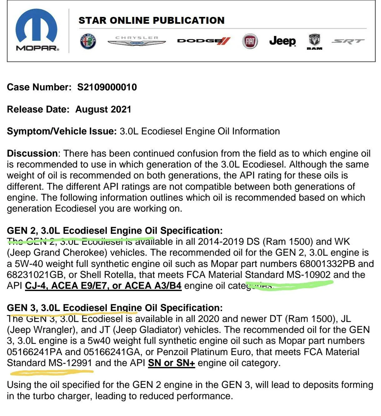

The turbo seal do go bad especially with the dealers using the wrong oil. There is a TSB not to use Rotella but the dealers use that since it's cheap. You have to let the engine cool also before you shut it down to cool the turbo center section. This is the case with all turbos. Let it idle or drive very easy the last 5 mins. If towing and going to exit and fill up, let it cool first 3 mins on idle.
Do have a reference to the TSB that says don’t use Rotella? All I can find is that it depends on what Gen Ecodiesel it is.
