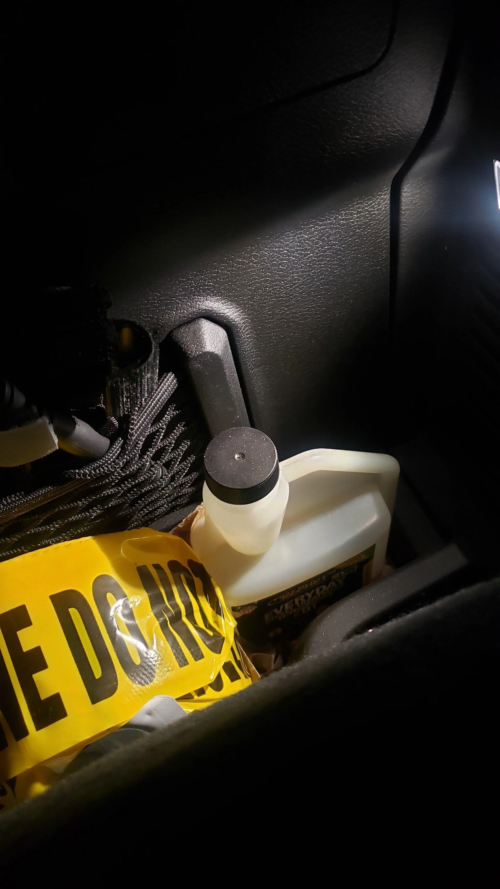

I shove it in the corner of the cubby, and have something to keep it upright. I have had it leak though: when the bottle is nearly empty, on a hot day (or high altitude) the air in the main volume can expand enough to force the liquid up the straw and out the top! To solve that, i ensure the straw is empty and the bottle is slightly squeezed before I seal the cap so there is room for gas expansion when it gets hot.
