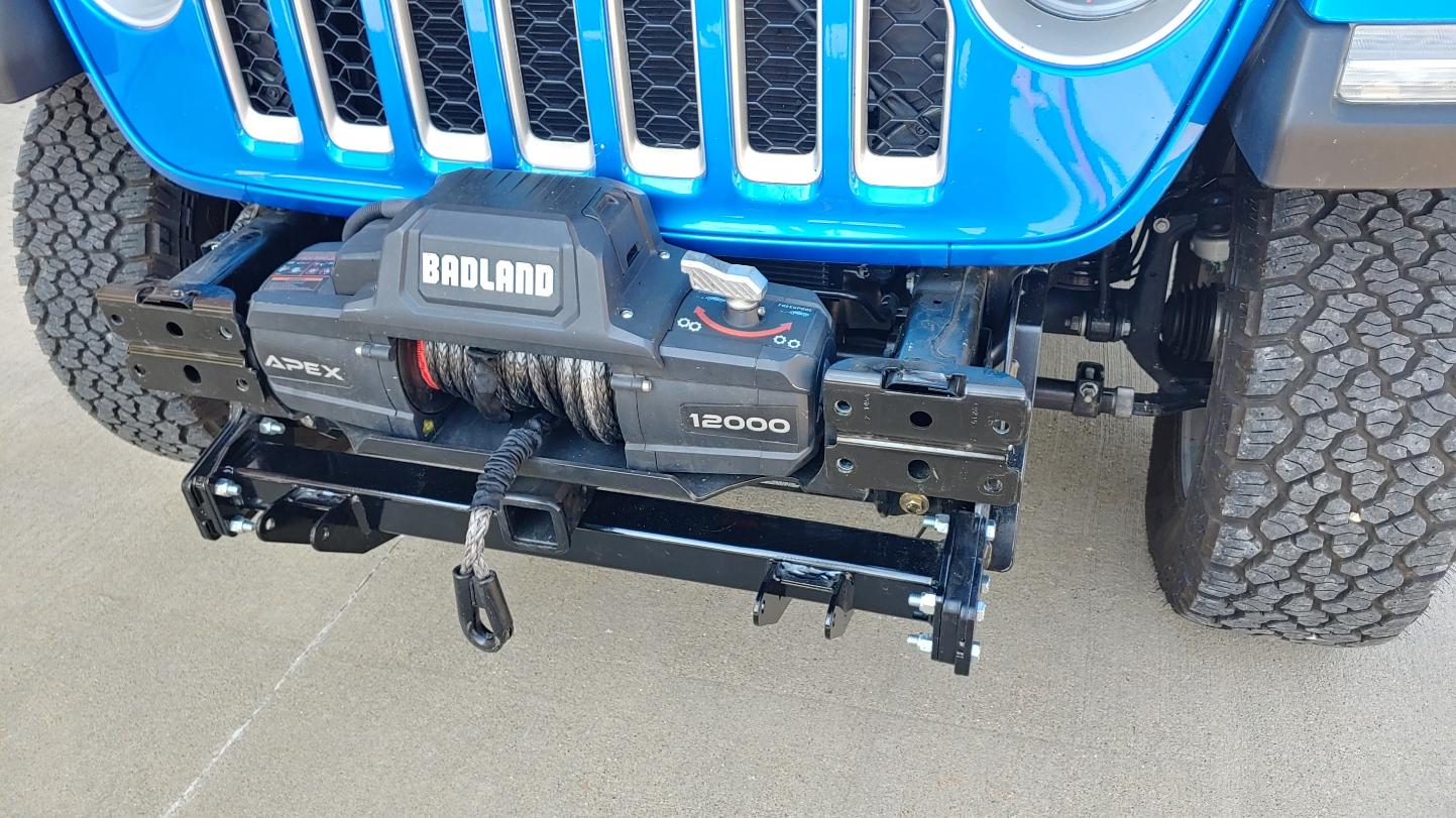

My secret with the cheap winch plate that came with the eBay steel bumper was a 2x4 and a floor jack, and some bolts and nuts.
I put the plate in place, lined up the holes in the front of the frame using tapered long punches and some rods I had. I got the holes lined up perfectly using the floor jack with a 2x4 on it to hold the plate where I wanted it, then bolted the plate to the front ends of the frame to hold everything.
I mounted the winch (bumper still off) and tightened the rear/lower winch plate bolts tight, used the jack and board to support the plate with winch while I removed the front bolts, and slid the bumper into place.
I did put the bumper together, loosely, on the floor. I didn't tighten anything until it was on the truck. Each truck is a tad different due to tolerances. My 2020 and my 2022 had some very different measurements between frame parts and holes. No way I could have removed a bumper from one and put it on the other without loosening everything up.

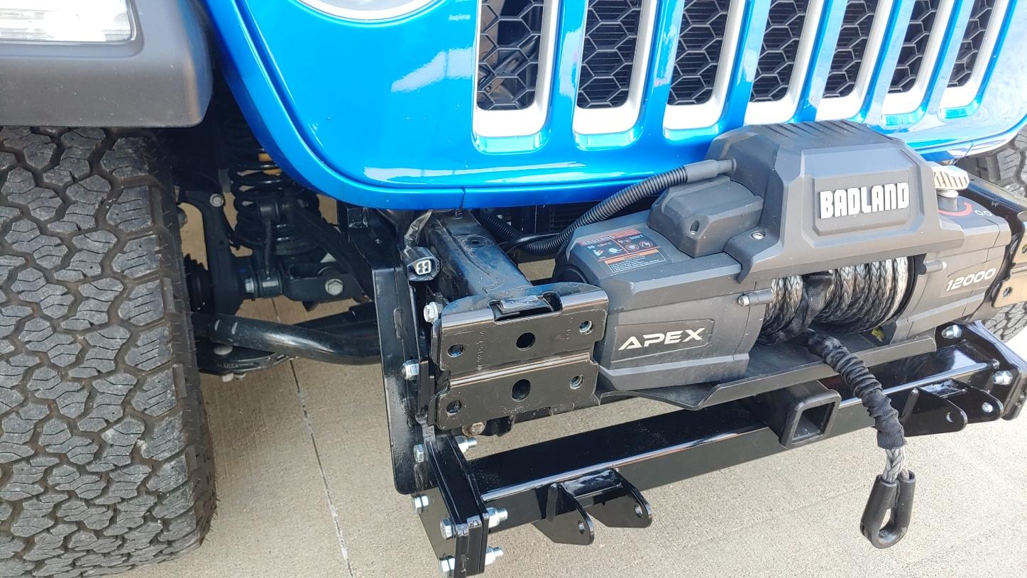

Installing on my 2020 - the winch plate bolted between the frame and bumper. Note how well the holes lined up. I used a jack under the plate to hold it to line up the bolt holes after using tapered punches and rods to line holes up.
I put the bumper brackets with hooks in place then built the bumper on the truck. Easier to do.

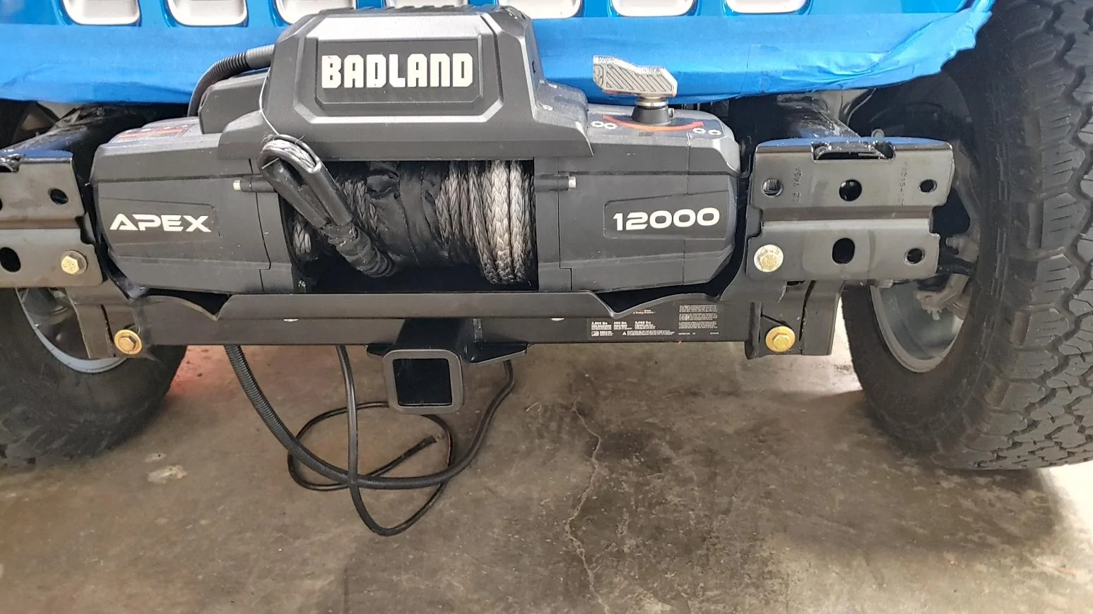

With the new Bulldog winch plate it was much easier as it bolts against the REAR of the frame ears on the front - those help keep the plate in place with bumper off -
This is where I am installing the stuff on my 2022 -

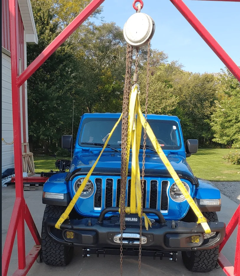

I love my gantry crane! Working alone with a bad back you have to get creative..........
Anyway, this pic is here mostly to show that if you have the aluminum bumper like I REALLY REALLY REALLY wish I did, you could make it look great with powder coating. A shop near me does it pretty reasonable, and the finish is pretty much identical to the factory MOPAR steel bumper finish. It's black, nice texture and has taken my "oops" more than once without a scratch or blemish.
If I didn't have this steel bumper and so much invested in it, I'd be getting that aluminum bumper, would drive it straight to East Des Moines to that shop for powder. Two young guys started it a few years ago in a poor part of town, it's sort of a mom and pop shop, that does such great work they are building another shop in another town to do production work for small manufacturers.
