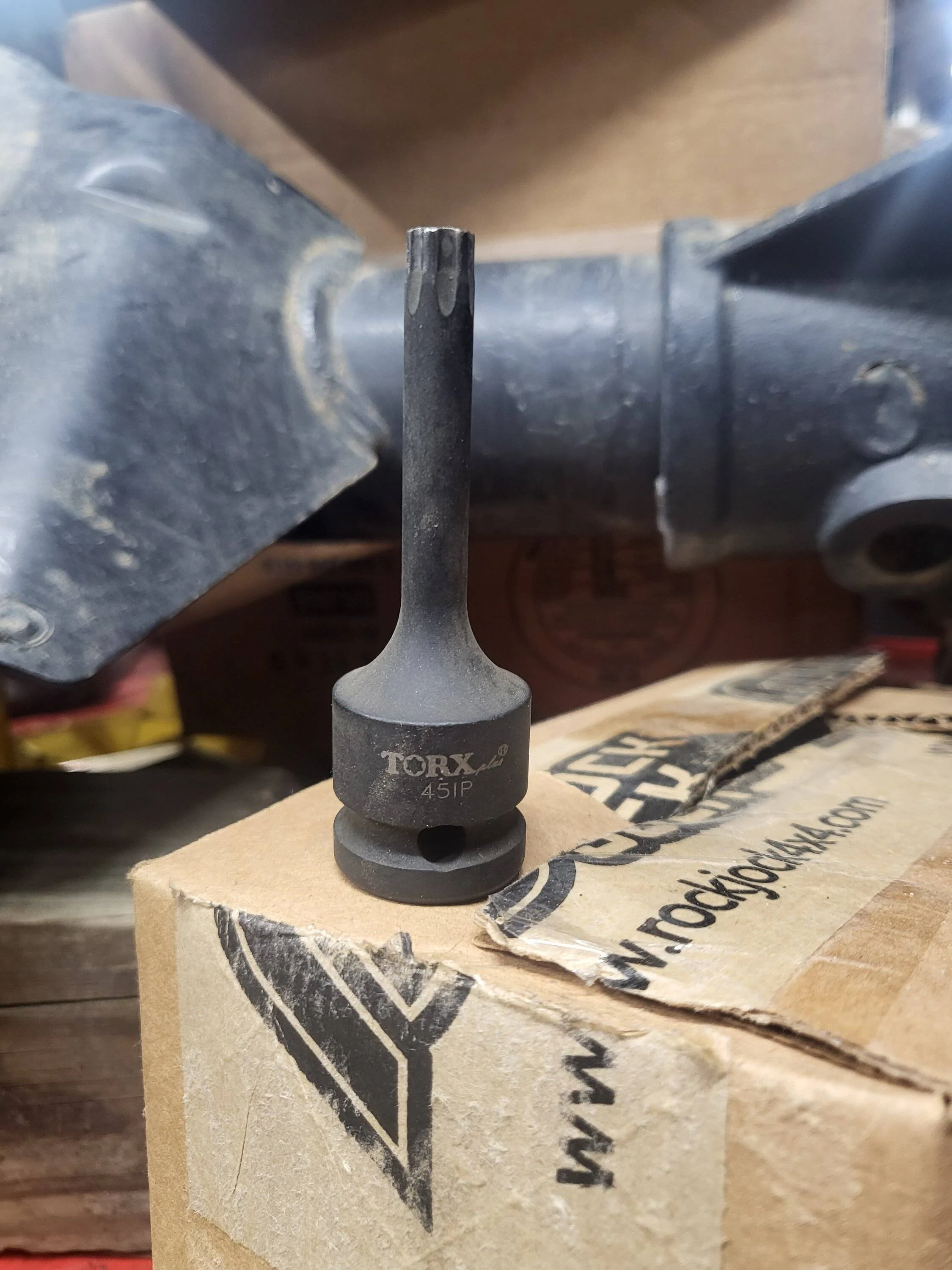

I stand corrected. I said it was a T50 + but it is actually called a 45 IP. I hate making incorrect statements so my apologies. I had to go to the shop to confirm but here is a picture of the bit itself. @starrskream
Jeep Gladiator What tools to carry? 20240229_181744

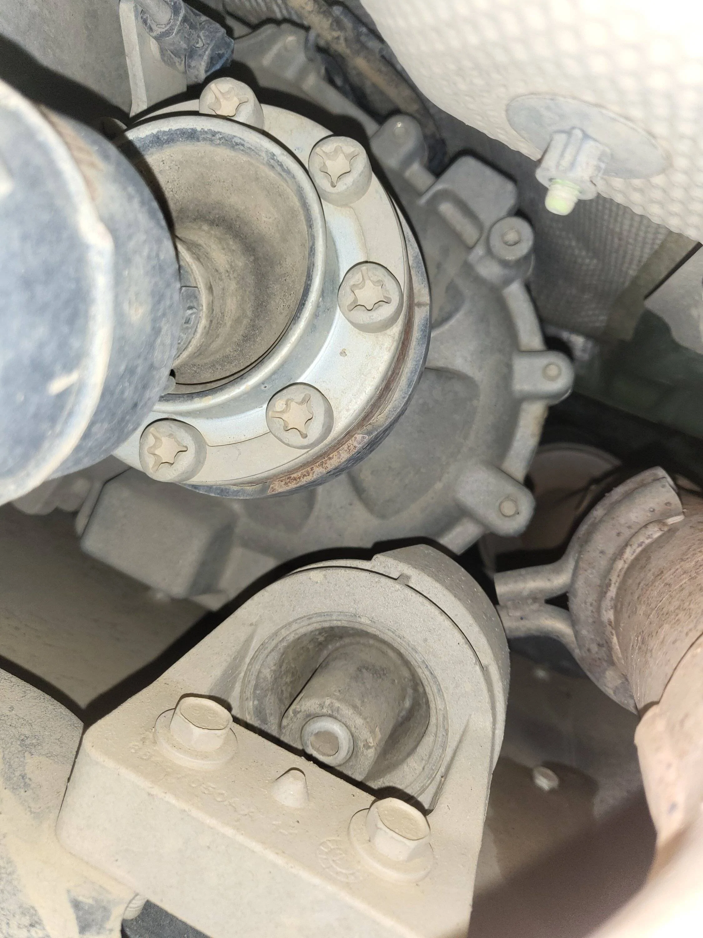

And this is the weird bolt that takes this special bit.
Jeep Gladiator What tools to carry? 20240229_183750
