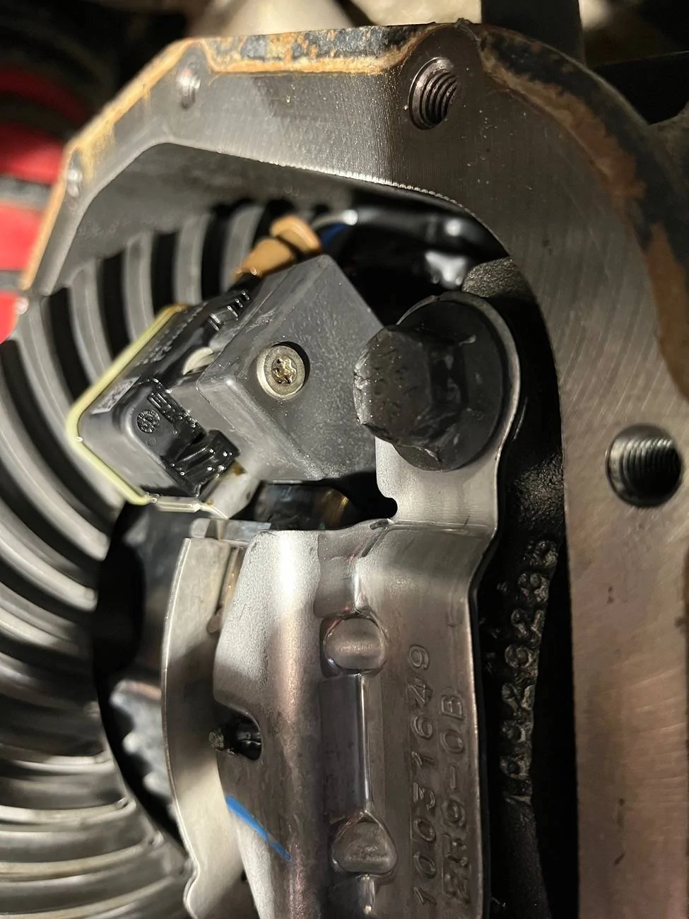

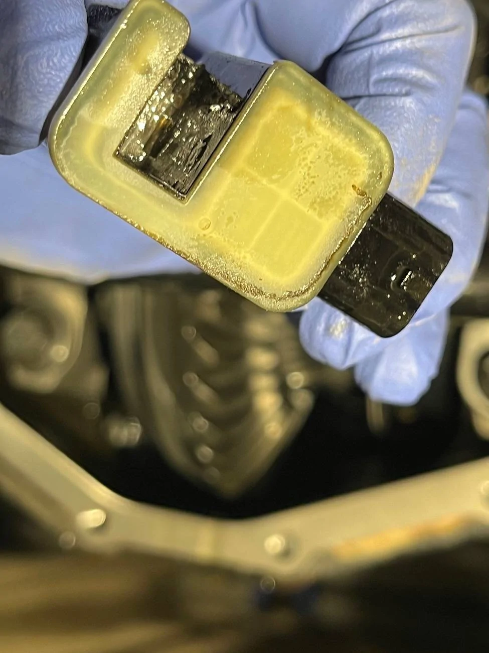

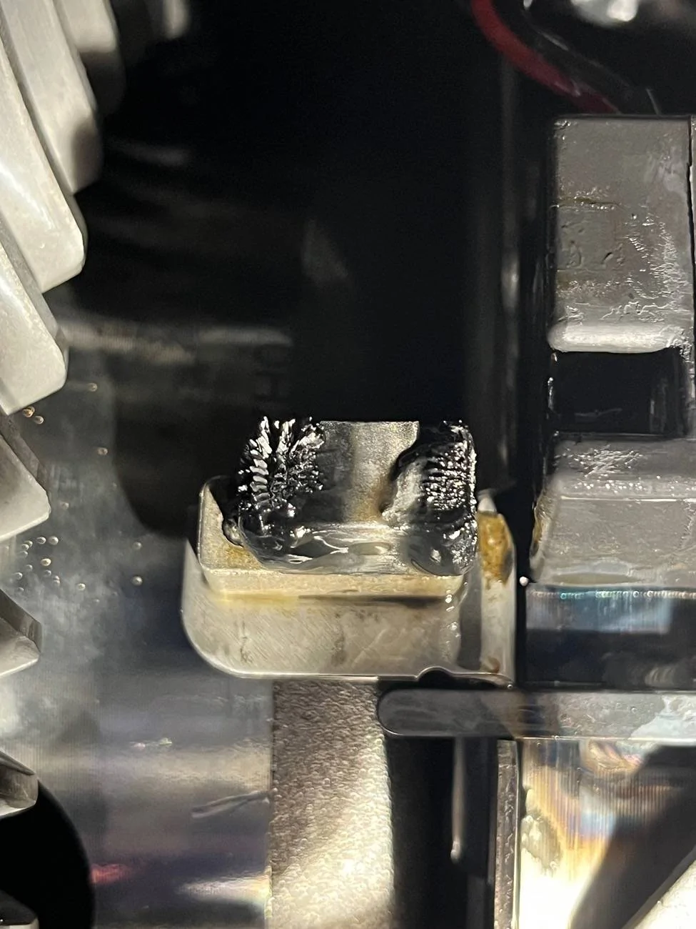

….and let’s not forget another reason to pull the diff covers (for those who have lockers) is to inspect the locker sensor for oil intrusion and to also pop it off and clean the locker sensor magnet so your lockers engage and disengage quickly.
Maybe some of you went with that sensor bypass Z harness cuz your sensor failed. Just keep in mind your Z harness doesn’t bypass the magnet and it still needs cleaning. If you’ve bypass the sensor and don’t have need for it, the magnet is at least working hard for you in attracting all the pretty filings.
Jeep Gladiator What weight gear oil??? IMG_0304
Jeep Gladiator What weight gear oil??? IMG_0298
Jeep Gladiator What weight gear oil??? IMG_0301
