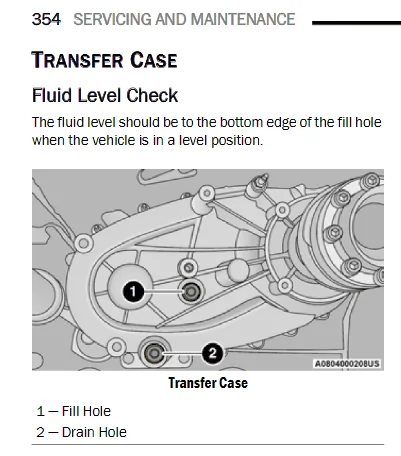

How can they want you to be exactly 1/8th below the hole, like it actually matters, and then say “approximately”?? ...
I wondered about that as well. I first ran into this 1/8" below the fill hole cr@p on my 94 Dodge Ram. I thought it was strange since everything else that I've ever worked on has been 'fill to the bottom of the fill hole'. On my JK, the manual states "Lubricant should be at the bottom edge of the oil fill hole." Anyhow, on my JT, I just made sure it was on a level surface, filled to the bottom of the hole, and then let it sit until no oil was coming out of the hole at all. This was my second oil change using this method.

I think for some to read that it has to be below where the hole is engineered might scare some people from attempting this scientific challenge. How is someone supposed to get a tape measure in there to measure it right so I think people give up. I believe the transfer case says the same thing if I'm not mistaken.
Been awhile but I remember back in the day on other vehicles where one had to measure below the fill hole like of a diff or manual transmission fill, the trick was to find something bendable into a J-Hook like a pipe cleaner and hook into the hole and measure the distance from the bend to the fluid line on the device used. Most just used their calibrated pinky finger and made the call.

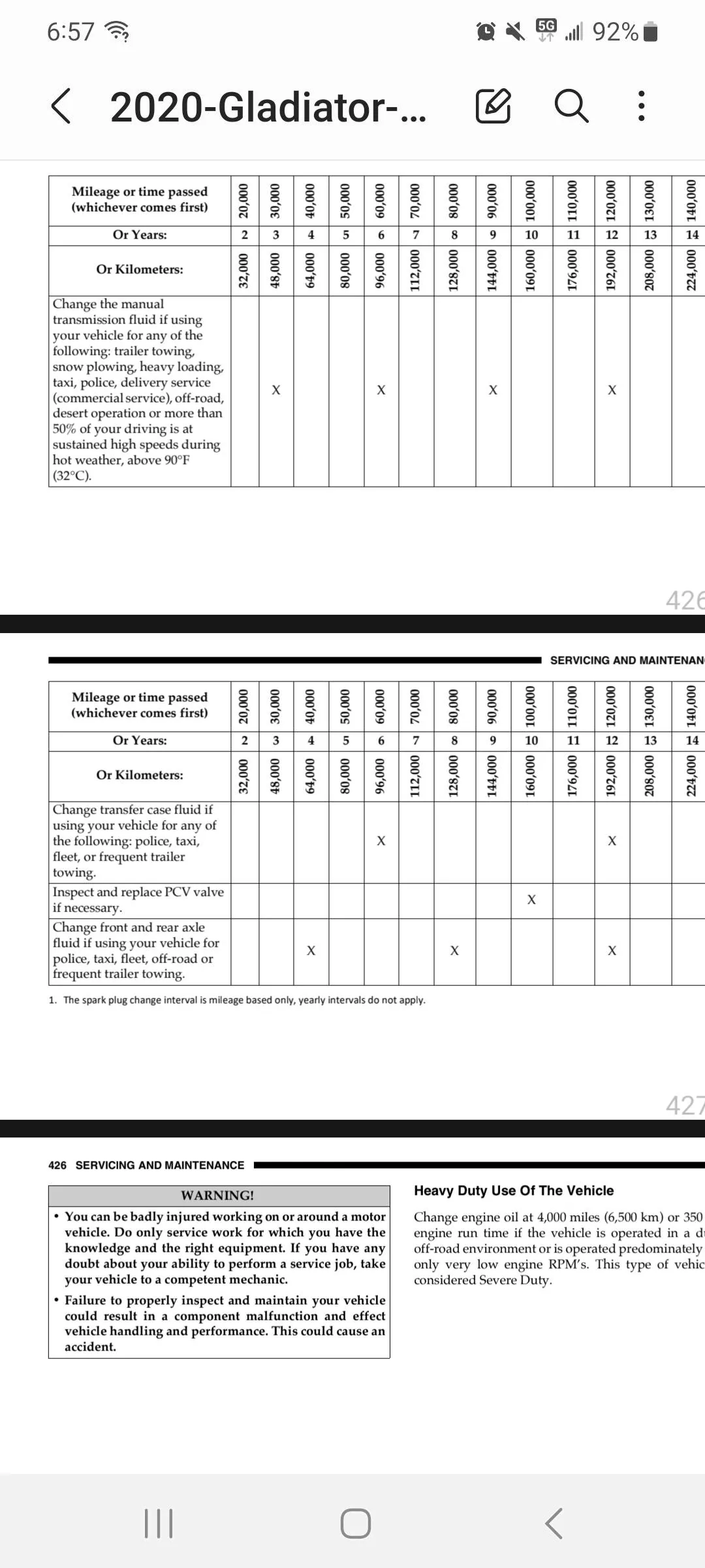

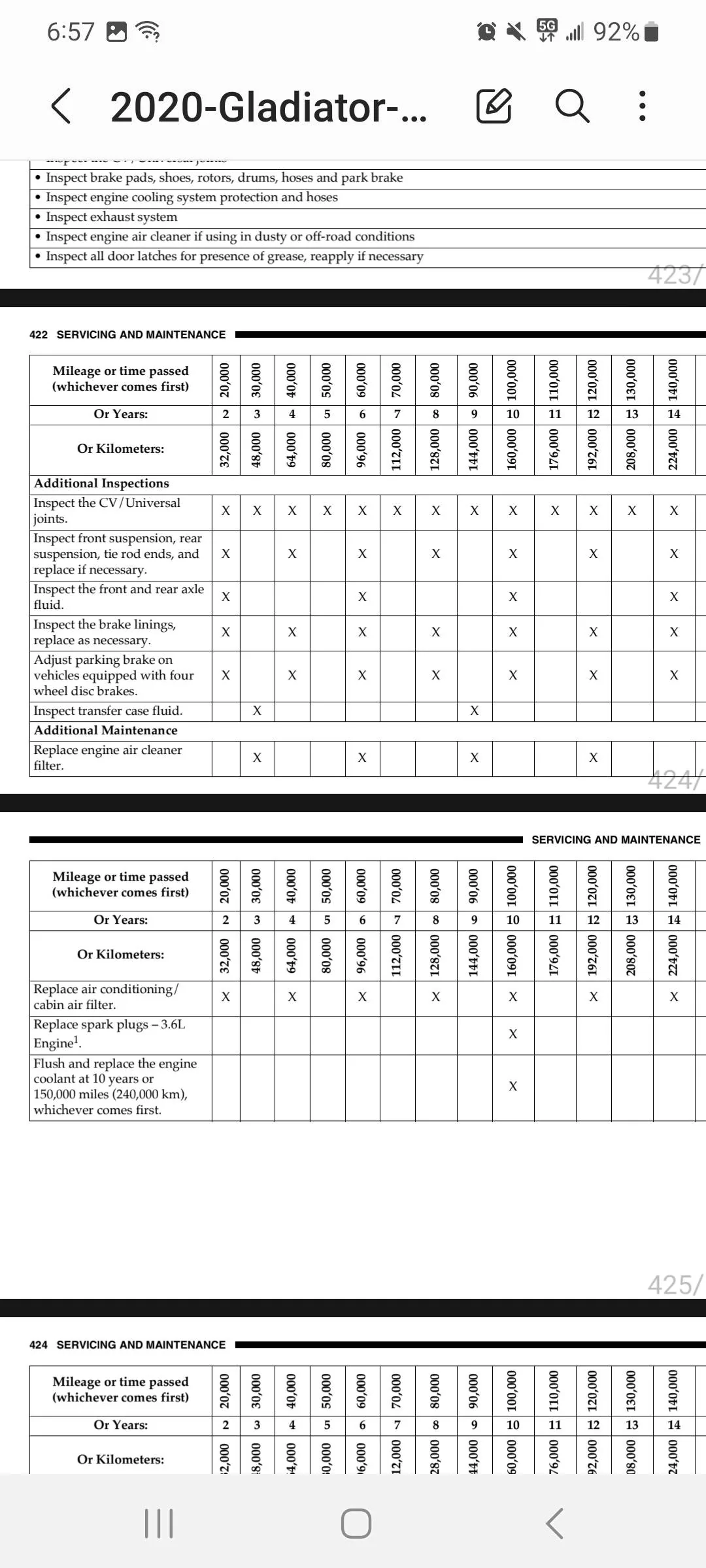

What is the recommended mileage to do this (on a Rubicon) if that makes a difference?

So 40,000 miles or 4 years for the axles and 6/60 for the transfer case under severe use.
